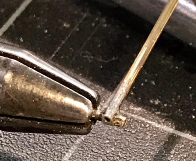

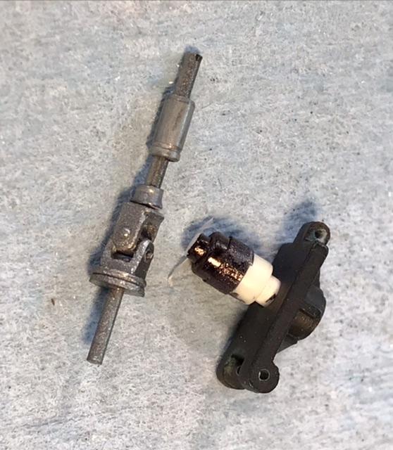

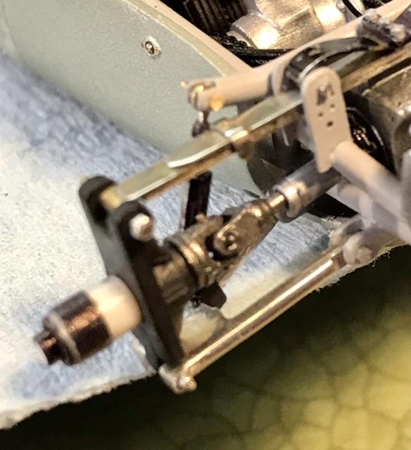

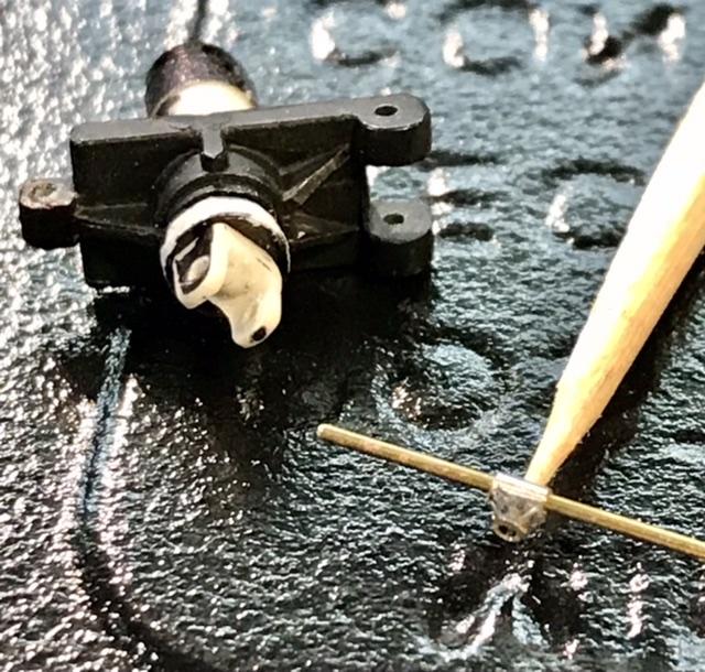

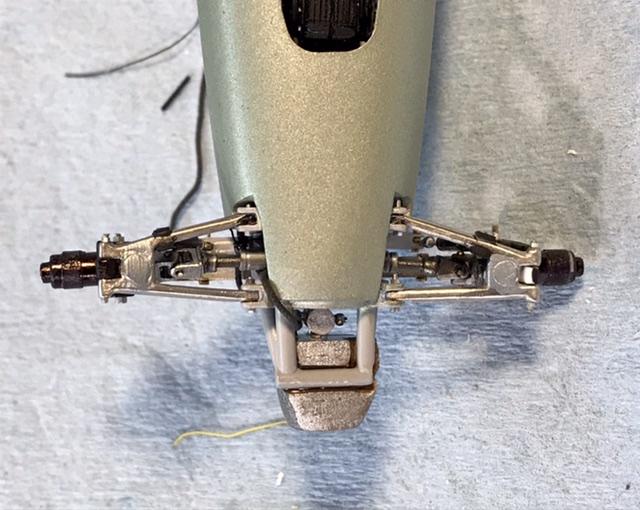

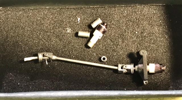

U joints /  evergreen strip - .080 by .100 - filed and sanded to shape with .020 holes for the pins - which are Scale Hardware .07 rivets - through a brass yoke made of soldered .08 brass tube ...
Weeeeeh ....
Share this post
Link to post
Wonderful how to on the universals answered many questions about how to do the cross bearing. Thanks!
Share this post
Link to post
You’re velcome ...  you can do a working susp with these ...  can’t on the Cooper -  The combination of plastic and brass makes these parts too fragile to allow for susp travel.   oh well ... paint finish on axle and U joints is Alcad polished steel over Alcad steel -  works well -

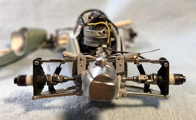

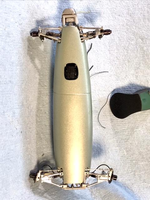

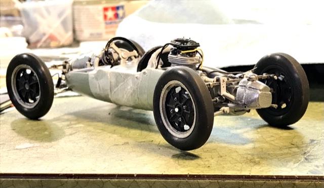

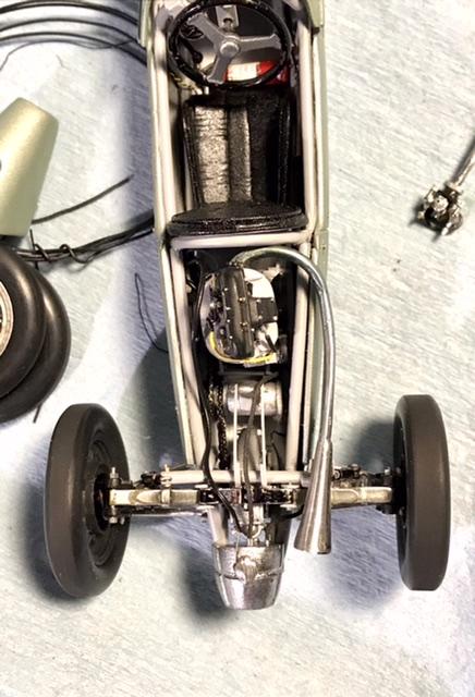

So the axles are in and the uprights are “pinned”. The axles run right up against the shocks -  the U joints are small but probably still a bit over-scale ...
the stance is not quite as good as the test fit 8 months ago- the left rear wheel is about a scale inch off the ground - I’ll use a couple of tricks to improve the stance slightly -  but I smell a points deduction on this ...  got to remember to delete this post ...

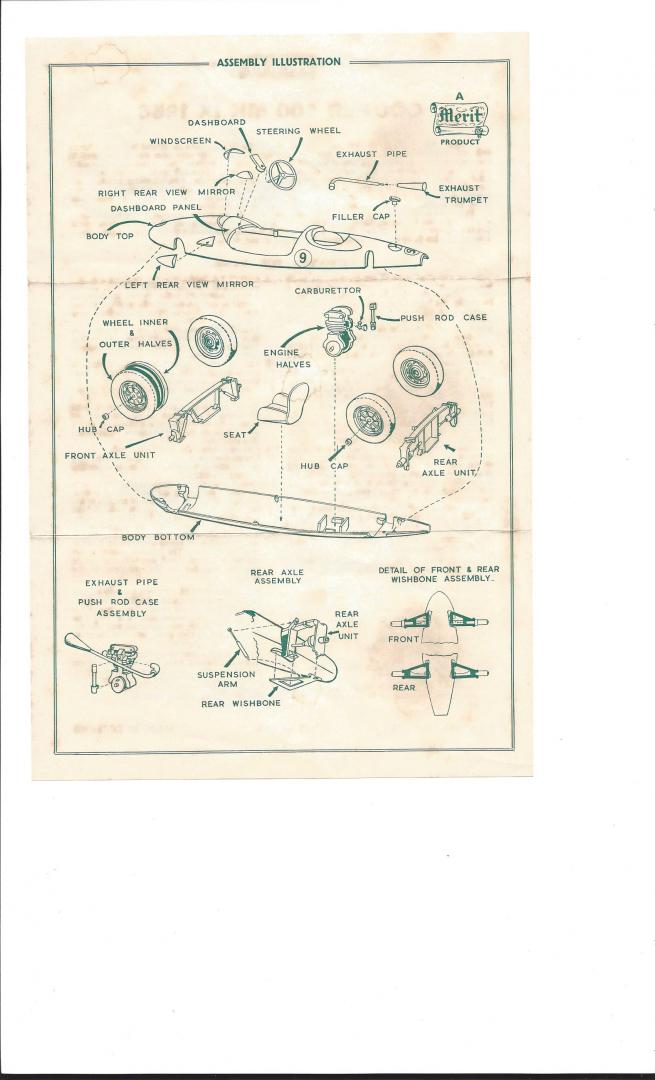

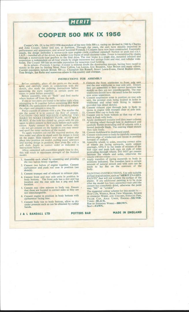

Buried somewhere on the workbench is a 1/24th Merit Cooper FIII.  Kinda rare.  Bought mine years ago as semi-built-up.  Started but not painted or finished.  Gonna actually build this with a thin-cast resin body from Guido or ScaleKraft fame.  It's a knock-off of the Merit body with a nice thin casting.  Also kinda rare - I've never seen another one.  To the best of my knowledge, Guido stopped casting before he actually produced a resin kit of the Cooper - which is a shame.  Anyway, I'm a complete sucker for Merit kits - got a bunch.
Delayed this build until I found some photo-etch that could be used for the chain drive - which I finally stumbled upon recently
- more on this later.
This is not a "real time" build.  The work on the body and chassis was begun earlier this year.  I'll post as I have time and sort of catch up on the build as I near completion.
Here goes .

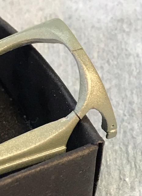

The engine cover fell to the floor (again).  The break was in the two thin spots where there wasn’t enough resin to withstand clumsy handling.  But the breaks were clean - so I’ve drilled in and placed some short .012 brass pins and drilled corresponding holes and glued it all back together. Will need some sanding and some more paint but I’ve got some xtra paint left over    ...  could’ve been worse ...

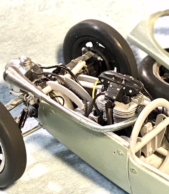

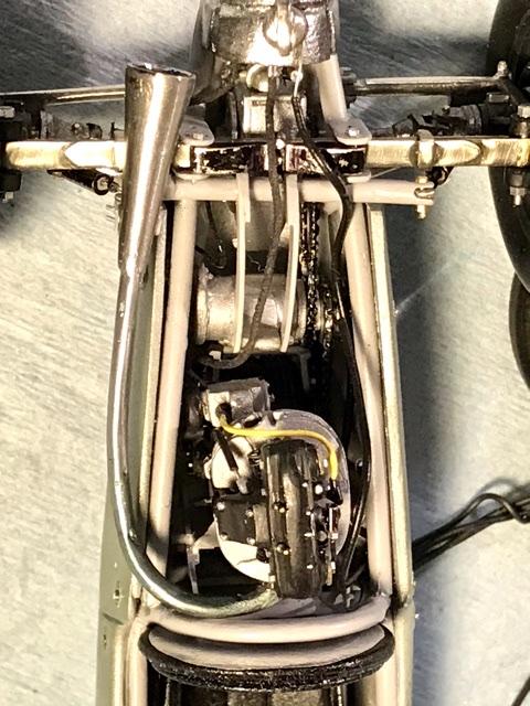

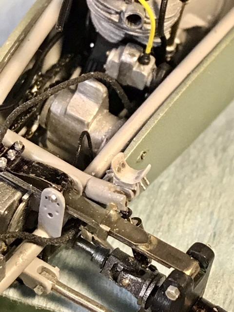

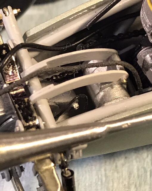

Last few parts - made from evergreen.  The mount for the exhaust pipe is set onto the chassis brace above the mount for the shock.  And I madE two curved braces that grab the top of the gear box.
Share this post
Link to post

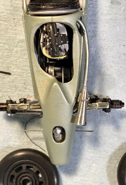

The exhaust pipe leaves the front of the cylinder head just behind the drivers head and curves back along the frame ...it’s a Herb Deeks white metal part - thanks Herb!
notice anything missing in the engine bay ?
Share this post
Link to post

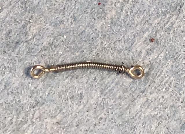

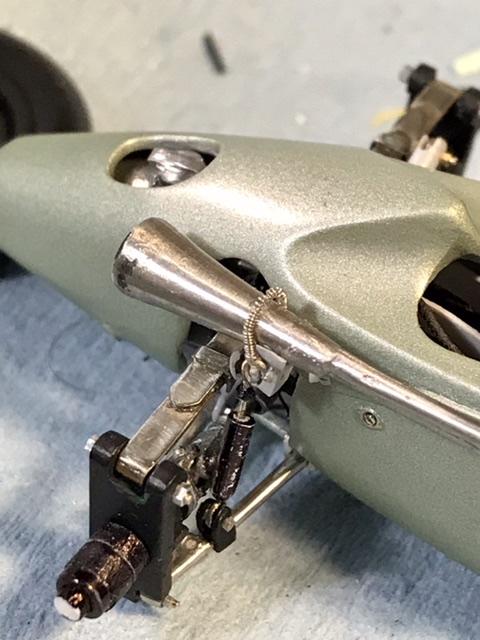

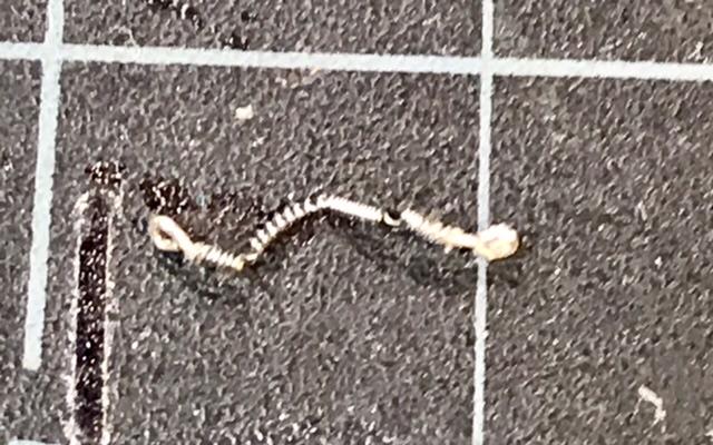

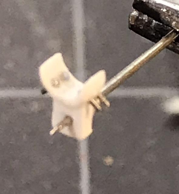

The exhaust pipe needs 2 spring clips. I made two with some steel wire - .005 - wrapped / wound around some .012 brass and glued in some eyelets that the train modelers use ...  I ruined onE of the two - making them wasn’t too bad - installing them - now that where the problems started ...
Share this post
Link to post
So the first spring clip was attached. -  but there wasn’t enough room to get the second one attached. -  I’ll probably make a clip without the eyelets and glue it next to the first one -  scale casualty ...

Do you ave a carburetor for that thing?  "notice anything missing in the engine bay?"

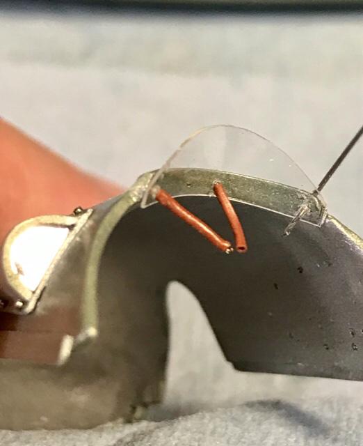

BANG    The carb is missing - but not for long ...

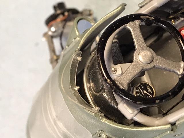

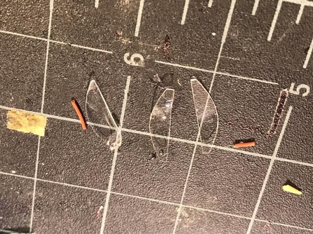

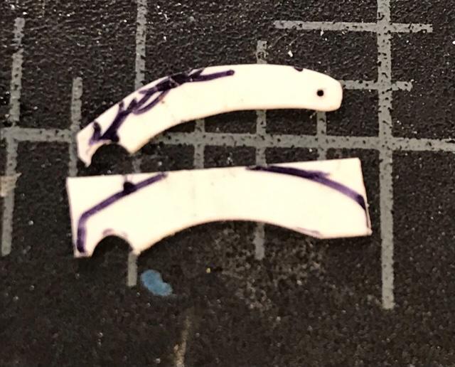

In the mean  time - I’ve cut and attached the windscreen with some TMM Hardware - they make some nice slot head screws - and some RB Motion nuts.  The kit windscreen is long gone - so I cut some thin clear plastic - got the shape right on the fourth try -
Share this post
Link to post
When at first it don't look good do it again.  If only they would come out right the first time.  I'll have to check out the TMM line, good micro hardware is hard to find.
