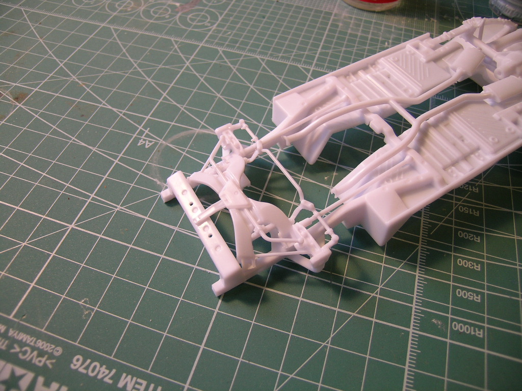

I have no earthly idea what Revell was thinking when they did the suspension here, as some of the connecting items, connect to nothing at all, at least as far as I can tell.
Also, what would be the recommended paints to use for the two Argent silvers, the one for the shaker and the one for the grille? I'm guessing that two different shades of metalizer will do the trick, but any advice would be welcomed.

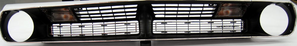

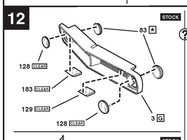

So, it appears that the lights inboard of the headlights are both amber? Revell provides clear, flat lenses (part numbers 129 & 183), but no appearance of bulbs, nor any indication of color, so I'd like to fake these in somehow.

Kevin, you can just put a dab of Tamiya Clear Amber on the inside of those parking lenses to get the effect you want. I've not seen those lenses in Amber, just the bulb flashing behind it was.
Share this post
Link to post
yup, looks like a clear lens to me...with an amber 1157 bulb behind it.
I know Tamiya used to make a really nice clear amber paint.
Drilling a small pilot hole in the back side of the lens and filling it with some amber paint just might duplicate of the look of the real thing (try this on clear sprue before taking a chance on ruining the kit lenses)

Always a clear lens with a amber bulb on the backside

in 1-25 scale it would be just a speck on the backside

Thanks for the great inputs, fellas. I had intended to drill a tiny hole for the bulb, and fill it with color, just wasn't sure if they were amber or not. I have both Tamiya and Gunze clear yellow, so I'll use one of those.

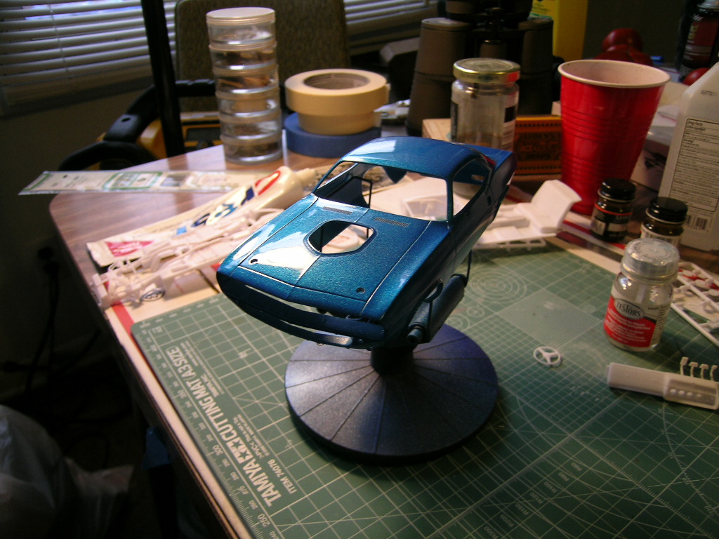

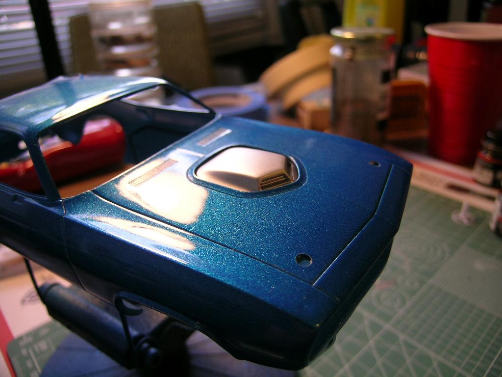

I had avoided polishing the hood so far, as I'd assumed I was going to paint it black, but now that I've decided to stay with the blue, it got some attention today. Still some orange peel here and there, but I'll keep working it.

If you're going for a factory look, a little orange peel is actually desirable. Better a little orange peel than burning through and having to strip and repaint!

That's something that I'm terrified of, and manage to still do it all the time.

Actually, there are several areas that have now seen the paint sanded/polished through to the primer, but when I'm 100% finished polishing (another couple of days), I'll just touch-up those areas with the airbrush, and re-polish. I did this on my Challenger body, and it worked out fine.
