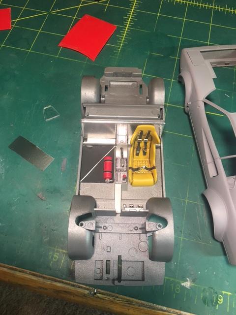

Hi,
Lotta work although it may not look like it;
- Added 1.5mm to rear fenders
- Cut open rear engine cover
- Sanded the many mold/seem lines that appeared after a few coats of primer
- Added front oil cooler opening
- Added front and side skirts
- Refurbished a Revell 308 engine
- Covered head light and louvered front sections
I've pretty much settled on HRM Ferrari comp wheels/tires.
I also drilled out an extra exhaust hole as there was only one.
Edited by aurfalien

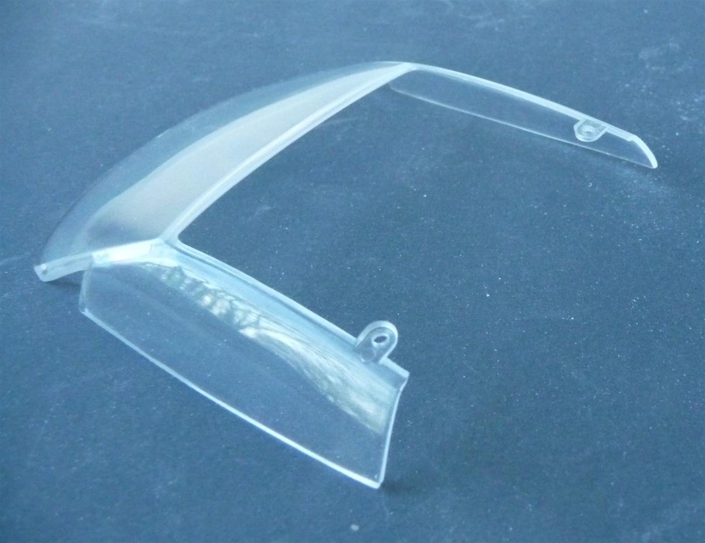

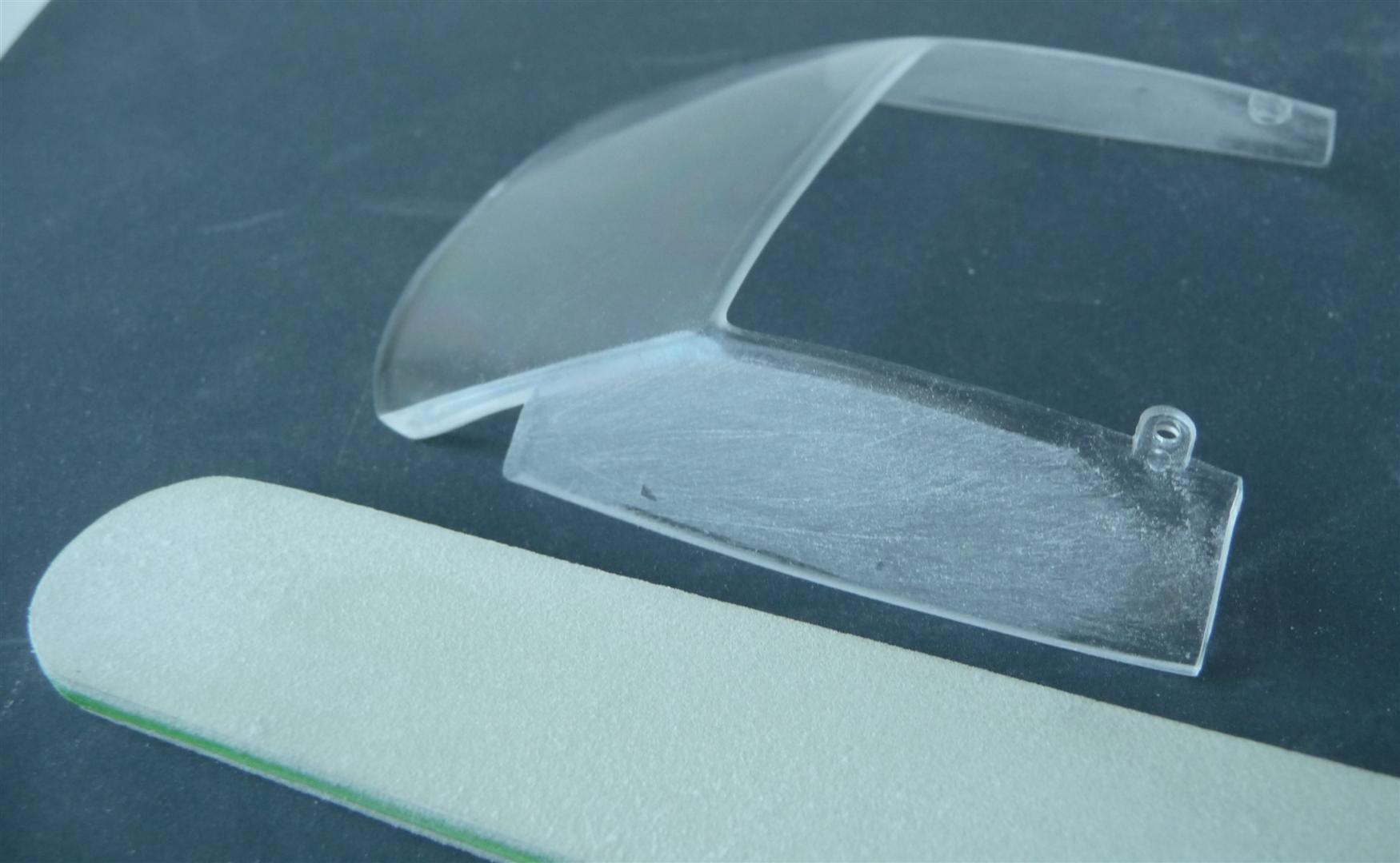

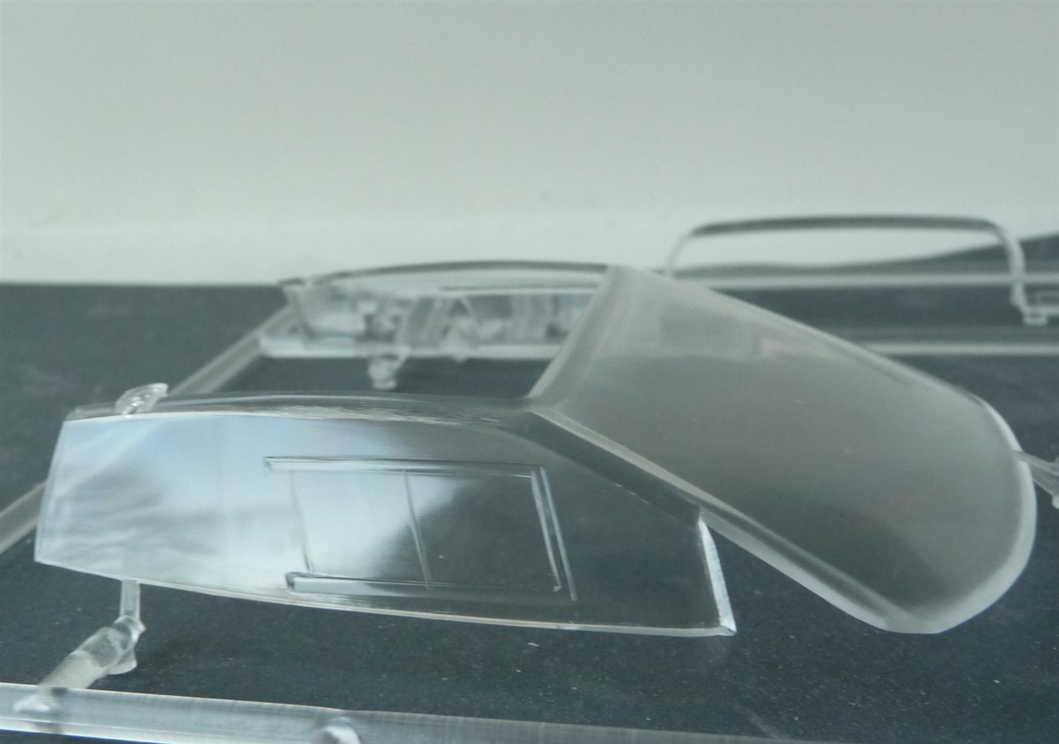

I love this project! That windshield can be fixed with very fine sandpaper and Novus polishing compound. Here is an example. I built a road going Testarossa but the kit supplied windows had a slider, which I sanded off then polished clear.

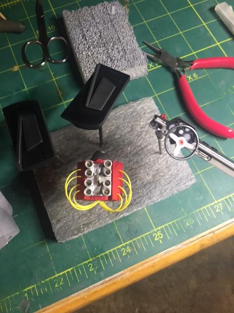

Hi,
Eh screw it, I made some ok pics now.
Few things, I decided to save the engine for another build having an open trunk being a 308 Koenig.  Its far too pretty of an engine to mostly hide.
So I made my own top half only including using a center punch to flare out some tubing I cut.  I also made little center venturis for the carbs.
It will be obscured by the aluminum mesh you see pictured.
I swapped the seat from spare parts of a Fujimi F40.  I also added some aluminum tape to reflect some interior fromage.
So far so good.  Once I'm done with this, I'm going to dedicate the rest of the year for tribute build to my dear friend CrazyEd.  But I simply MUST finish this Ferrari first.

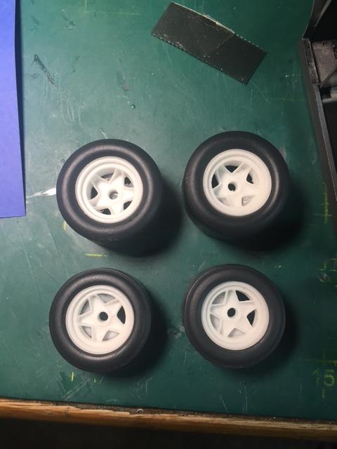

Hi,
Ok I've spent many hours of surface prep getting it to a nice smooth sheen.
I used Archer decals to simulate vents where the head lights went.
After much testing on plastic spoons, I've chosen Tamiya flat red thinned with there lacquer as it looks and feels fab!
Will apply tomorrow so wish me luck as I've stripped this body 4 times already and after much practice, I'm ready for the the prize fight.
I've stripped the wheels 3 times and destroyed a set of Harolds beauties in the process :(
But here they are, using Vallejo Liquid Gold thinned and airbrushed using Tamiya lacquer.  It will not brush due to how bad a shape it's in.
The pot is like syrup and Vallejo was supposed to send me a free replacement as they said it was old and bad when I bought it.  But I made it work.
Edited by aurfalien
