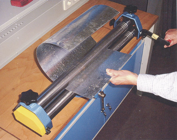

There are two ways to roll soldering wire:
  • You can improvise an inexpensive rolling device usable for rather thin soldering wire by fixing a small, hard wheel (hard plastic or metal, available at hardware/house improvement stores) under a piece of wood. With the weight of your body roll over the soldering wire on a hard and smooth surface and you get a thin, bright, very flexible strip of metal that can be glued easily with super glue.
  • Rolled wires of any kind, i. e. also thicker soldering wire, brass, aluminum and copper wire, so-called silver wire, even hypodermic needles, are extremely useful for numberless purposes when detailing, converting and scratch building. I used them on virtually all models during the past 20 years. For making such rolled wires of exact thicknesses/widths the fast and easy way I made one of the best investments of my modeling life: a bending machine. Bending machines are actually meant for making equal, kink-free curves in sheet and strip stock. Usually they look similar to this one:
Rundbiegemaschine.thumb.jpg.240254e6a4fa
When I bought mine I was not sure if the considerable amount of money would pay off. It really did.
