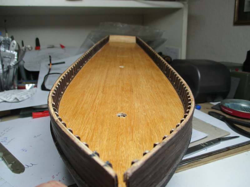

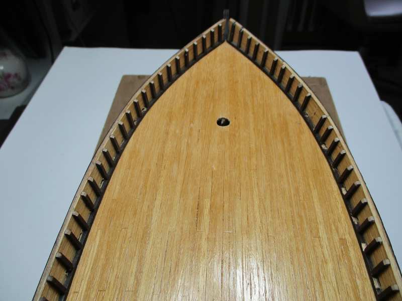

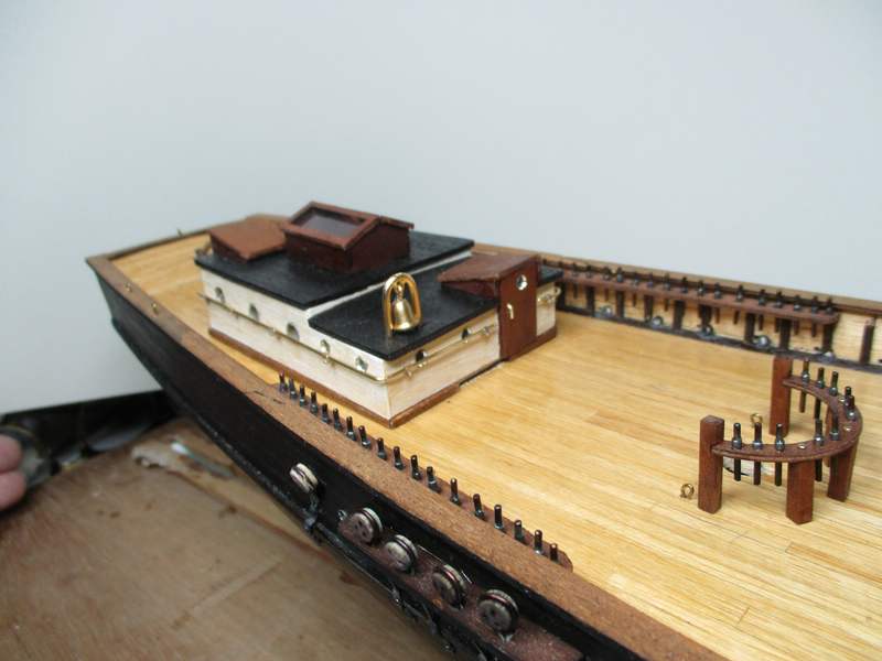

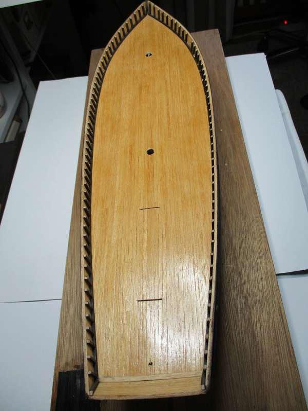

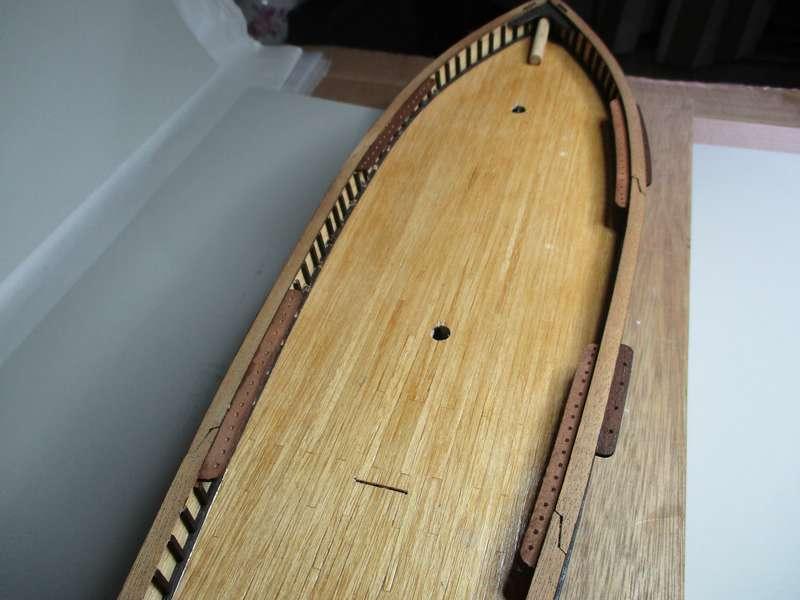

Here a few shots of the finished deck planking.  This is a Japanese wood, I think it's called Kyta or similar.  The width is a little small, but that's OK.  What I wanted was the color and shade, a nice contrast to the black, and the grain is really a winner;
-IMG_1601.thumb.jpg.f994526570a94f2f6490
-IMG_1605.thumb.jpg.3677dd340de13c997b7b
-IMG_1606.thumb.jpg.ce3d8a35abdcacce2a25
Actually, wooden historical model ships are my 1st love in modeling, after a long time fuel altered race cars come up.  Done those recently, it's time again for a big ole ship, a great task for the autumn and winter months coming up.
Thanks for looking, comments or questions welcome.

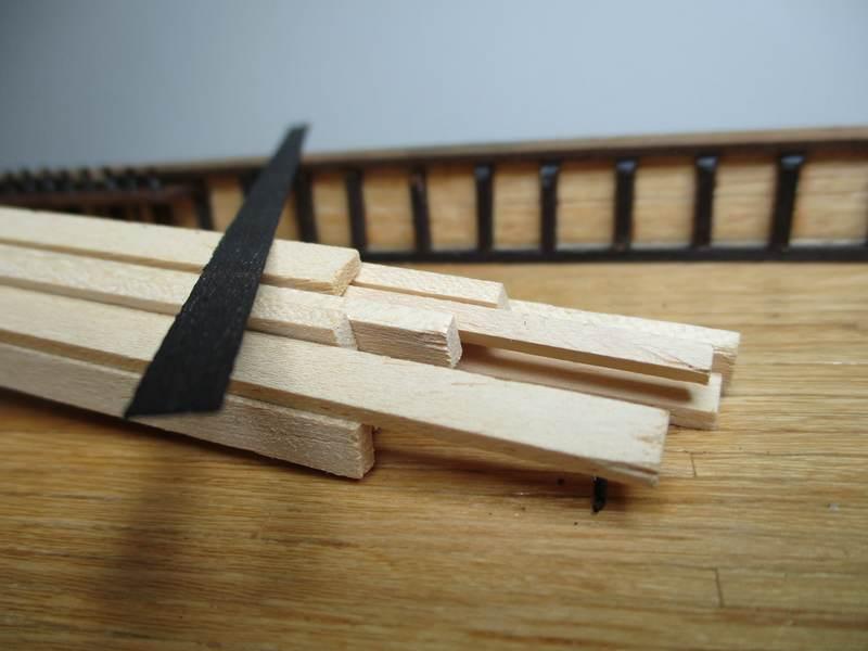

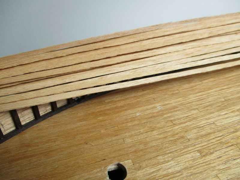

Hi Roger,  the deck planks are individual strips of wood that are cut to the proper scale length, then glued individually to the construction deck, which is a single sheet of quality plywood supplied with the kit.  You can see a bit the plywood deck at the hole prepared for the foremast.  The wood is similar to teak, yes.
Here a shot of the planking veneer strips, they're generally about  30" long in most cases.  You can see the deck finish is just these strips that have been sanded smooth then a coat or two of clear varnish;
-IMG_1704.thumb.jpg.3dc21a9b63a3ae685b38
Back in the day, the planks of wood used for ships were generally about 30' to 35' long, and were placed in a staggered layout so that the shortest plank would not be less than 5 feet long.  So you use about 4 plank lengths for the entire ship.  Lets say 30', 20', 10' and 5'.  You can see the staggered layout in the pic above, the longest planks return every four layers, or runs, of the planking plan.
I really appreciate your interest, ships aren't a big deal on this forum, and I'm surprised and pleased.  Thanks for looking.
Michael

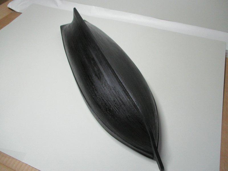

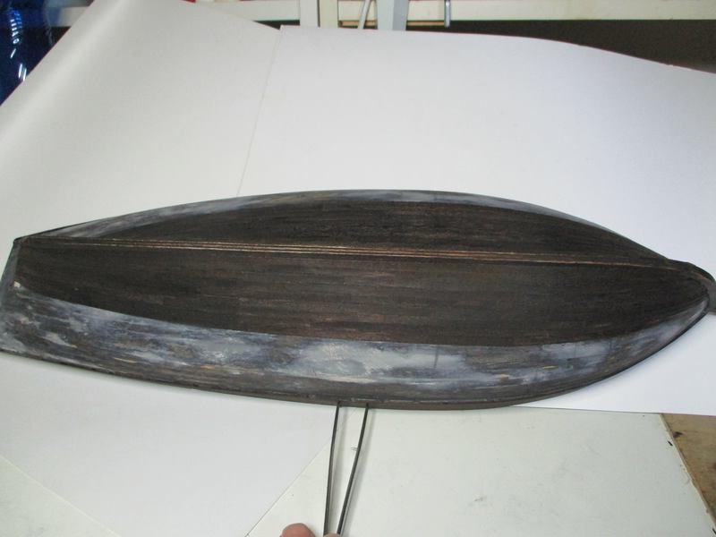

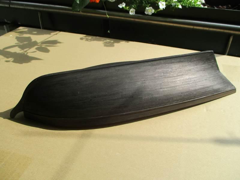

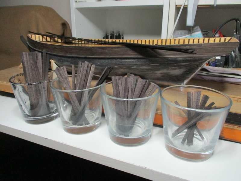

The 2nd and final hull planking is finished,  this is black stained mahogany veneer strips, 5mm wide.  The number of wood strips can be determined before you get started.  You measure at the widest part of the hull, from the keel way up on the deck.  This ship has a little more than 9cm, which rounded off makes 10cm = 20 strips of 5mm wide.  Yep.  Got it.  Up on the bow though, it's smaller.  Here the distance is a little over 6cm.  This means 2/3 of the widest area.  Now we can't make any crummy cuts, and needle ended boards.  But we can cut every single plank to 2/3 size as it moves to the front, or bow.  The boards were never cut to less than half of their width.
Done that.  It comes out exactly as measured.  20 planks at the fat hull, 20 planks at the bow.  The stern line though is a little bit longer because of the hull design.  3 'cheaters' were need to compensate for the longer area, as well as the rake.  This hull is kind of extreme.  Love it though.  These ships were the sports cars of their genre!  Fast and sleek, they ran away from the opponents of the old days.
These small and aggressive hull designs were the forerunners of the famous Tea Clippers, read Cutty Sark and all of the famous ships from the mid 1800's to the early 1900's.  American made, American design, and truly American history here guys.  Made in Baltimore.  The ships were very low in the water, the masts were tilted radically back and the ships had way more sail than ever shown before on any ship type.  Radical design, and my favorite.
So, moving on now, here a few pics of the new black hull planking.  Raw wood now, it'll be smoothed out next step.  Note the ebony wood on the top railing area.  Great stuff, and makes for a fine and slight contrast;
-IMG_1644.thumb.jpg.bb83e8b119b6ace70b6a
-IMG_1645.thumb.jpg.be12c86e90474e090c36
-IMG_1646.thumb.jpg.30858ed0fc12c559e99c
Next up will be the sanding of the hull, and adding a finishing coat to protect the finish.  This will make the wood darker.  More later.

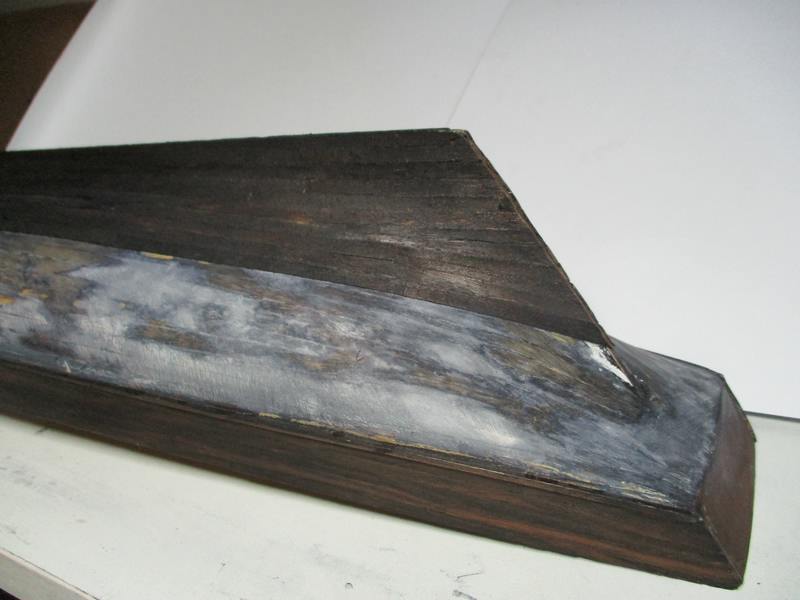

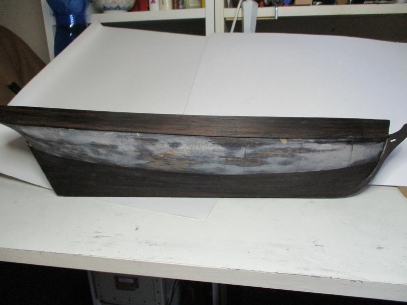

Here a look at the two planks used for the hull of a ship model.  The thicker strips shown is a softer wood, you can soak the strips in water to make any really tight bends that might be necessary.  The black strip on top is the veneer strip, regardless of the type of wood, these are generally 5mm wide, and about 0.5 thin.  Here;
-IMG_1719.thumb.jpg.4f42d530aa64031ddb62
The thicker, 1st planks are attached by either pressing small brads through the boards into the bulkheads, or just add a drop of CA while holding the plank in place.  The wood is porous and soft, so it either glues super quick with CA, or a quick drying wood glue, or nail it into place.  Either way works great.
Also, this 1st wood layer doesn't have to be laid with any great deal of patience or even perfection as it only acts as a solid and firm background for the final planking.  Once the 1st layer is on the hull, then the fun begins.
Get at with coarse sandpaper, and fill in the cracks between the planks and the dents and imperfections with a quick drying wood putty.  I like stuff in a tube, it can just be squeezed out directly onto the hull.  I'll even apply the junk to a big knife and smear it on, then with a wet finger smooth it out more.  I like acrylic based putties for this.  After maybe 10 to 20 minutes, get sanding again till the hull is smooth and without any depressions or cracks.  There are always imperfections to be filled and sanded,  Always!  Not to worry.

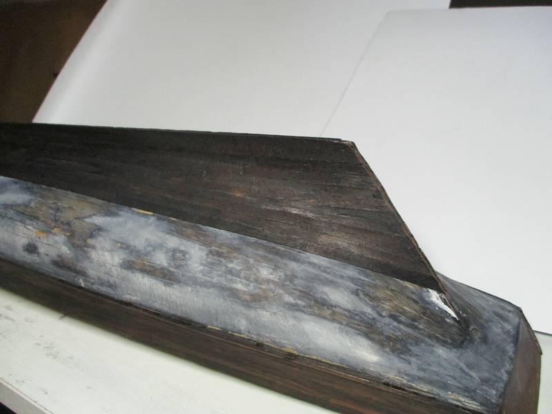

Here a look at the hull of this model, you can see the white filler.  I did practice staining already, so this the reason for the blackness. Here;
-IMG_1631.thumb.jpg.767e1baee47b464659d1
For the the final planking, lay a thin bead of wood glue along the veneer strip while holding it in your fingers, then with a finger spread it out along the whole length and width of the strip, then apply to the hull.  Since the glue has a lot of moisture, it will allow the strips to be bent slightly according to the curvature of the hull.  I like using an instrument or such to push the new plank right up against it's neighbor.  Also, keep a slightly moist cloth handy.
When the plank is pushed up and actually forcefully pressed against the adjoining strip, press the plank down onto the hull with a dull and flat instrument.  Push it on, and press it down.  Glue will bulge out everywhere,  scrape off immediately with a sharper tool (like a dull #11 scalpel).....then rub smooth with the moist rag to rid the wood of excess wood glue.  We want a wood that is free of glue rests, or else the wood will not take kindly to later staining!  Very important!

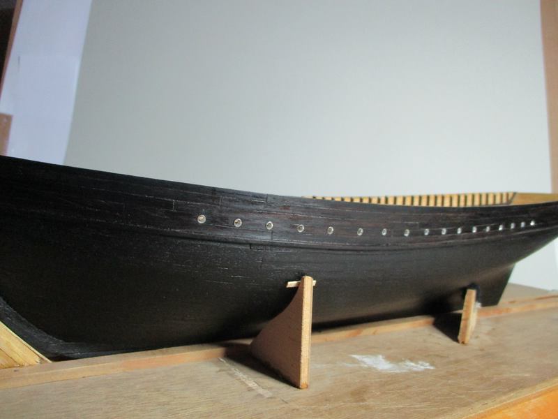

UPDATE:

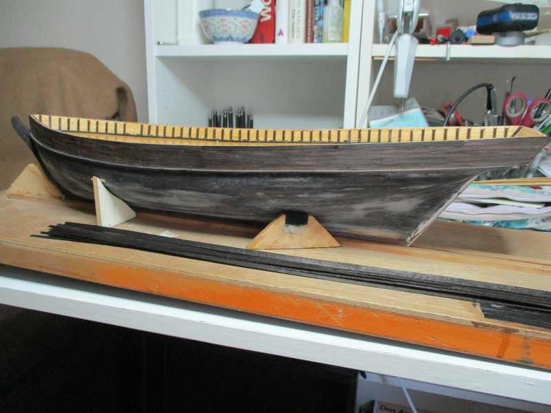

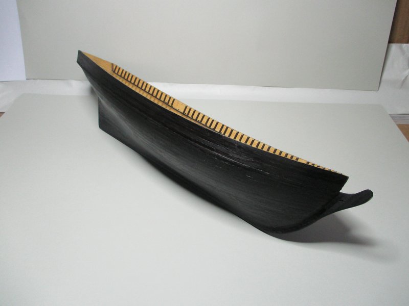

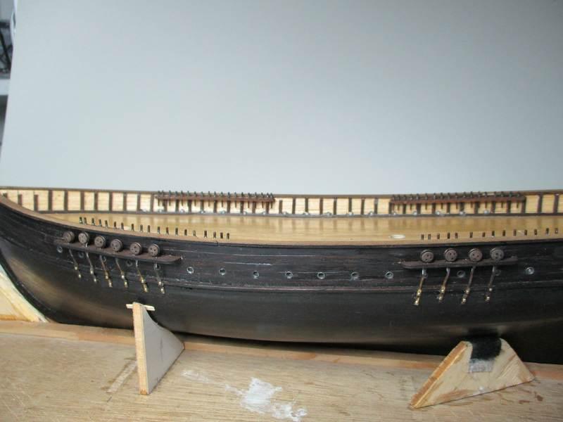

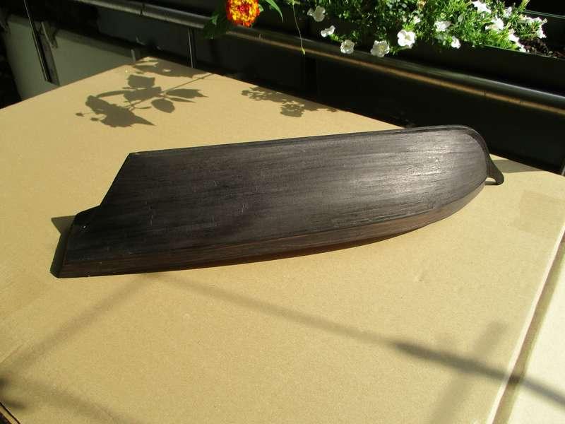

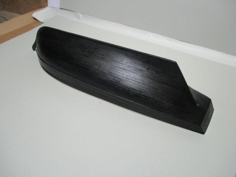

Now the hull is planked in black and sanded smooth, a final finish is needed.
The old ships that had blackened hulls had a shiny appearing finish.  Tar in the paints was the reason.  These surfaces were not smooth though, the stuff was probably more like a goop that was slabbed on with a mop of some sort, and probably appeared to be knobby and very structured.   The blackened hulls were not meant to be some kind of stealth look, but only intentioned to protect the wood from the salt water and elements.
My problem is, after several wooden ship builds, I just can't do it.  Ships with a beautiful walnut veneer planking....and slapping some thick black junk on the wood?  This hurts.
I've chosen a hard oil finish for this hull.  It will shine and be protected (hardened).  Here a few pics of the 1st oiling;
-IMG_1657.thumb.jpg.f2848b7b46695d66fec2
-IMG_1658.thumb.jpg.613239fe390d331294f8
-IMG_1659.thumb.jpg.ab494aed94097992f771
The surface is not quite dry yet, somewhat tacky.  Unfortunately the weather here is warm and very humid.  Not good for curing, this will take a good day or two.
What I like is the degree of blackness, and that the wood grain is clearly visible.
More coming up.

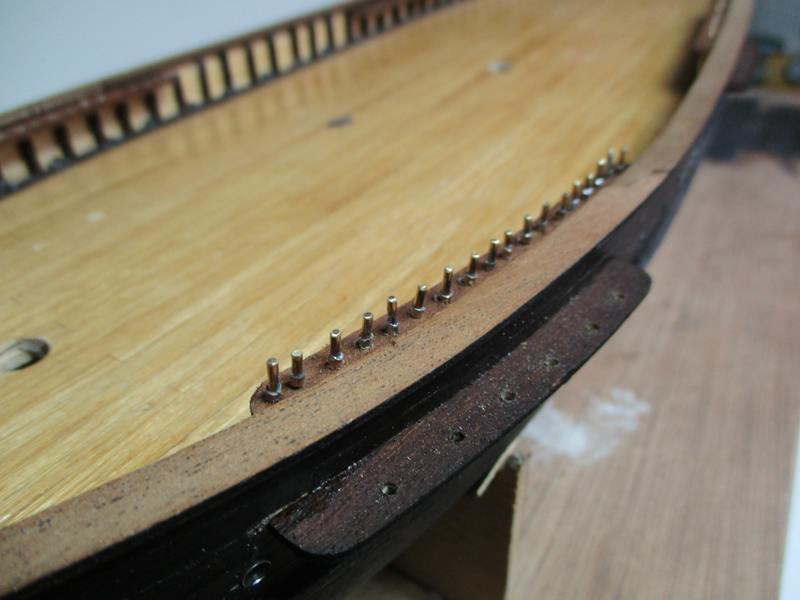

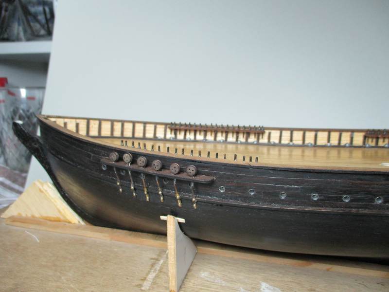

UPDATE:
Hi Roger, this is the easy part and goes fairly quick.
The hull needed another coat of oil and after it dried completely out it lost it's shininess, which is good.

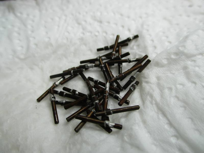

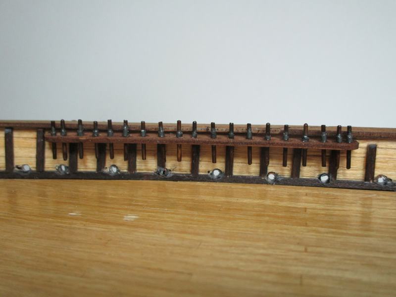

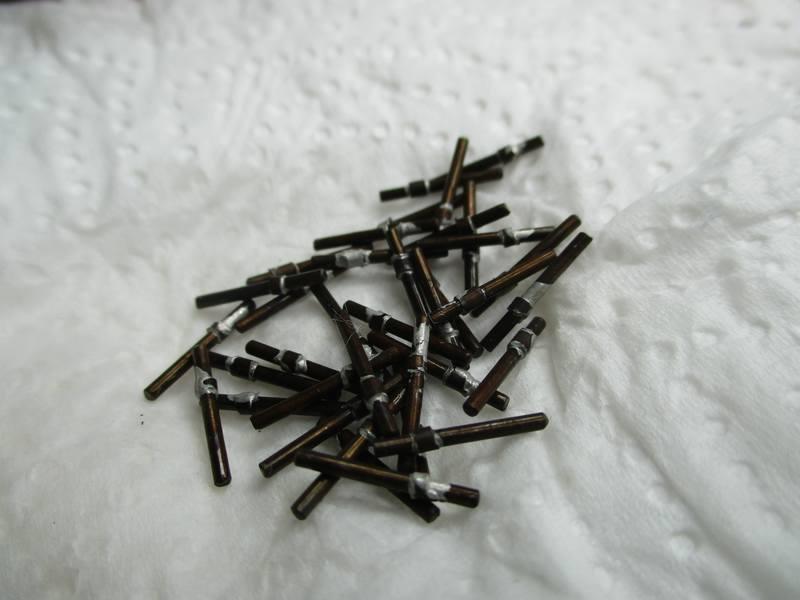

Moving on to the deck, I made a mistake with the belaying pins.  The ones from the kit are brass, and too short, plus there's a seam on both sides that would have to be removed.  So I ordered new ones out of wood, but they're too short too and too thick.  So, I made new pins.  Just the holes in the racks are too big and the new pins would fall through.
I decided to solder on a small collar so the pins won't fall through the holes in the racks.  Then then the pins had to be blackened some how.
First off a look at the hull, with scuppers added to the bulwarks.  On real ships, these outlets allow the water flooded onto the deck to drain back off.  Here's a look at things;
-IMG_1676.thumb.jpg.db4e947f5e34ecbc0aa9
I like the wood contrast between the ebony and the blackened mahogany.  The ebony will be dulled somewhat by wiping down with 0000 steel wool.

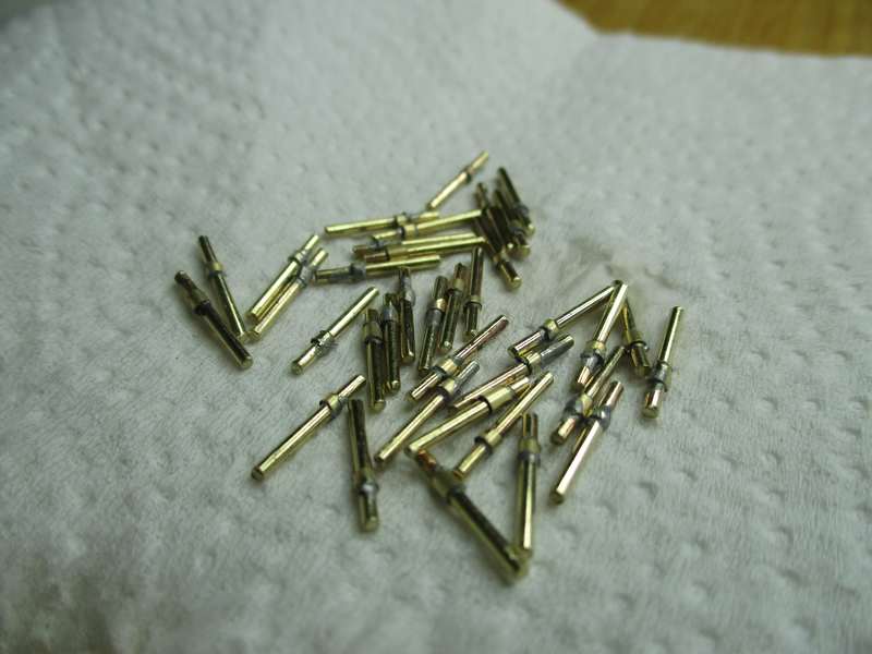

Here the pins from 1mm brass rod, with a collar of 1.4mm brass tube soldered on.  These pins will allowing tying off the sail rigging later on;
-IMG_1692.thumb.jpg.e67b21e663c669b64bab
Here a look at a couple mounted;
-IMG_1685.thumb.jpg.4f0e947df2a9dee775ec
This is the 1st batch.  There at last count 106 pins to be mounted on the deck.  Ugh!

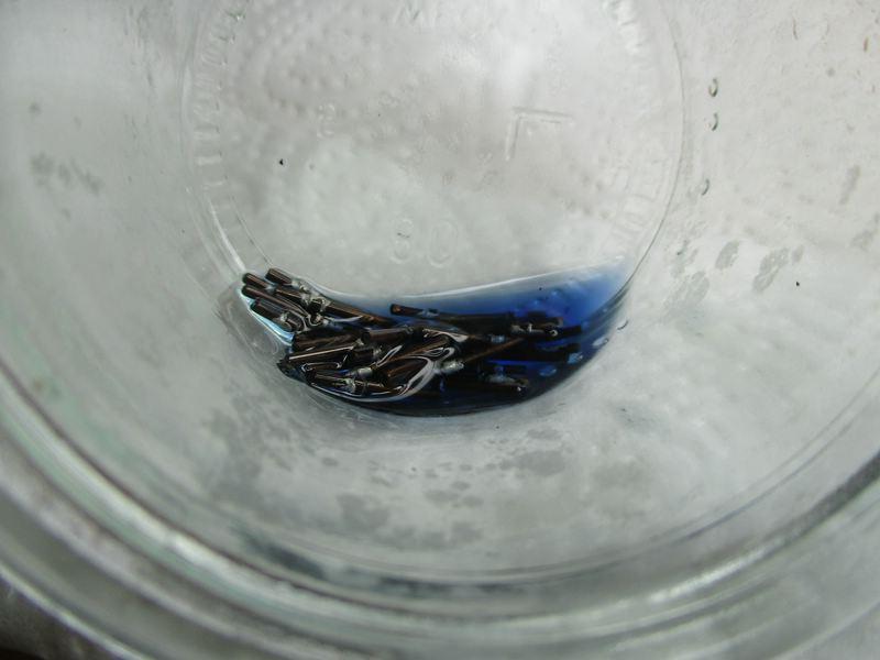

Here a blackening solution for brass, after about 30 minutes they became dark enough, just the solder was not affected;
-IMG_1697.thumb.jpg.92bce1cda6197cc55962
Done for now, I'll add some metalizer paint to the solder on the collars.  Later on they'll be covered with ropes, so they should be OK;
-IMG_1702.thumb.jpg.b75197148740b74b8f39
Here the pins attached to one rack on the deck, cemented on with Zap-a-Gap;
-IMG_1710.thumb.jpg.268d88bc6dd9a1ea8f8d
This way the pins are long enough to be able to wrap thread around them, and far enough apart to not go crazy doing it.
The fun of a wooden sailing ship has begun, but already some headaches on the horizon.  When the rigging starts,  my nerves have to be in good shape.  106 pins.
Thanks for looking,  more to come.

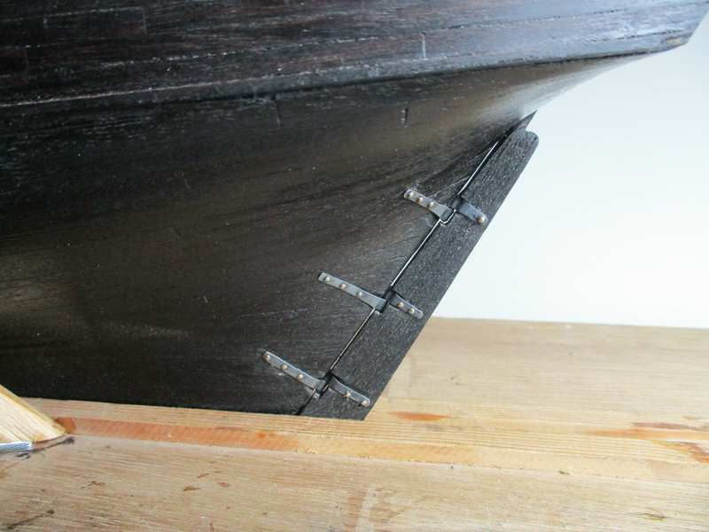

UPDATE:

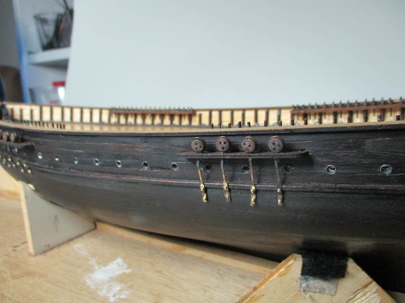

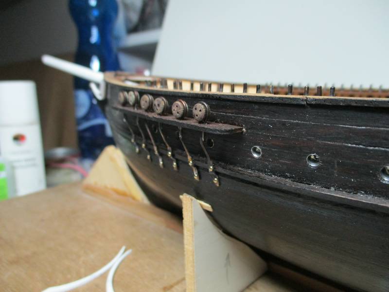

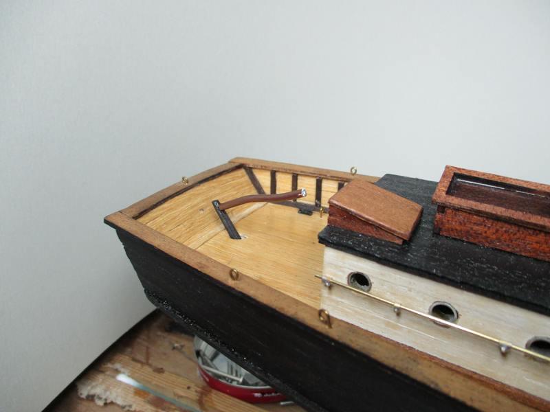

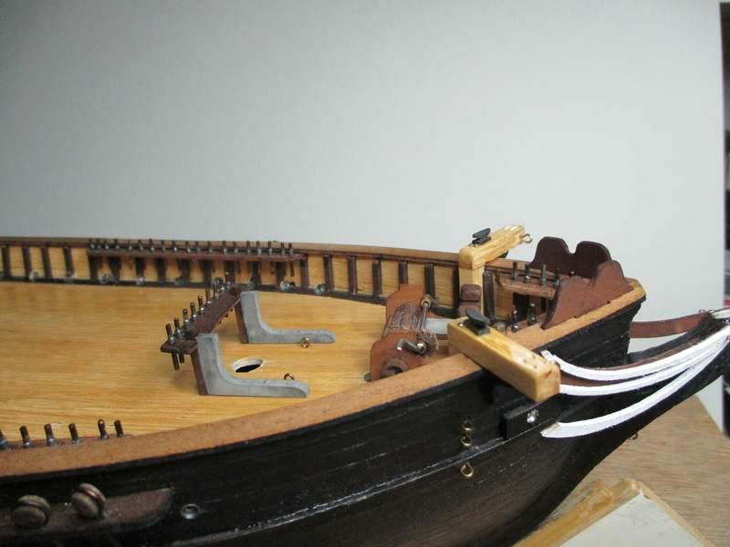

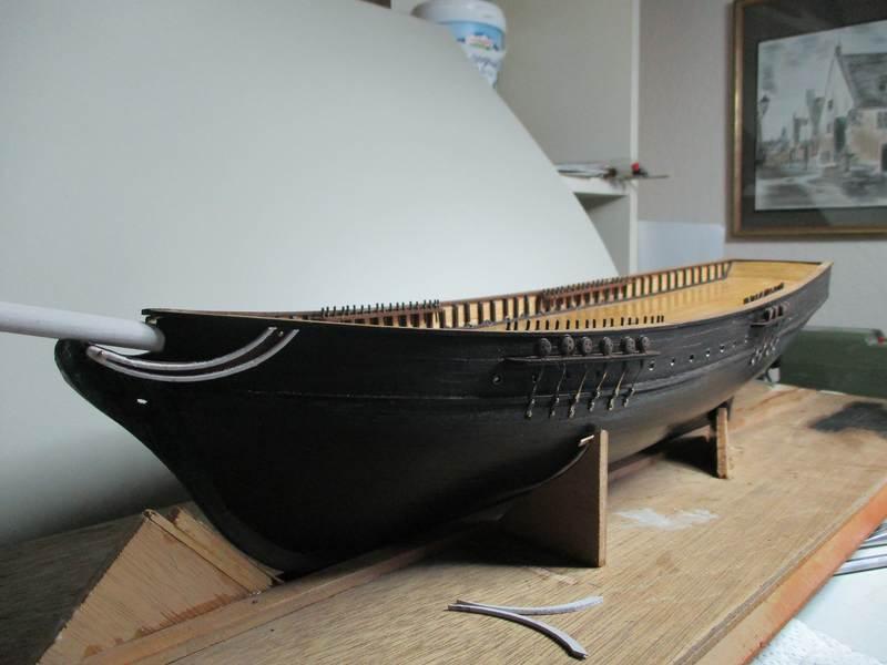

Further on with the rigging hardware now and a little work on the bow.  The racks on the sides of the bow are holding the 'dead eyes', wooden blocks that will be a major support of the masts to maintain lateral integrity.  These will be the support for the 'ratlines' ladders that let the crew climb up into the masts and yards to attend the sails.
-IMG_1706.thumb.jpg.88a5828e774ff632fe00
-IMG_1707.thumb.jpg.e88e25e753e82a4fd07a
-IMG_1709.thumb.jpg.2d9e7212f219a3939952

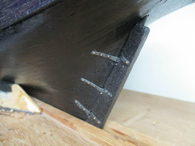

Here the beginnings of a little decoration on the bow.  I kind of like black hulls of this period, with white trim.  Like the 'Constitution', that has also white lower masts.  I don't think I'll go this far with the white trim, as this type of ship was not a major player, just a newcomer, a fast merchant vessel, made for speed and profit.
-IMG_1717.thumb.jpg.8423c890dd3e3e696392
-IMG_1716.thumb.jpg.4716e5a6f27b873b0021
The white wood was stained with liquid white shoe polish, about 3 applications and the wood is white as snow.  Dries fast too.

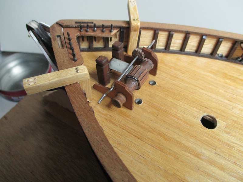

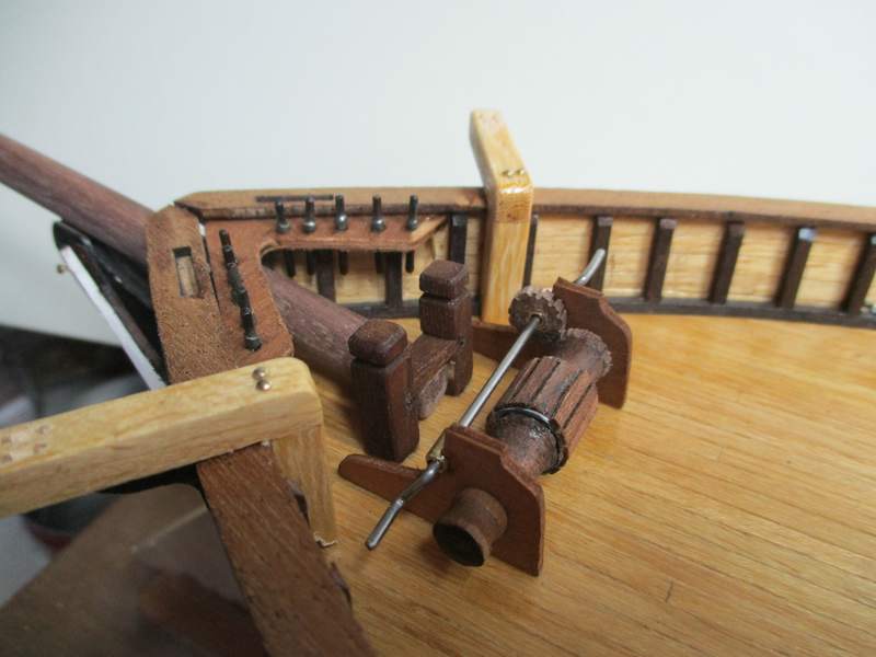

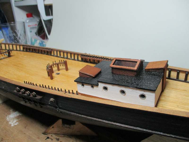

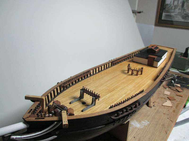

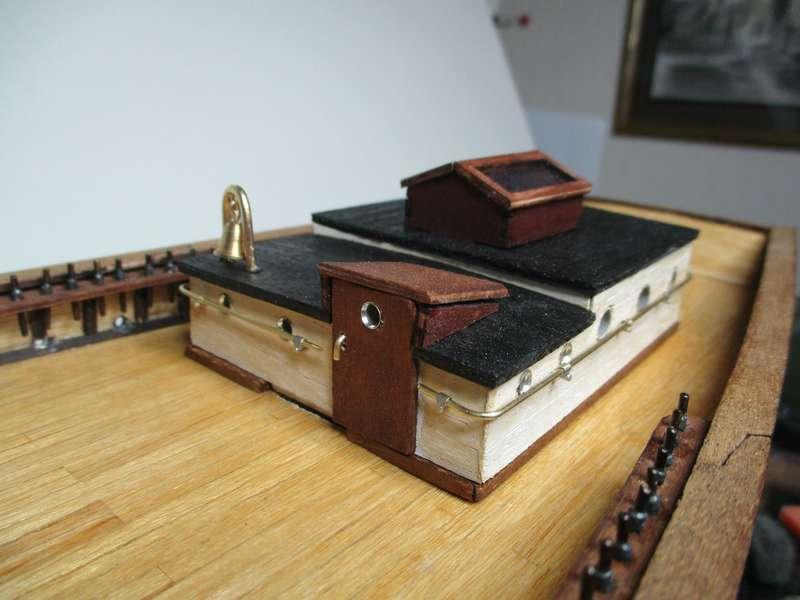

UDPATE:

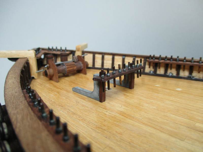

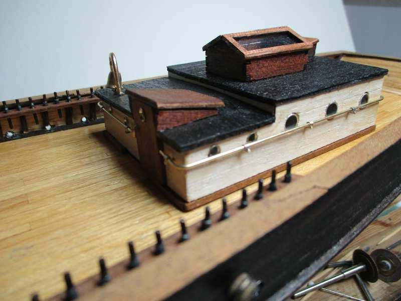

Meantime, this is starting to get a working deck, lots done now.
The brass has been blackened /grayed, here a scratch built winch for the anchors and heavy lines of the masts and used also for raising the big yards when the ship was in port.  The yardarms were also lowered when a sailing ship was in port for a longer period.
-IMG_1740.thumb.jpg.7958ee23f863e8c74481
-IMG_1748.thumb.jpg.2281c4f123f2b925a6ee
Another rack for the belaying pins.  I think I have them all now, 106 for the deck alone;
-IMG_1744.thumb.jpg.7ce272fcd0cdedf7058c

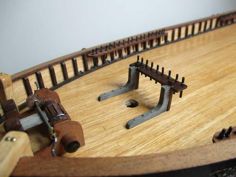

-IMG_1746.thumb.jpg.febb0d15379303dc377a
Here the last rack, plus the deckhouse.  Deckhouse has been bashed, it doesn't look like this in the kit.  The white will be yellowed somewhat, it looks too clean and the cabin gets a handrail today;
-IMG_1751.thumb.jpg.8645a1a6234889f36cda
-IMG_1752.thumb.jpg.76b4c32ed94afedb8cb2
-IMG_1753.thumb.jpg.15e99626d4a95f728516
The build is progressing well, I'm happy with it.  Still no plans though for the masts and yards though, they were missing in the kit.  I've contacted Occre in Spain, still no reply.
Plans are not really needed, I have books that describe how the masts were built, just the plans are consolidated and I wouldn't have to look up every single part.  There are lots of parts and individual hardware for the yards!  I want the sails too work on this model.
Thanks for looking.

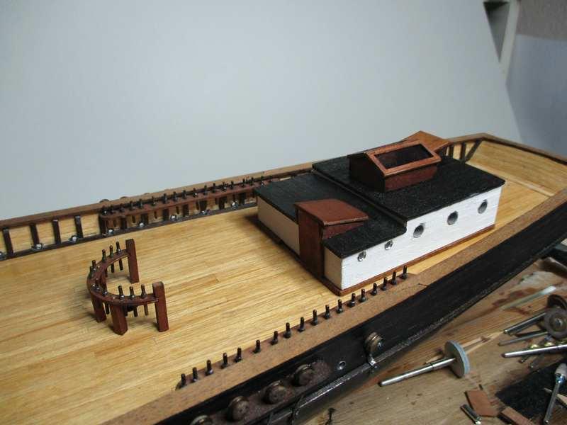

UPDATE:
The deckhouse is finished, just different than the kit.  Dimensions are the same, it's big, but there's nothing I wanted to add to the deck to use the extra space.  Added some ports and a brass handrail and dirtied up the white stained walls;
-IMG_1754.thumb.jpg.b24ba05af16a5238112a
-IMG_1755.thumb.jpg.8e822bf045f7e80913be
-IMG_1761.thumb.jpg.d75f0abb19d8445dfb2d

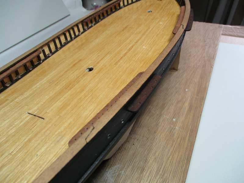

The ship has a rudder now, I prefer a wheel as they look nice on a model, but this type of ship used a rudder bar.  The cleats and rings have been attached to the deck for the blocks and tackle to handle the steering;
-IMG_1762.thumb.jpg.758e9f9c6e69be72fc88
The rudder has been attached using the kit hardware, brass strips.  These were thinned down to lessen the bulky look, and then chemically blackened.  Not dark enough, so I added some Humbrol black/gray metalizer paint and buffed the parts out.  I'll probably leave the brass brads as they make for a tiny bit of optical contrast.  Not shiny or 'brassy' looking, just a slight break;
-IMG_1764.thumb.jpg.9956050ef0e51849047d
-IMG_1767.thumb.jpg.d4f3bd42bb27af5e254e
Last up for now, the bow is done and ready for the bowsprit and rigging;
-IMG_1763.thumb.jpg.060143116b01bf10d798
I had some construction sheets blown up to 1:1 scale to the model ship, done by a printer shop.  The paper sheets are 28" x 40", I'll attach them to a strong sheet of poster paper and hang them on the wall at the bench.  This way I can hold the individual mast and yardarms directly to the paper to make sure the scale is right.  The rigging starts getting fairly involved and actually, a complete mess of lines and blocks.  This will be a major modeling situation as I'd really like to make this close to the real thing.
Next up are covers for the deck entry to the holds, maybe a dingy mounted as well.
