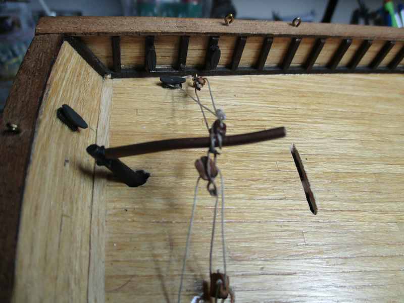

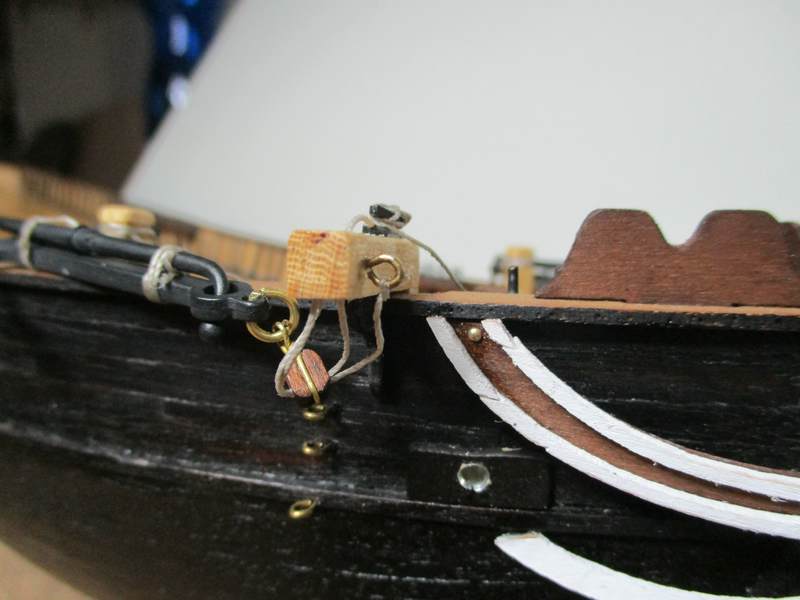

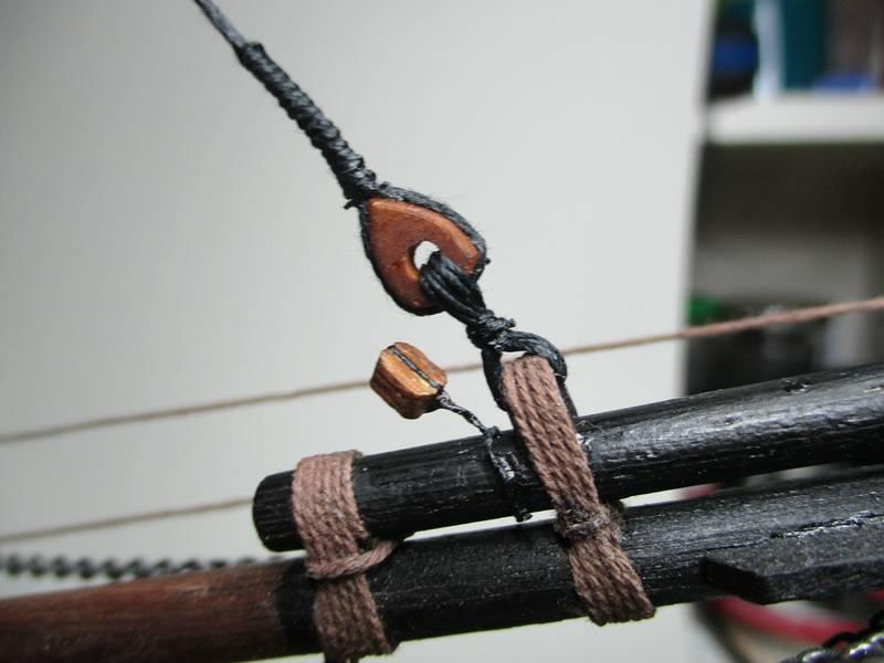

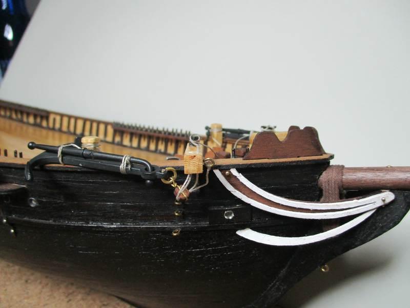

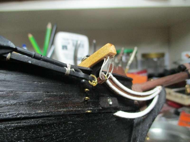

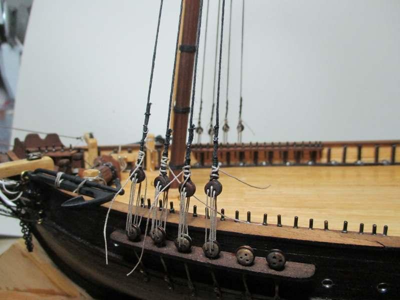

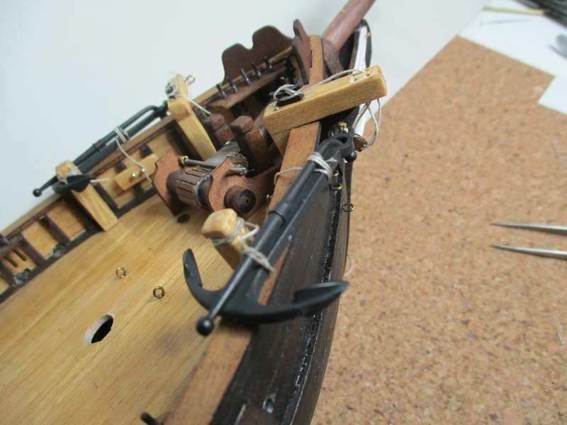

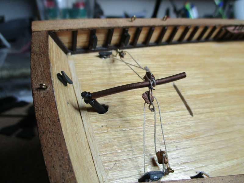

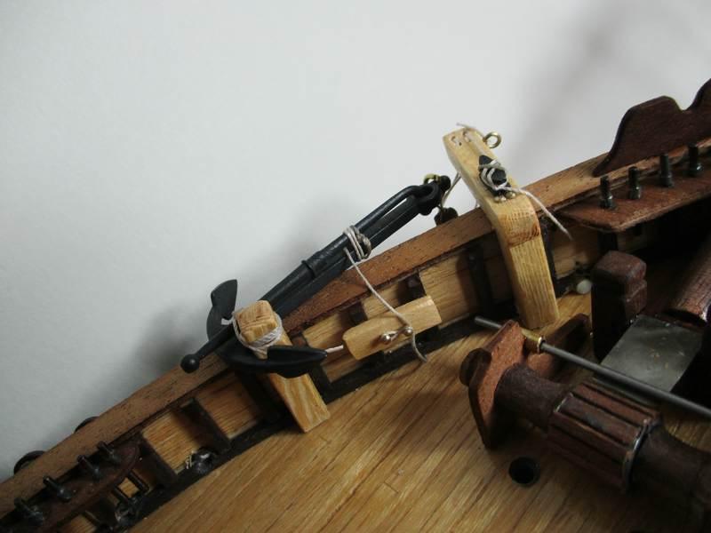

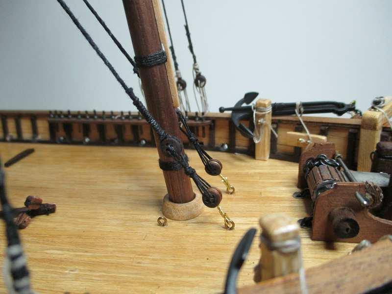

UPDATE, new pics:
Today I started the rigging.  There are lots of blocks to do, a hundred or more, here are just a few.  I completely forgot how to do these silly things, it's been years.  The 1st four, back at the rudder, took me hours.  Not good.  A way had to be found to do this on more of an 'assembly line' method.
The few shown here are a little sloppy, up at the bow, at the anchors are a little better.  These are weak, the lines going through the blocks are too rounded, they should show more tension, and the knots are shoddy looking.  This procedure is called "stropping the blocks".  The blocks are single wood pieces, but already have holes and the groove in/on them.  Usually in a kit like this there'll be single and double blocks, and a couple of triples for the masts and the real heavy gear.  Here a peek at some singles;
-IMG_1781.thumb.jpg.9d1b6648ef3004223a4b
-IMG_1782.thumb.jpg.366701402ea5b9e72a88
Glad the beginning is over, it took hours and I had the shakes.  A small jig to be used as a third hand was made, and things went smoother.  Still room for improvement though.  The bow is kind of a busy place, so the blocks for the anchors will not really stand out.  Here the anchors lashed;
-IMG_1775.thumb.jpg.39cebd190867ed4a4442
-IMG_1776.thumb.jpg.1cb702349efe67c61ee9
-IMG_1777.thumb.jpg.51e7d865f5376fed52b2
-IMG_1778.thumb.jpg.5b22bc04659183b55855
-IMG_1783.thumb.jpg.6c6339336820c52b5346

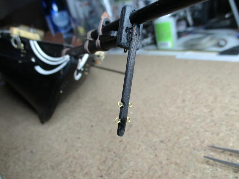

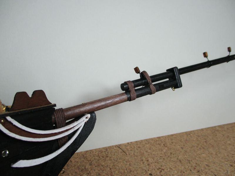

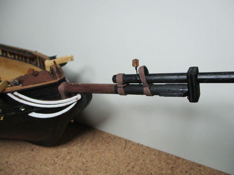

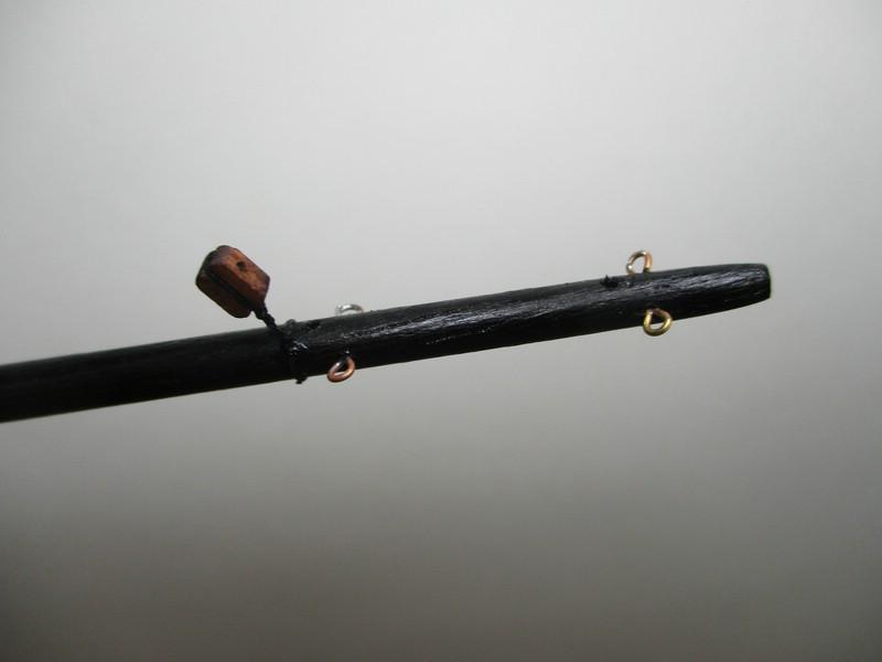

The bowsprit is also done.  The various brass round eyes are different than what the kit calls for, they suggest just drilling holes through the wood and run a heavy thread through there from one side to the other.  That sucks, so I made brass eyes, no rigging lines running through the wood without any hardware support.  A few pics;
-IMG_1768.thumb.jpg.098549c0763398b7d6d3
-IMG_1771.thumb.jpg.9fa6247a962a685dc3ce
Here is where the kit says to just run the rigging lines through a hole.  So I made a hole, but bent some brass wire to make two eyes for the heavy lines and chains later on;
-IMG_1773.thumb.jpg.3a13e62b6d5e6c15b7e8
Same here for the "dolphin striker",
-IMG_1784.thumb.jpg.00574a40b0fd258495b5
As far as I can tell, next up are the masts and the further rigging.  Still haven't decided 100% on the color scheme, probably just like the bowsprit.
Some big steps coming up soon.
Thanks for looking.

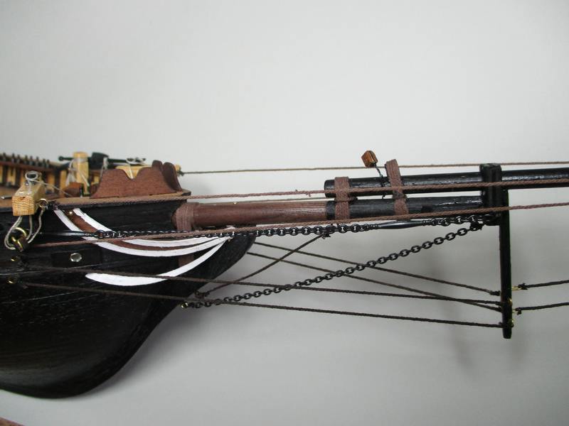

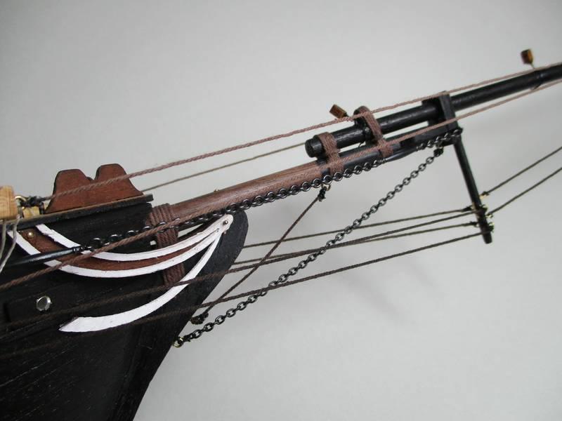

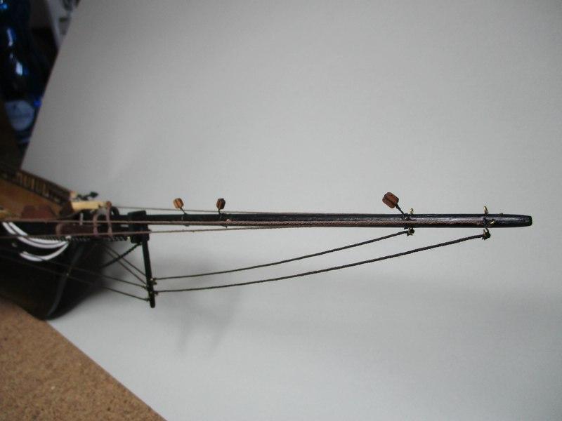

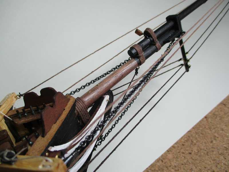

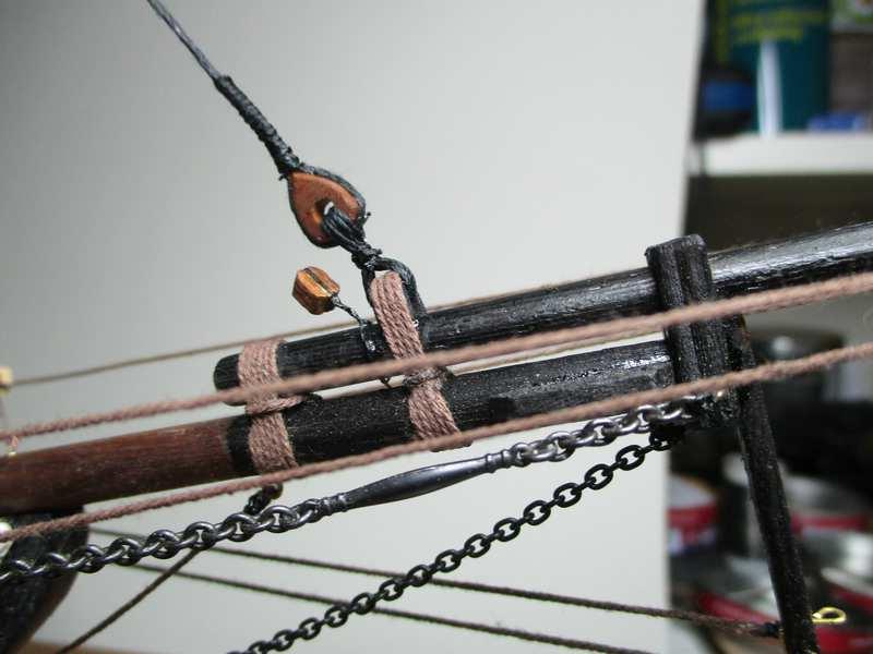

Bowsprit finished;
The rigging up front is done for now.  Later on there'll be more when the masts are mounted, then the sails.
This is the standing rigging for the bowsprit;
-IMG_1785.thumb.jpg.01d81903893222fb0cc4
-IMG_1786.thumb.jpg.e2429bb6162cc11a3178
-IMG_1787.thumb.jpg.be12cc03854f5121ca6d
-IMG_1788.thumb.jpg.b11d77e9f82cecaf054c
....on to the masts now.

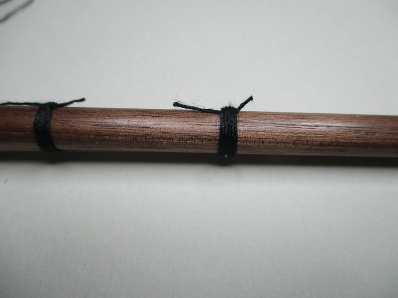

Update,new pics;

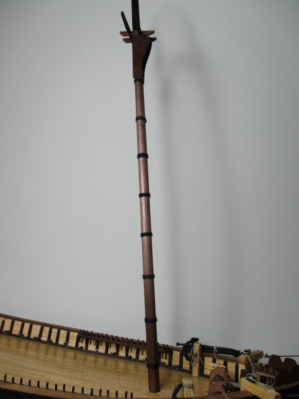

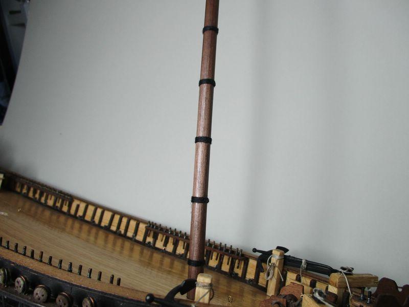

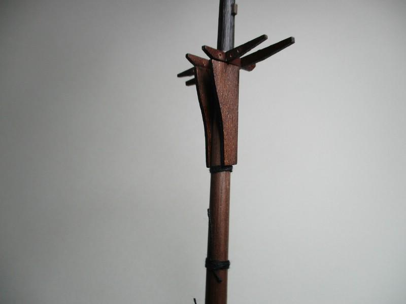

The masts are cut and tapered, stained and sealed.  Here a few pics of the front mast, lower section, preliminary rigging.
The masts back in the day were built up using at least 4 lengths of sawed and formed wood for the core,  they were not 'telephone poles' per se.  Either the separate lengths were then held together with iron hoops, or tightly taught and sealed heavy lines.  I've chosen the latter for this boat.

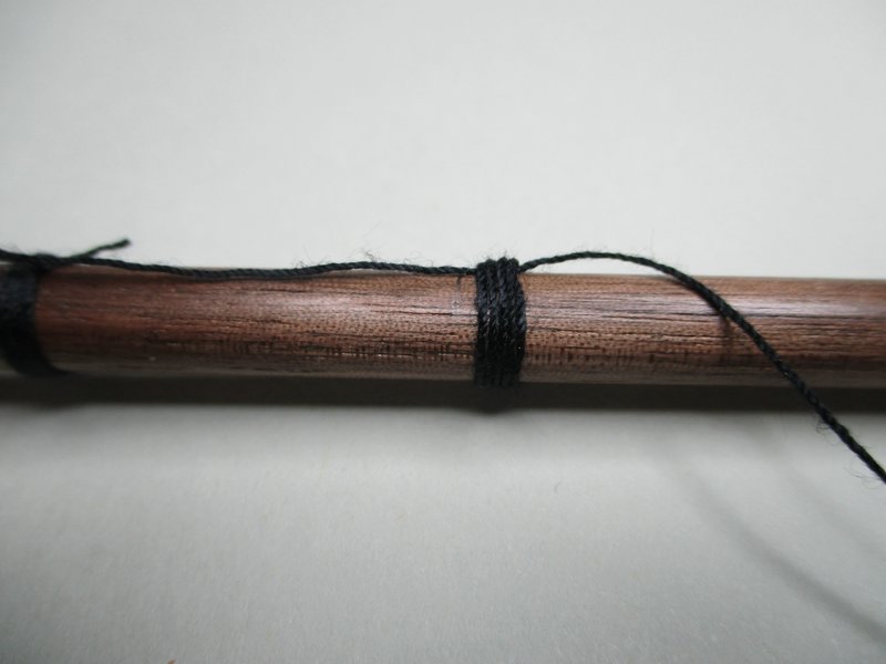

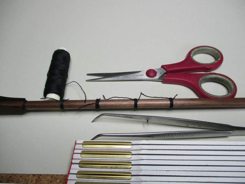

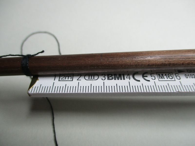

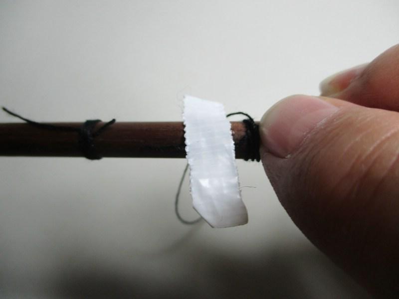

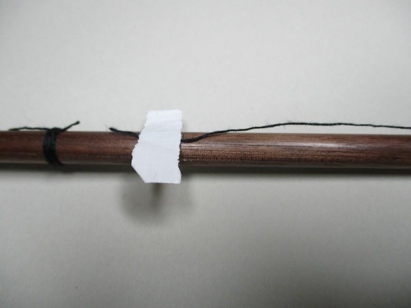

Here a slick way to make a circular holder using thread, without tying the ends with a knot.
Here the tools needed, tweezers, thread, measuring medium, scissors;
-IMG_1790.thumb.jpg.fbe14bf67ec3a2968205

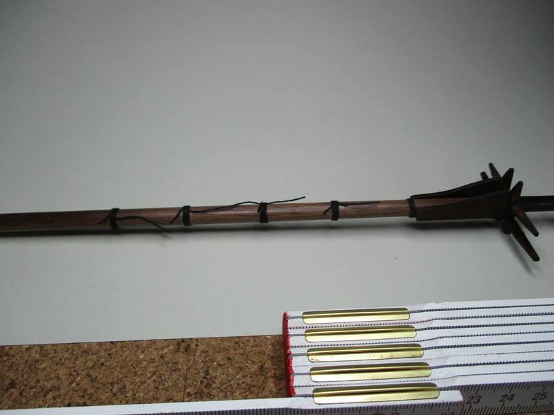

Here the lower mast section, already with a few thread rings;
-IMG_1791.thumb.jpg.03598643fa798649f502
I've chosen about an inch of space between the rings, more space than scale, but I think this is enough without letting it look cluttered up and busy;
-IMG_1792.thumb.jpg.b6d1d94ffed06257926b
Here a thread cut to length, a decent amount to make working a comfortable experience;
-IMG_1794.thumb.jpg.c40a551fcd7b1a43dd08
The thread is laid right along the 3cm line marked with a pencil;
-IMG_1795.thumb.jpg.a2f4628d6d2ac131fa60

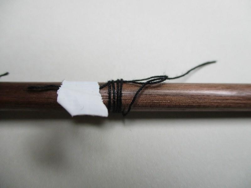

With a small piece of tape, one end of the thread is held in place at the marked line;
-IMG_1796.thumb.jpg.357de3cd6c7aa94b75e8

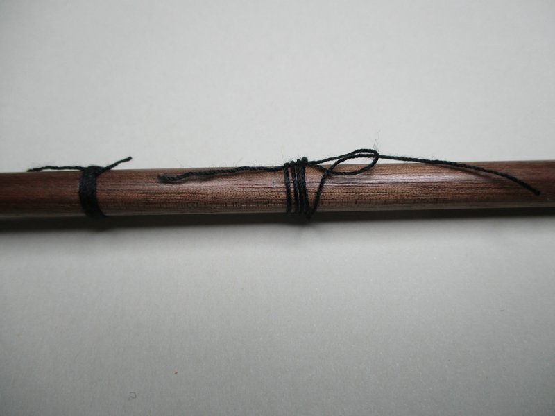

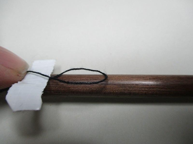

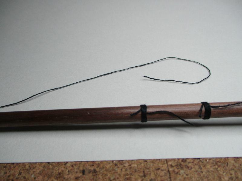

Make a loop far enough away from the beginning point to allow for some working room;
-IMG_1798.thumb.jpg.af6ef5d79d66a7ff1052
Right index finger (somewhat dirty from wood staining, sorry) placed directly on the loop, then the thread wrapped around 5 times with the left hand;
-IMG_1800.thumb.jpg.1c549b23ccf81da1a16b
5 times, then the end is fed through the loop;
-IMG_1801.thumb.jpg.afc210bfeb4ad6c3de8b
Tape is off.  Thread is loose, not for long....;
-IMG_1802.thumb.jpg.edc2784abebe239df6d2

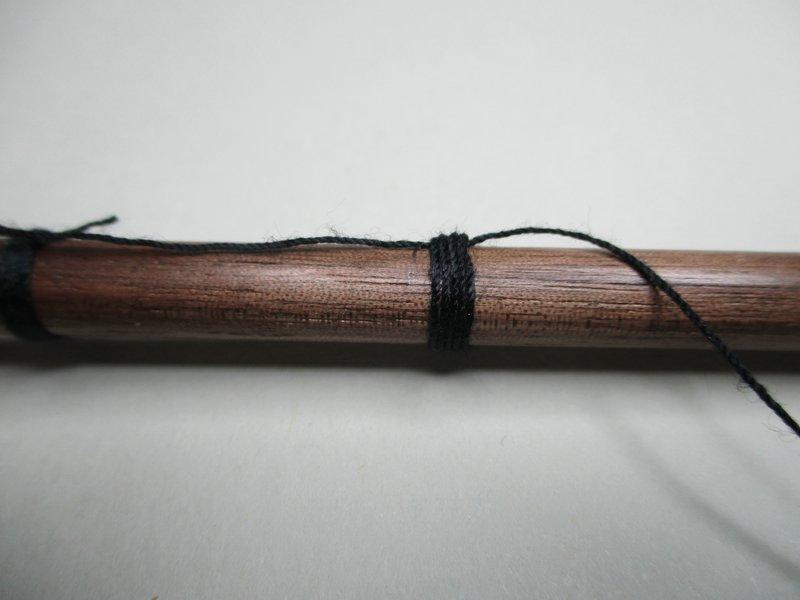

Left index finger on the single, long thread to the right.  Then with tweezers, pull the left single thread away.  This tightens things up and makes for a nice loop;
-IMG_1803.thumb.jpg.9abd01fca57f140098b6
Trim up a bit to make room for the next loop.  Then either with CA or diluted wood glue painted on, the ends can be snipped off;
-IMG_1804.thumb.jpg.001793d5edbc06a2a2fb
-IMG_1805.thumb.jpg.cb7464e9674aeccedfb9
-IMG_1806.thumb.jpg.74ce7bb930e291ad84f2

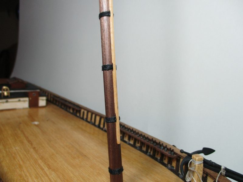

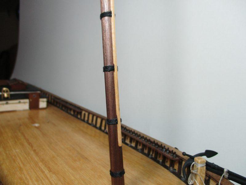

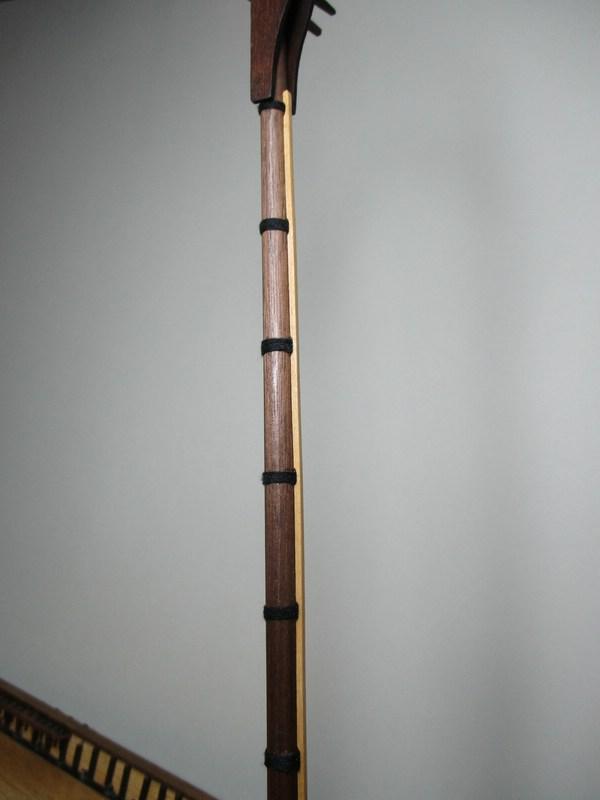

A skinny wood strip will be cut and then placed over these hoops, top to bottom, to allow the yard arm to be lowered and raised over the hoops, also protecting the mast from friction from the heavy yard arm.

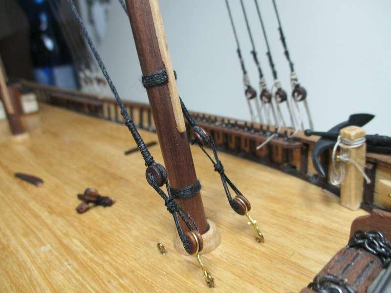

....and here with the 'bumper' mounted to the front of the mast;
-IMG_1807.thumb.jpg.8b91eac442dfacd95306
-IMG_1808.thumb.jpg.3a805d8ad22411d755bc
Moving on, a series of blocks will be mounted, then further up to the upper sections.

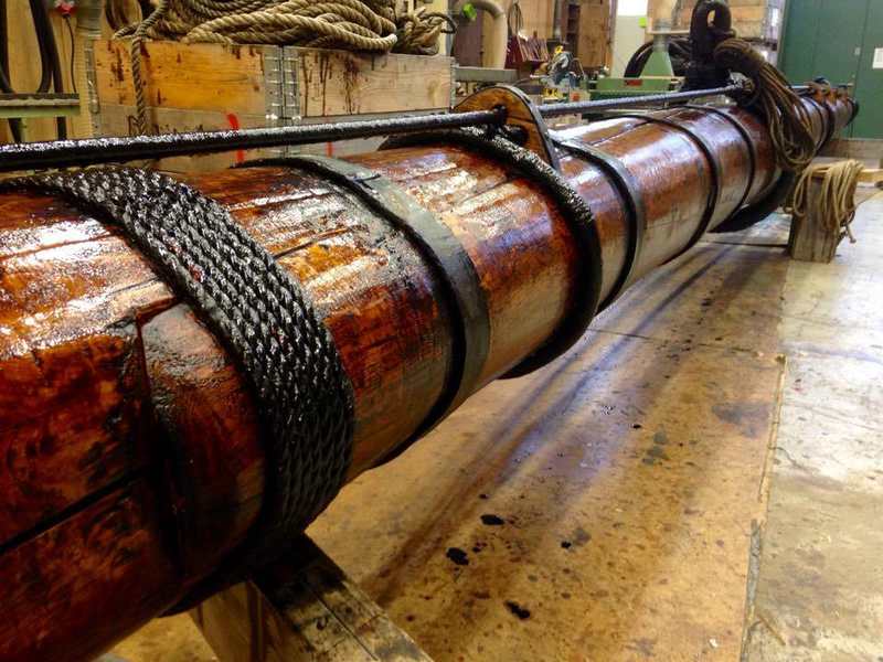

NEW.
I found about the best pic of an old ship I've ever seen.  Amazing.  Here what appears to be the lower main yard arm of a large ship.  This is a major piece:
-0000.thumb.jpg.2ec535889876ac780551567b
I estimate the yard style to be similar to ships of maybe the 1850's.  It's from a big ship for sure.
Notice the way the yard arms, and masts as well, were built.  This piece has at least 8 different wooden lengths overall in it's cross section.  The rough looking iron hoops were the major factor in keeping the sandwiched construction style held together.  Probably later on, the rope loops were added as the outer rounded cap was starting to separate from the mass.
The metal rod running along the top is the 'jackstay'.  This was a major breakthrough for the working crew at sea, appearing around 1820 or so.   The top edge of the sail was lashed directly to this iron bar, instead of being lashed around the whole wooden yard.  The 'old style', when the sail was wrapped around the complete yard, hung directly underneath the yard.  Very intense and dangerous work while at sea and wind and waves!  Sails are heavy....one hand for the ship, one for your life.  Hold fast.
This newer method allowed a somewhat safer stand for the crew, and was quicker and easier dealt with.  Plus, the sail was flush with the yard as it was now lashed on top of the yard, which also heightened wind efficiency.
My guess, this is a yard arm from a clipper ship, early 'Cutty Sark' type.  The chocks holding the newly introduced jackstay were in the early stages an iron eye bolt that was drilled into the yard arm.  This piece here shows wooden chocks with a metal band, meaning my opinion, a somewhat later technique.
I'm thrilled in finding this photo, it tells stories.  I like the colors too!  Just, I have a wooden ship with this color, and the current project is different.
That is a heavy piece!

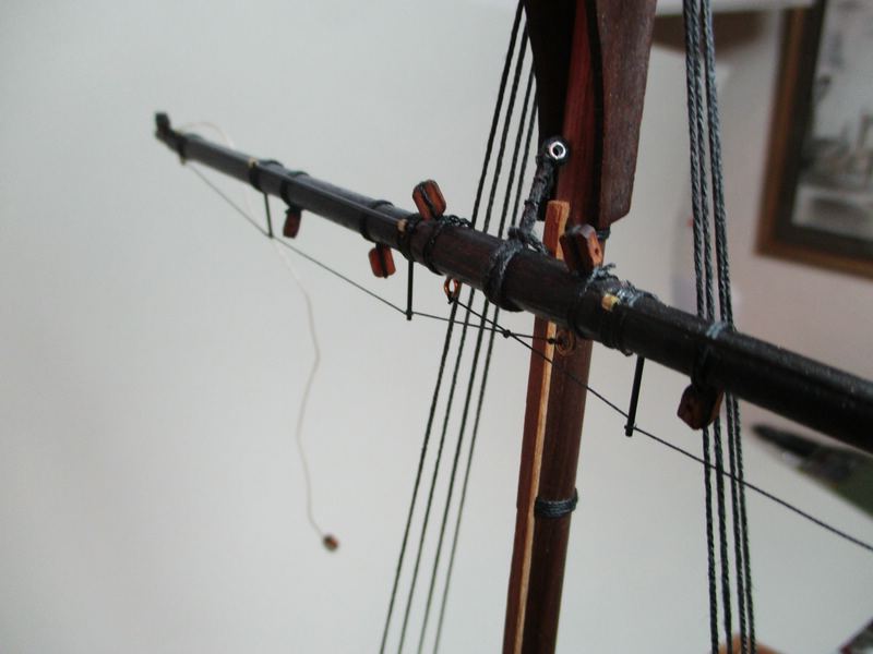

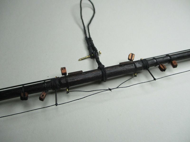

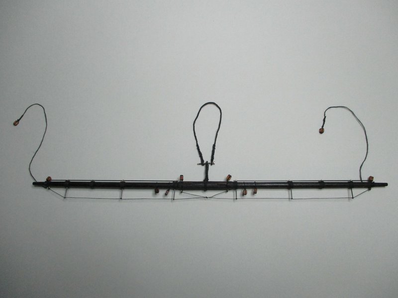

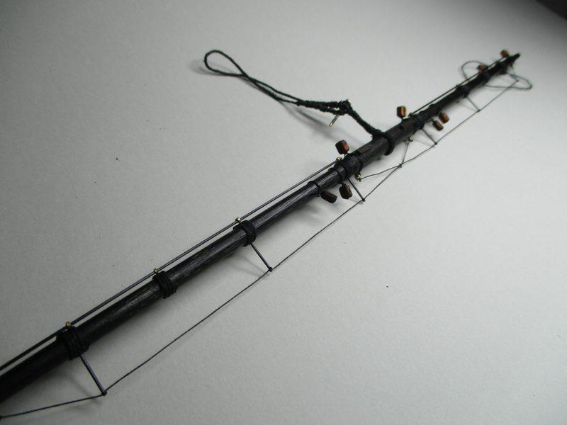

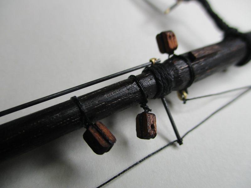

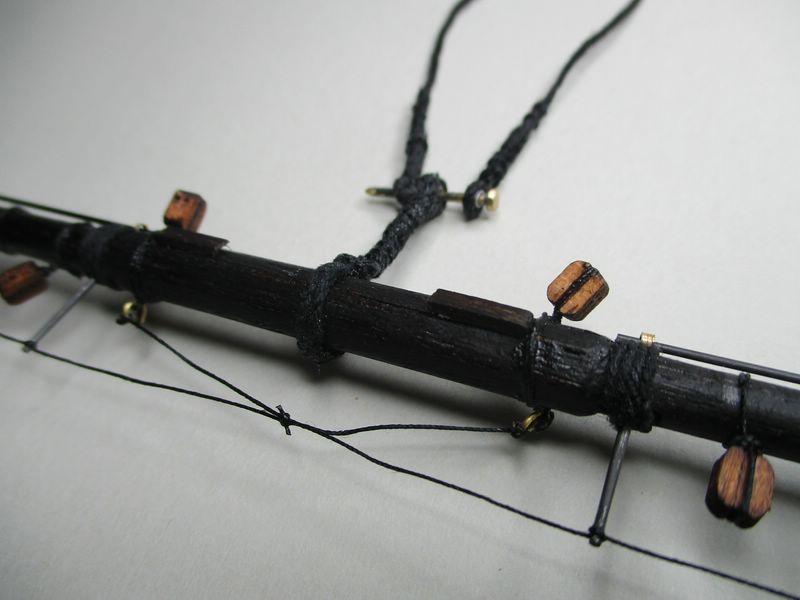

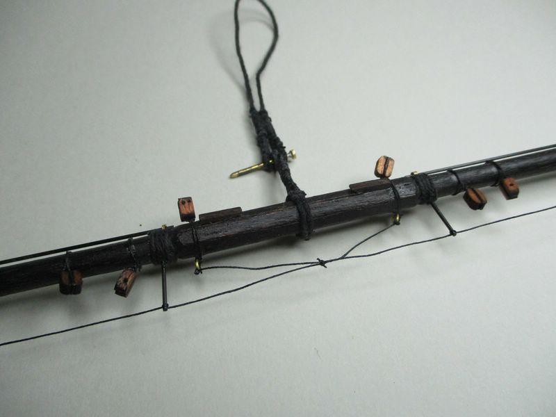

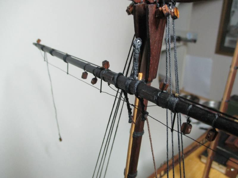

Here the lower yard of the fore mast, 13"  long.
-IMG_1809.thumb.jpg.45da7c4851d732d62f23
-IMG_1810.thumb.jpg.336d252fe8105dbad50d
-IMG_1811.thumb.jpg.cb49791d5ba452d4f2a7
-IMG_1812.thumb.jpg.7f4faedce33d1eb45b85
-IMG_1813.thumb.jpg.385ccd04323eb847c3e9
Even though bare brass was not visible on real boats, I'll let it be, maybe later blackened if the brass parts stick out.  No problem now though.

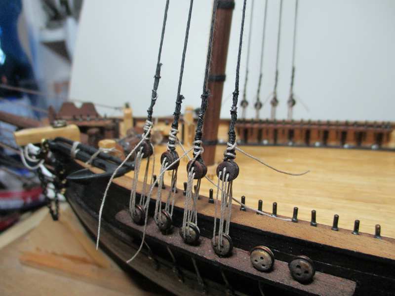

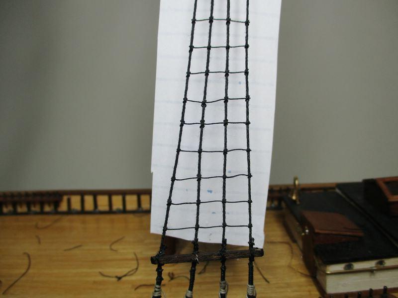

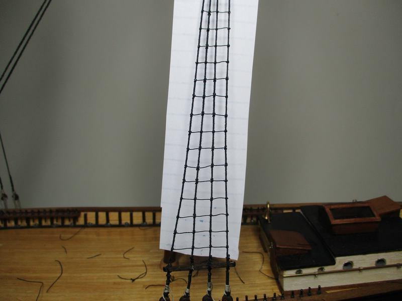

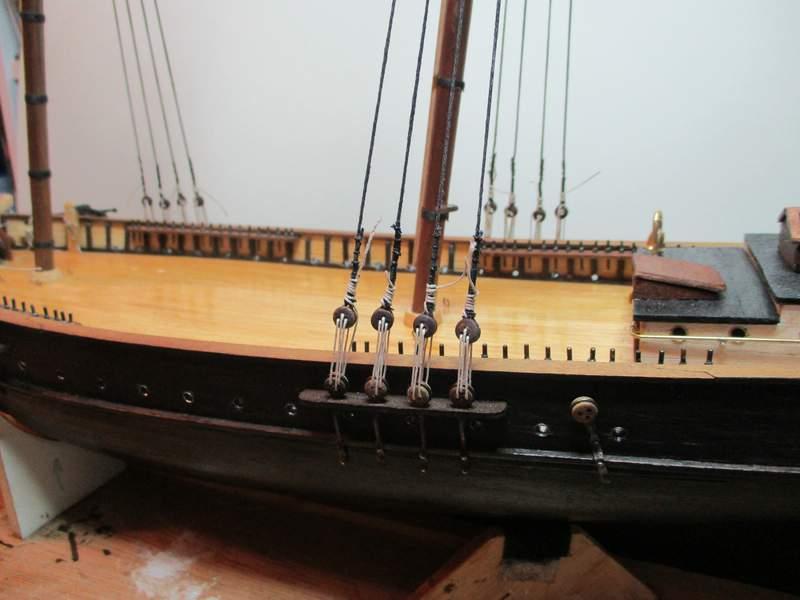

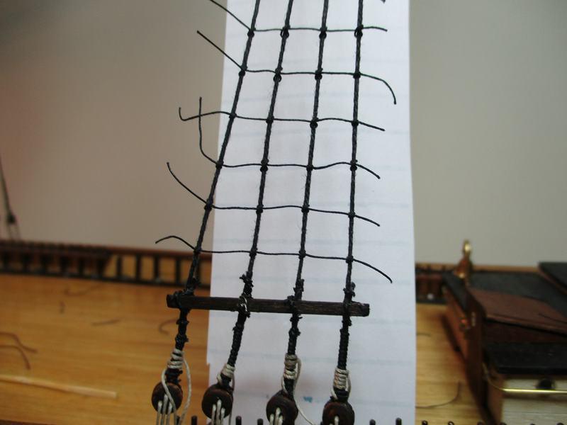

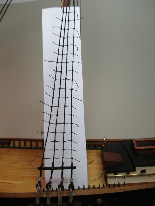

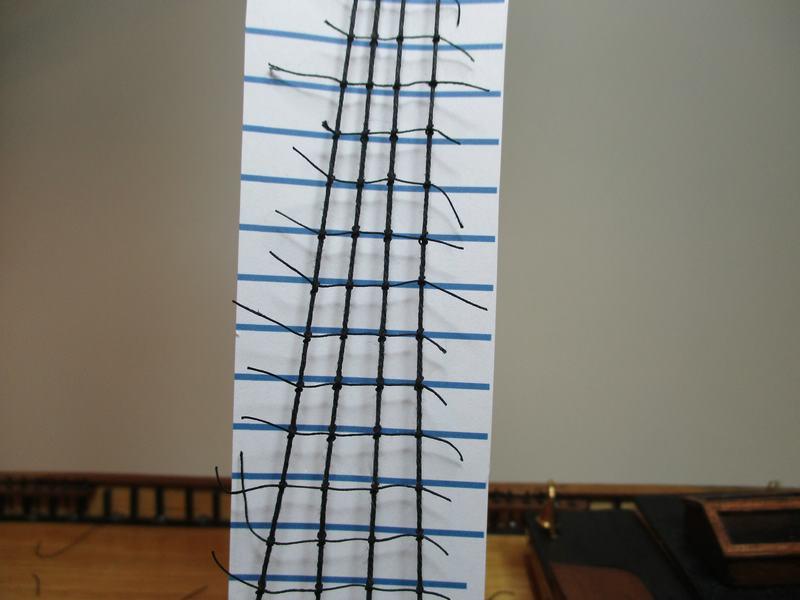

UPDATE:  Feared ratlines have begun.
I've been busy the last days practicing knots and lines.  How detailed do I wanna go?  Past experience tells me it's the overall view, and the overall model that pleases.  Not necessarily getting ridiculous with details.  This is not a museum model.  Just more detailing than the OTB model would show, still in the comfort range, sometimes though, some stages go a little further.  It's not a must do thing.  These models are large, and no one goes up to study detailing.  Me either once the ship is on the shelf.

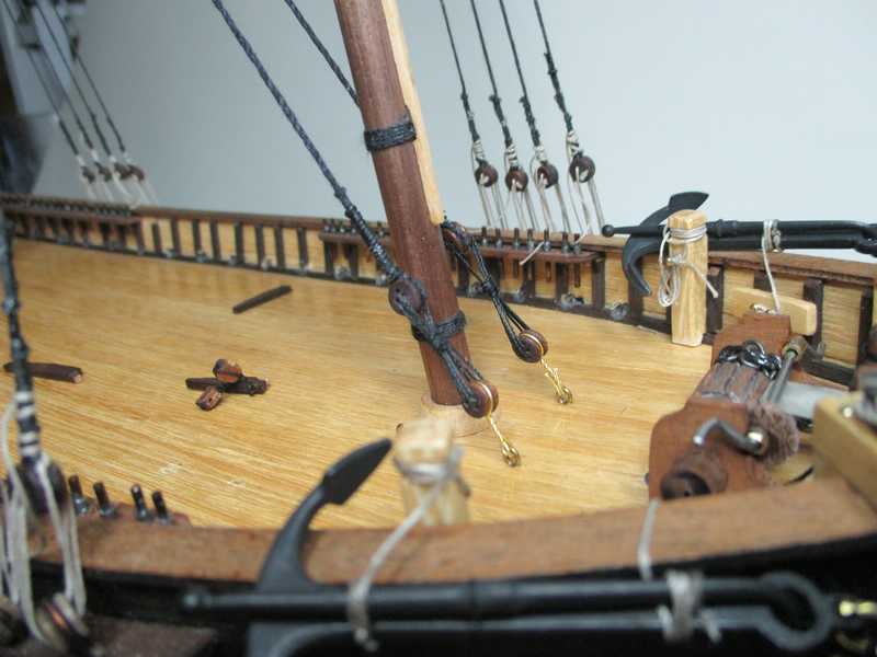

The infamous ratlines have been started.  First off, the shrouds on the foremast, lower section.  A little later on the horizontal 'steps' to make the ladders will be tied on, just not yet.
Here a peek at the 'deadeyes'.  These allowed for tightening the major lines that held the masts in position.  Note, the deadeyes on top do not have to be level with each other as the tension was adjusted from time to time, allowing for an apparant misalignment.  They're OK when not level;
-IMG_1820.thumb.jpg.3729453b62b1fc88b3ac
-IMG_1821.thumb.jpg.9d14809274aa0af8deee
The tan lines are not glued, just tied off.  Later on some adjustments may be necessary to keep the masts straight.  These lines can be untied and pulled tighter or loosened.  The finished line will be wound up nicely along the black, whipped heavier line to which it's now attached.  They will not be glued, just tied.

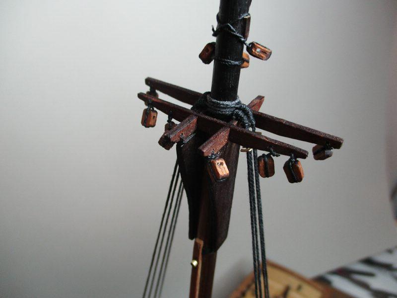

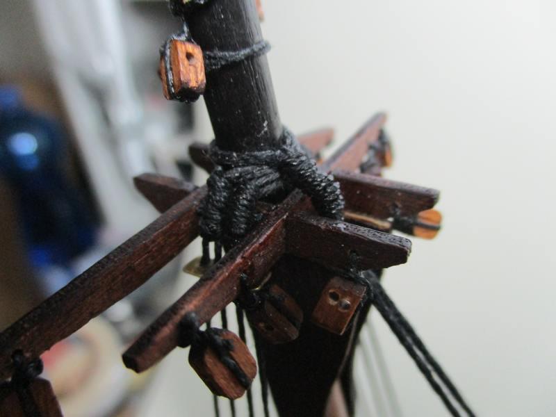

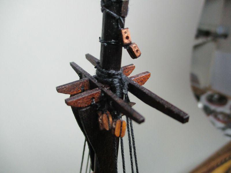

Here the shrouds as they wrap around the mast top.  They're done pairwise, to each side.  First one pair to one side of the ship, the next pair to the other, and so forth;
-IMG_1822.thumb.jpg.e7df5c2359f15877d17a

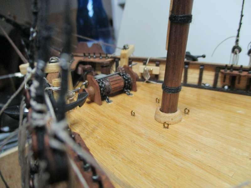

Anchor chains attached, and running around the spill and below deck;
-IMG_1823.thumb.jpg.4fa4f65d81dd608a3822

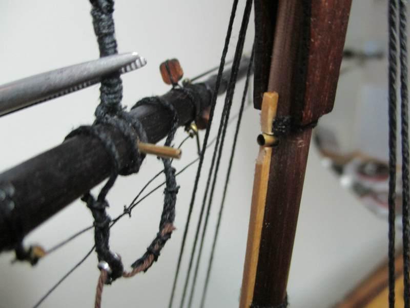

Next up a clear ship modelers breach of procedure.  But the yards are a real pita to mount the 'real way';
-IMG_1825.thumb.jpg.1eb6401323f9e4168e91
So, to make the initial mounting easier for me, a hole was drilled into the mast, then a brass tube inserted, the yard got the same treatment.  Now the yard just slides in to the brass tube on the mast.  This was, the yard is held in a position that can easily let the rigging do the rest.  Position is basically secured with this 'cheat'.  I like;
-IMG_1826.thumb.jpg.81a8002a2dcfc1845307

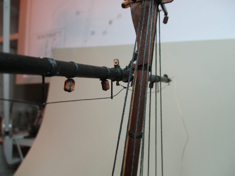

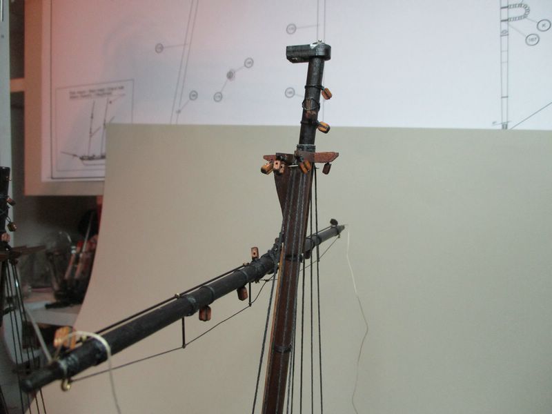

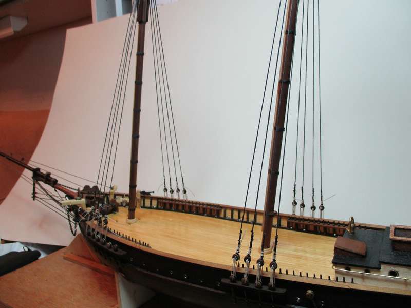

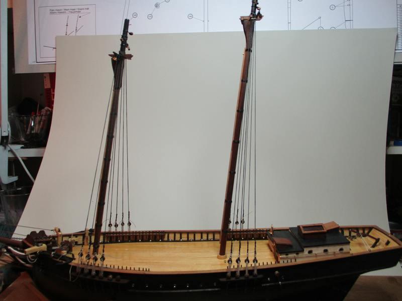

UPDATE:  Main mast and shrouds mounted.
Here a few pics of the progress, main mast;
-IMG_1827.thumb.jpg.23d521f99f37069965df
-IMG_1830.thumb.jpg.f8efcb1a2e200d0f59f5
-IMG_1831.thumb.jpg.34bcbb5acaab422af819
Here a couple of closeups;
-IMG_1829.thumb.jpg.664f5fe65c426c4e85f9
Main mast lower yard;
-IMG_1833.thumb.jpg.ebf7be1380ef387f6d31
-IMG_1836.thumb.jpg.1e466ffcb51213ae2a03
-IMG_1837.thumb.jpg.f72015ba71b51cb4ce3e
Next up is making the actual 'ratlines'.  This will be adding threads across the shrouds to make ladders so the crew could attend the sails.
Thanks for looking.
