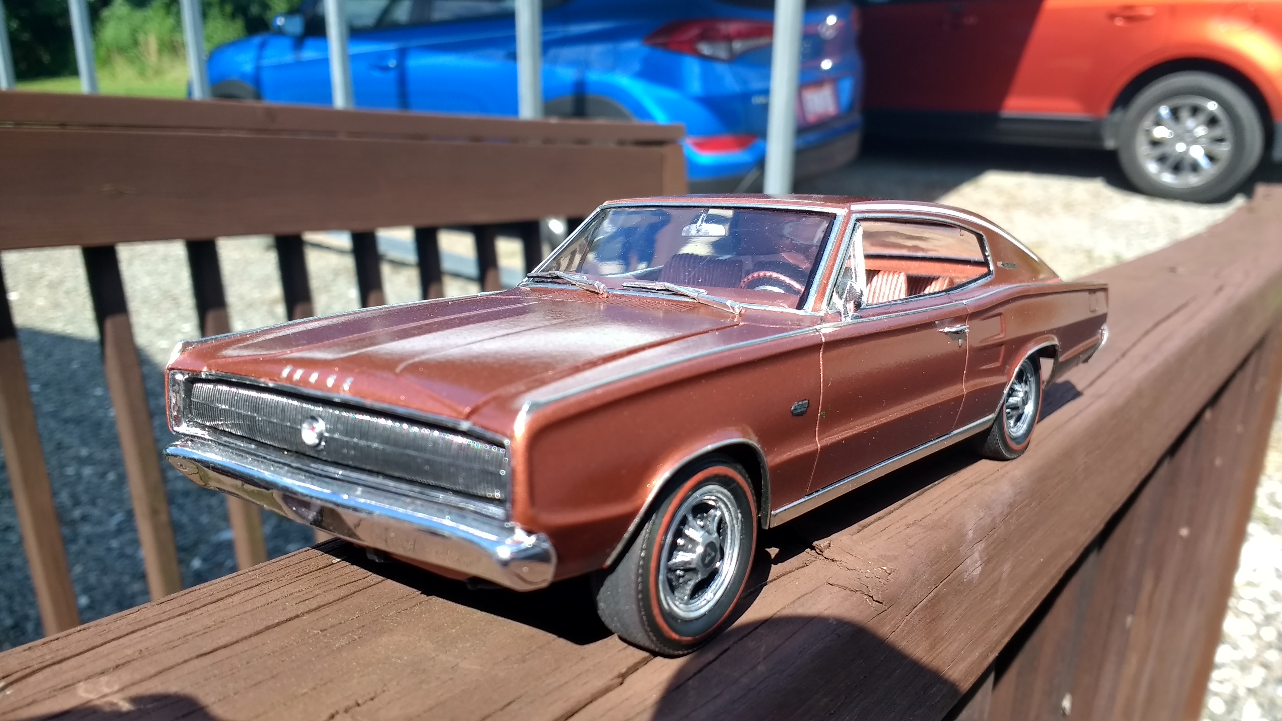

This is a way I did the redlines in the photo.  I'm pretty ham handed so someone with a more delicate touch could probably do better.  I chucked a dremel sander drum in my cordless drill - moto tool spins too fast.   Then slide the tire over that and get it all true.  Fix the drill some how so you can operate it and the marker part at same time.  Vise, wife, etc.  Sorta like a poverty/ghetto mod - spin the drill at a slowish speed and apply marker to sidewall.  In this case I used a grease pencil/china marker.  But you can use a paint brush, pen etc.  And if you really go all out and make a trie holding mandrel, it would be a lot easier to get them true.  Silver or gold sharpies might work but only apply lightly to get a thin line.  By same token, you can take an x acto and scrape the line back to a thinner line after you make a big line.  Takes a light touch, but worked for me.

Hi,
Hmm, not a bad idea Randy, pretty ingenious actually.
Thanks for the tip.
