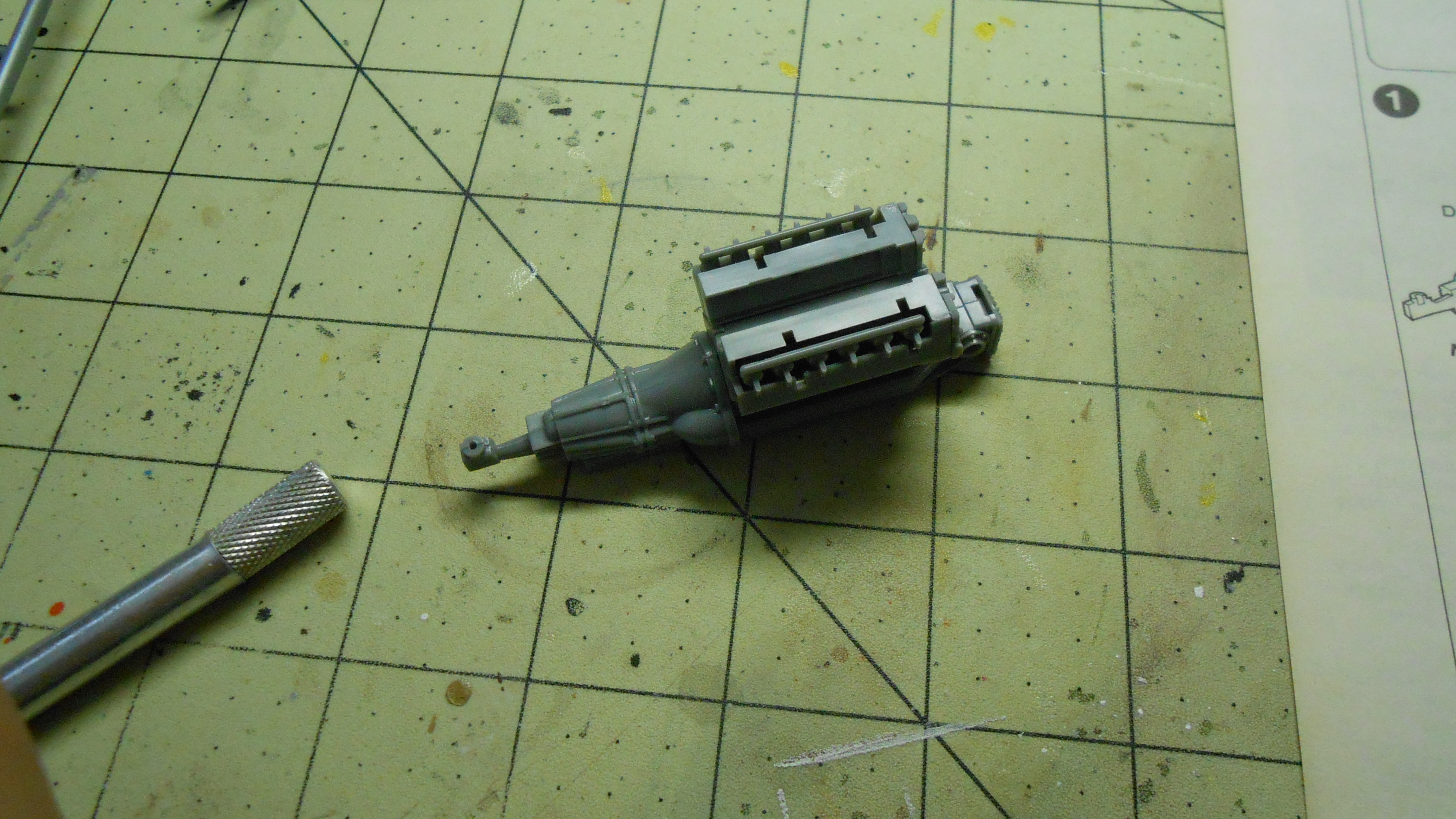

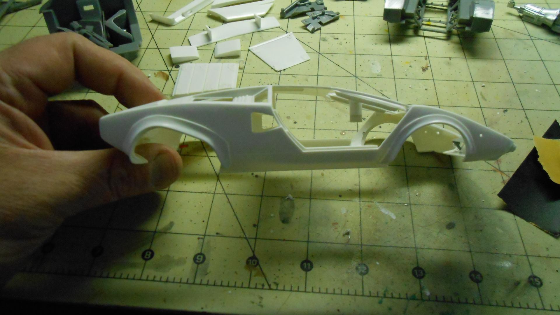

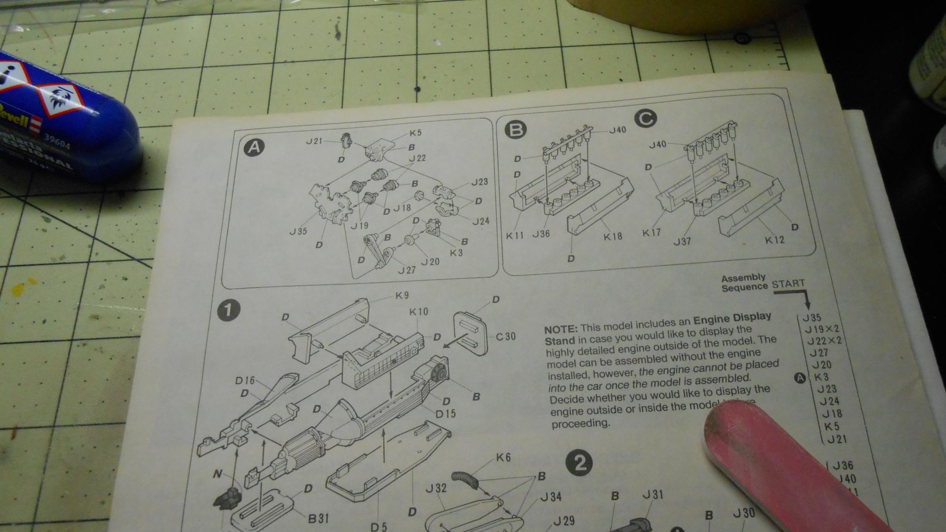

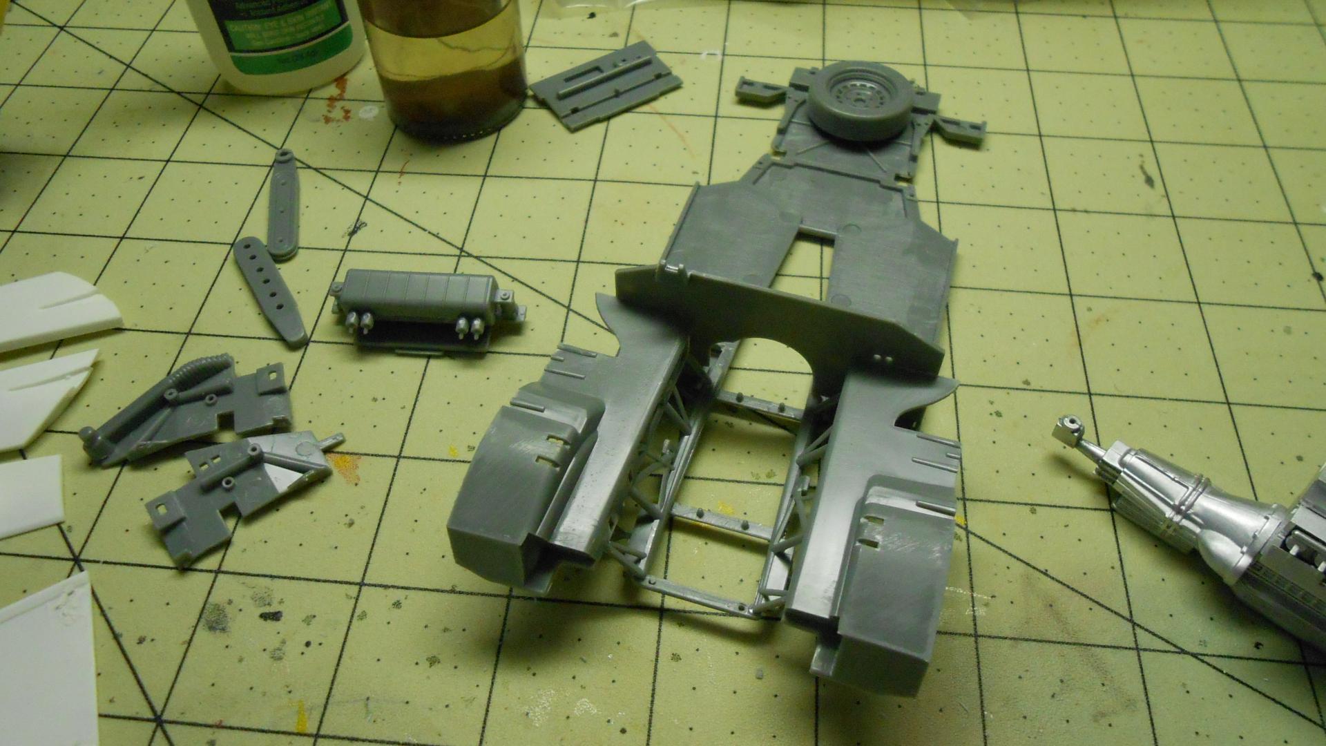

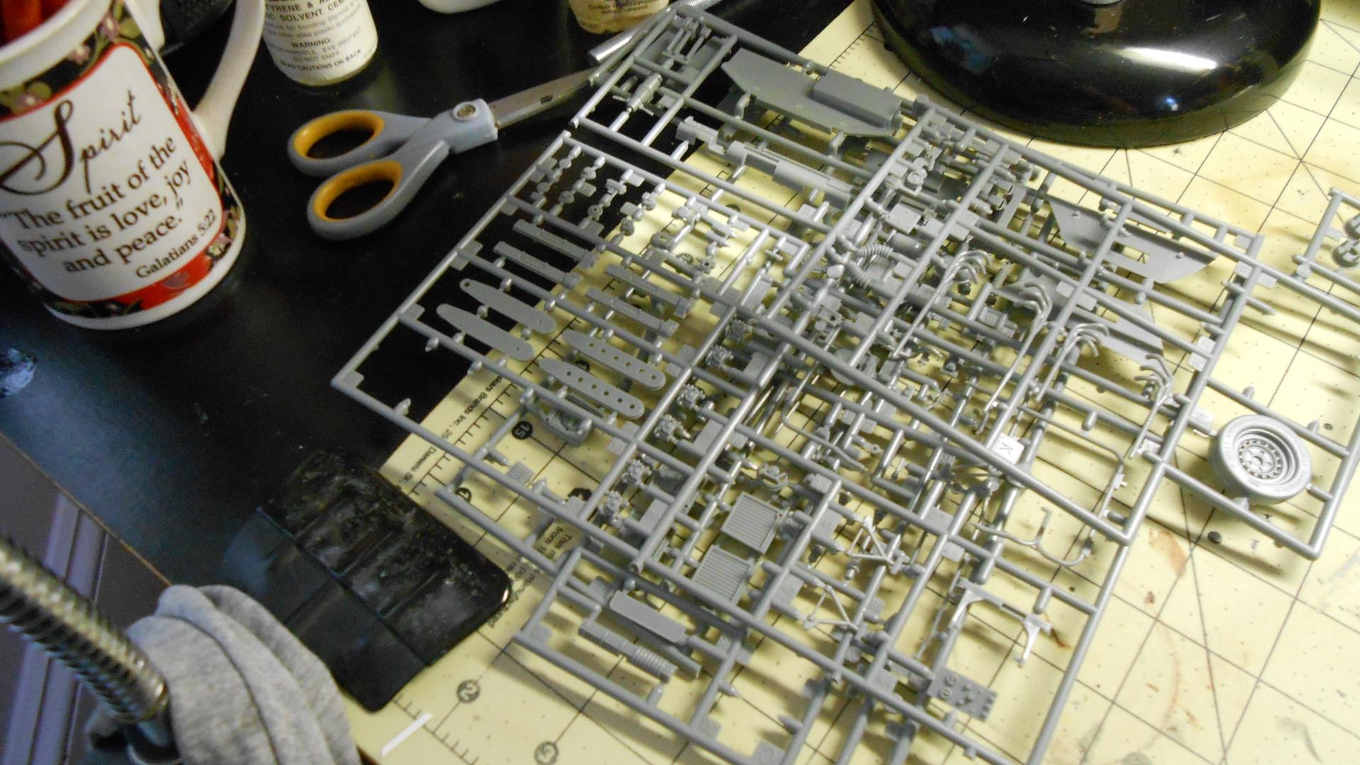

The long block alone is already 15 pieces deep. The fit is absolutely perfect. All sanding was done with a fine board and then assembled with Revell professional Contacta cement. My absolute go to glue these days. Pics show just how many trees are involved with this kit. When your tree count goes up to K you know you have quite a few pieces to assemble
Share this post
Link to post
Trees are so precise with ZERO flash. If it can be a separate part it is. Working parts are doors, front lid, engine cover, lights and posable wheels. It also has shoulder harness hardware and a guide for cutting the belts. I plan on at least ignition wiring and batter. I may do some vacuum hoses as they are prevalent. I have some generic PE bits and I think I can add a throttle plate with linkage. But we'll see about that. There is a wealth of pics on the net showing every aspect of this car so images should not be a problem. The decal sheet is also very good with every marking needed. An interesting fact about this car is that every piece of glass is flat on the 1:1. Making the glass in this kit easy to fit and distortion free.

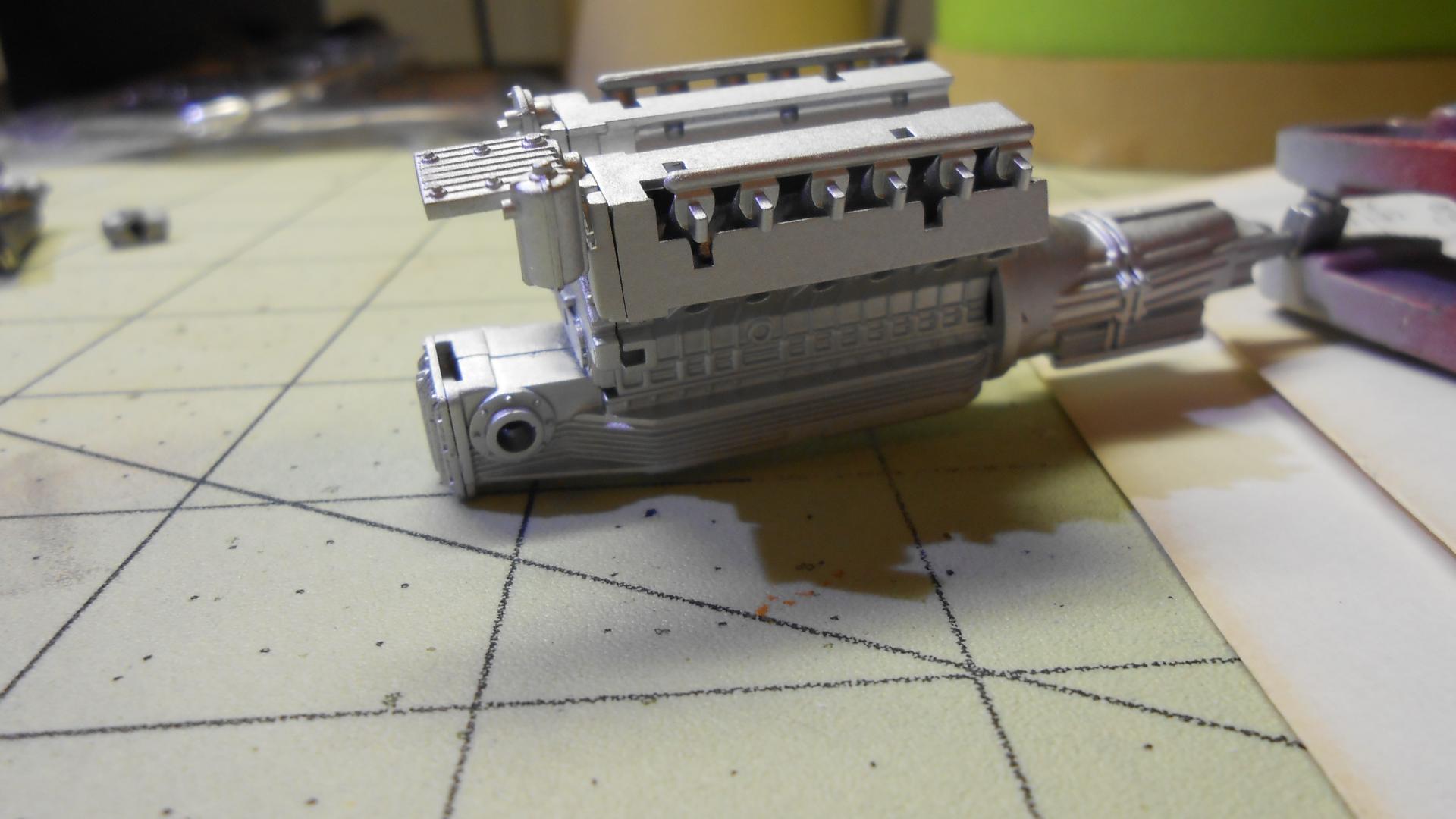

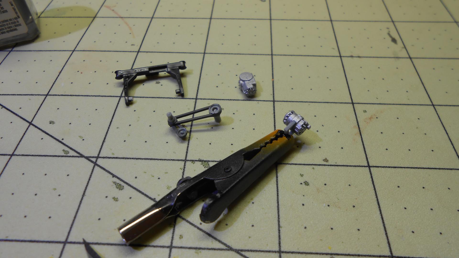

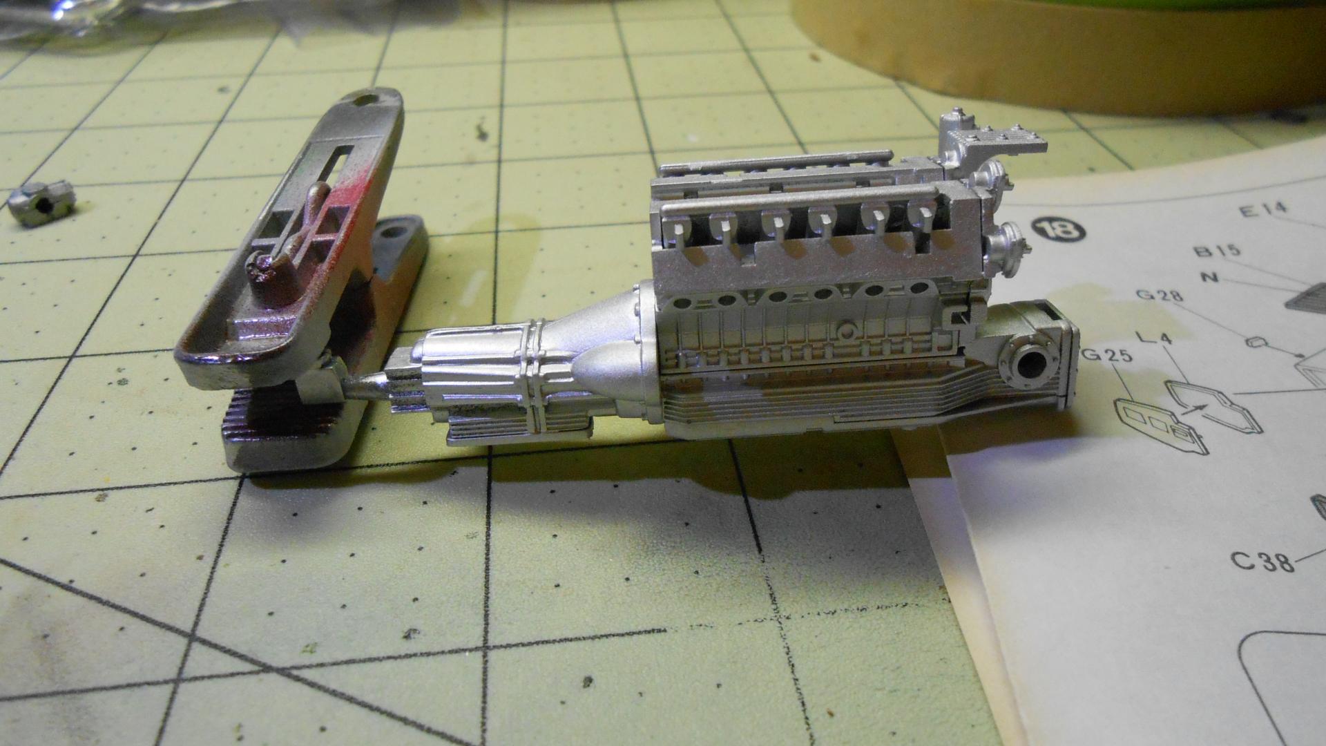

Work continues tonight with painting of the long block with a few of the brackets in place. I attached as many pieces as I could while still in bare styrene to keep everything strong. The A/C bracket and drier as well as distributor bases were glued while bare plastic to keep it stable. I painted the alternator compressor and belts in flat aluminum as per reference. I cleaned up the fender flares with fine paper and am preparing to attatch them. It will require some deft tape and glue to get these strong and straight but I think I got this. My plan is no clearcoat just Duplicolor white enamel and a gentle buff. These were painted in a single stage back when new so I'll do the same. One thing I see is the rear tires seem a bit small. I post some pics in future installments and you make the call.

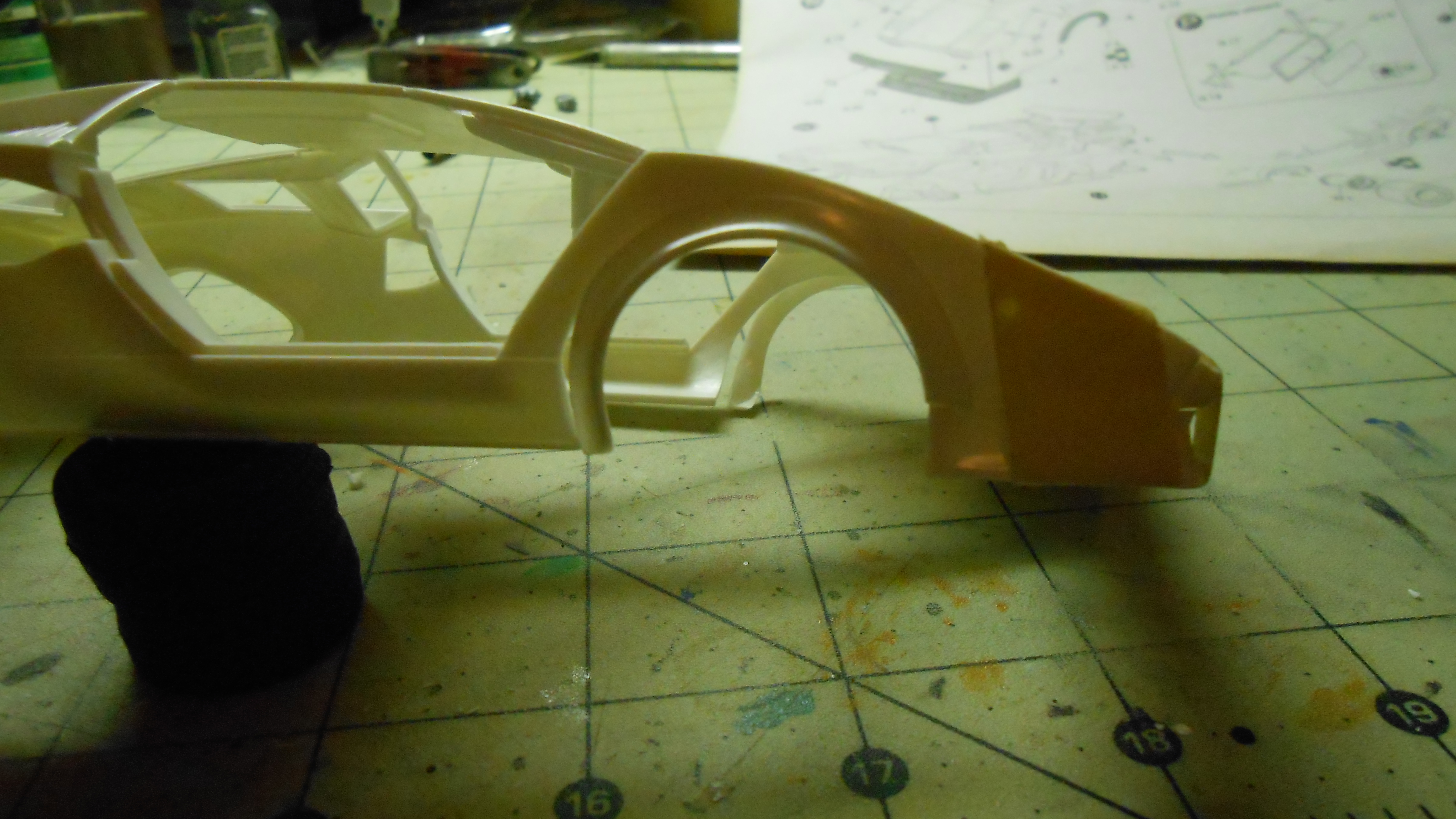

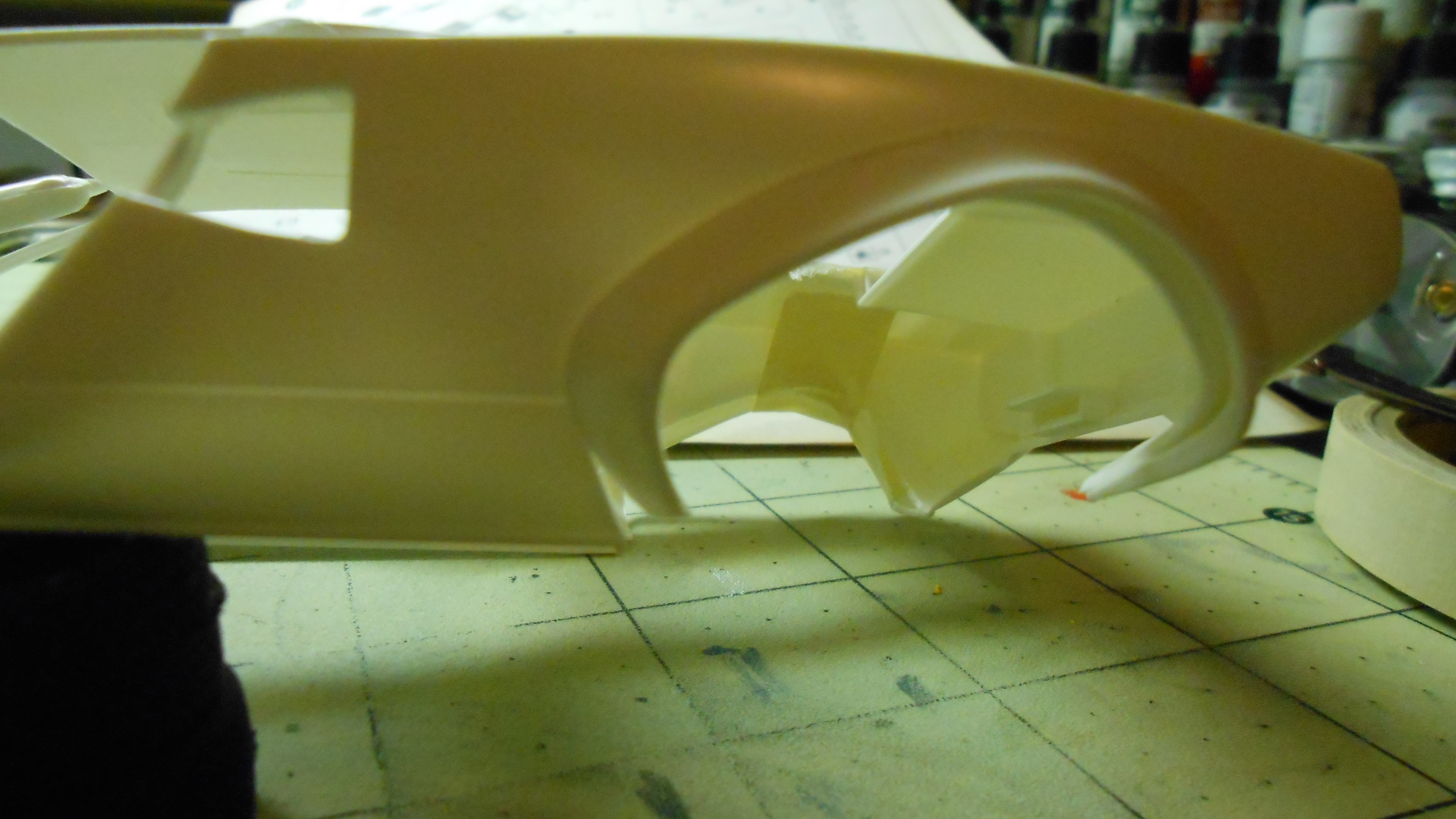

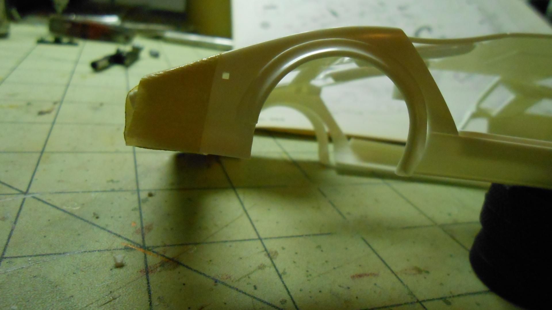

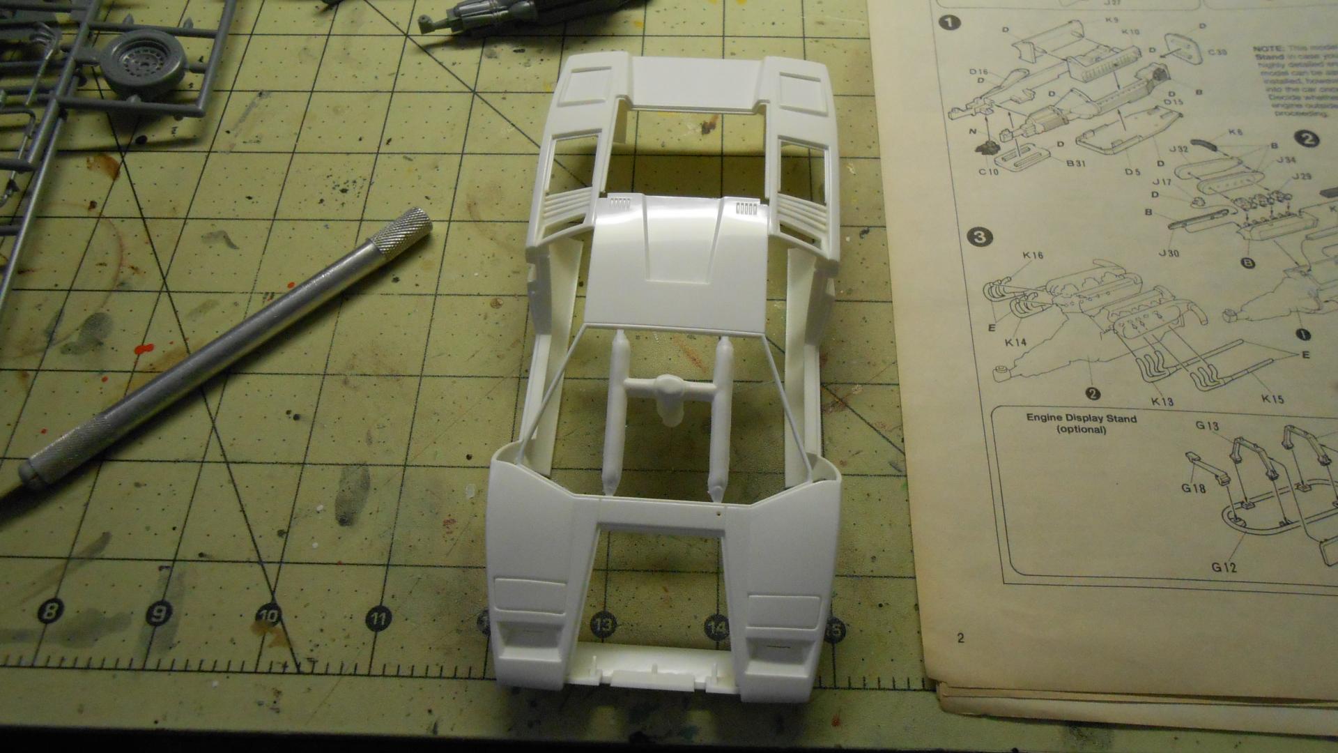

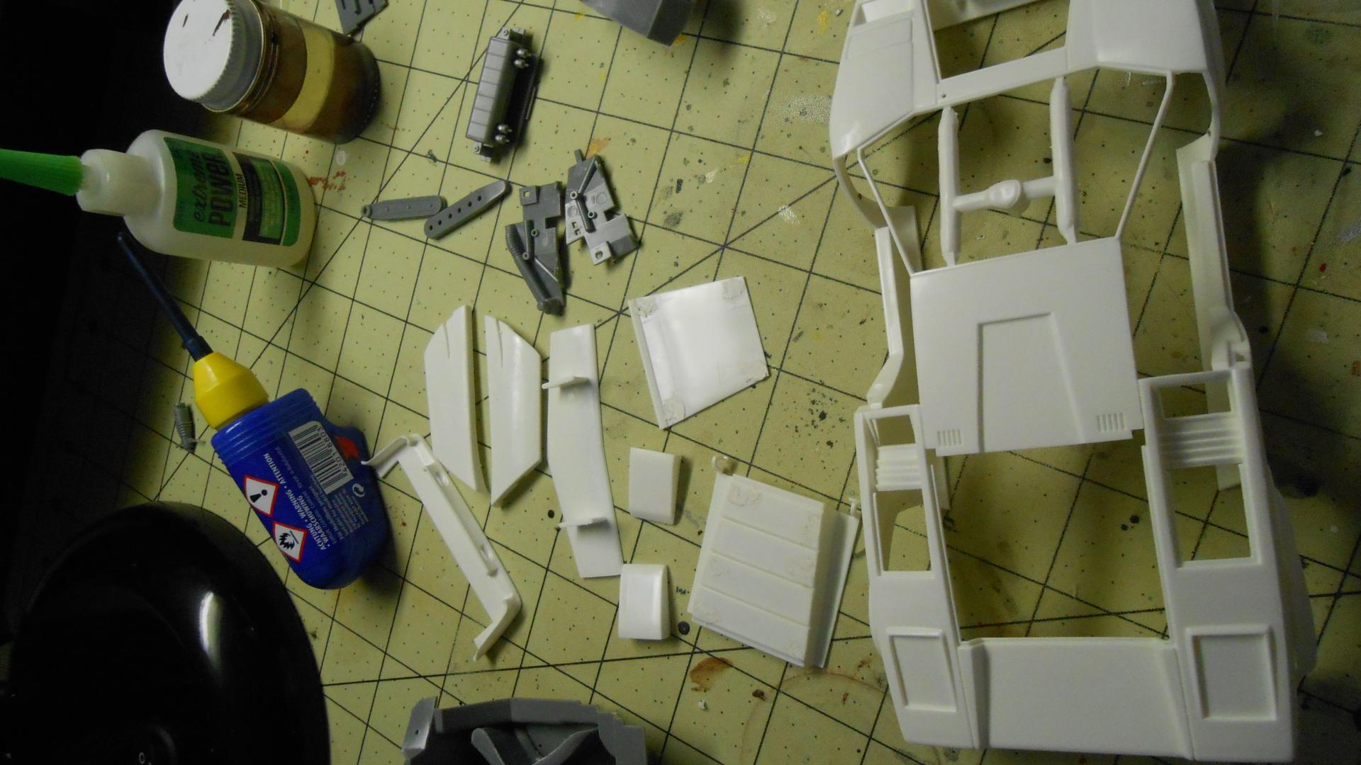

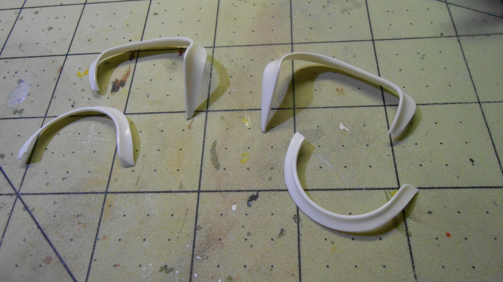

The front flares must line up with the ground effects in the valance so I had to mount the bumper and hood hinge permanently. The valance can be held in temporarily until the flares are cemented in so they stay lined up. I'll dismount it for painting so i can hit it and not glob paint into it. There are also driving lights that go in there and those would be a pain to install with the valance already there. The rear flares just need to hit their marks correctly and straight but gluing will still be a pain since their correct location is compound so I may do it in two stages to make certain they are on the money. Sanding these flares was a bit of a pain but they are good to go and line up nicely despite their complex nature.

On the flares Bob, line them up where they look the best and if you don't already have some....get some flex-I-file with the glass tube for precise metering of the liquid solvent. Stuff works amazing for joining body panels and flares.

Thanks Kenny. The Revell Contacta has a great long fine nozzle so I think I'm good. But I'll still look into those Flex-I-file tubes.

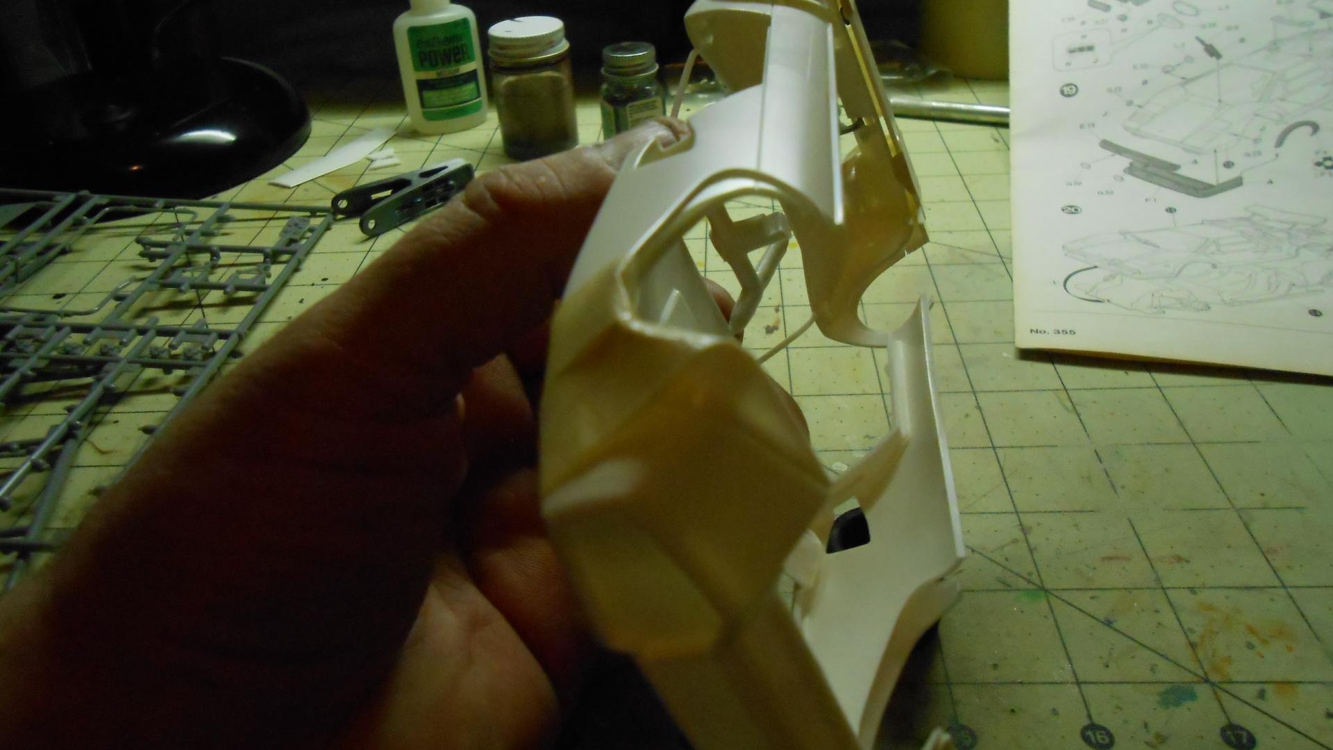

The flares fit good but they are too rounded so they must be installed in halves. I have the first halves in and lined up pretty good. I think the passenger side may come up a tad short to the lower beltline but I'll see how persuasive I can be. I'll let them harden overnite and see in the AM. I did preliminary bends so I know they will bend to their spots and I didn't go too far with the glue so the arc stays good throughout the curve.

What is funny is the drivers side rear flare fits very well and is being held only by the glue. I didn't need to tape it at all.

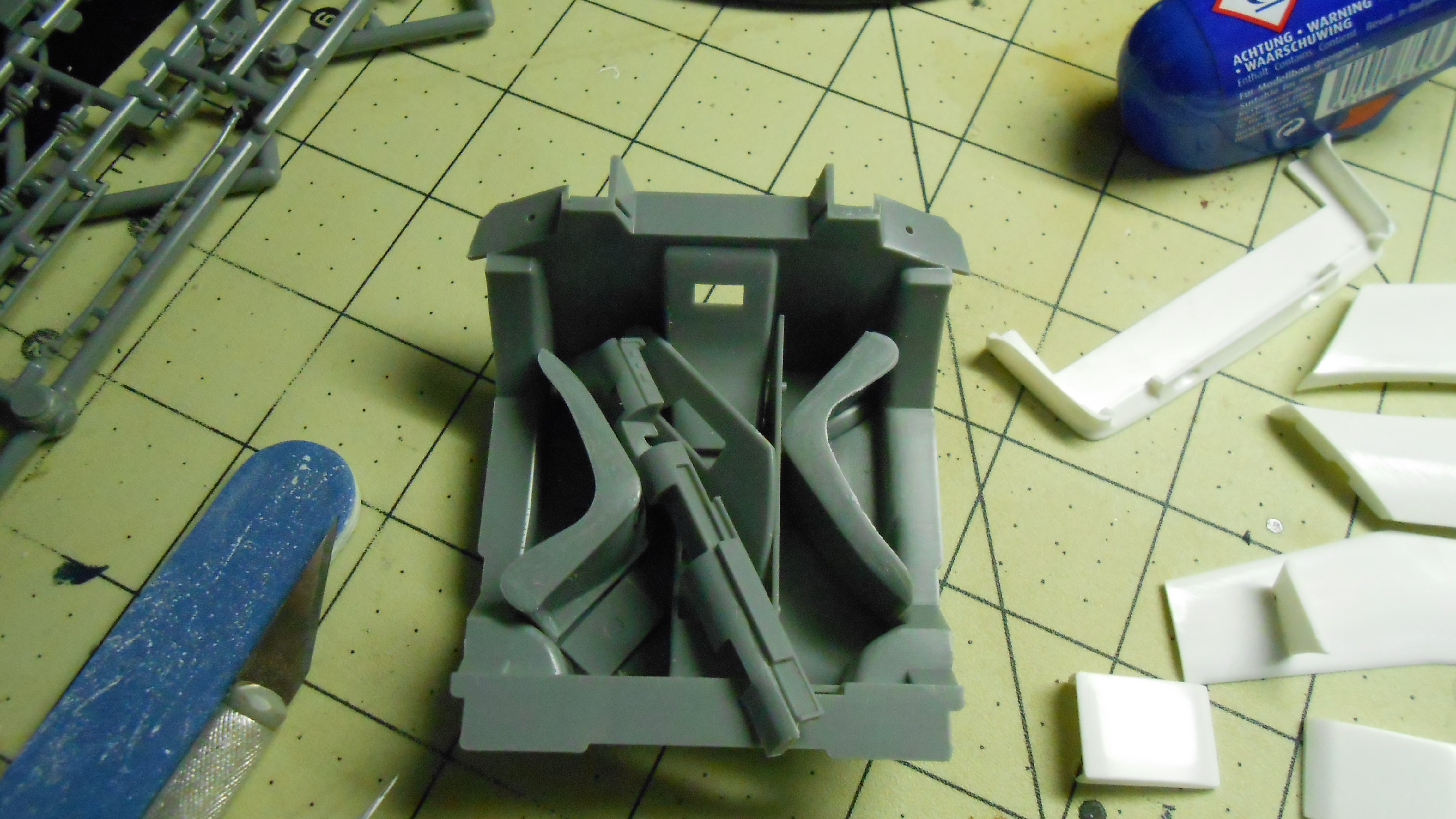

Here is the chassis with bulkheads attached. The left leans down ever so slightly. The body does shore it up when inserted so that's a relief. The back box is complete awaiting Model Master buffing metalizer. Front bulkheads are getting near to being attached. Body parts are sanded and need a wash before primer is applied. Ejector pins were filled with Tamiya white filler.

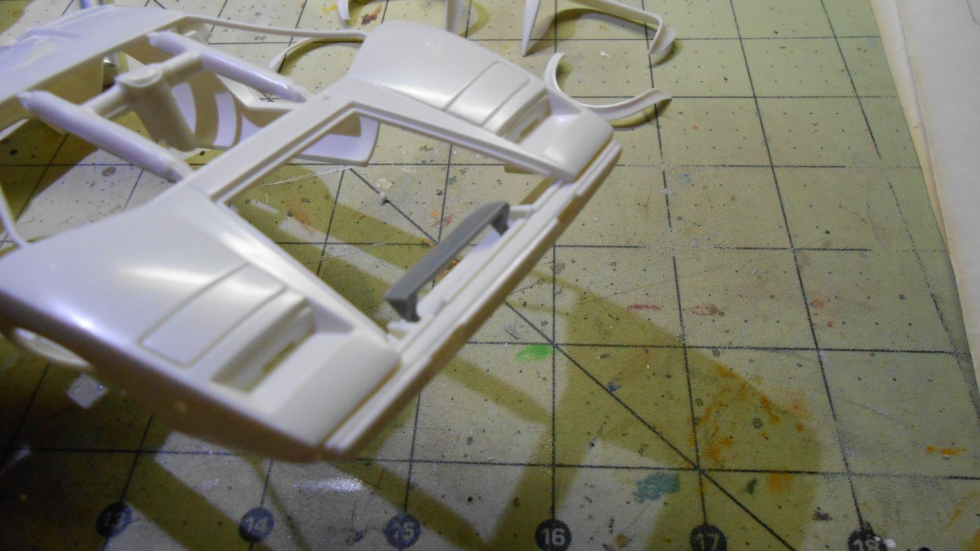

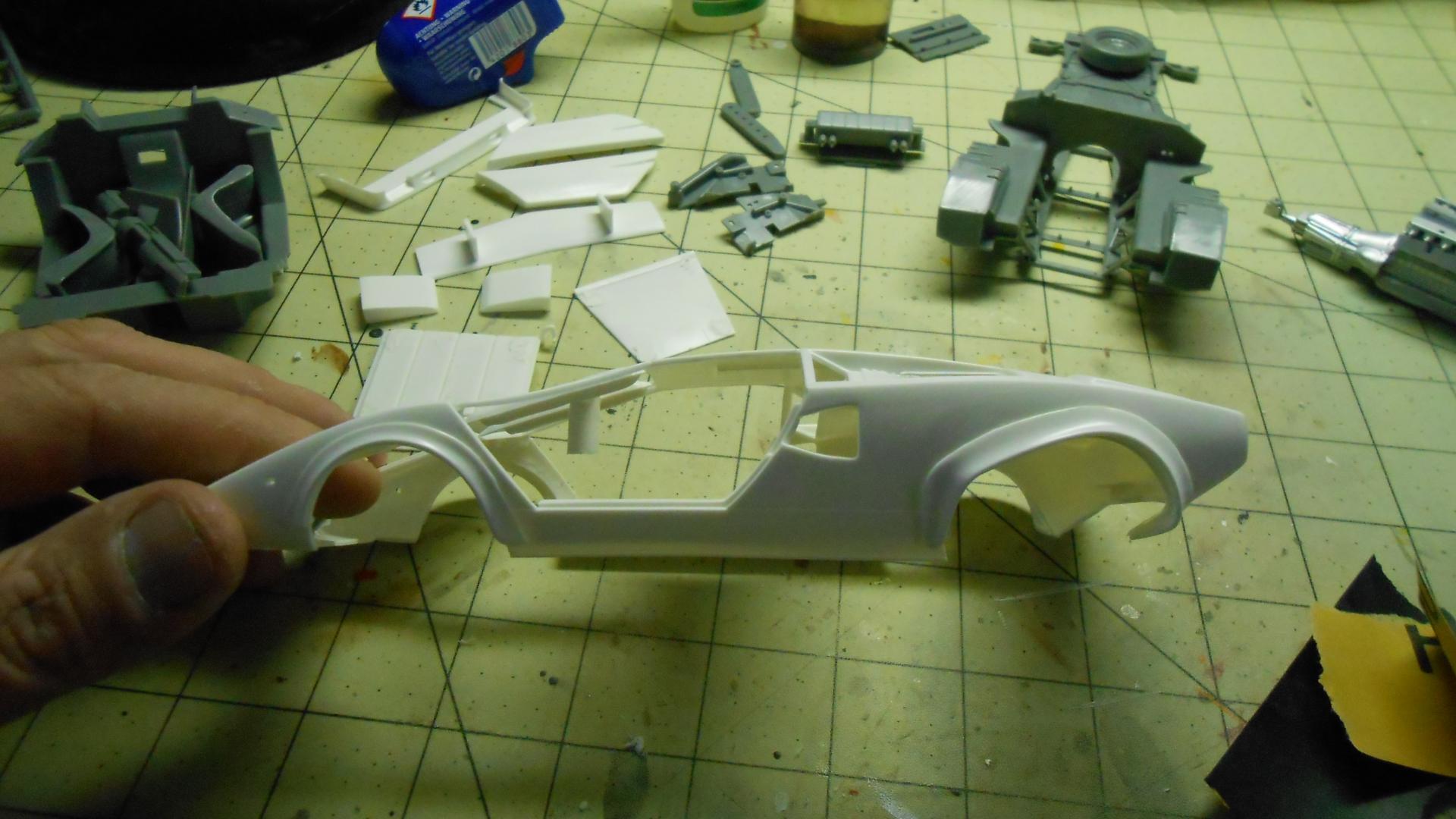

Left and right sides of the body. As you can see the drivers side window frame dips quite a bit. I put the glass in to see and it straightens out perfectly. The comments on the glass were interesting but mine seem clear. I'll lay some Future down on them for maximum clarity.
Interior parts that are getting red paint are all in one place and awaiting a wash before white primer.

Thanks Dann. I have the flares in what I think are their best positions. Looking at reference says the rears sit too high in relation to the top but I can live with it. I'm excited to see someone do a WIP on the Aoshima kit so i can see it go together for myself. Handling one at a show quick like and sitting on the bench with it all apart are two very different things.
