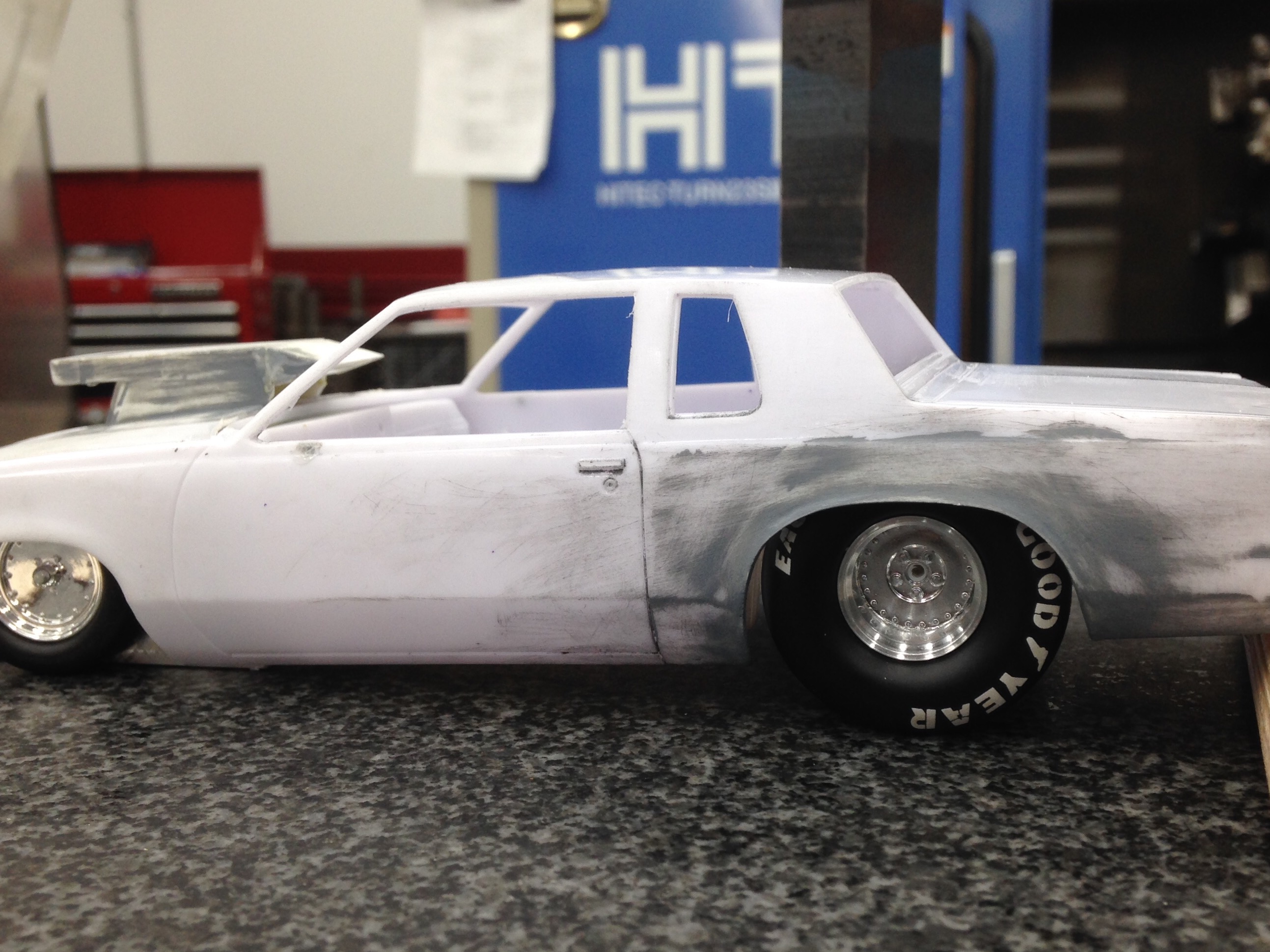

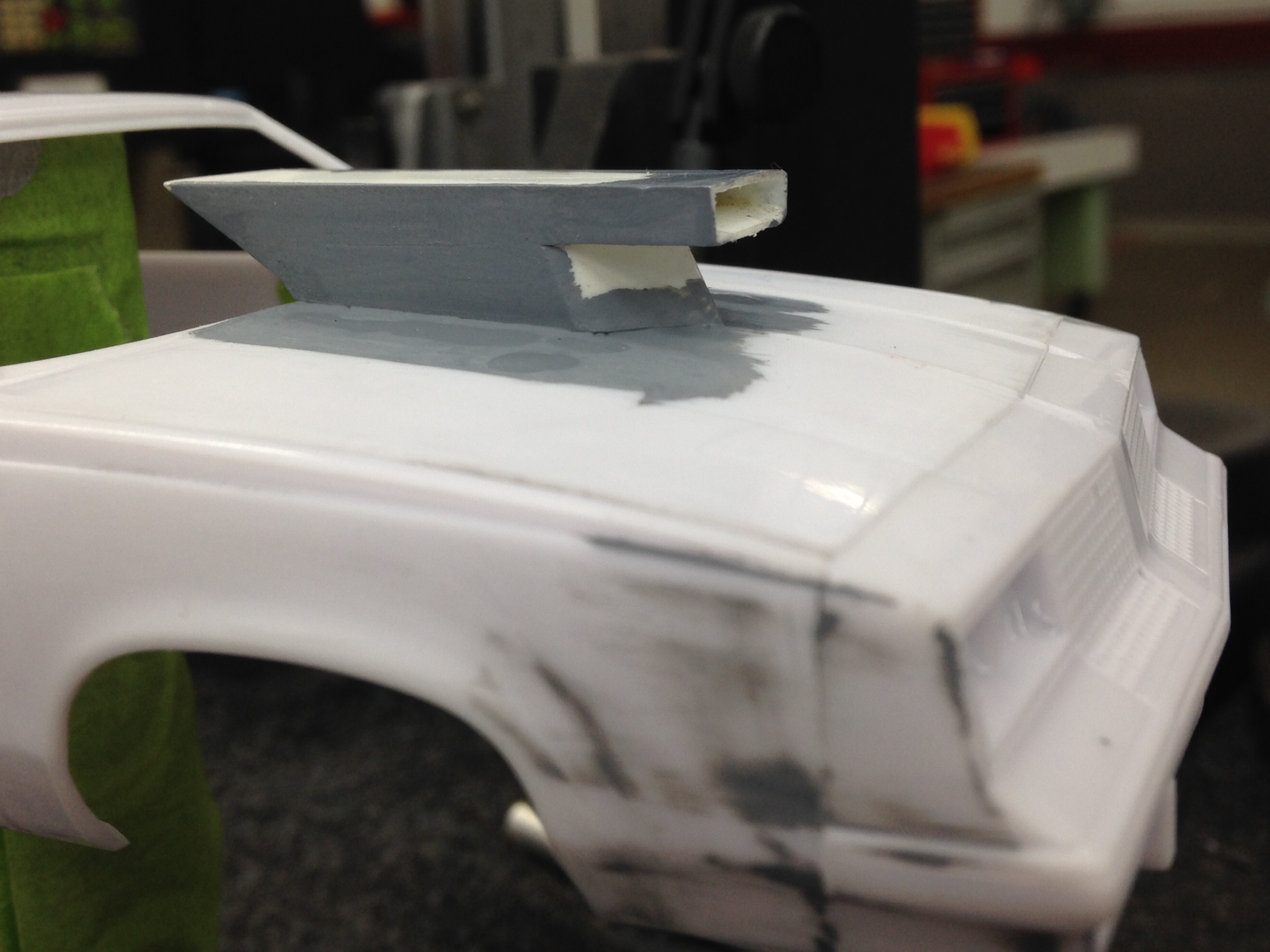

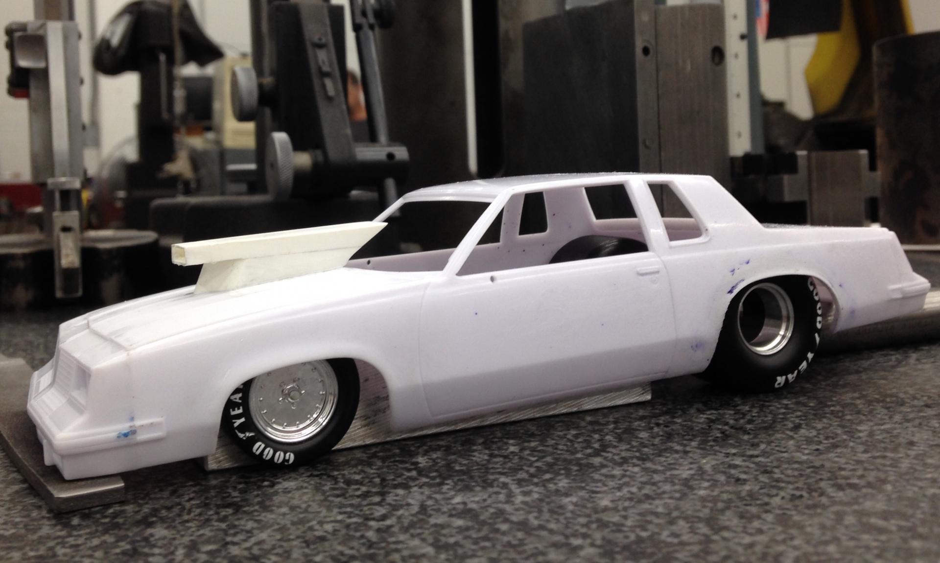

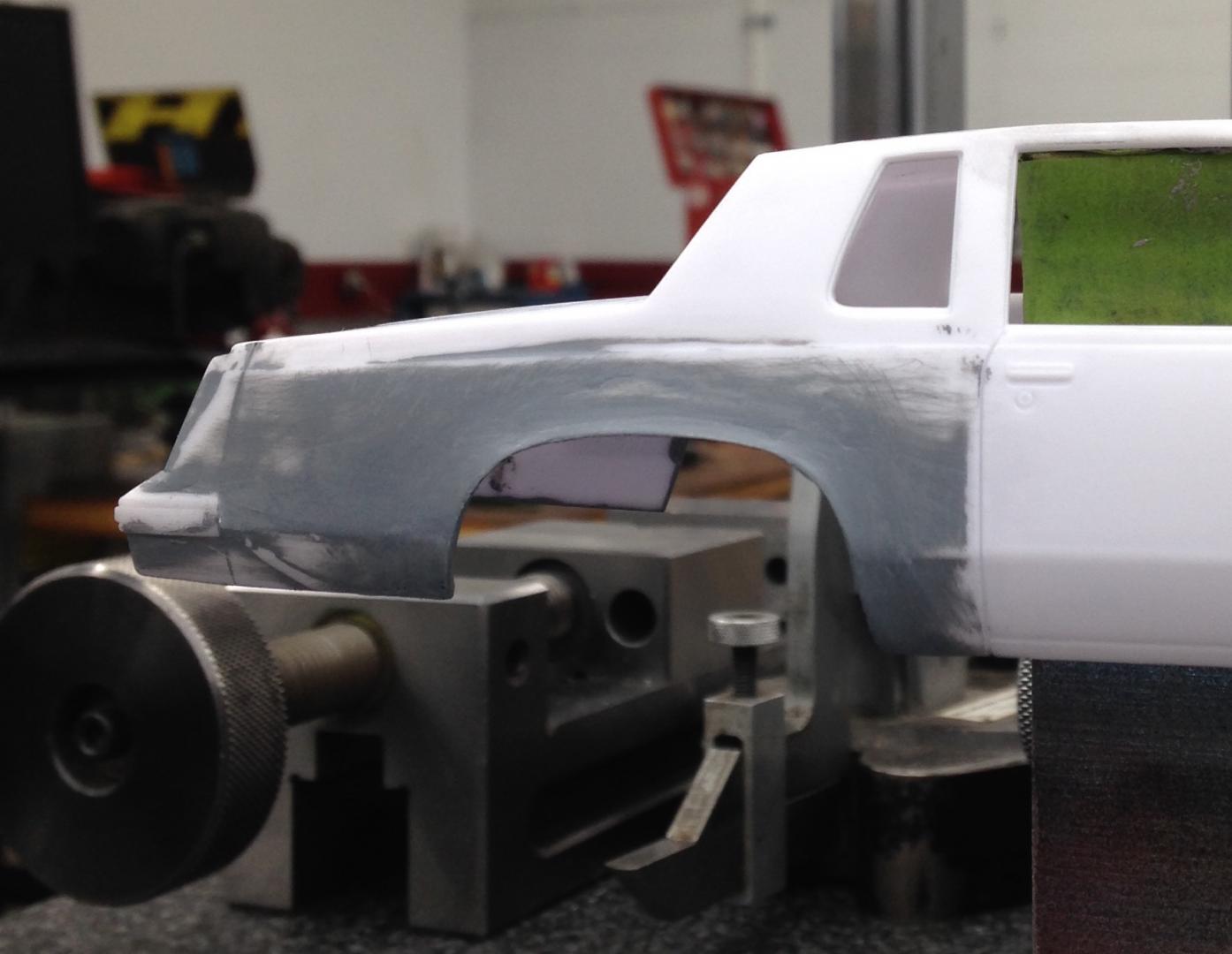

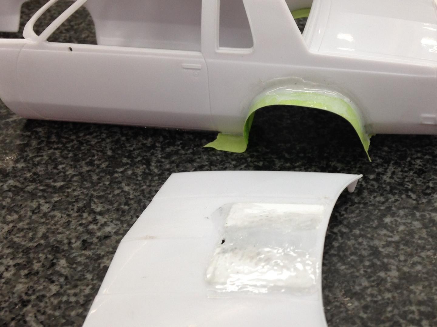

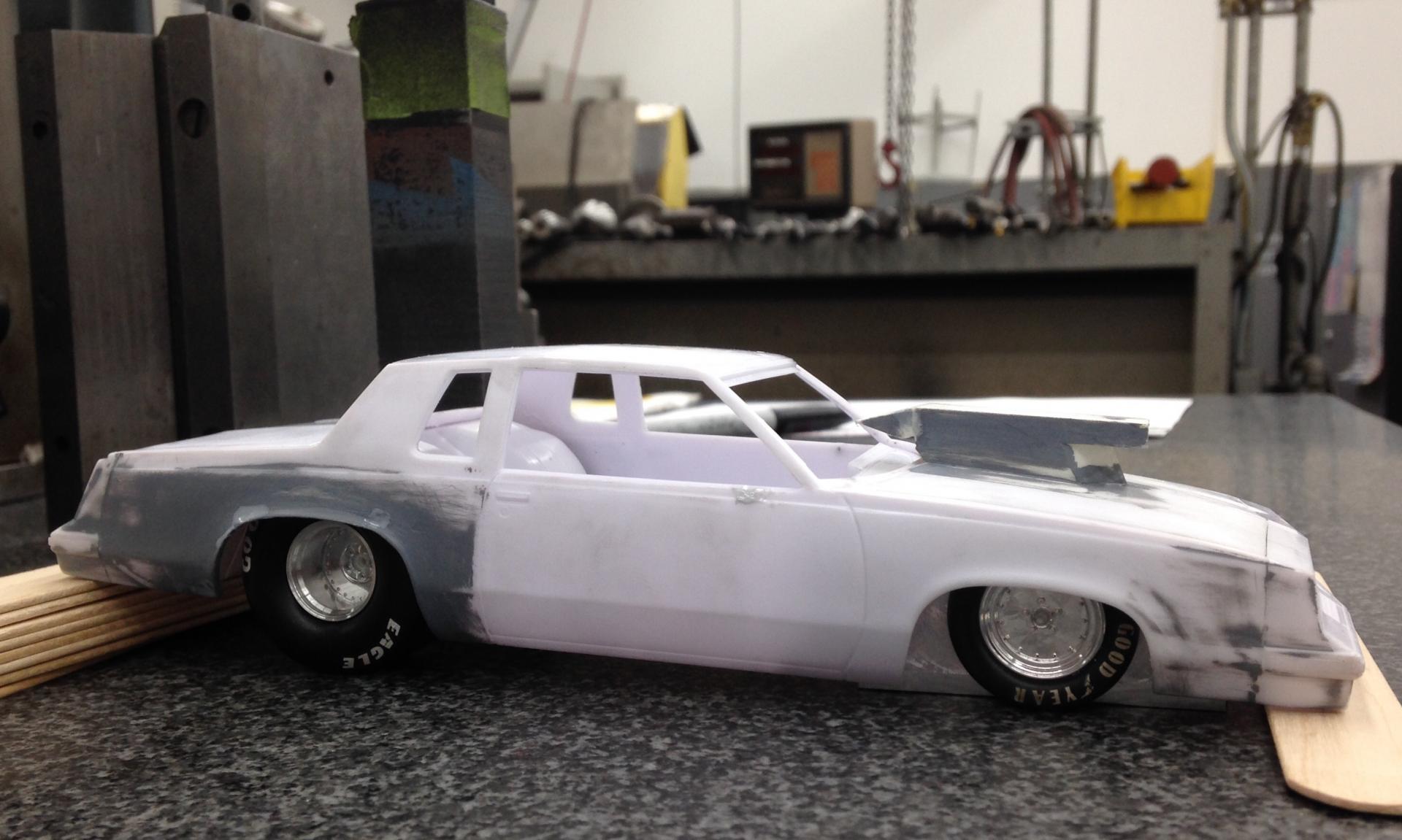

jeff f Posted September 28, 2017 Share Posted September 28, 2017 (edited) I just received the Slixx Warren Johnson Black 83 Olds decal . Started mockup of wheel / tire to body . Using cut down Monogram Goodyear Frontrunners on old MPC front wheels . Backs are nylon with aluminum rims and an old AMT center from the 55 Chevy sedan . I got rid of the hump on the hood and enlarged the back wheel wells and reastablished the flair . Using the Charles Carpenter 55 for the rest .Hope it turns out ok . Thanks for looking Jeff . Edited November 2, 2017 by jeff f Quote Link to comment Share on other sites More sharing options...
cobraman Posted September 28, 2017 Share Posted September 28, 2017 That's going to be very cool ! Quote Link to comment Share on other sites More sharing options...
Dodge Driver Posted September 28, 2017 Share Posted September 28, 2017 Looking good there. Definitely has the look of an 80's Pro Stocker.Is that Dykem layout fluid on the fenders? I always assumed it would attack styrene. Quote Link to comment Share on other sites More sharing options...

Codi Posted September 29, 2017 Share Posted September 29, 2017 Excellent start to it Jeff. The stance is oh so right. cheers, tim Quote Link to comment Share on other sites More sharing options...

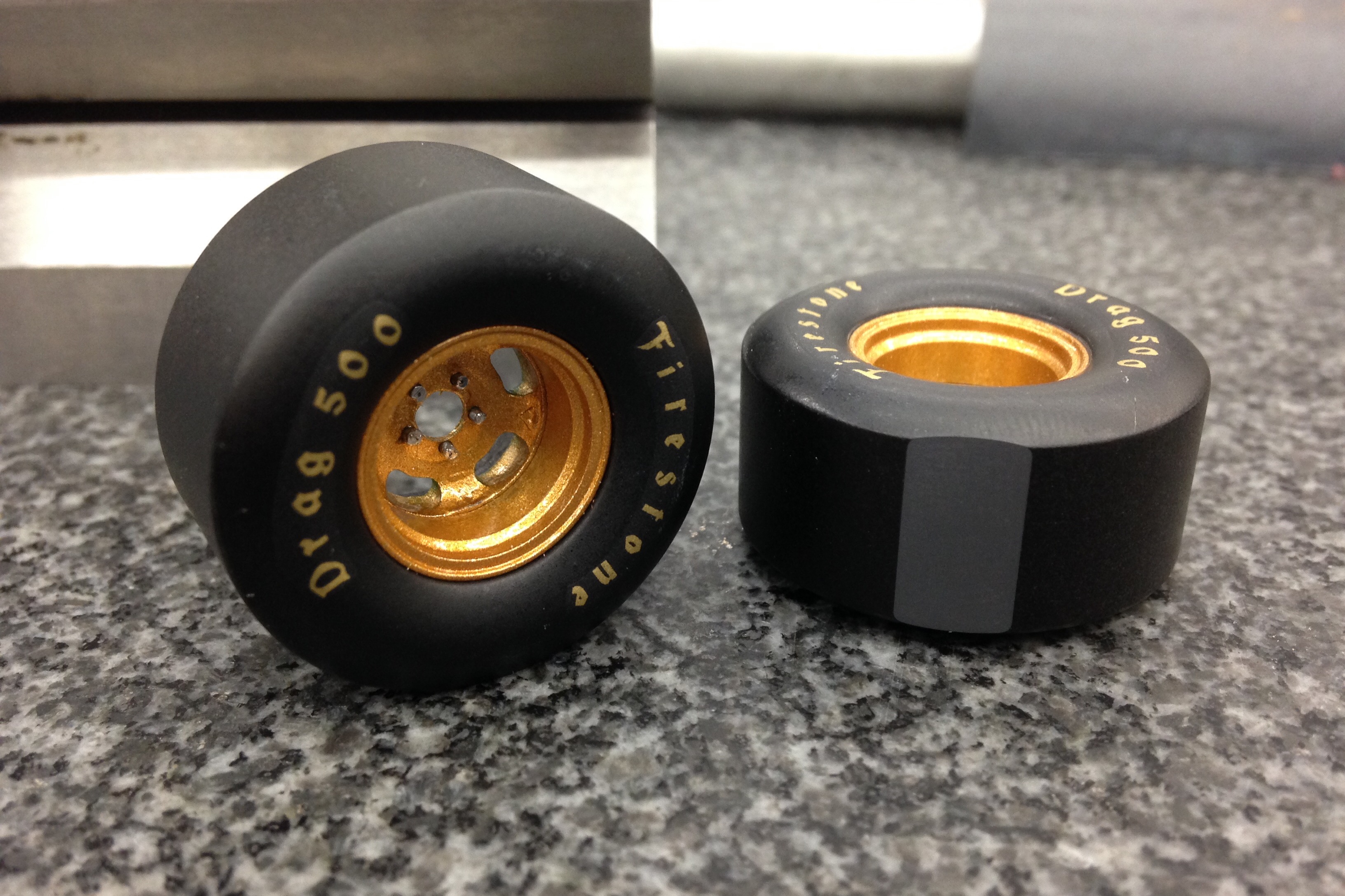

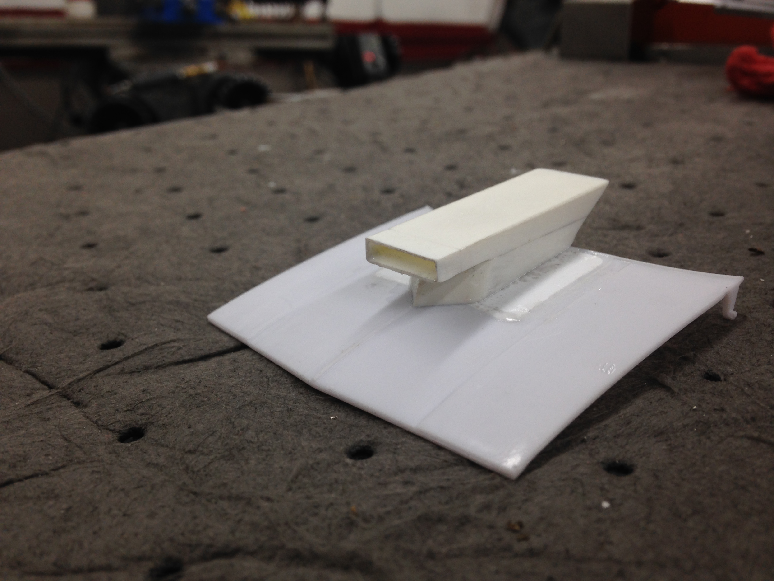

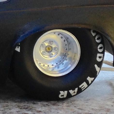

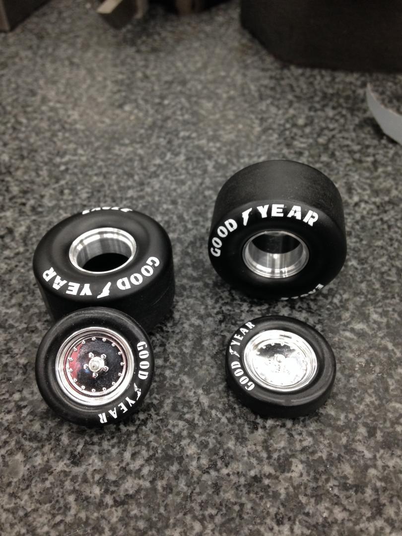

jeff f Posted September 29, 2017 Author Share Posted September 29, 2017 Thanks everyone , I machine my slicks from nylon . I was shown this tip by Dave Fletcher at Portland Modelfest this spring . Mix liquid glue and bits of evergreen to make a filler . Awesome , No shrinkage at all . You can teach an old dog new tricks ! The scoop is Monogram with the droop removed . Thanks Jeff . Quote Link to comment Share on other sites More sharing options...

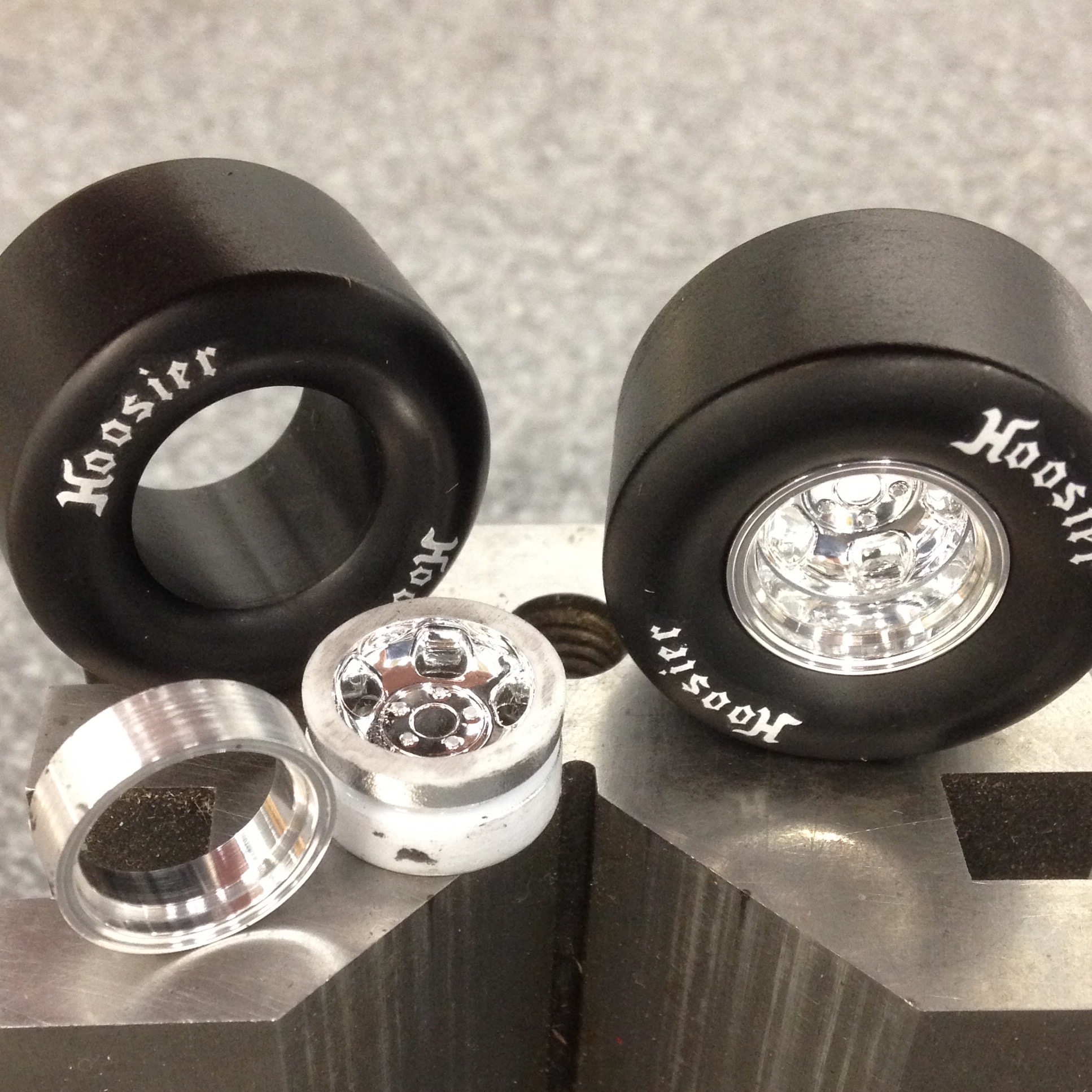

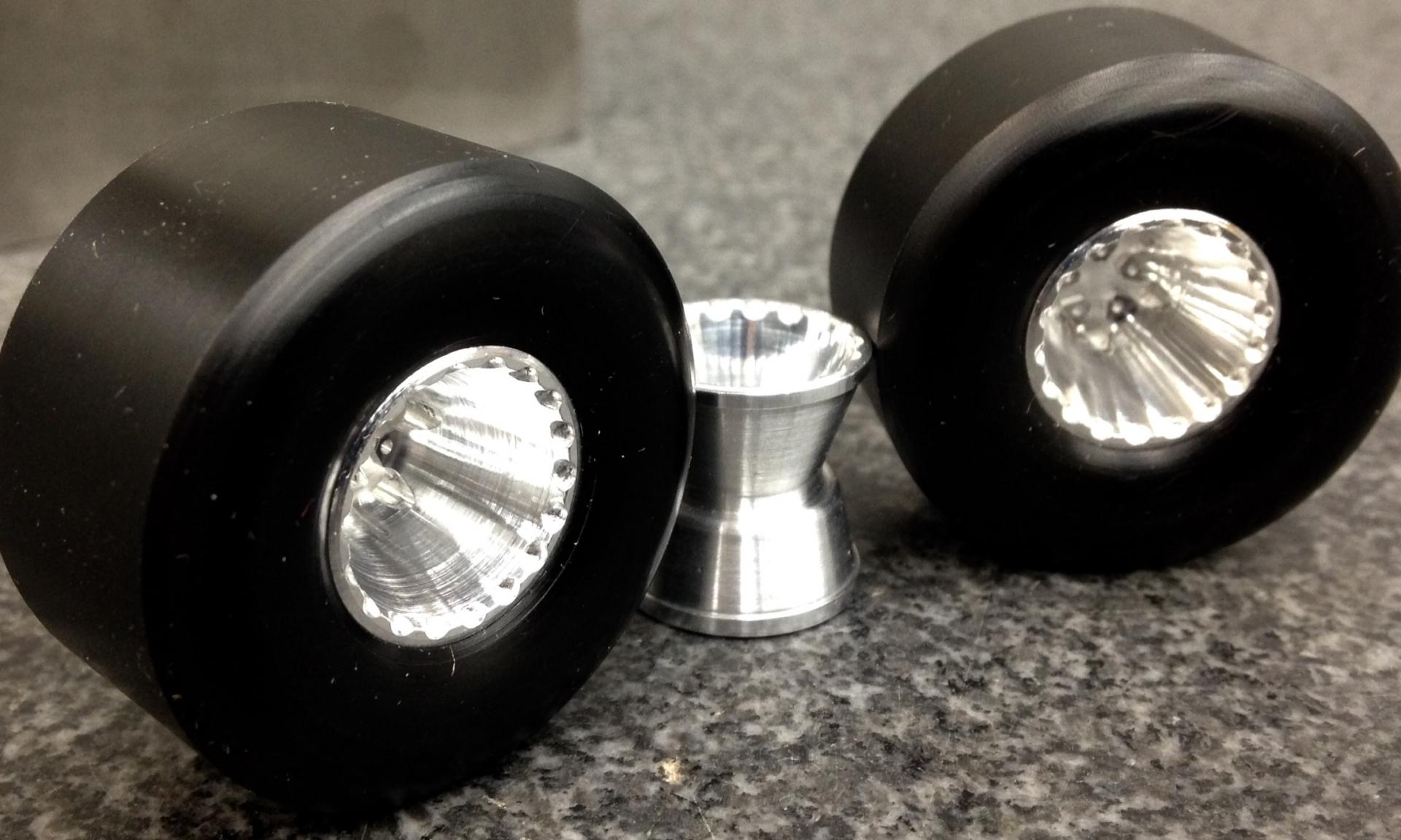

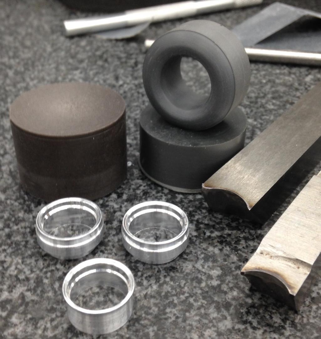

10thumbs Posted September 29, 2017 Share Posted September 29, 2017 Hi Jeff, looking very good.Question, if you don't mind. 'Machining slicks'....what do the beginning object look like? The tires look just great.Also, the metal rims. Can you give some insight to the origin?Greetings, Michael Quote Link to comment Share on other sites More sharing options...
Davewilly Posted September 29, 2017 Share Posted September 29, 2017 Looks pretty good so far! Quote Link to comment Share on other sites More sharing options...
jeff f Posted September 29, 2017 Author Share Posted September 29, 2017 Michael , I'll do my best explain . I use plain back nylon round stock , drill and bore to size . I E , 15 " is 15.75 to 15.875 lip to lip = .634 in 1/25 scale . Part off and mount on an expanding mandrel , then finish OD . I made some form tools for the sidewalls . Also make the OD slightly curved like a tire with air in it .Last I mill flats across the OD to show weight on them . The rims are made from aluminum bar stock T73 7075 . Quote Link to comment Share on other sites More sharing options...

iBorg Posted September 30, 2017 Share Posted September 30, 2017 How big of a lathe? Quote Link to comment Share on other sites More sharing options...

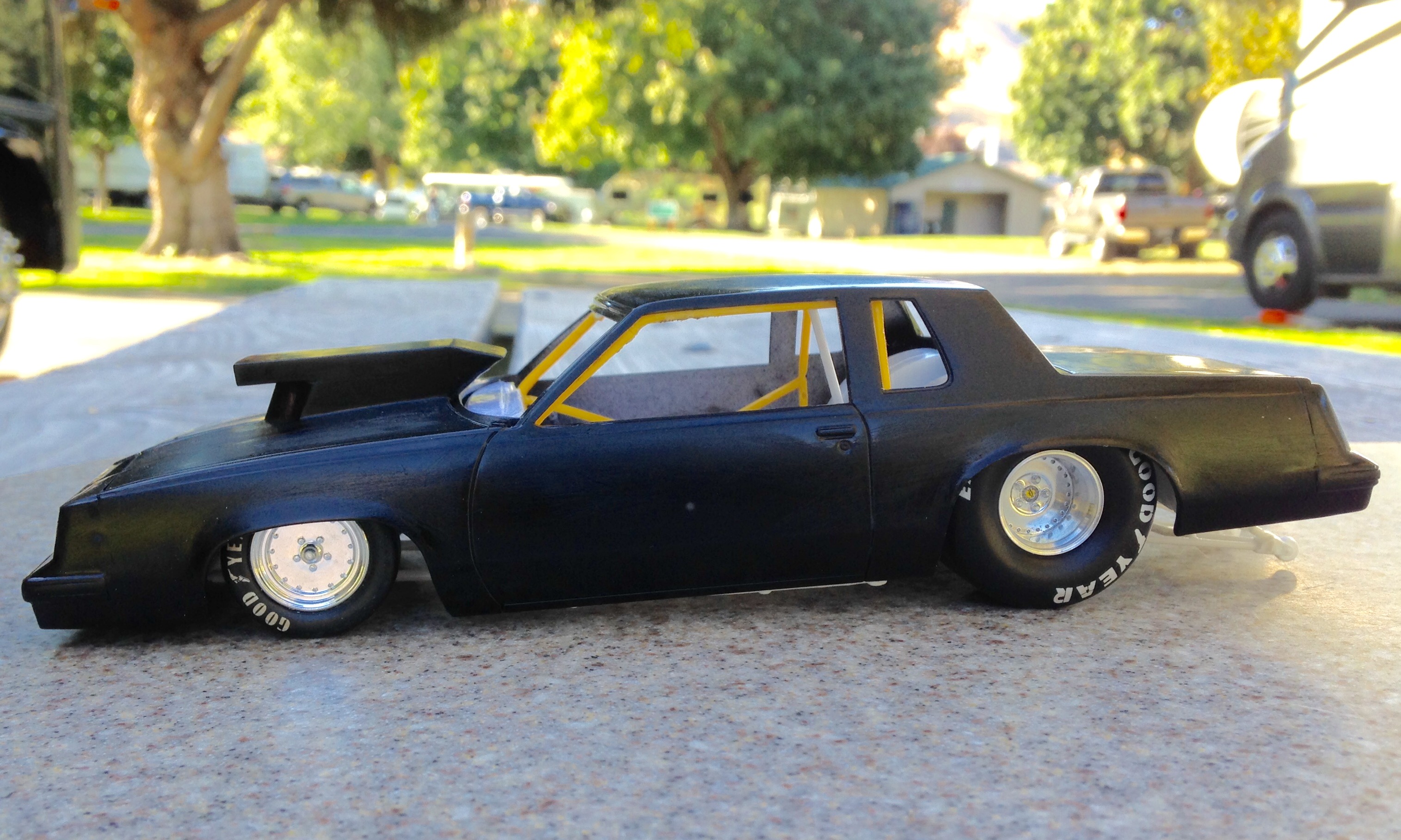

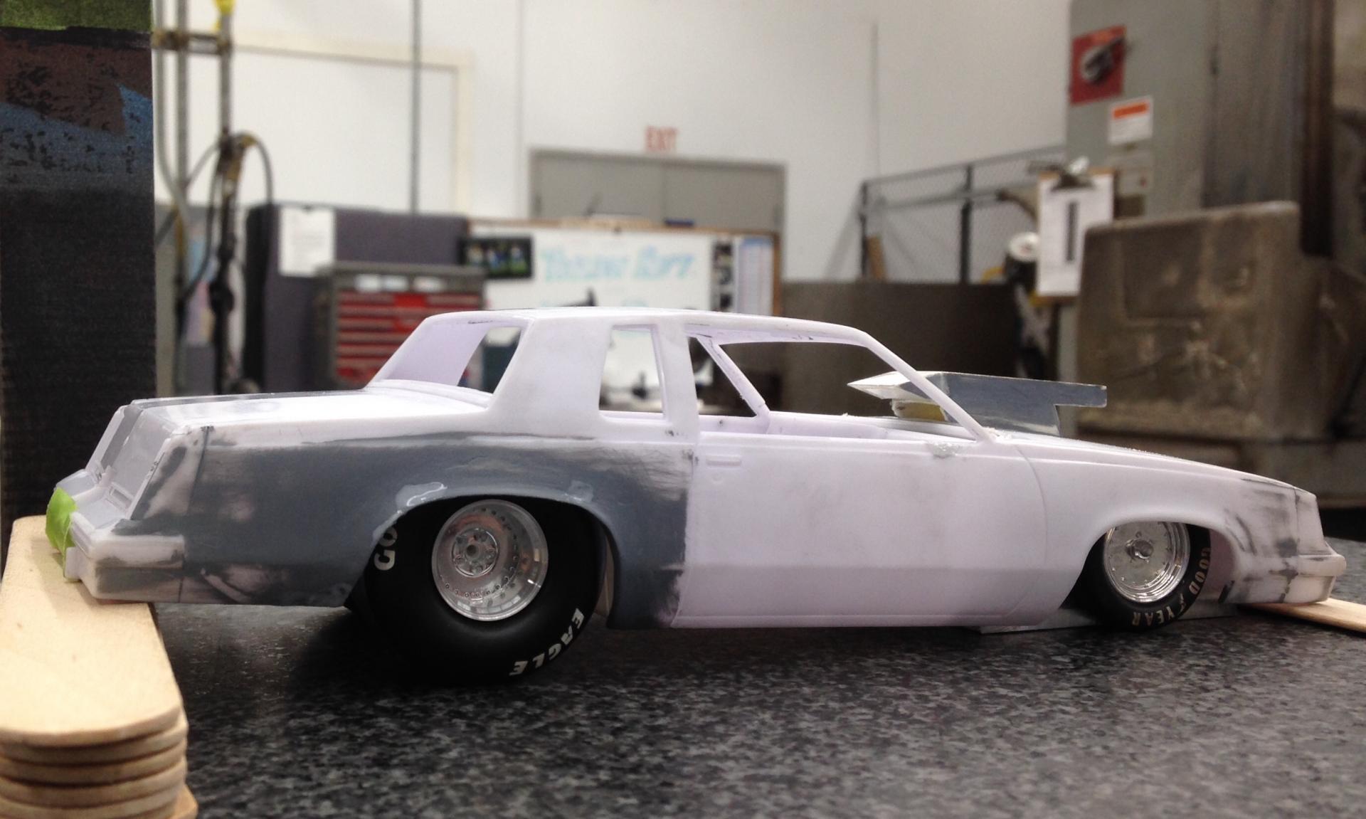

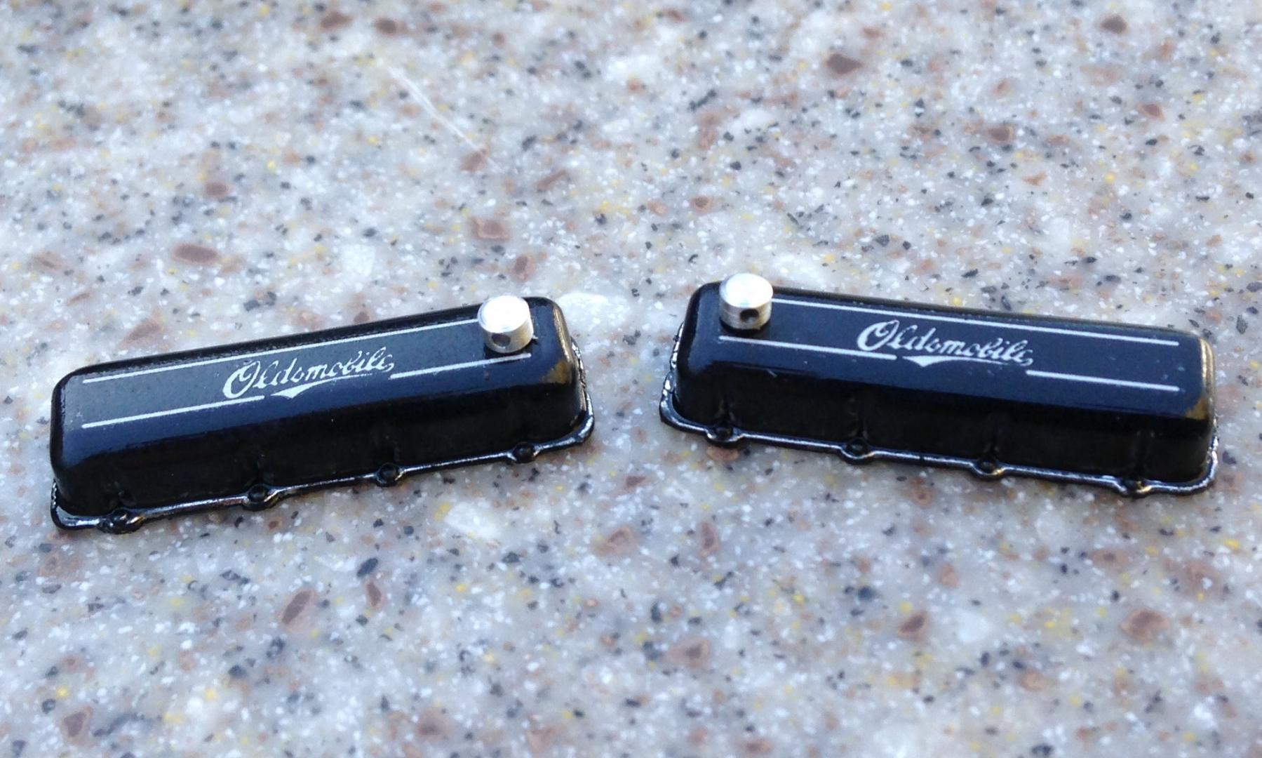

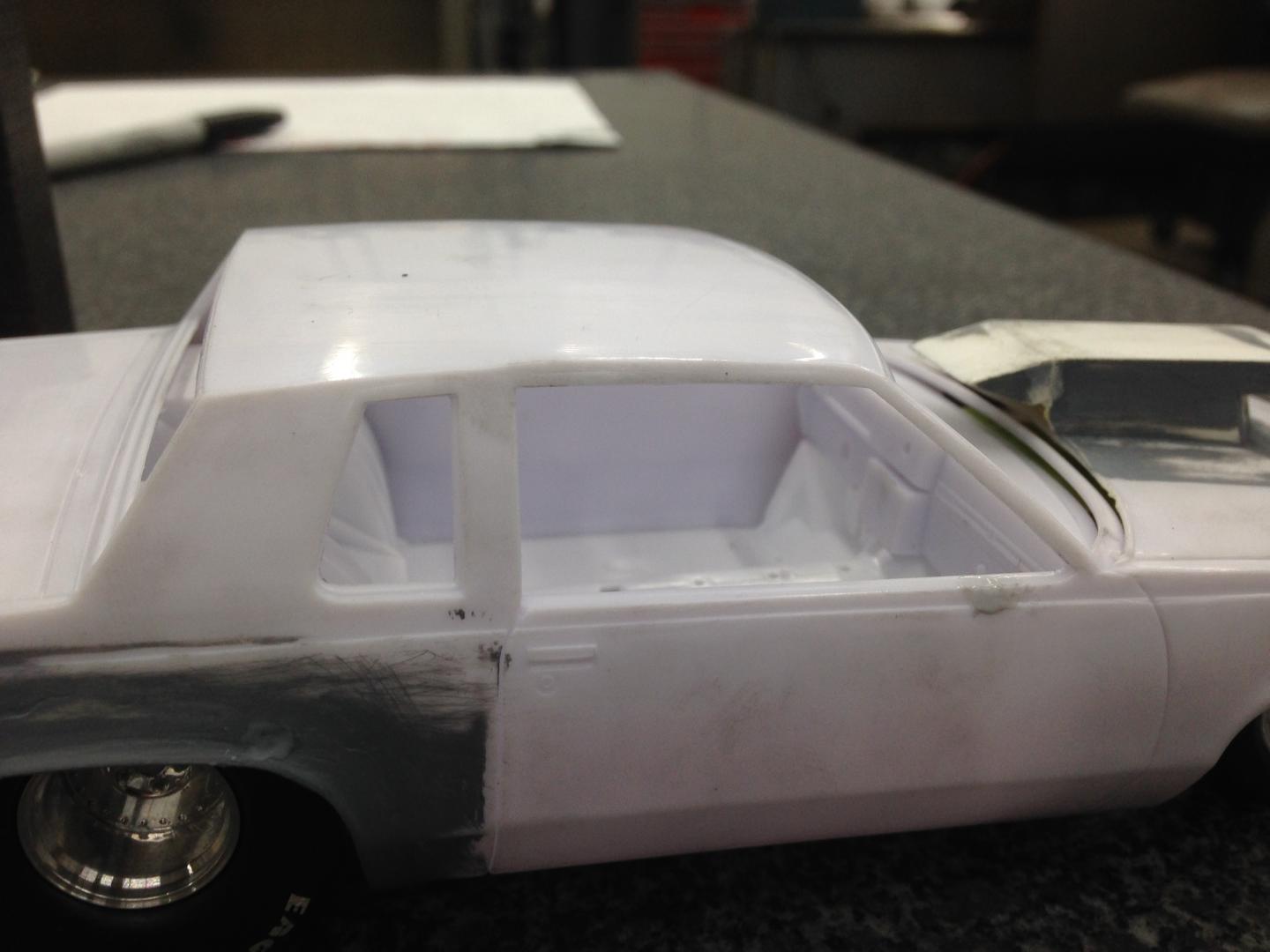

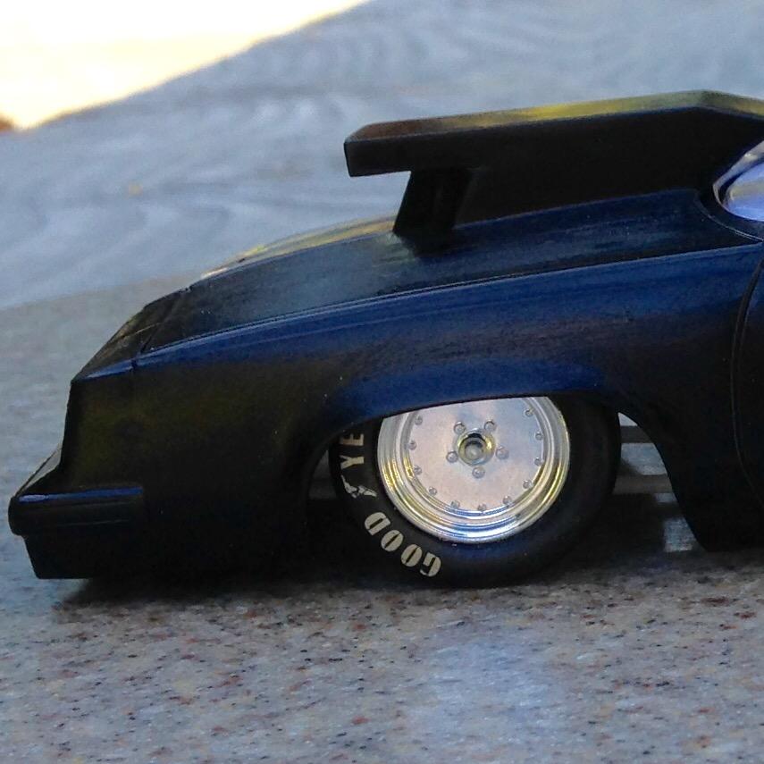

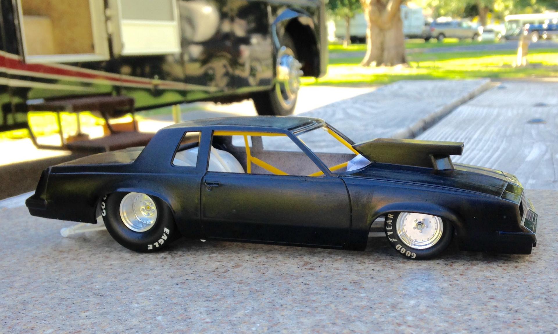

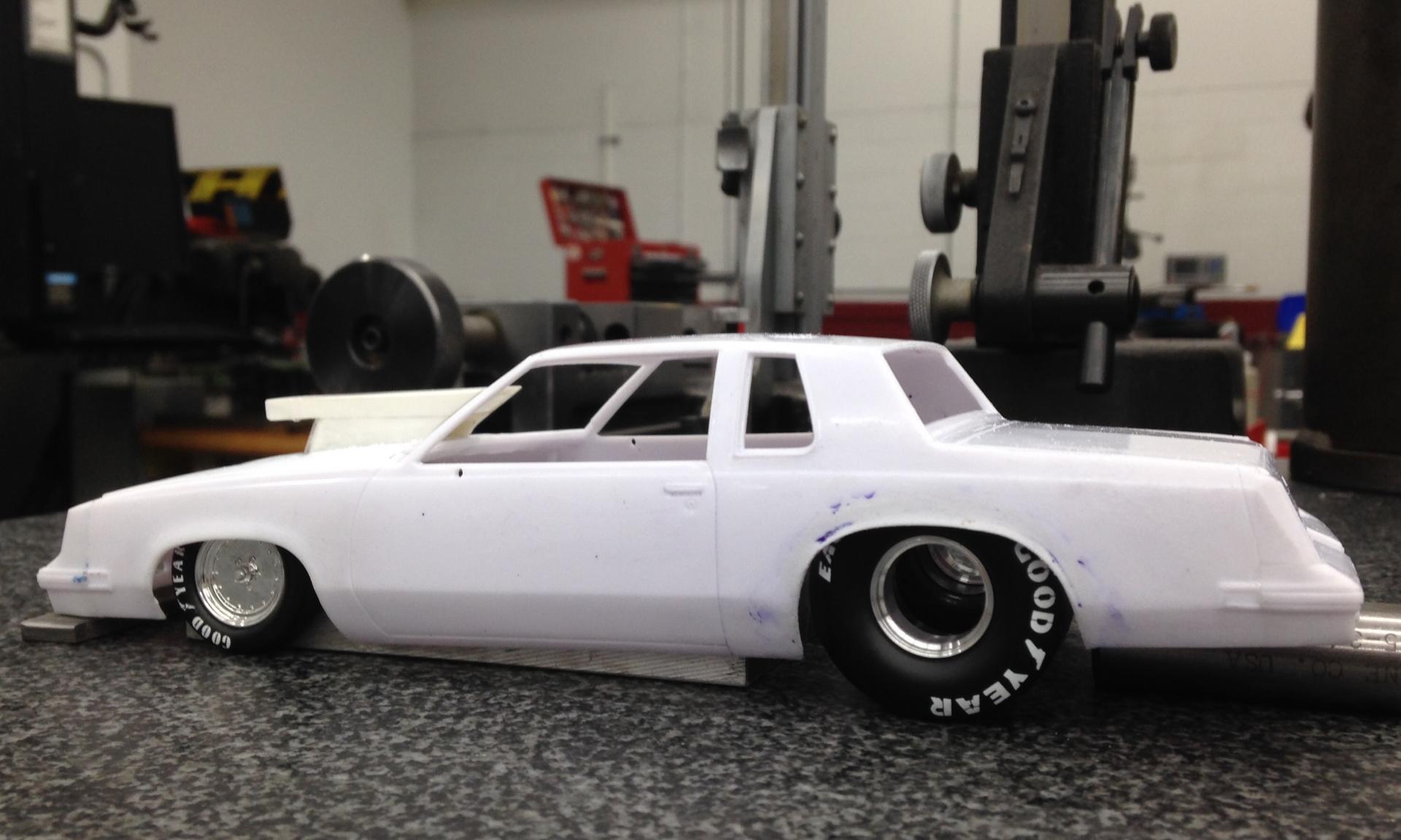

jeff f Posted October 3, 2017 Author Share Posted October 3, 2017 A small update , chassis pan and dash fitted . I weathered the tires , fronts more so . Tipped the back of the scoop downward , still need to fill in as needed to match windshield . I robbed the valve covers from the 88 Olds PS kit . It looks like the Monogram Camaro PS roll cage side pieces will work out as a starting point . Thanks for looking in , Jeff . Quote Link to comment Share on other sites More sharing options...

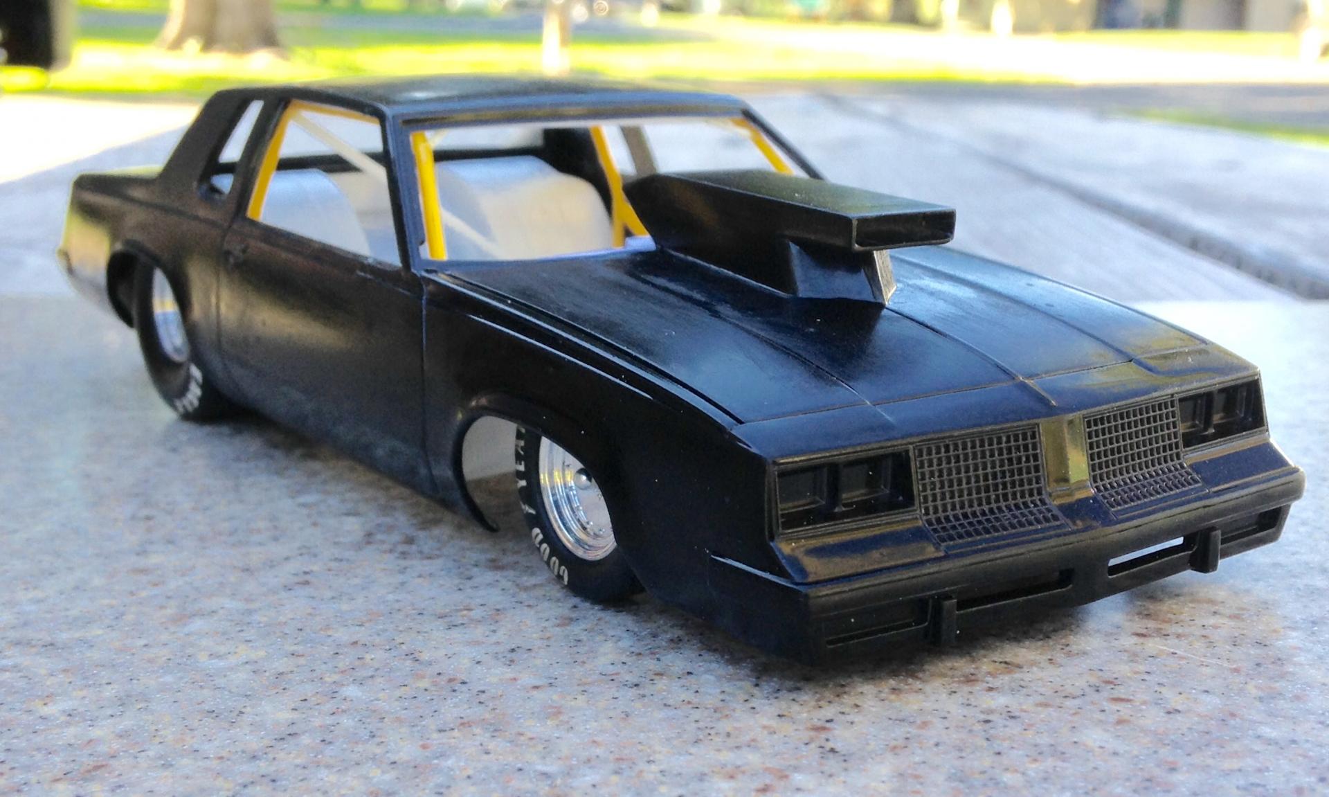

jeff f Posted October 8, 2017 Author Share Posted October 8, 2017 Weekend update while at Lake Chelan enjoying the vintage unlimited hydroplanes . Pretty happy with the stance and tire placement in the wheelwells . I really like the valve cover and axle decals , thank you Slixx . Time to start painting . Again thanks for your time Jeff . Quote Link to comment Share on other sites More sharing options...
NYLIBUD Posted October 9, 2017 Share Posted October 9, 2017 The car looks great.Again the stance is dead on perfect.The cage is coming along really nice too.Keep the pics coming. Quote Link to comment Share on other sites More sharing options...
