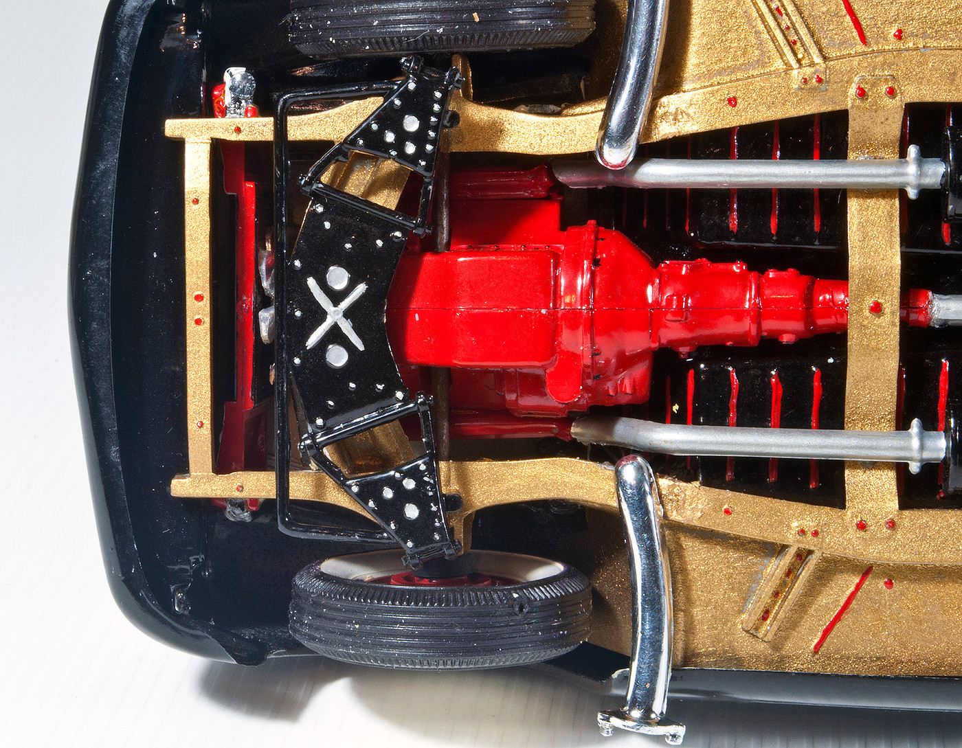

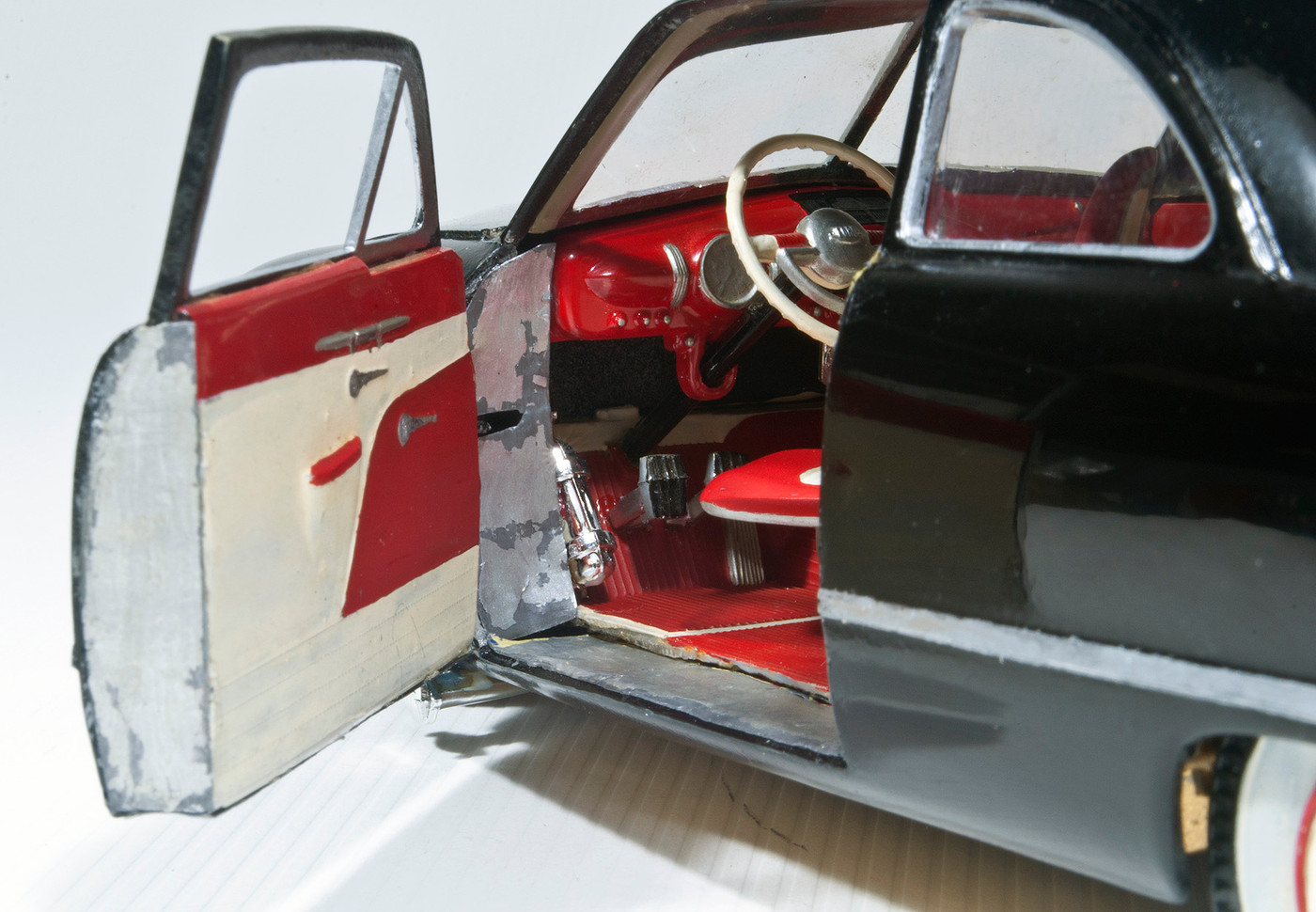

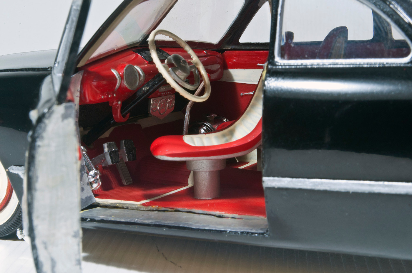

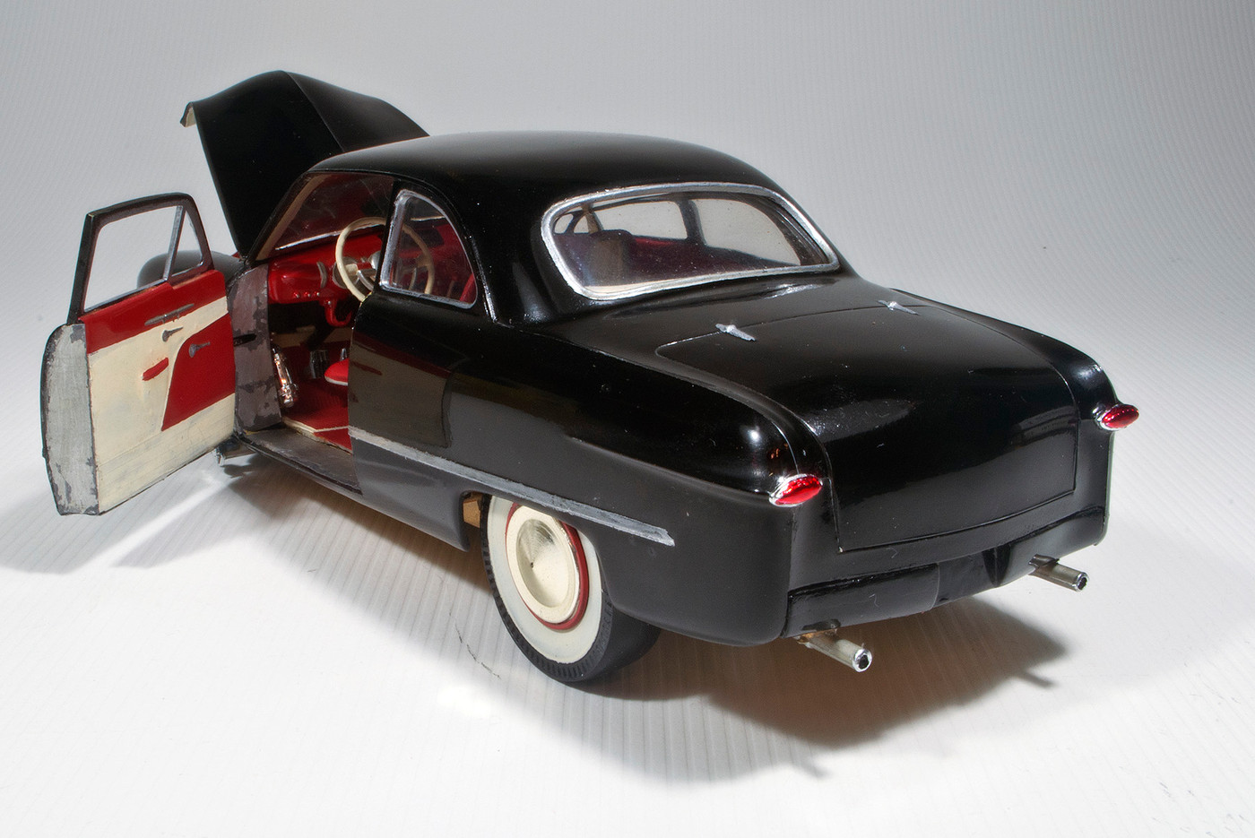

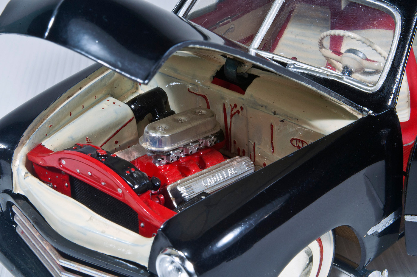

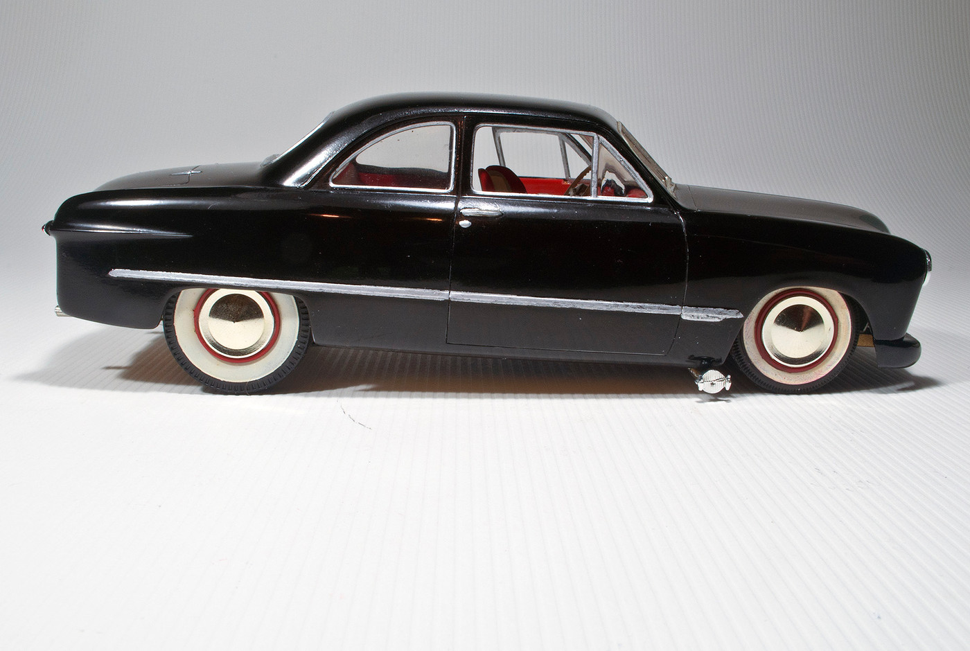

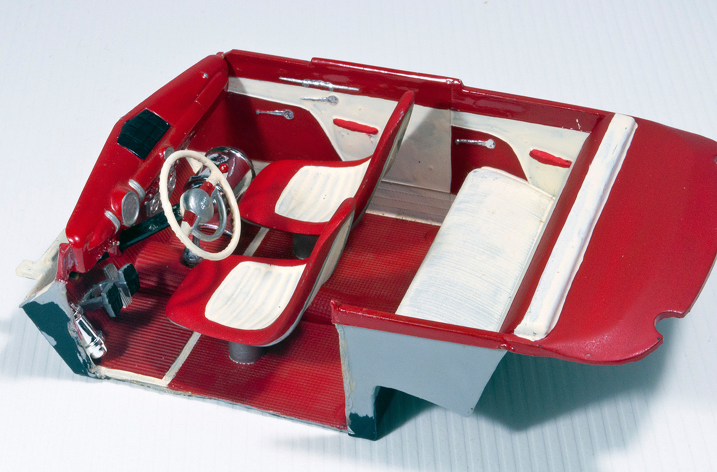

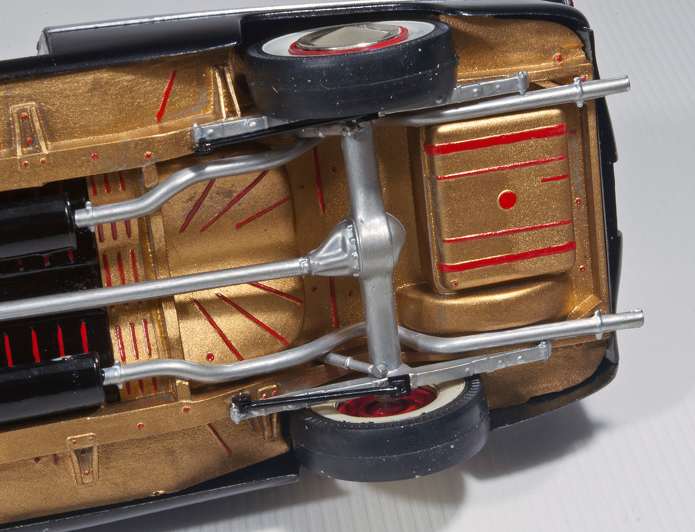

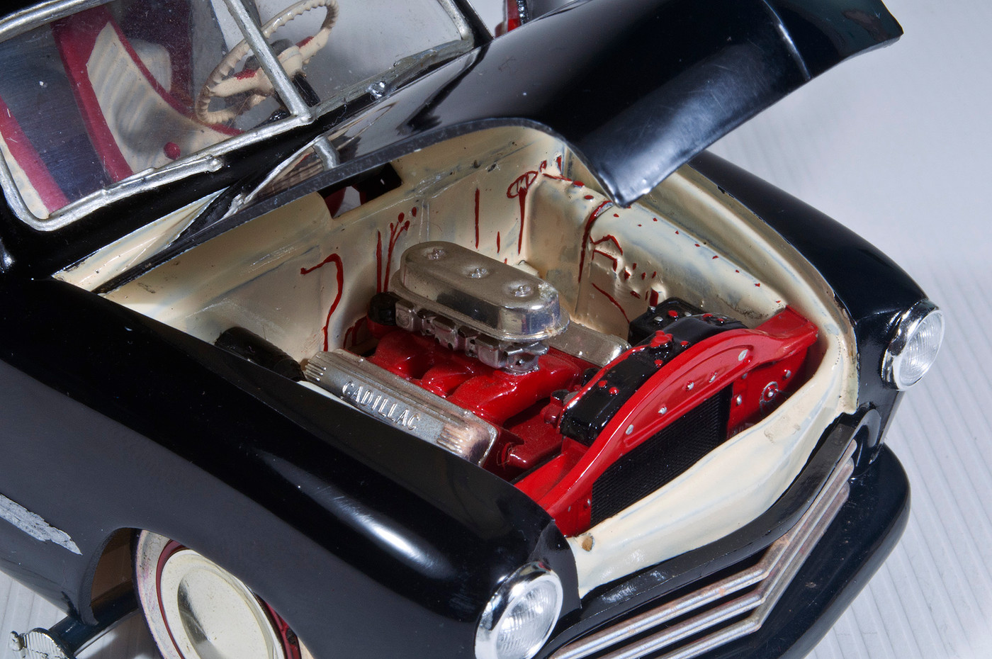

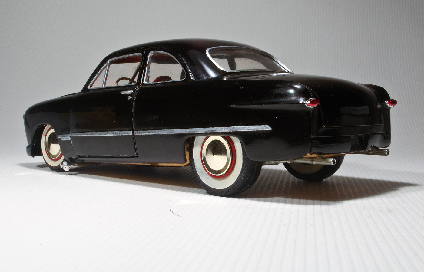

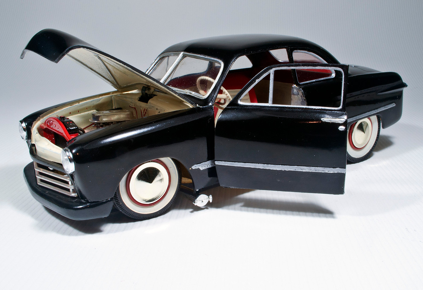

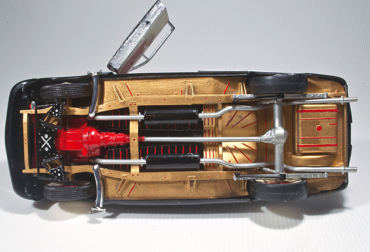

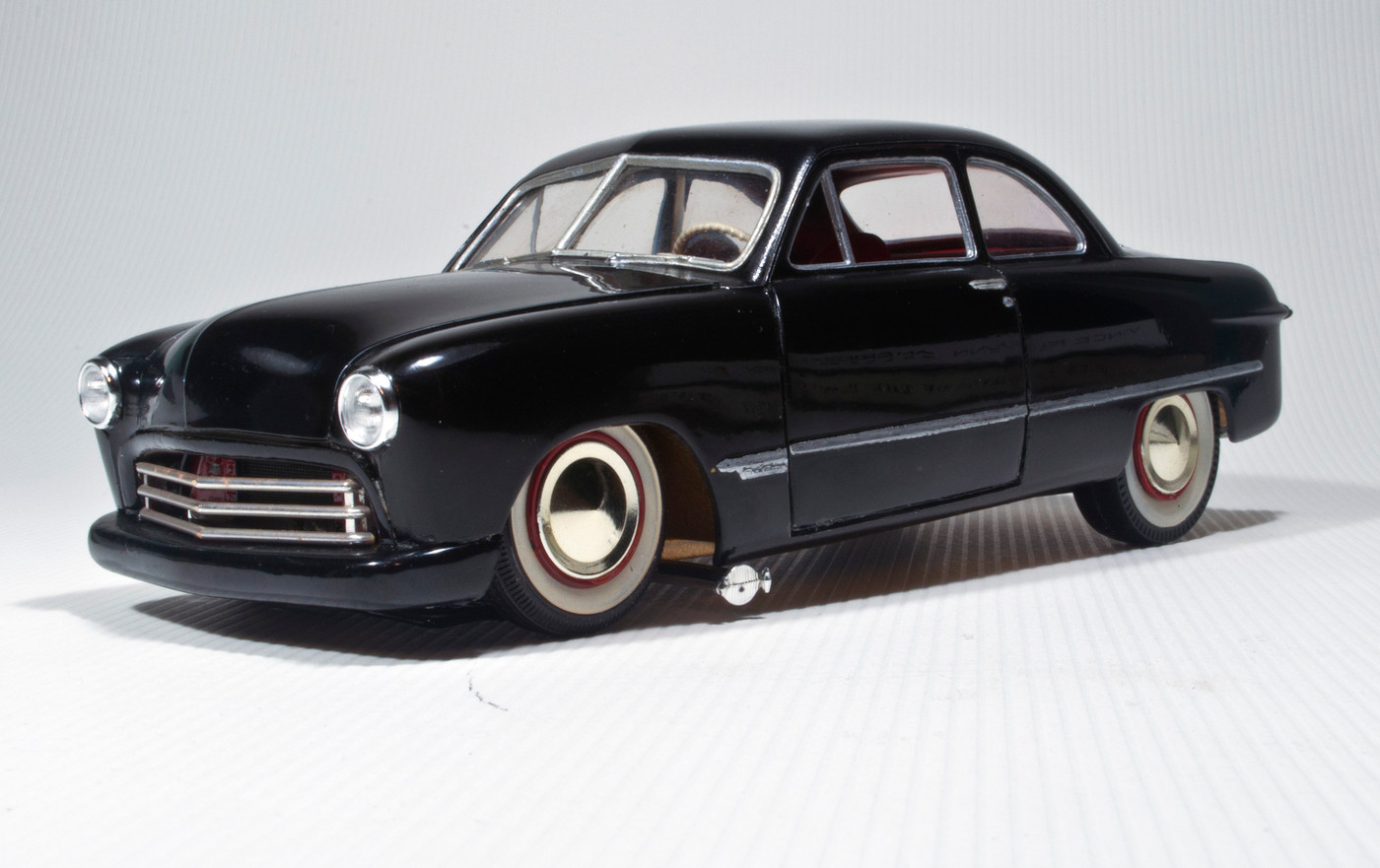

Early this year I picked up this vintage custom/hot rod build from the 1960s of AMT's great '49 Ford Club Coupe from one of the guys in my club. I recently took it apart for cleaning. polishing of the old black paint, repair, and refurbishment with very minor changes. I detail-painted the window and side molding in Testors silver, and sprayed the interior with Dulllcote 'cause it was REALLY shiny under the dust and dirt. The original builder was a detail-painting madman with a very steady hand – check all the little red and silver bolts and rivets and the snappy red details on the underside. Of special note is the opening door with a single wire hinge and the door jam and door edge filler panels made from metal from a Testors glue tube.  The tires have hand-painted WWs on both sides and the original builder set the killer stance with wheels and hubcaps from the first-issue '40 Ford coupe. I replaced the head and taillights because the chrome was badly oxidized and the broken and missing traction bars and lake plugs. Putting this old model back together was a great slump-buster!

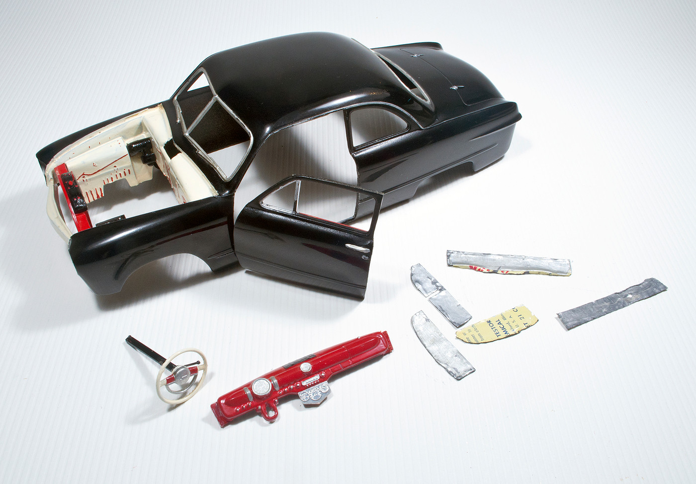

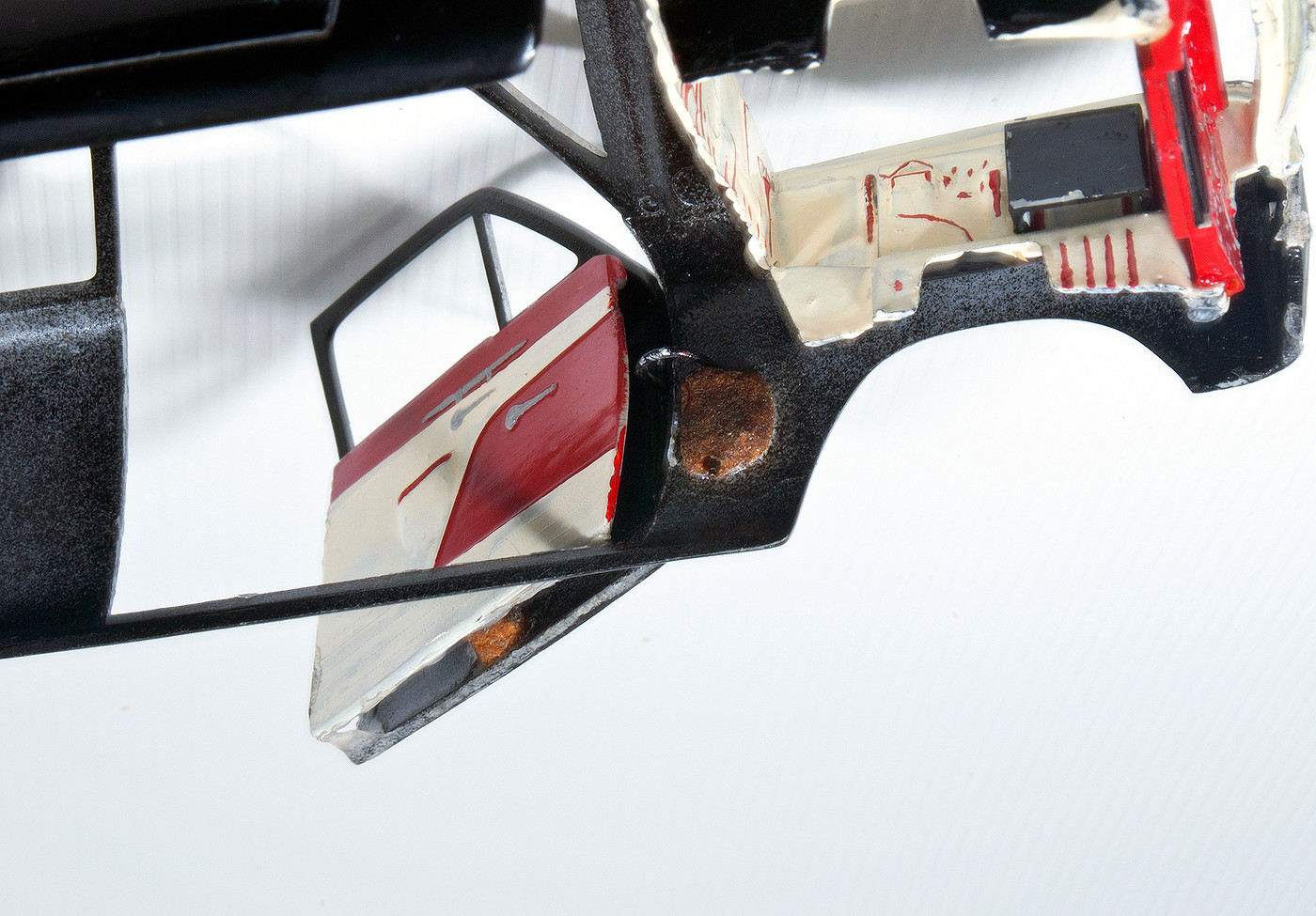

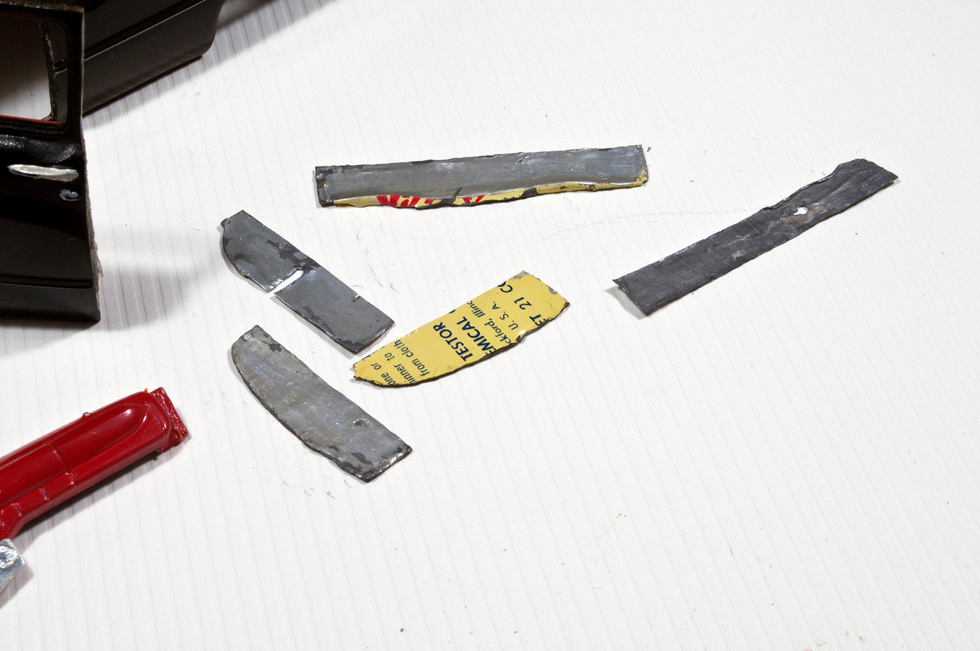

Some shots during the rebuild. Any idea what the hard blobular material is that he used to make the hinge block? it is very hard, with a rough surface.

That blob hinge looks like it might be an old putty called "plastic wood".
That was exactly my first thought too.
Share this post
Link to post
Thanks, Rich. I was thinking that's what it might be. I just don't remember PW being so hard or grip so tightly to styrene.

Nice job of saving this car, however I do have a question.  How do you or for that matter any other builders out there take apart old models?
I have attempted it in the past and end up with nothing but broken pieces every where. The glues usually have had the parts welded together.
Thanks, Mike. This one came apart very easily. The builder used cement very sparingly and, for those most part, didn't follow the instruction to scrape paint or plating from areas being joined. A gentle prying with an xacto was mostly all that was required to separate the parts. When I'm looking for an old model to rebuild I try to get the cleanest build I can afford.  More often than not if it's painted neatly, the builder was also careful with the cement.  If you must by something close to a gluebomb, watch for waving, distortion or sinkmarks on the outside from too much cement on the inside. many of these old models have fender skirts cemented on – rather than prying them off, to avoid breaking the body, I often use a dremel tool and slowly grind them off. A little more money spent on the $40 model may save you a lot of time and effort working with the $20 model.
