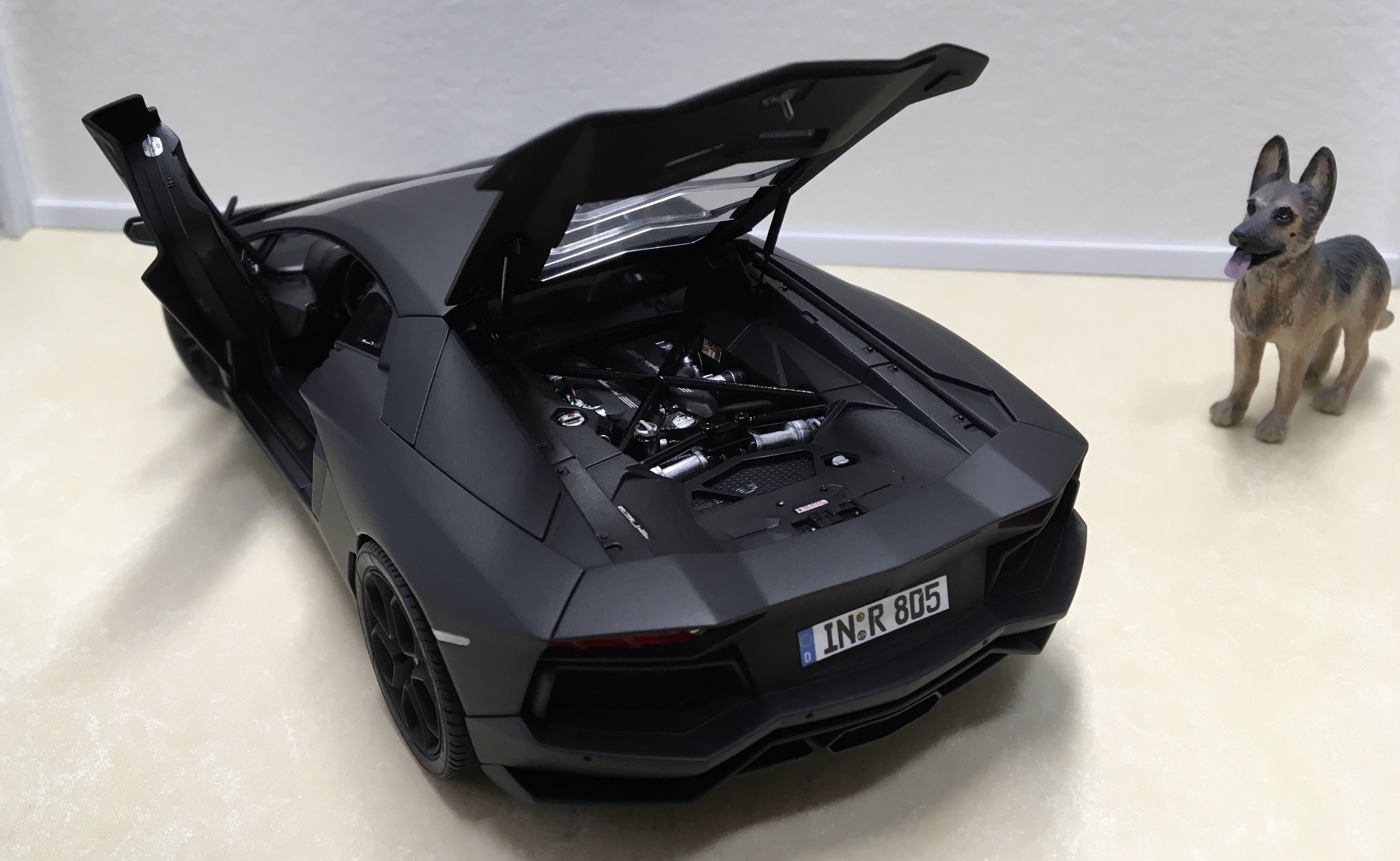

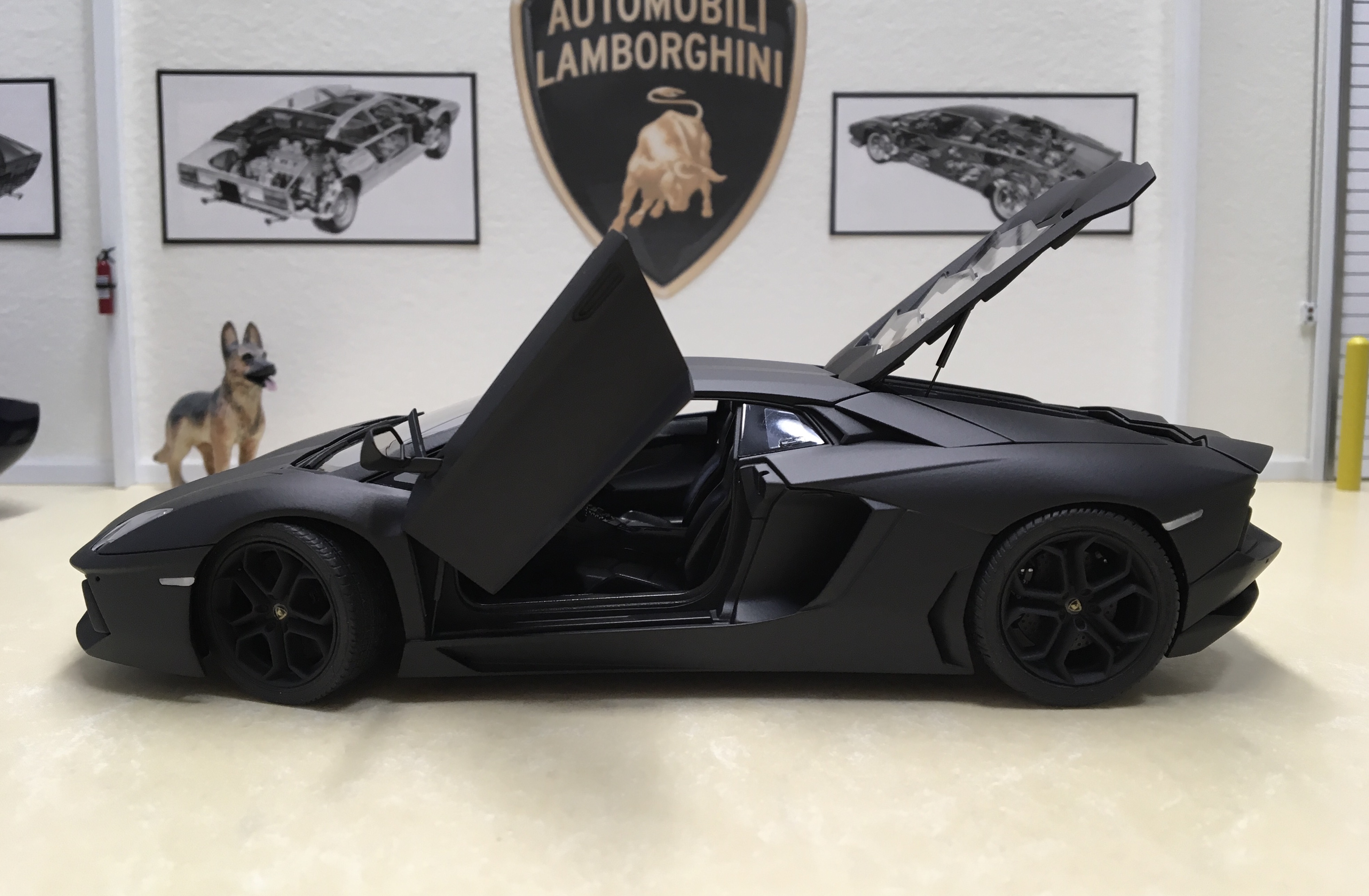

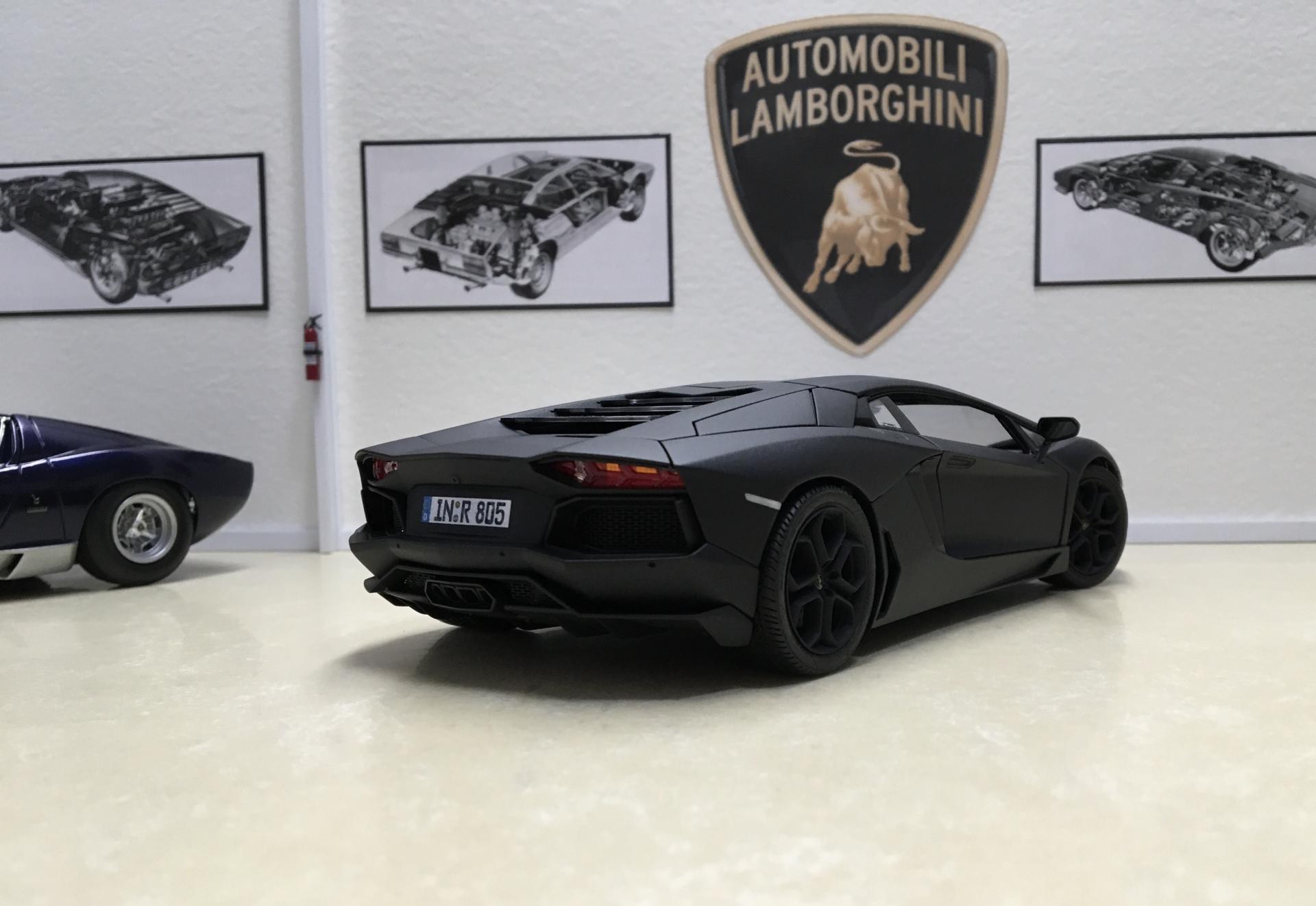

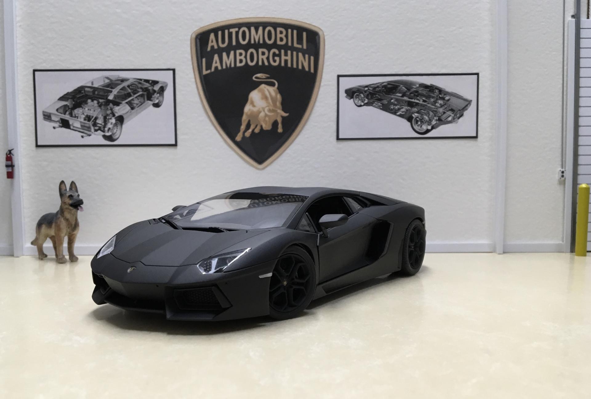

I think the Aventador is Lamborghini's last beautifully designed car- everything else has been a freak show of cars. This is the Aoshima full detail kit, which is actually what I refer to as a 3/4 detail kit, but with all the wiring and hoses I added, it looks like a true full detail kit.

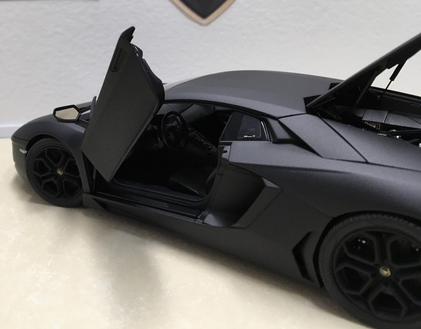

I knew I had to do it with a stealth like look, but the down side to it is that it is very hard to see all the detail and work that I put into it. For example, I painted the interior using 6 different shades/finishes of black, and it took a LOT of careful masking.

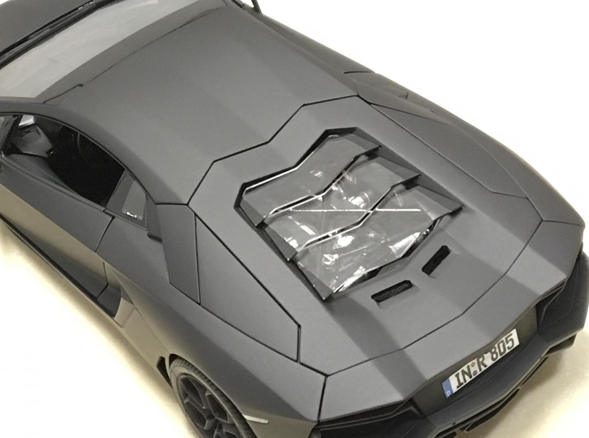

Body details: I used a different mesh pattern , 3D badging and center caps, blended one piece hood, valve stems, door and hood latches, prop shocks for doors and hood, scratch built hood hinges, and deleted the third brake light and tail light lenses (I think it looks much better without them).
Interior details: Seat belts, scratch built floor mats with raging bull emblems, velvet carpeting, door reflectors, anti-theft towing switch, door weather stripping, and photo etch radio face to cover up the weakly detailed molded in one.
Engine details: Radiators/inner coolers behind side vents, numerous wires, hoses, wrapped wiring harnesses, compression fittings, heat shield, and cooling fans behind the rear mesh.
Hope you liked it! ......thanks for stopping in to check it out!!

Thanks for checking it out!, glad you liked it!, my German Shepherd is extremely well trained......I bet he could stand in the same position without moving longer than anyone!
Superb!
Exactly as I would spec it from the factory.
Super clean, by the looks of it. The diorama with the cutaways on the wall, is a nice touch.
I hope that dog doesn't cock his leg, on one of the tyres!
