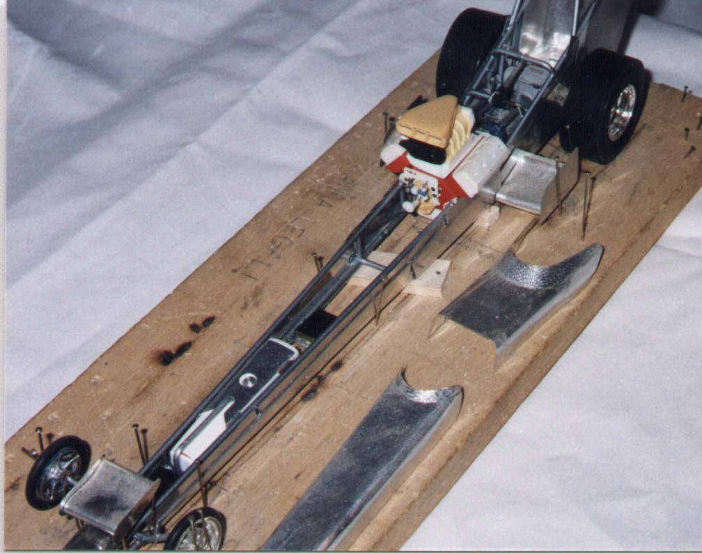

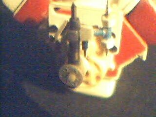

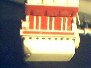

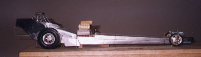

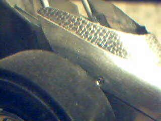

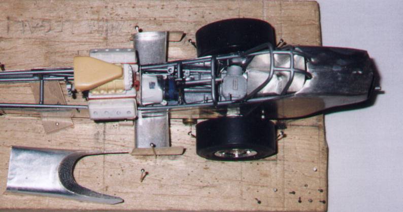

Straightliner59 Posted October 14, 2017 Author Share Posted October 14, 2017 Thanks, Dave! I agree. It is more fun, outside the box! That dragster's looking great! Here's something I was working on, back in the late '90s. Never finished it, but I learned a lot during its construction. It's 1/25th scale, brass chassis, aluminum body panels, nose and tail hammered, formed and soldered tin. Sorry for the crappy photos. If I can dig this thing out and put it back together, maybe I'll shoot some new ones. Thanks again! Quote Link to comment Share on other sites More sharing options...
