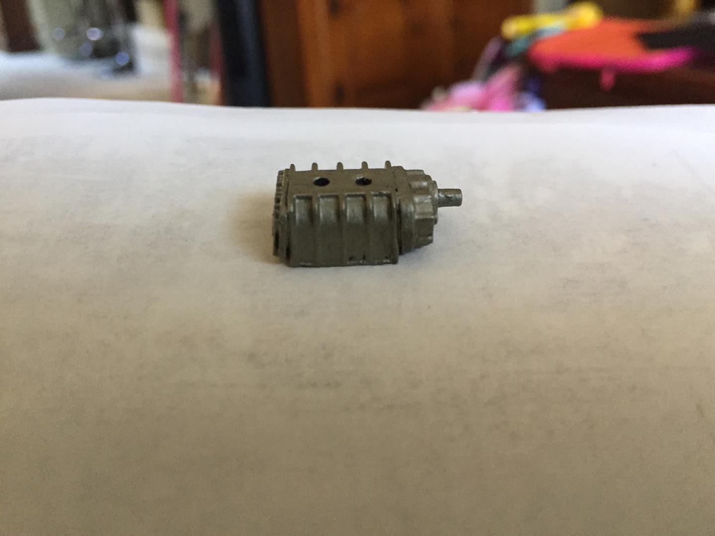

I've been doing some research on options for replicating the Dow-7 coating used on magnesium wheels. I haven't had much luck in finding a specific brand/color to paint the wheels for my project. Part of the issue is that the real coating doesn't last very long and will darken as it ages from a greenish/gold to the gray.
Here is something I came up with last night. Its basically just a 50/50 mix of Testors Gold and Flat Green although I feel a touch of gray to darken it might have helped.

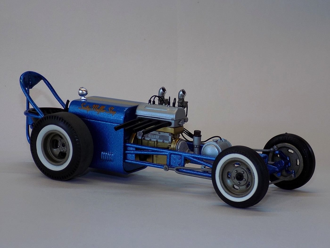

I've done several sets of model wheels using the following procedure to get the DOW-7 look:
1) Duplicolor Gray Sandable Primer (which is a dark gray.)
2) Brush on Testors Model Master "Jet Exhaust"
3) 24 hours later seal in Tamiya Semi-Gloss Clear
Here's an example picture of one of my dragsters that shows the result.

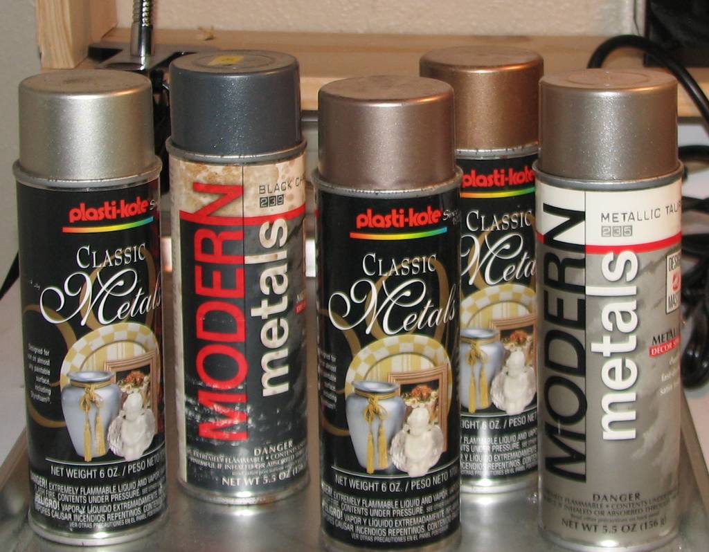

I picked these up several years back at various locations (Michael's, maybe Walmart, and Crafts Direct in St. Cloud, MN). I've used them for replicating different metal finishes. Yesterday at Hobby Lobby, I saw a can of Krylon that looked as if it might be perfect for replicating newly-treated Dow 7. Sorry I can't recall the color, but it was in a large can, and looked very close, and the flake appeared more metallic than metalflake. I wish I'd picked it up.

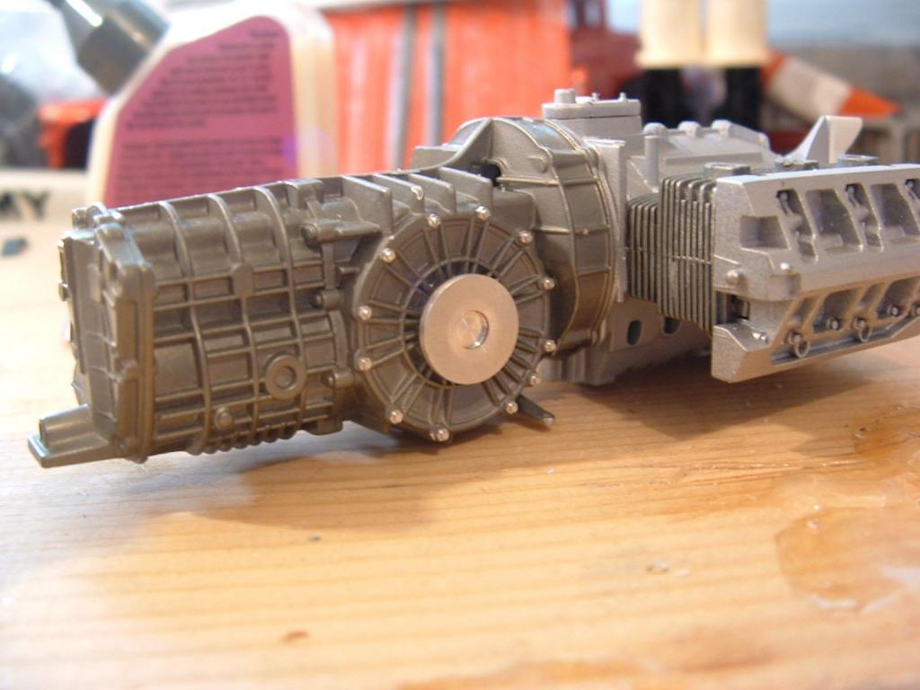

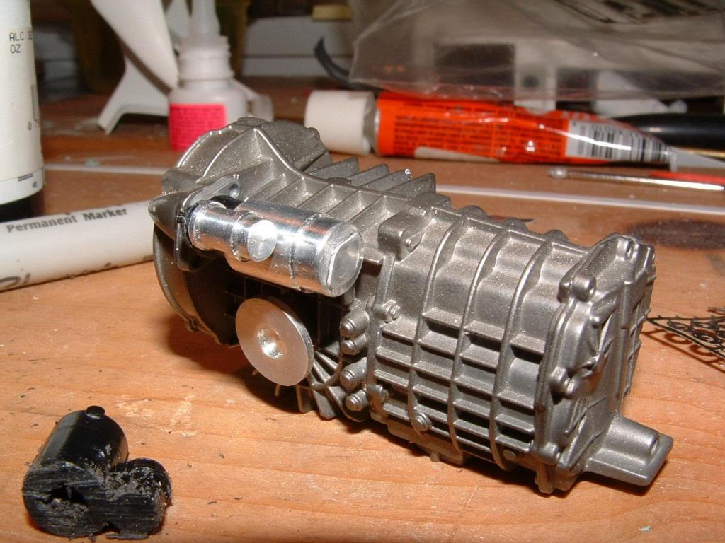

This is about as close as I've been been able to get as far as used Magnesium dow coated. Its Alclad Mag over white primer. Of course the make up of the Magnesium will change the color of it somewhat.2v2uenjDLxAw9yy.jpg2v2uenjsSxAw9yy.jpg

Paul... I love that. I am going to have to try that sometime myself.

Paul said:"This is about as close as I've been been able to get as far as used Magnesium dow coated. Its Alclad Mag over white primer. Of course the make up of the Magnesium will change the color of it" Hahahahaha! That looks almost perfect! And, that's closer than anybody else has got, as far as I've seen!

I used Testor Flat Green and Bright Gold. I would like to knock down the brightness a little. The flash must have really brought out the metallic it doesn't look that bad in person.
Thank you for all the ideas to recreate the coating! I definitely have some more experimenting to do.

Paul, (mr68gts) I tried your technique and I like what I see. I stripped the Crower on my car and like the new finish much better.  I think it takes a little differently on metal, brass in my case, but it looks better and closer all the same.  Thanks for sharing the tip.  cheers, tim
