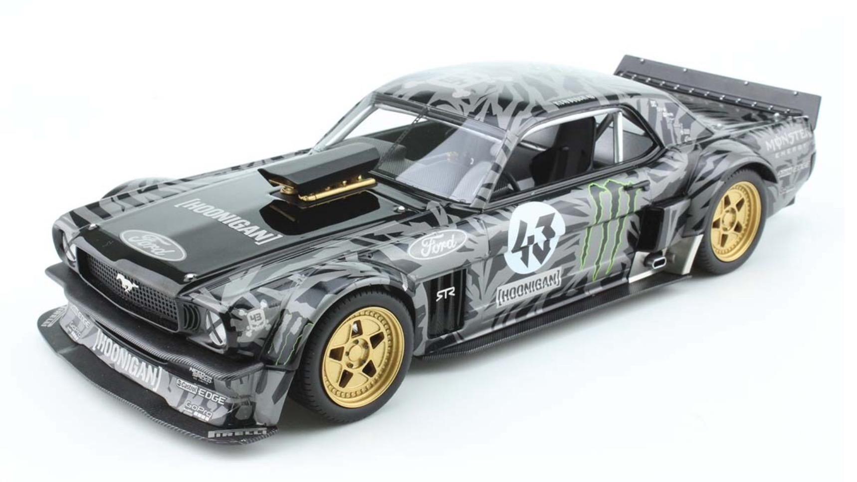

The Hoonigan would be pretty hard to replicate.  On the other hand, seeing the craft glitter paint it looks "out of scale" but perhaps it could be a base coat for more coats.  Try experimenting on an extra model.  Just my two cent opinion.
I love that car!!! I didn't paint it metallic, i got it like that and concocted a story in my head about it belonging to a man in his early 20's when he came home to Detroit from Vietnam in the early 70's and wanted to build a flashy drag car but didn't have much skill with cars.
