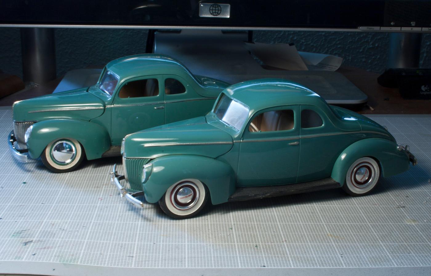

Tulip I don't open every post I see here but when I see yours I always check in and am never disappointed. Here is a cloudmist gray example built from the AMT coupe and sedan kits long before Revell did a 40. Started it 25 years ago. I really should finish it someday. The one in the back is a left over from the spray paint process. (I kept stripping and repainting until I was happy with the paint job.)

Thanks a lot!!
Loved your Ford Dave!!
Looks like you used the lowered front end. It gives the car, specially the Standard, a mean look.
The first AMT '40 I built back in the early '90s also has the dropped front end, and the dual exhaust.

You are correct, I did. I was replicating a 40 Standard hot rod that's in the collection of Jim Walker of Dayton Ohio. His collection was featured in American Rodder magazine back in 1992 and I fell in love with this one.
