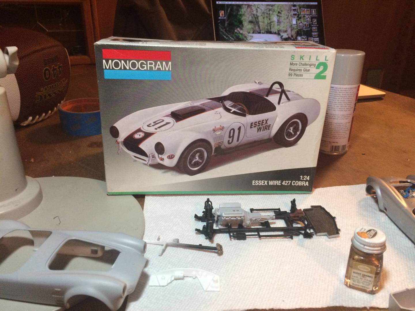

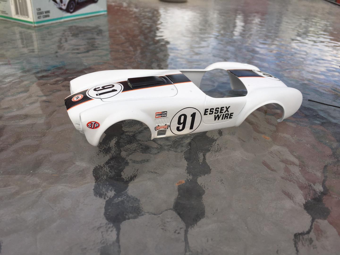

I started this with the hope that it will be a quick build.   Time will tell.  Does anyone know if this car had a black (carpeted) interior, or a stripped down aluminum one?  Also, which valve covers would it have?  Most pictures of competition cars show them with the chrome ones, but this kit comes with the finned aluminum ones.  I can't find any good pictures of this car from back in the day.  There are pictures of the car in its current iteration, but it seems to have modern changes and equipment.

No carpet, aluminum valve covers.  Right click to copy the picture/ right click to paste.

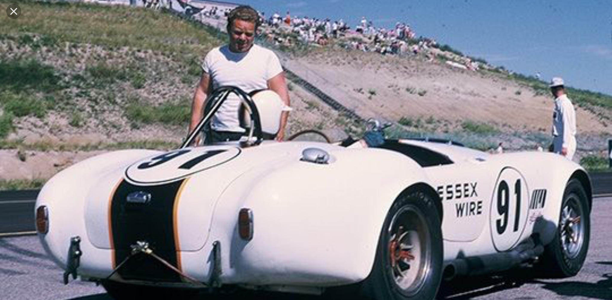

This picture may not help a whole lot but it is original, I took it myself at Mid Ohio, August 1965.

Telling by the photos, this car original ran with six-slot Halibrand mags and Firestone tires. The mags are available from Historic Racing Miniatures.

Wow, thanks for the reference pics, guys.  I can tell from Gary's picture that the car did have a wood wheel, and the red knockoffs from Rex's.

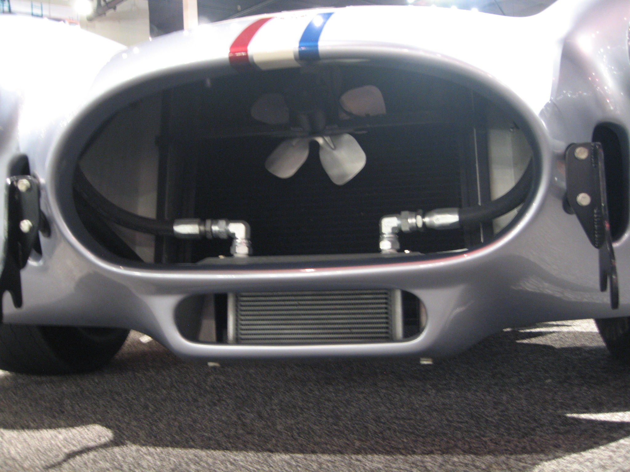

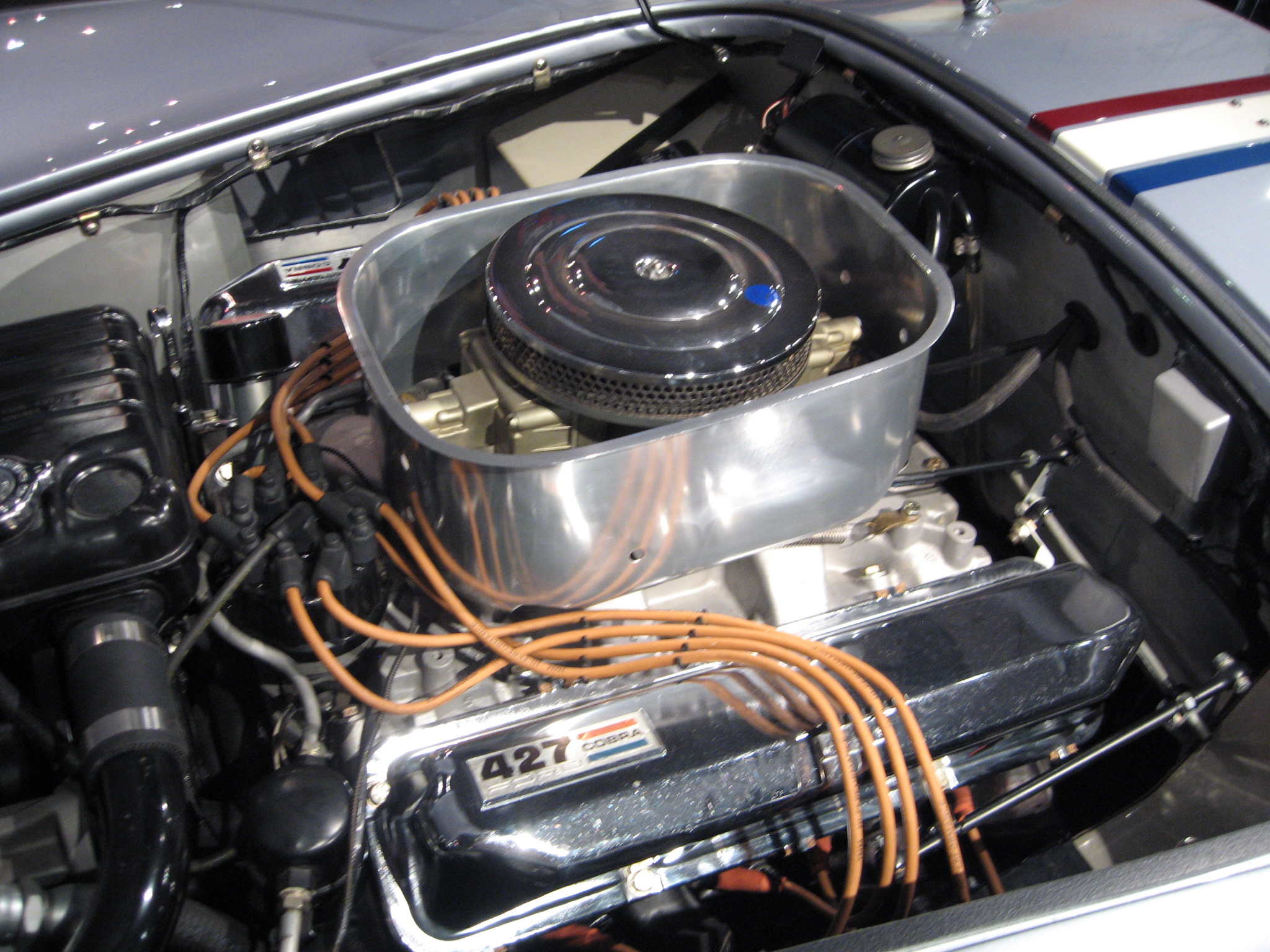

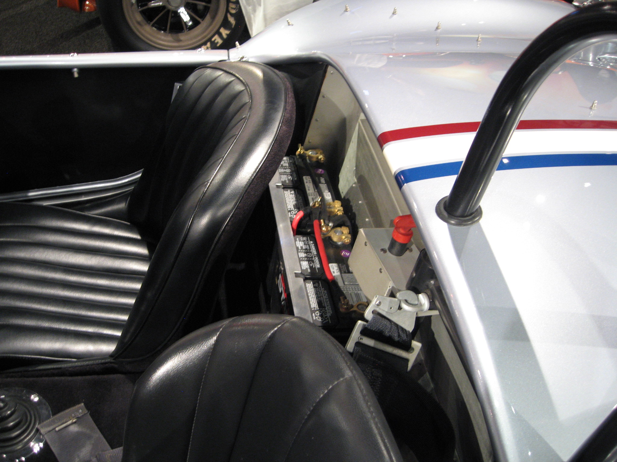

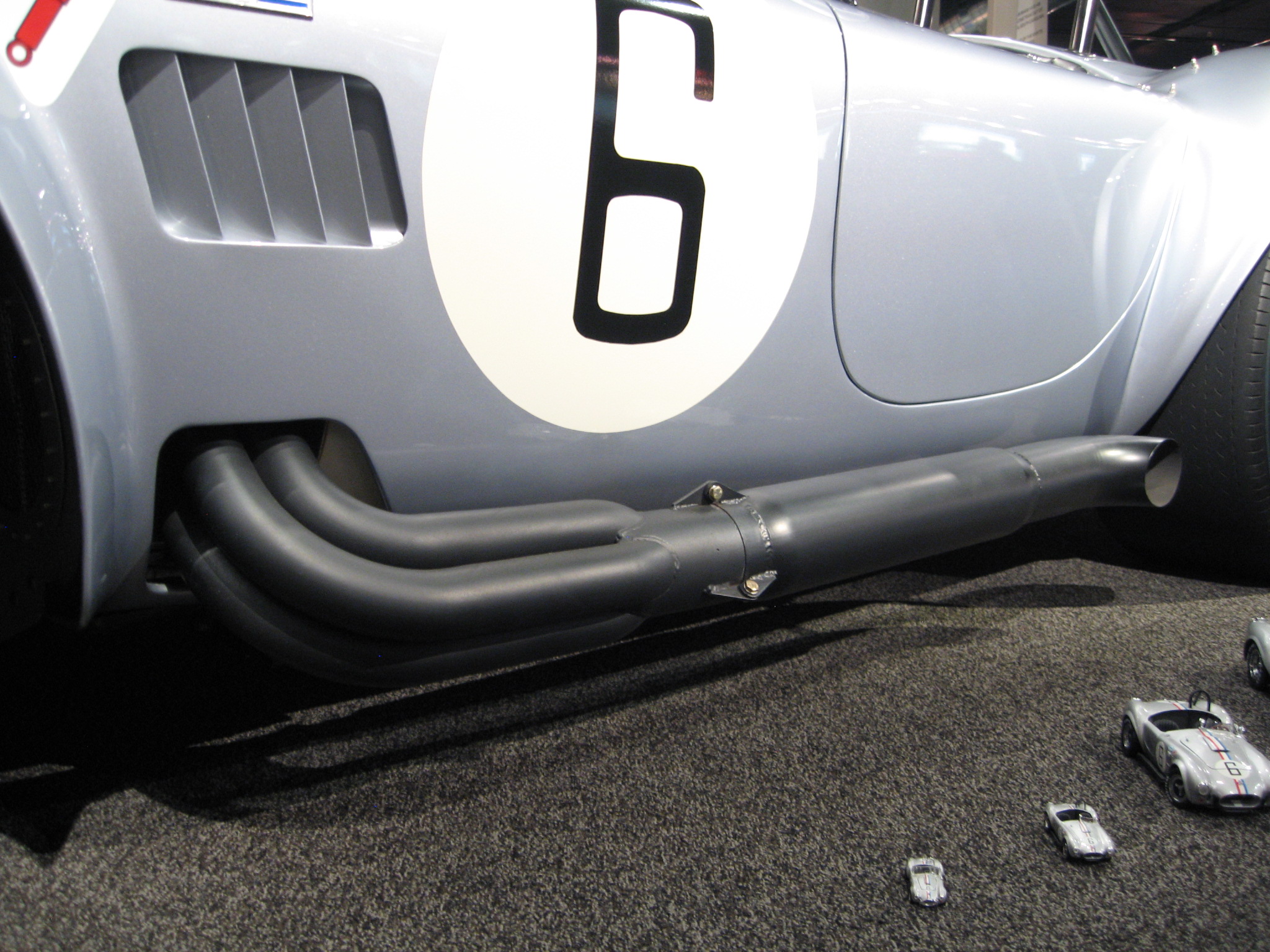

from my cobra world registry book,   competition cobra's like  (csx3009  essex  wire) ran smooth  chrome valve covers ,single 4 barrel and no air cleaner.   an  aircraft battery behind passenger seat and some used a different drivers seat.  about an hour drive from my house is the Cobra Experience Museum Martinez California . here are a few pics of csx3022  competition cobra.

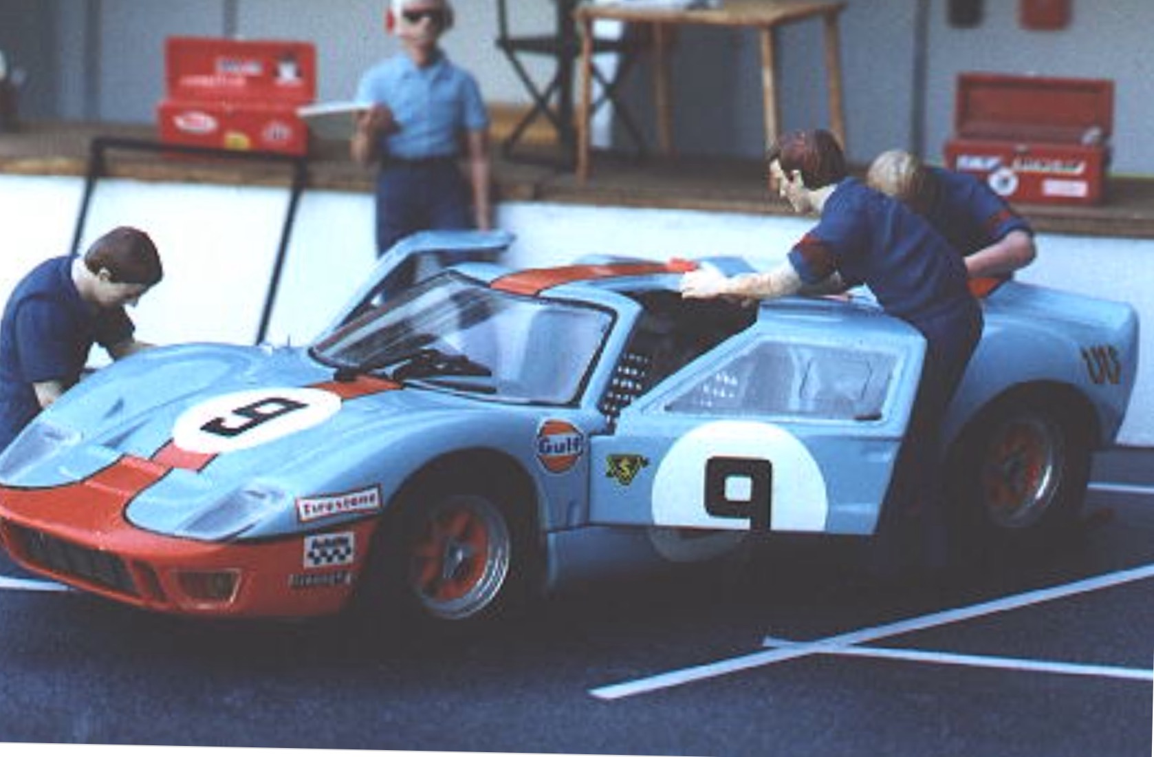

Great to see one of the old pictures from the 90's that I am guessing you scanned.  Feel free to post up more.  Not everyone was online 25 years ago.

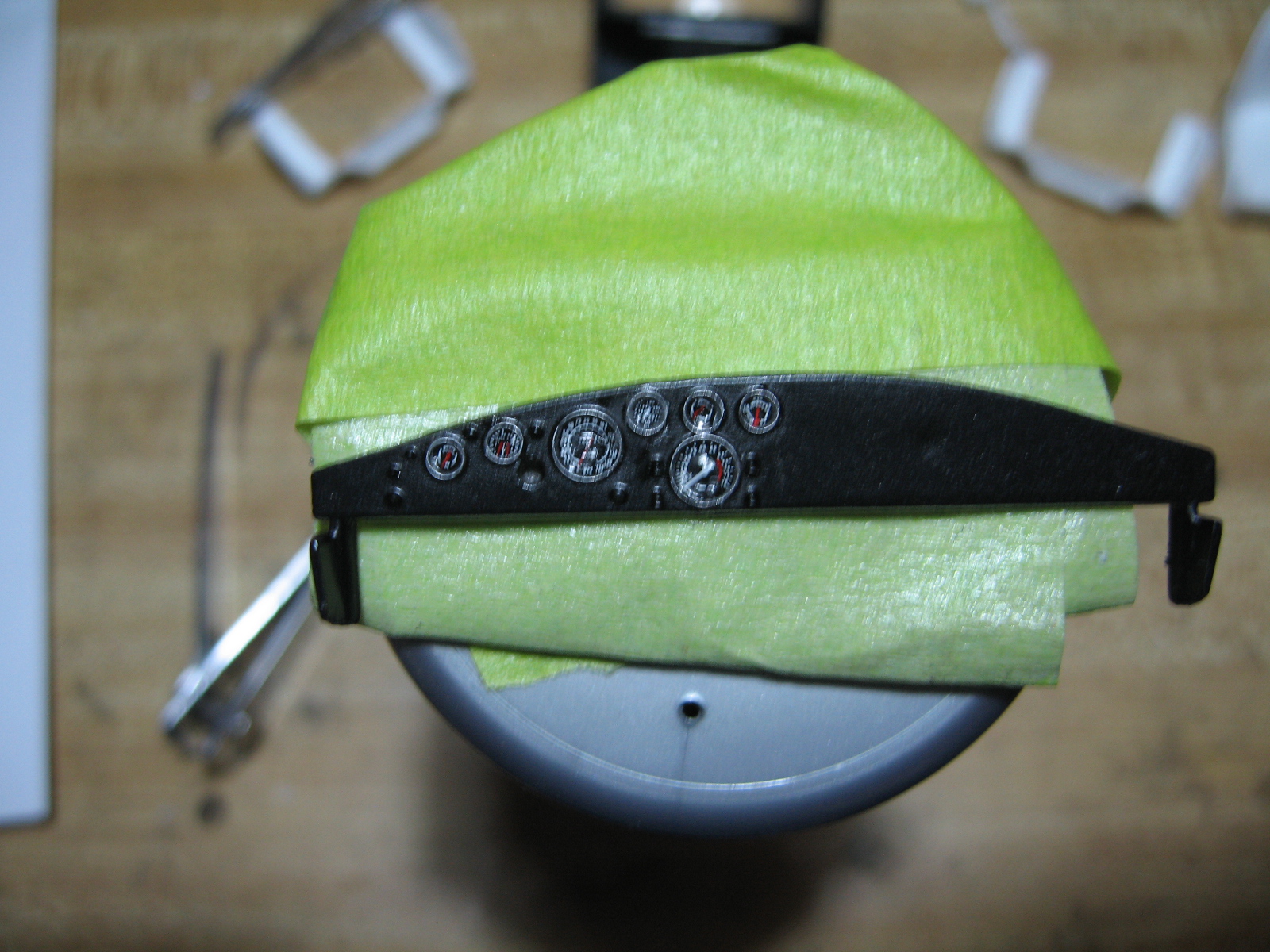

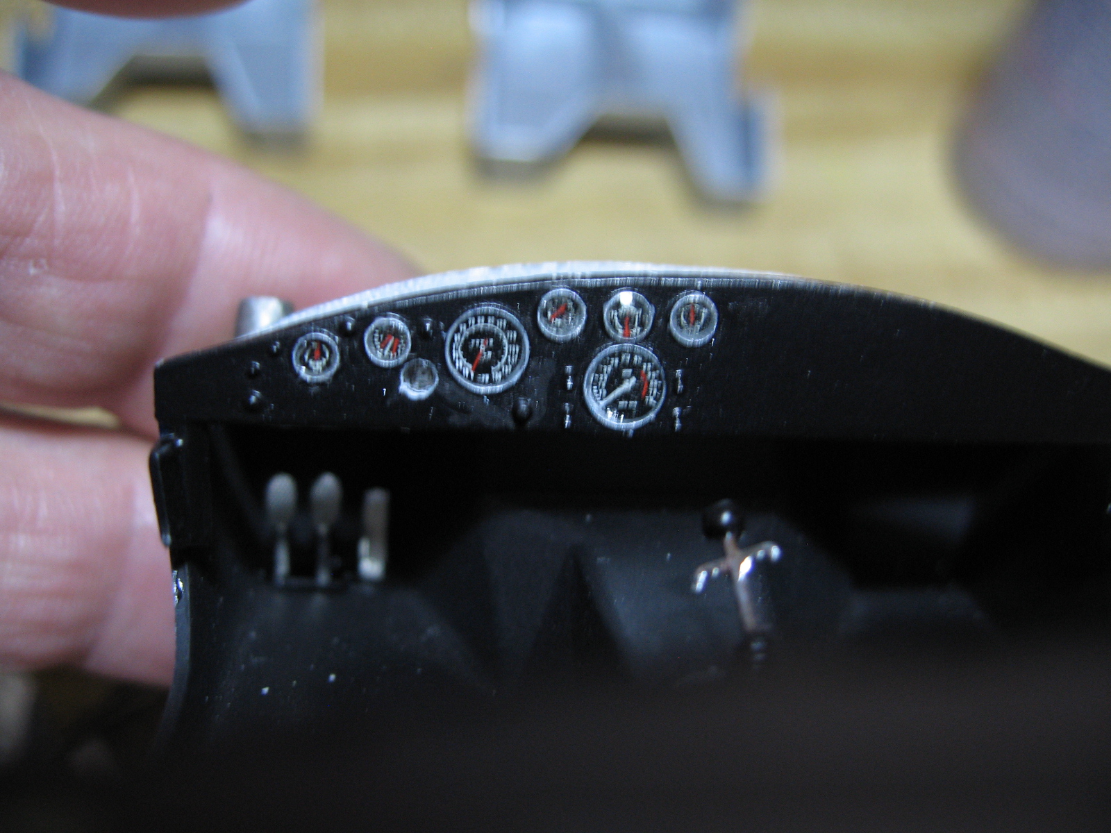

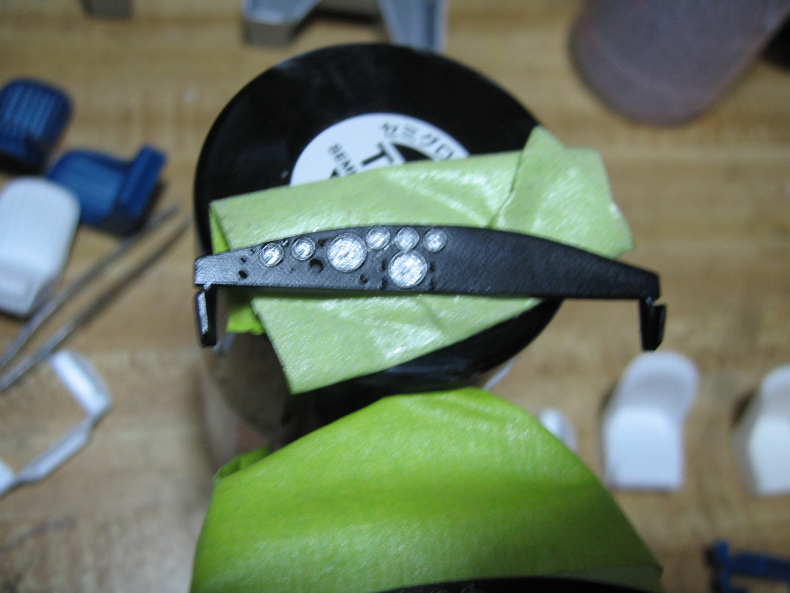

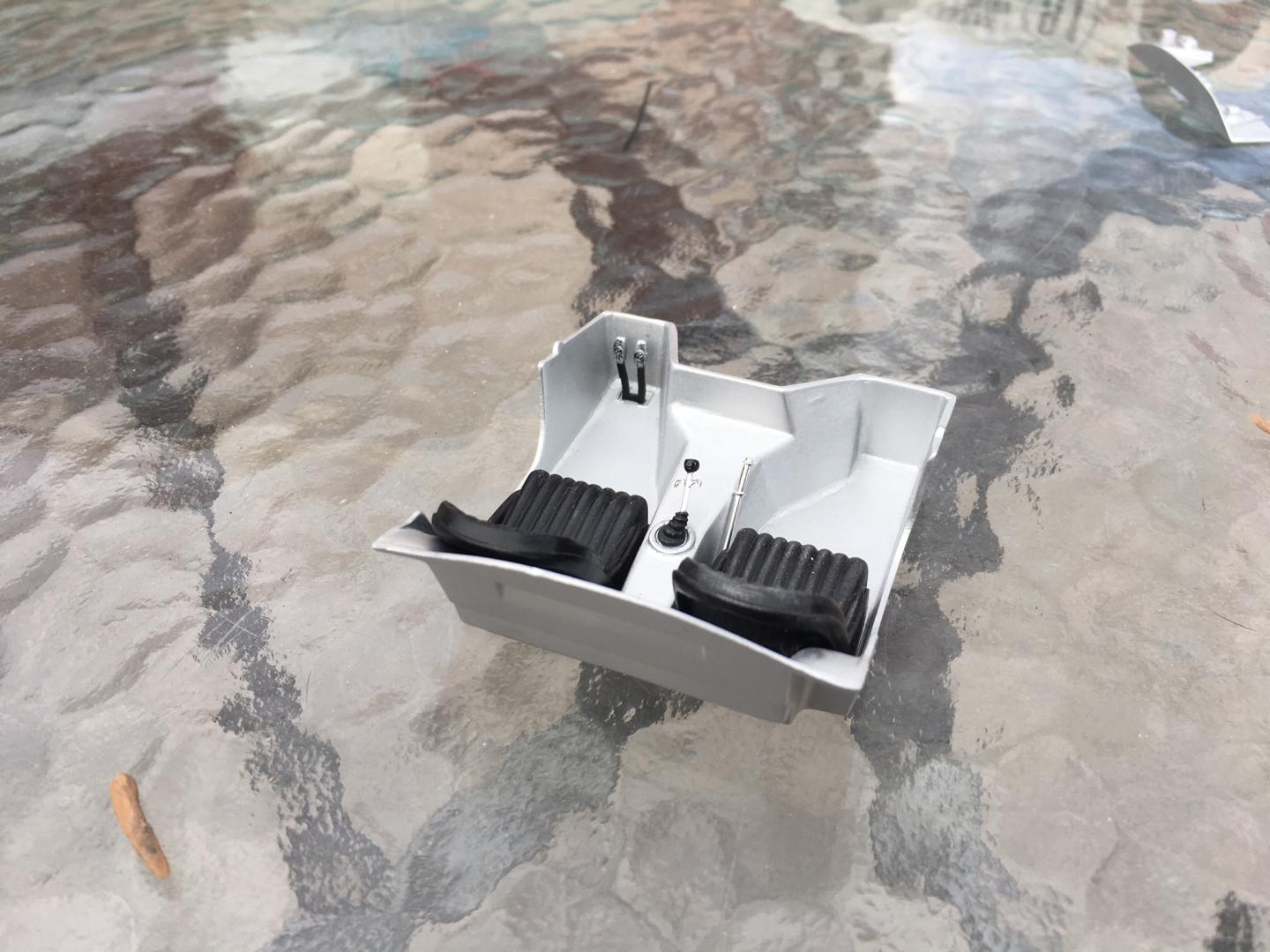

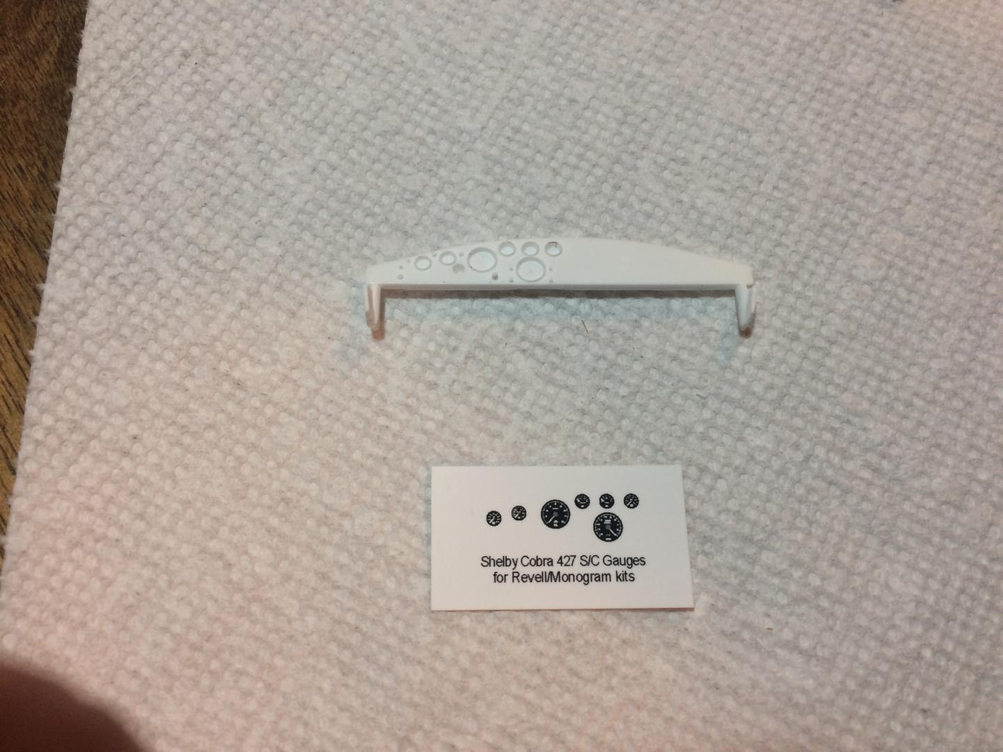

i found those gauge faces hard to cut out , so i used  gauge  decals  from this street burner cobra kit.  painted the gauge part all silver, applied decals and finished off  with  a dab of clear 5 minute opoxy to make it look like glass.  maybe hard to tell from picture

I like what you have done Ben, and William with the dash gauges.

Your dash & gauges look great. One thing lacking in the Rev/Mom 427 kits and subsequent builds are the front inner fender/engine compartment side panels. I am not sure if these are available after-market but the Fujimi 427 has them which could be used as templates.
