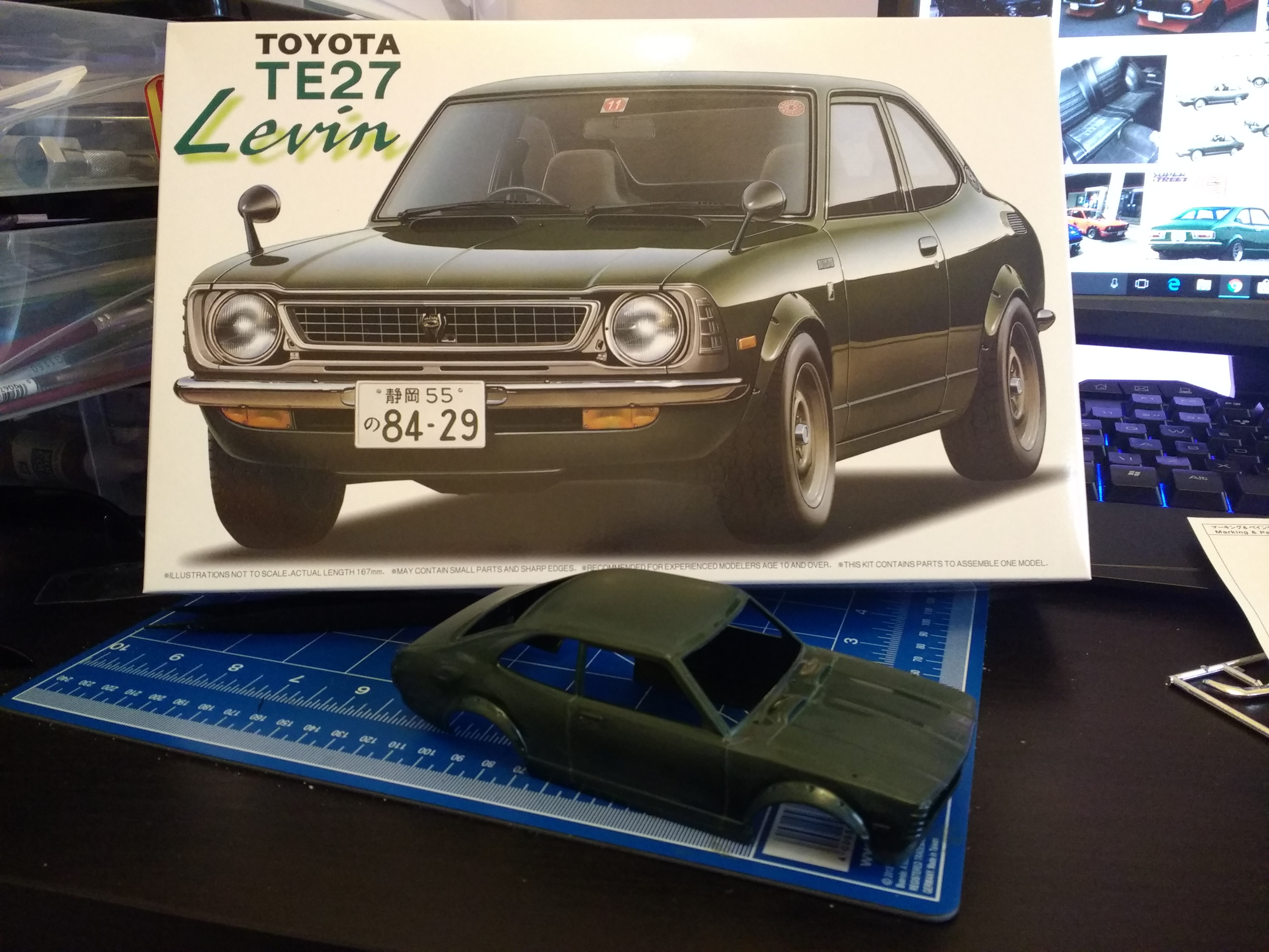

Needed a break from the Countach build  and this turned up in the post.  A nice simple set, good quality as always from Fujimi.  Deepened the panel lines and sanded the body with 1000 grit ready for primer.

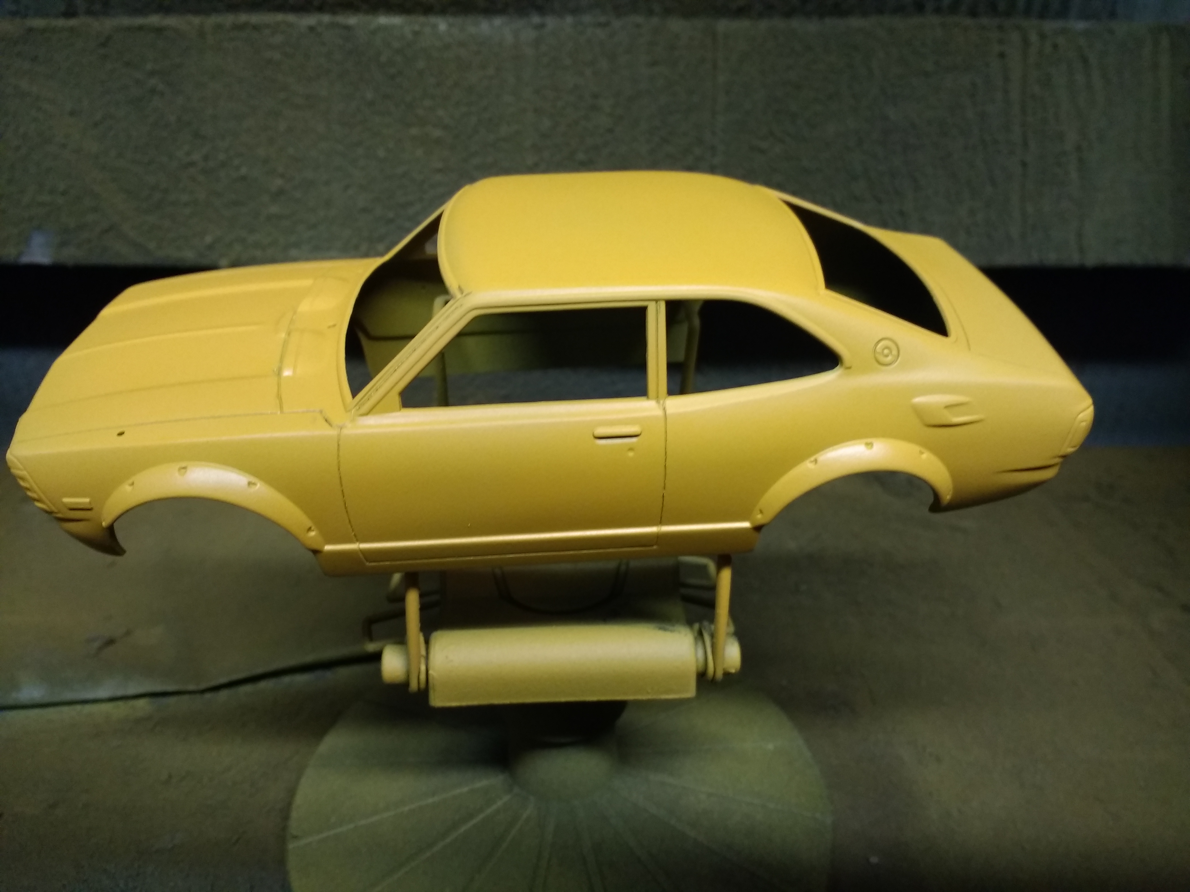

Halfords filler primer

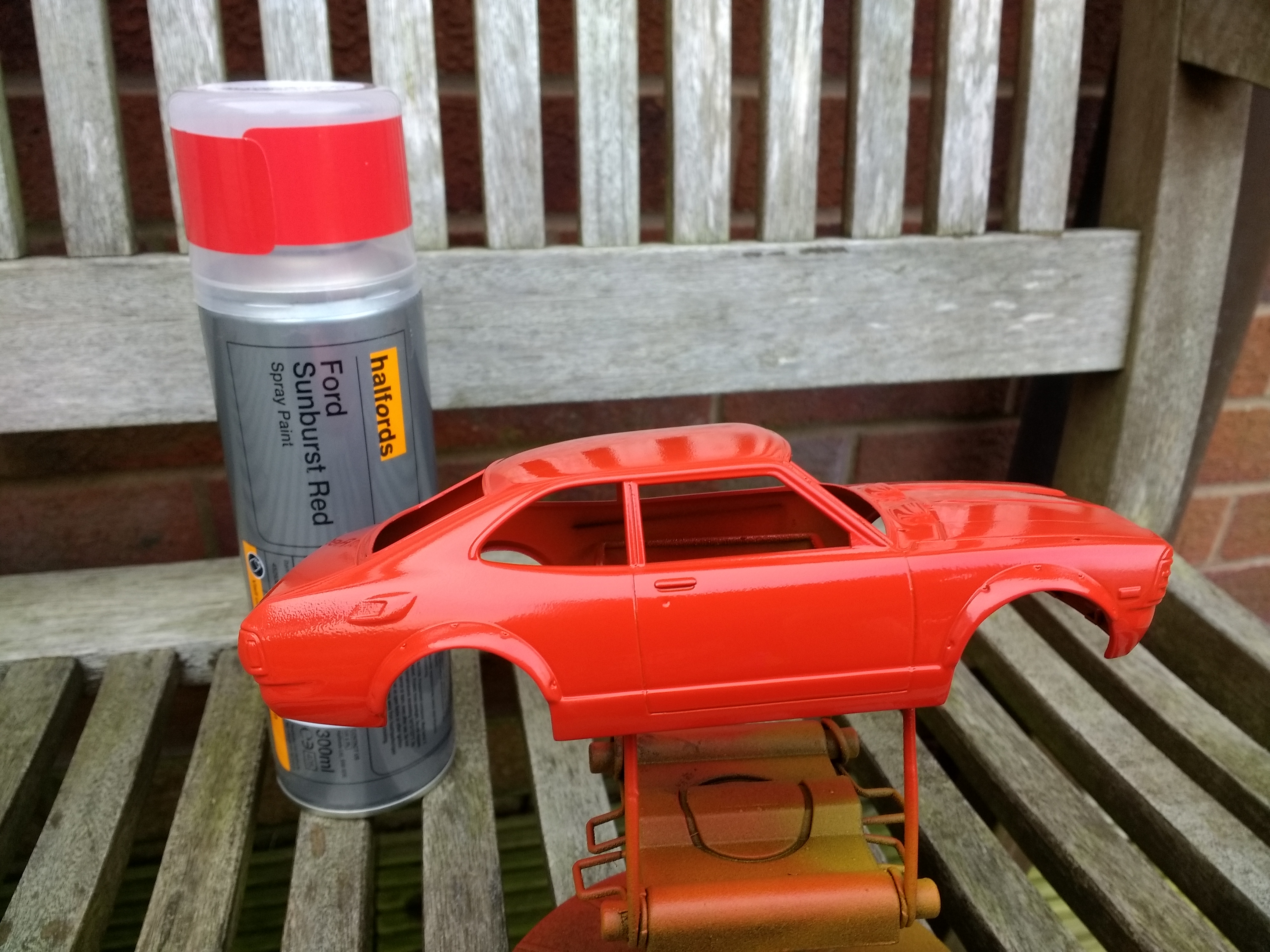

Halfords Ford Sunburst Red rattle can for the topcoat.  Managed to get a mild day to spray outside.  Just needs some fine sanding to even out the paint and then onto clearcoat next week.

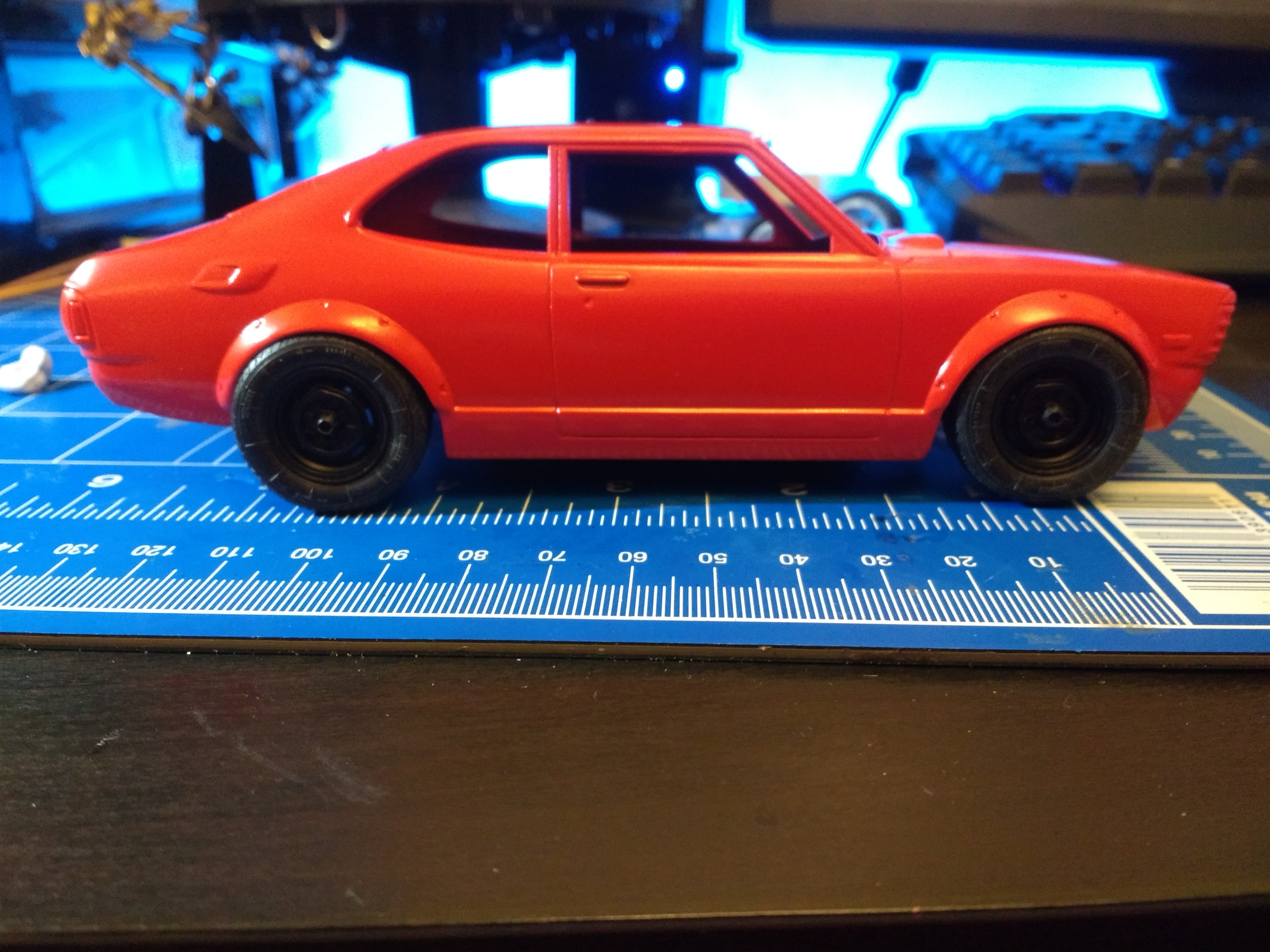

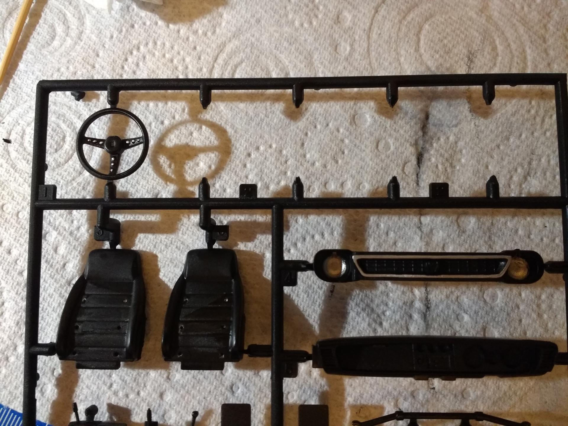

Bit of detail painting, the front grill silver was a challenge

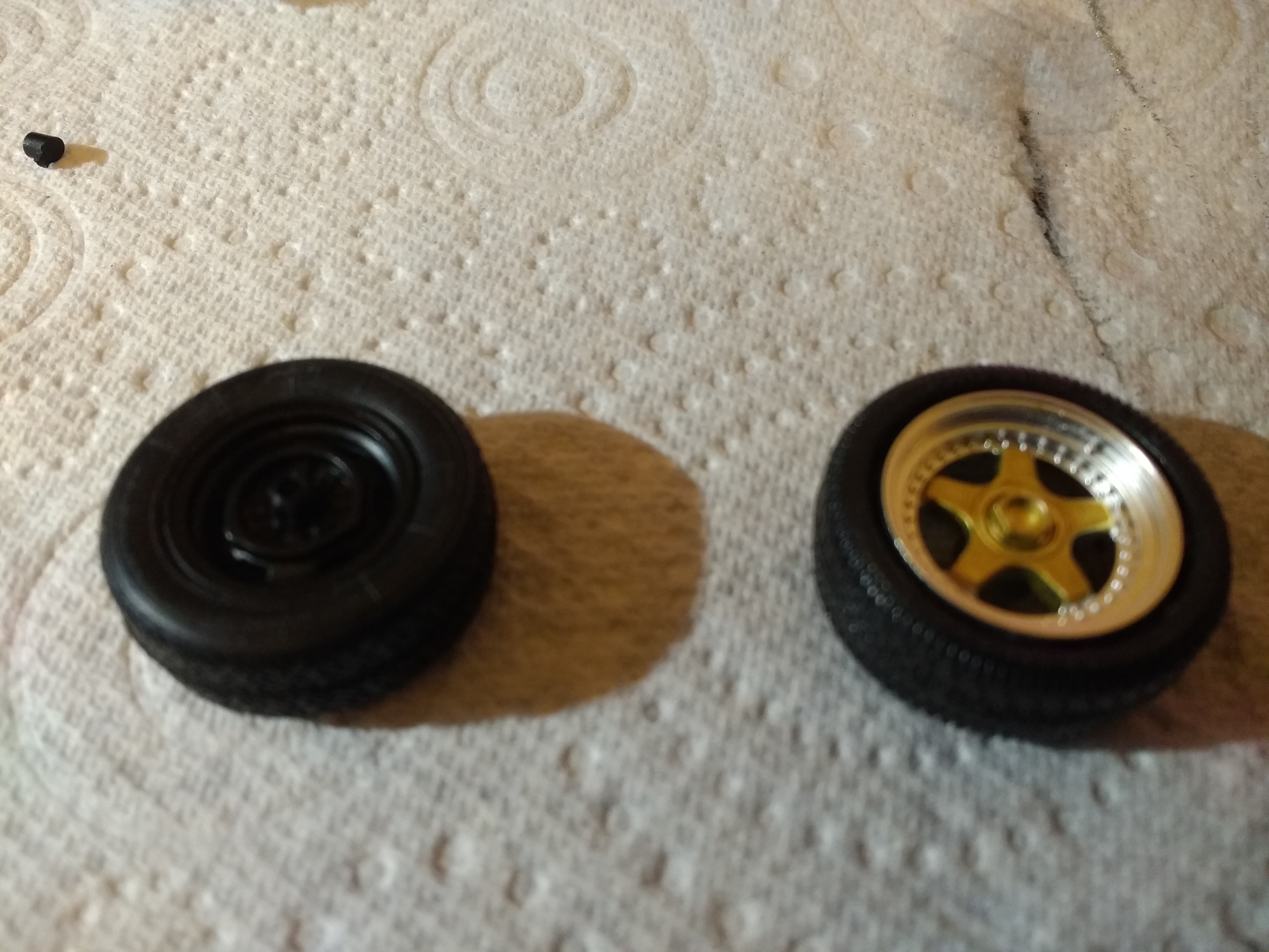

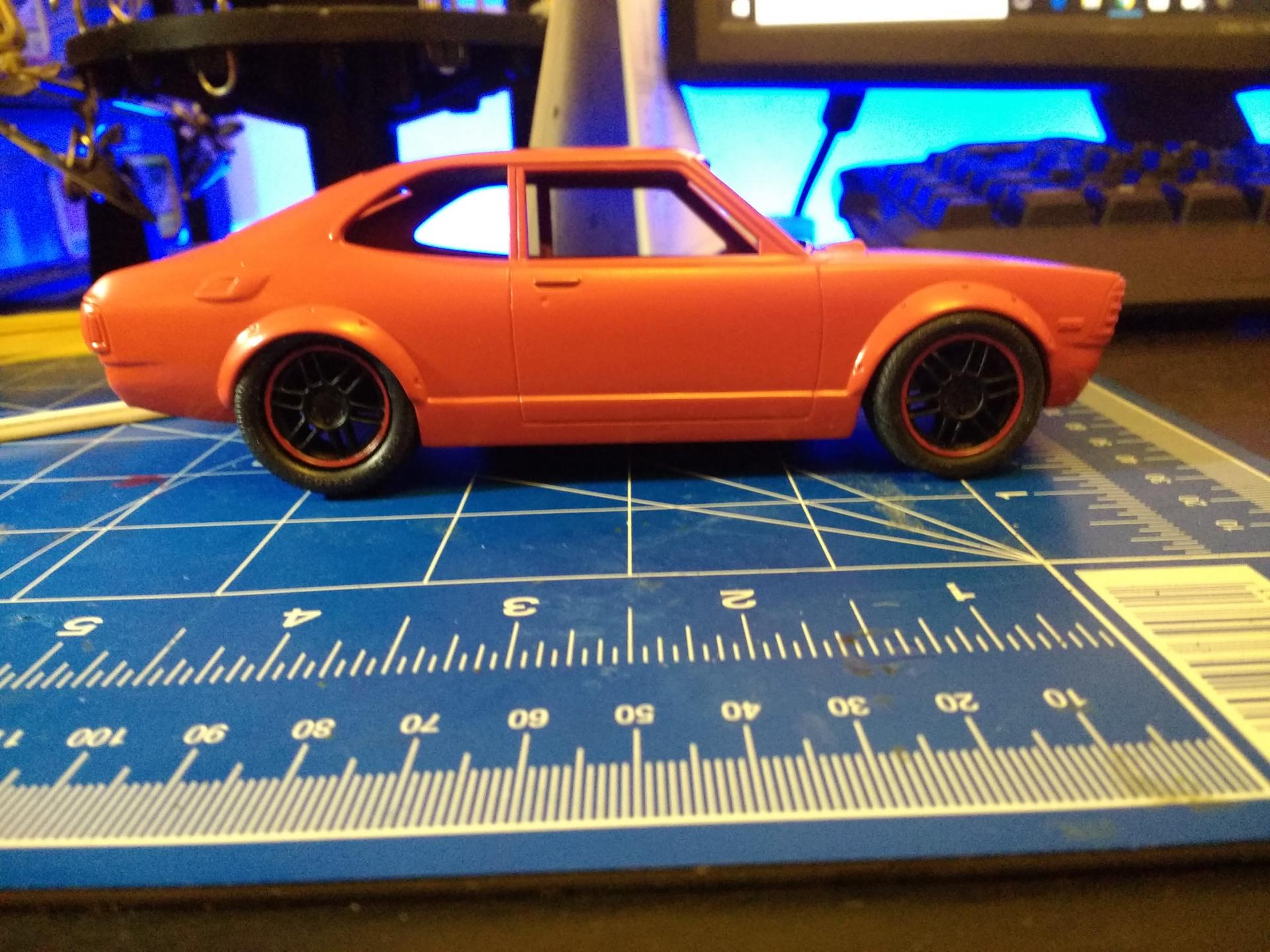

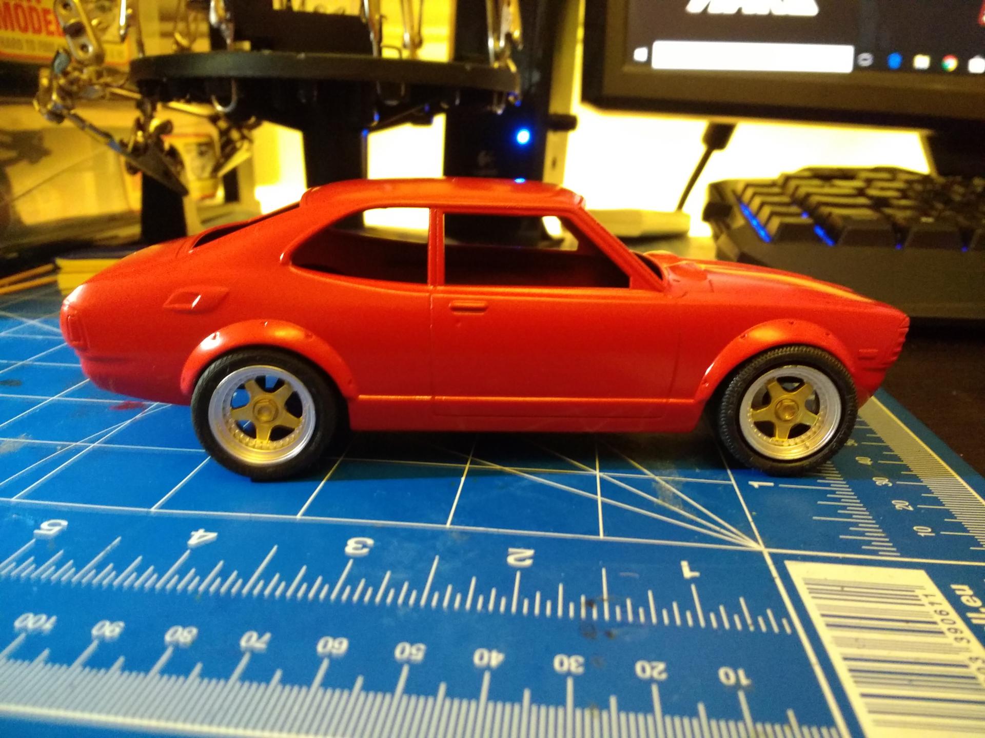

Choice of wheels, left ones come with the kit, the right are the same size off a Mitsubishi EVO 5.IMG_20171206_145339664.thumb.jpg.d6d2e2465a0ee0af5bbd937d6cdc3616.jpg

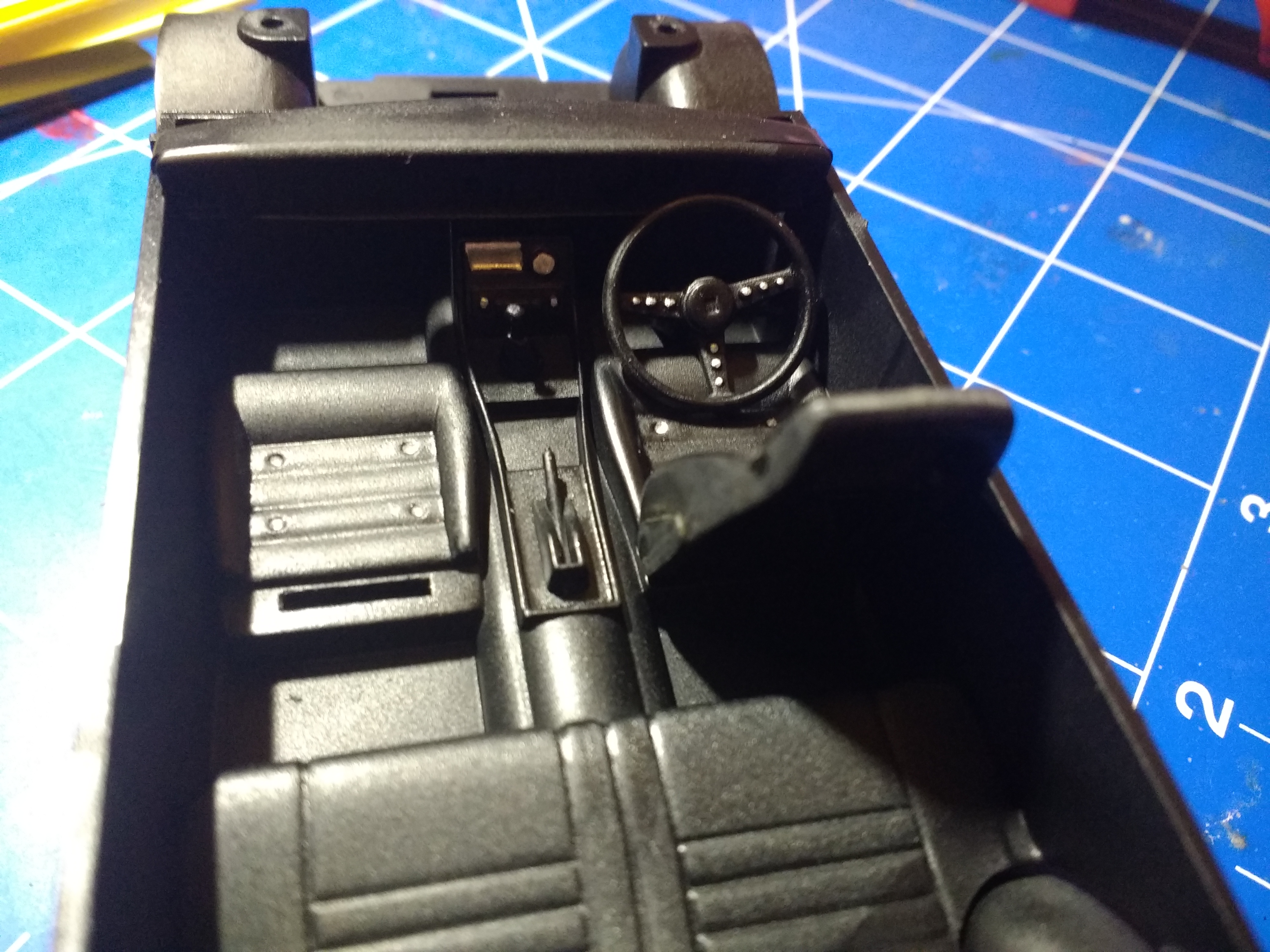

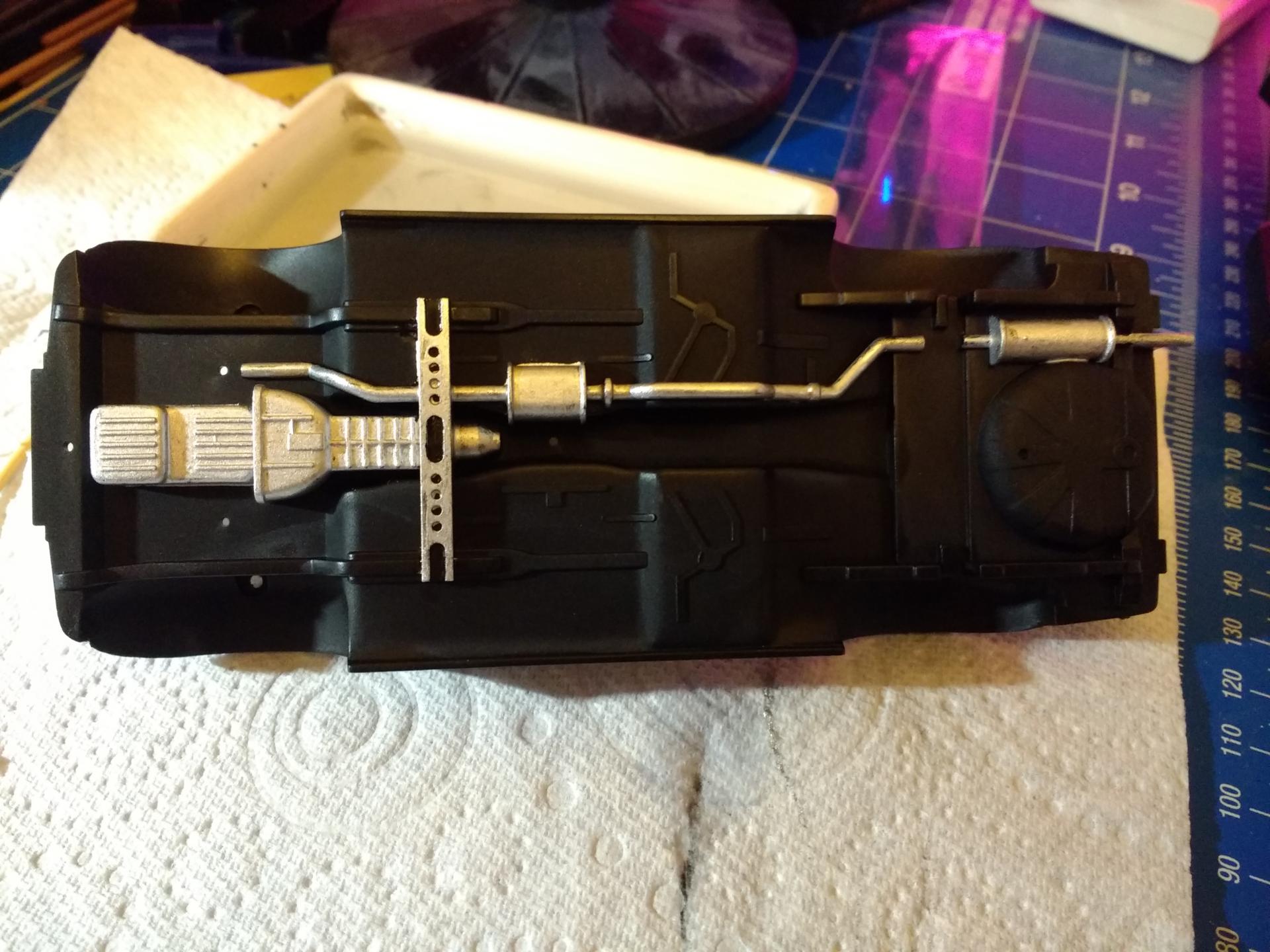

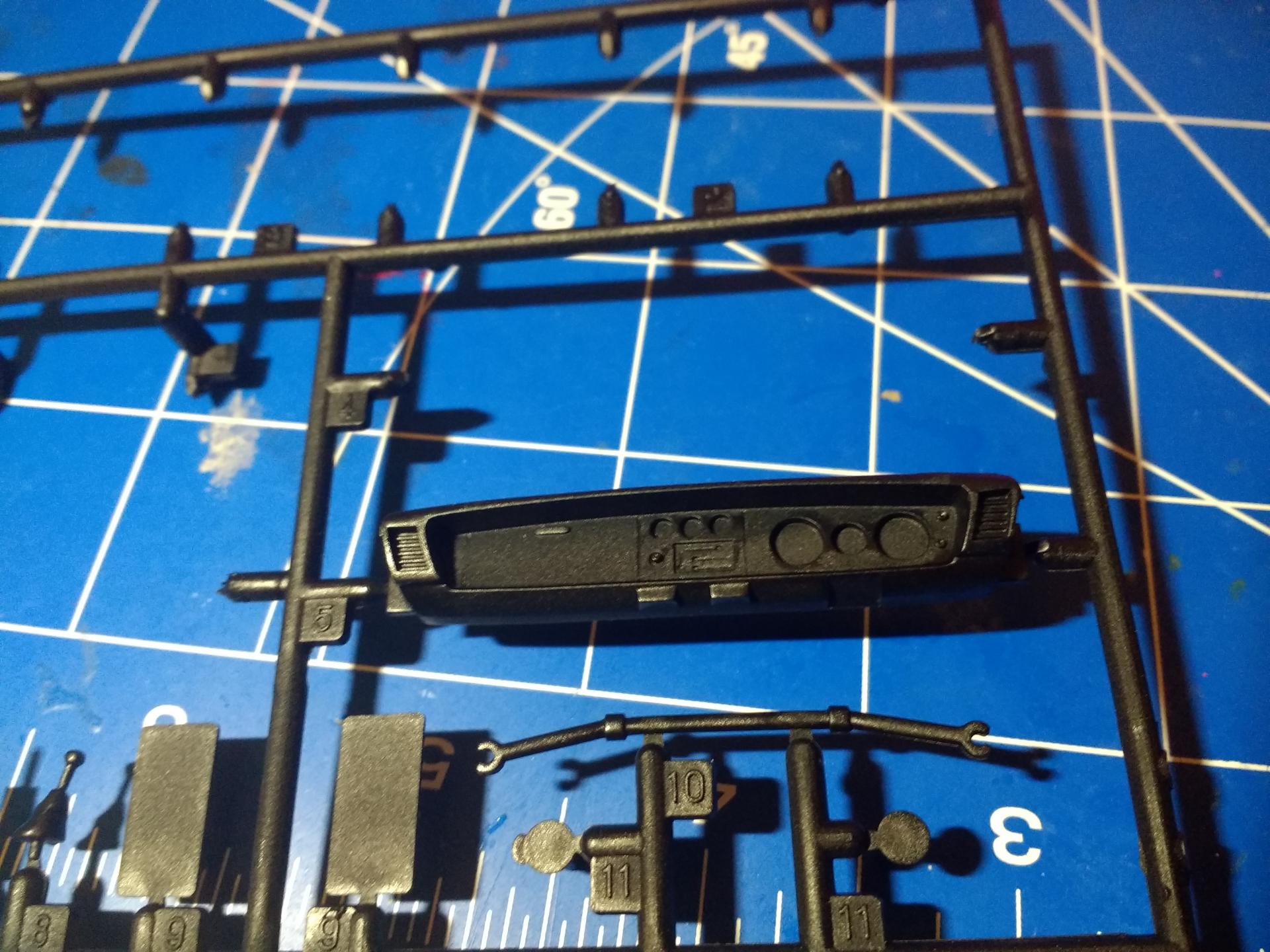

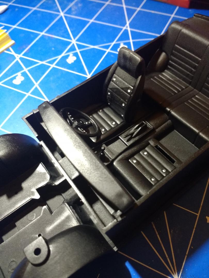

Started a bit of detailing on the underside

About the wheels; i'd go for the Enkei RPF01 lookalike wheels :)

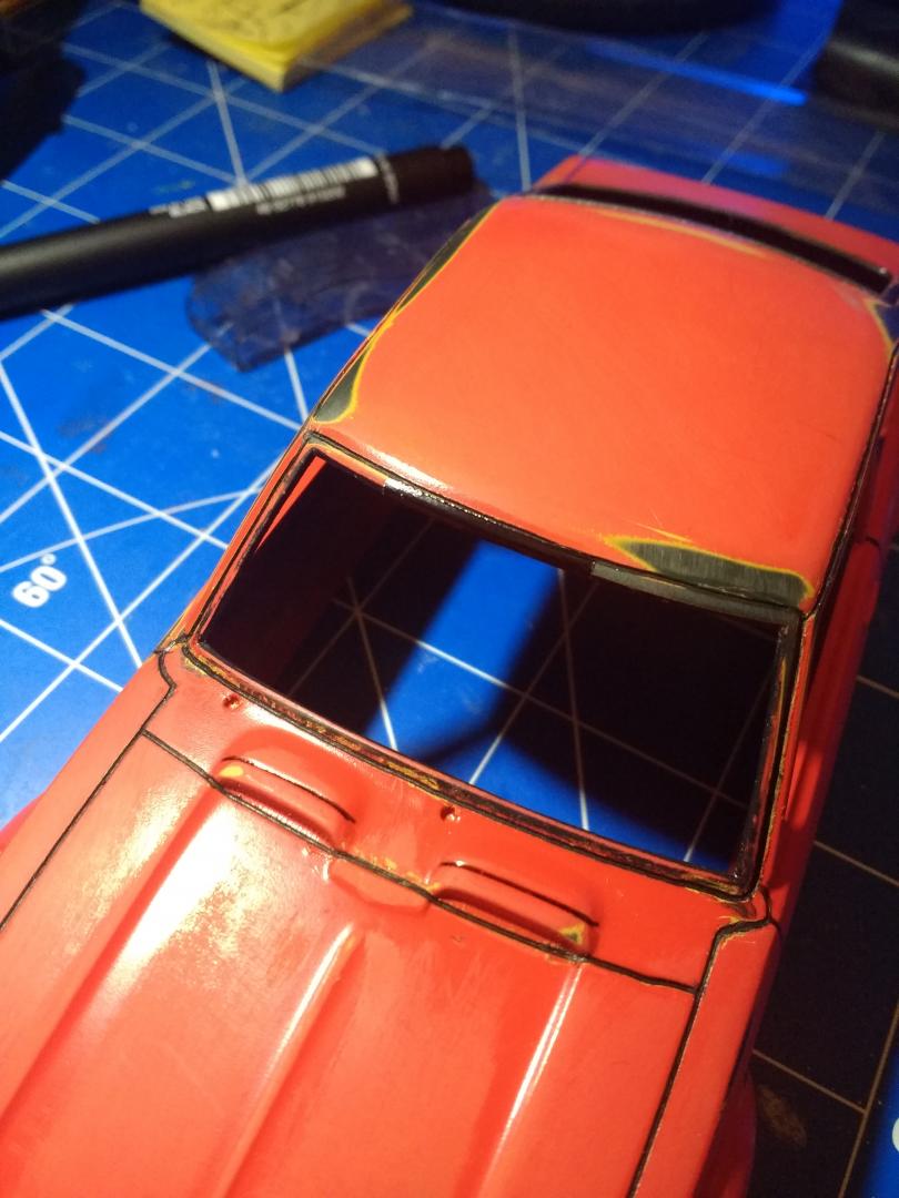

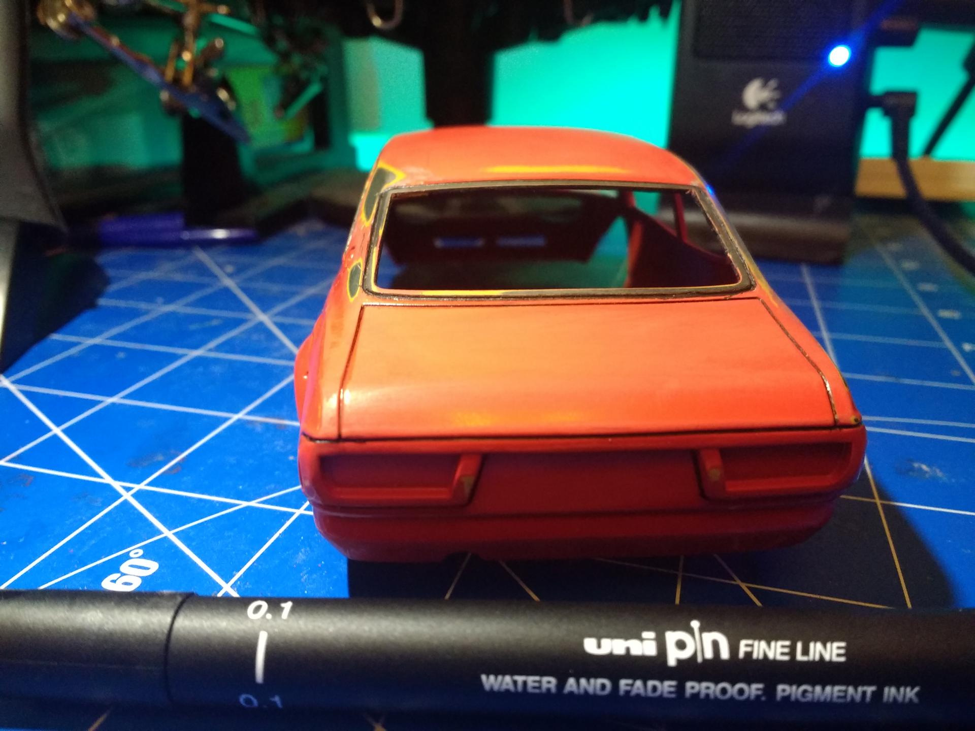

Thanks for the input guys.  So tonight I masked around the windows and put on the black.  When I peeled off the masking tape the paint had bled.  So I now have to sand the paint on the body back and respray.  I have deepened the panel lines and will use the diluted tamiya panel line paint to fill these before spraying again.

Ricky no left hand drive option on this kit.  The dashboard appears to be symmetrical so if you have the talent to reproduce the insert with the dials and glove box you could swap it to left hand drive.  I don't have that kind of talent for scratch building.  Anybody got any tips on window edging.  I have tried paintbrush, paint pens, deeper panel lines seems to be the only way I can put in a separation to neaten it.  Only problem is that I the panel lines end up looking rough.  I use a scriber or scalpel turned upside down to deepen and widen the lines.  I did look at the foil but I struggled to cut it neatly.

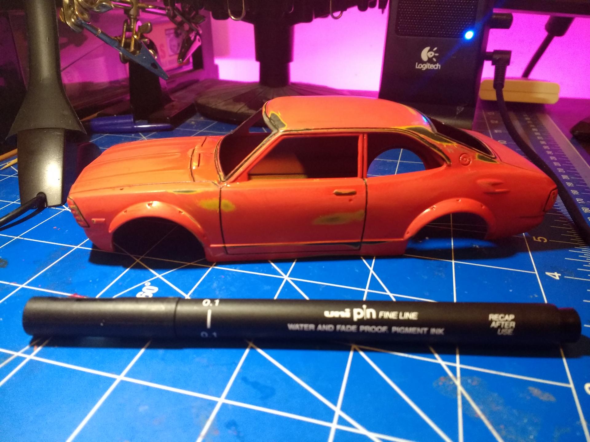

So finished up sanding back the Corolla and colouring the panel lines ready for primer again.  I will go over the panel lines again once primed.  I just got some black chrome bare metal foil.  Might try using it for the window edging, front and rear but I have deepened the panel lines enough that I can brush paint if I am careful.
IMG_20171209_232845392.thumb.jpg.d87ad7359e0b6cec05913571b6d033f7.jpgIMG_20171209_232854586.thumb.jpg.c25fbbd97e19a699b9426e49907f3b7e.jpgIMG_20171209_232836961.thumb.jpg.da77a1ff53d9155ba44ea12cb4e441df.jpg
