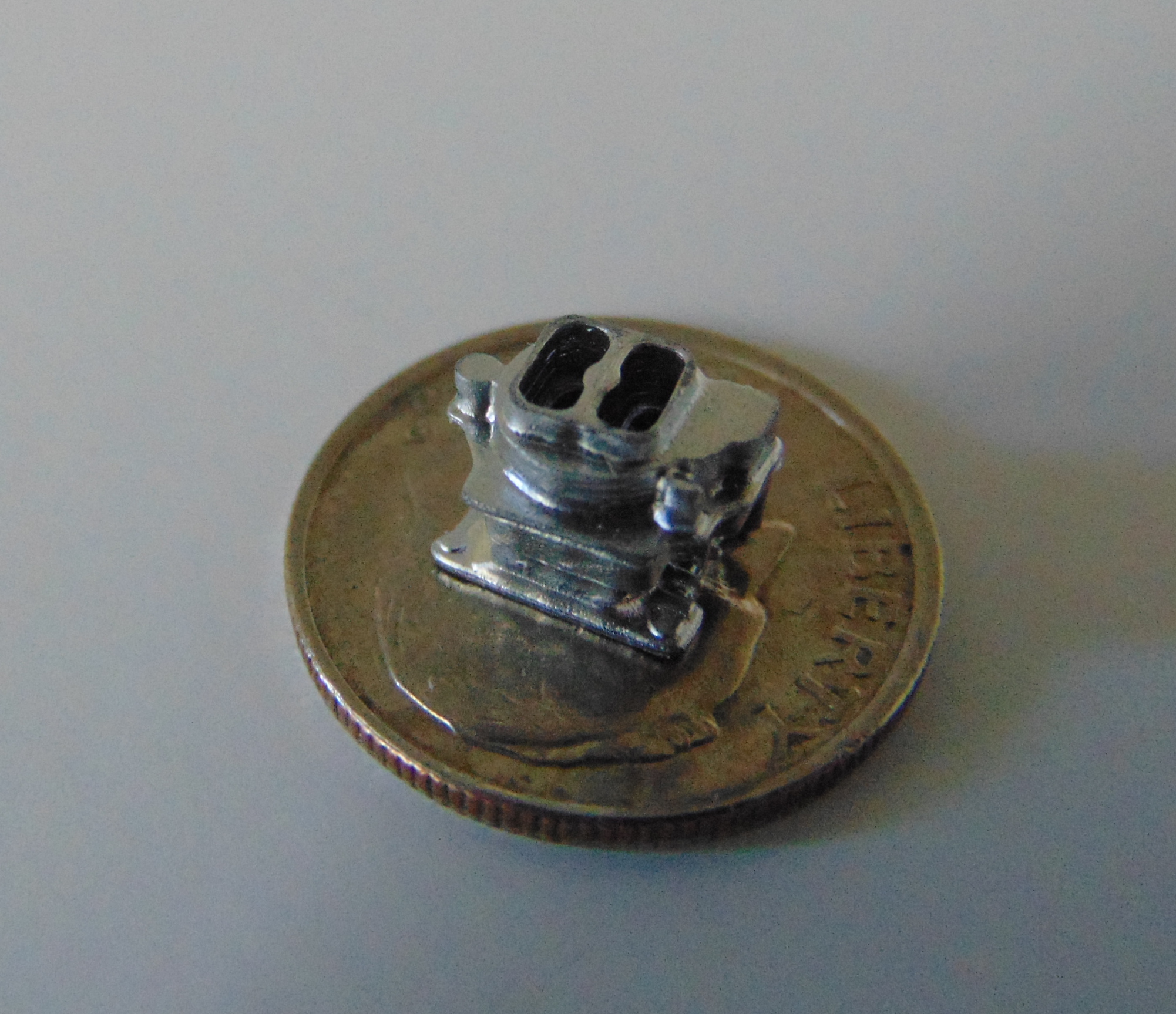

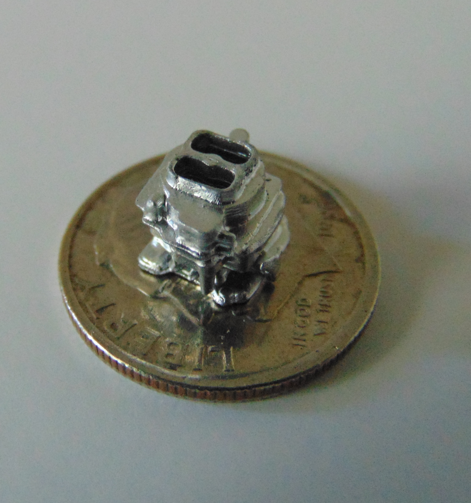

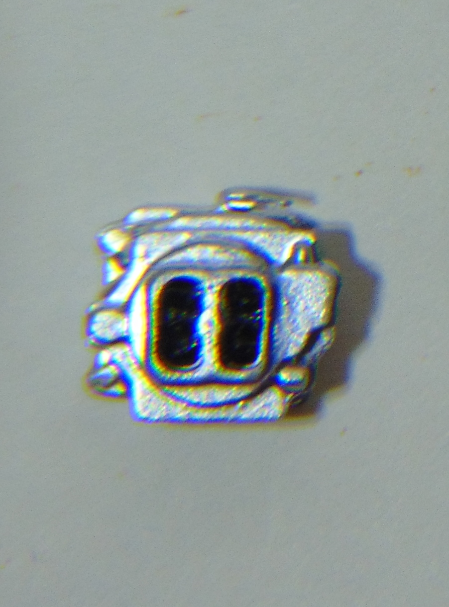

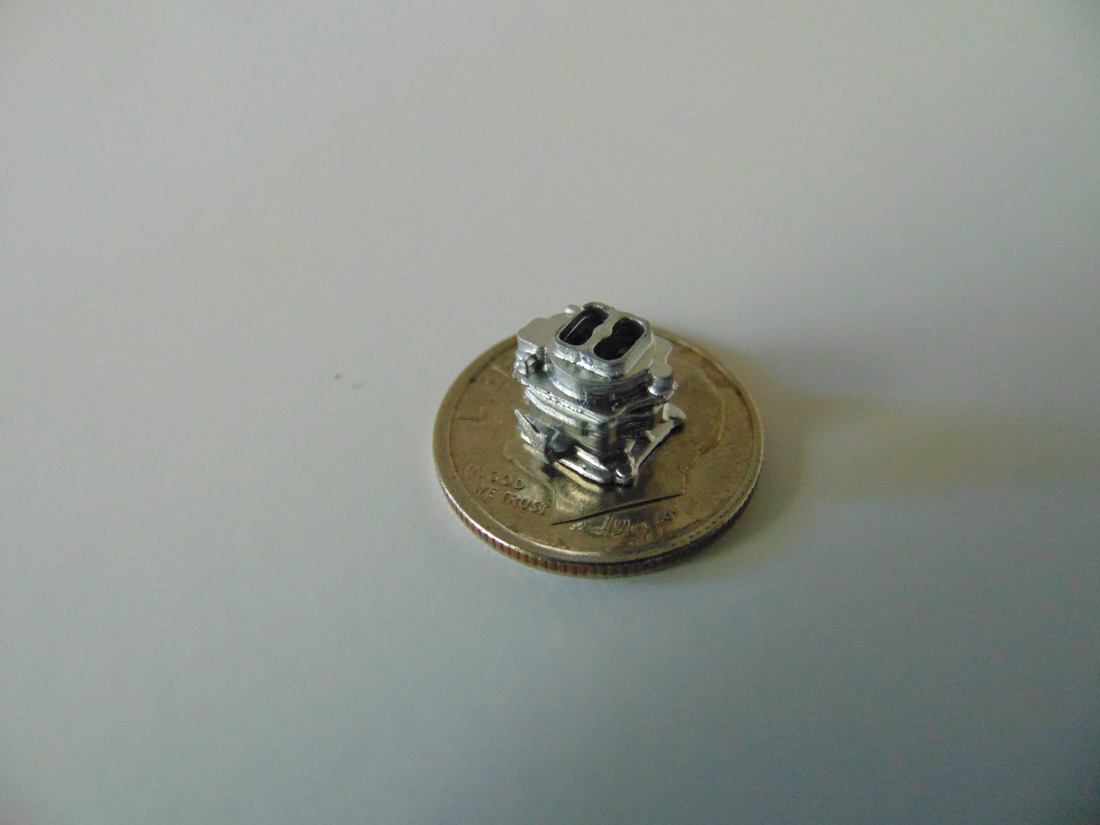

That looks good Doug!
Any chance you could get a really, really clear photo? Maybe more light, setting the camera up on a stable surface and using the timer feature to eliminate shake...I think it's a testament to the detail of this print that it's too small to see anything to criticize!
