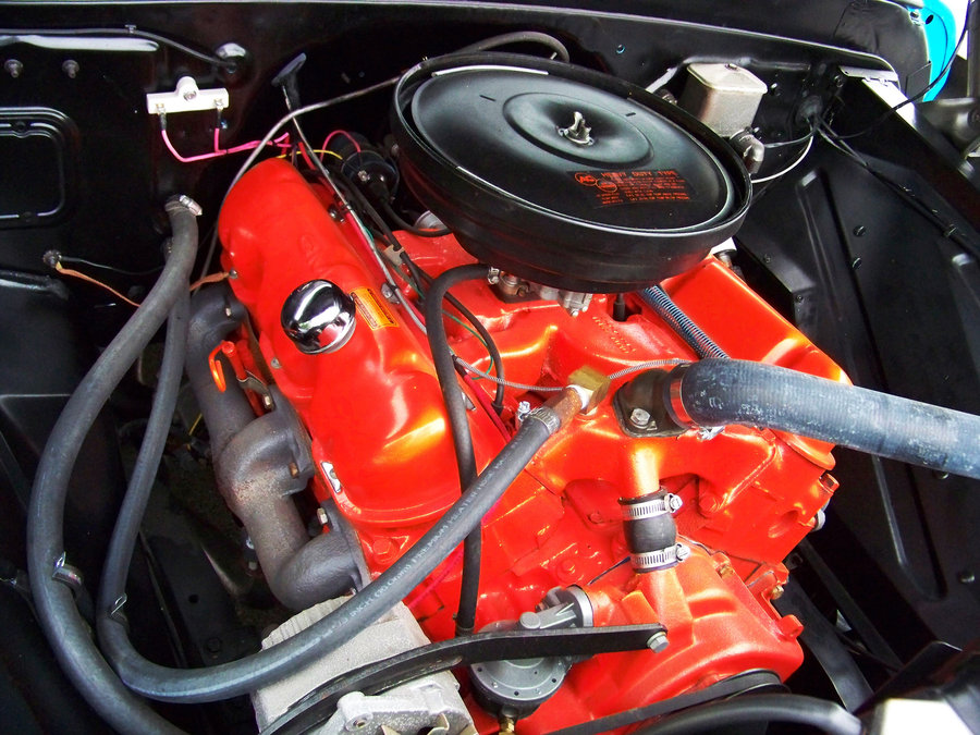

Most non-hemi V8 engines place the plugs below the valve covers, like this smallblock Chevy...
Image result for 283 chevy engine
