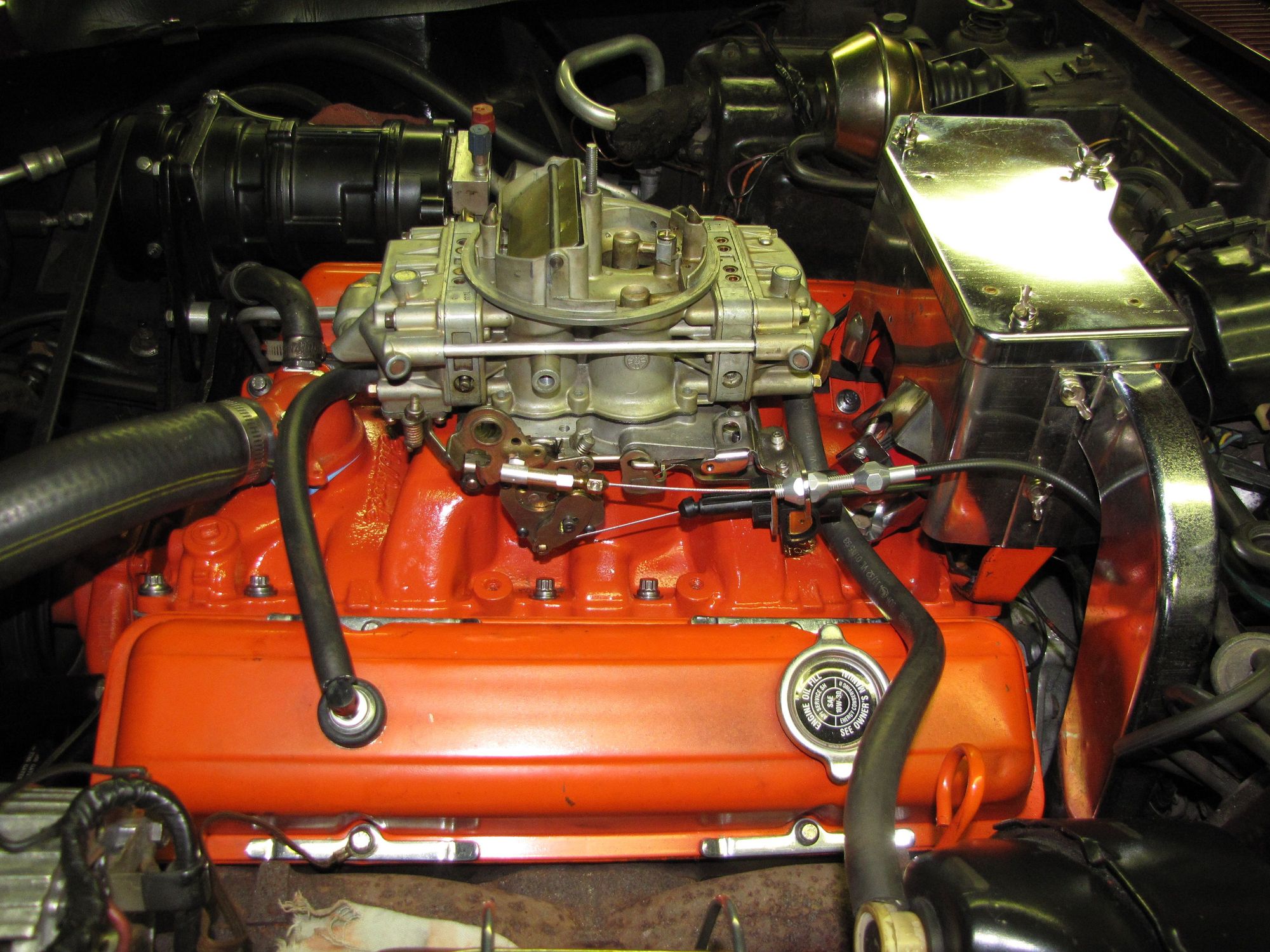

I was mainly looking for the point at which it exits the firewall. This is the best I can find unfortunately
80-img_0882_40c9fb6bfd09b709f11705e3d58e
Share this post
Link to post
That is not a stock carb (the were mostly Quadrajets) but the linkage is the same. You can run the cable through the firewall below the intake manifold would be the factory location.
