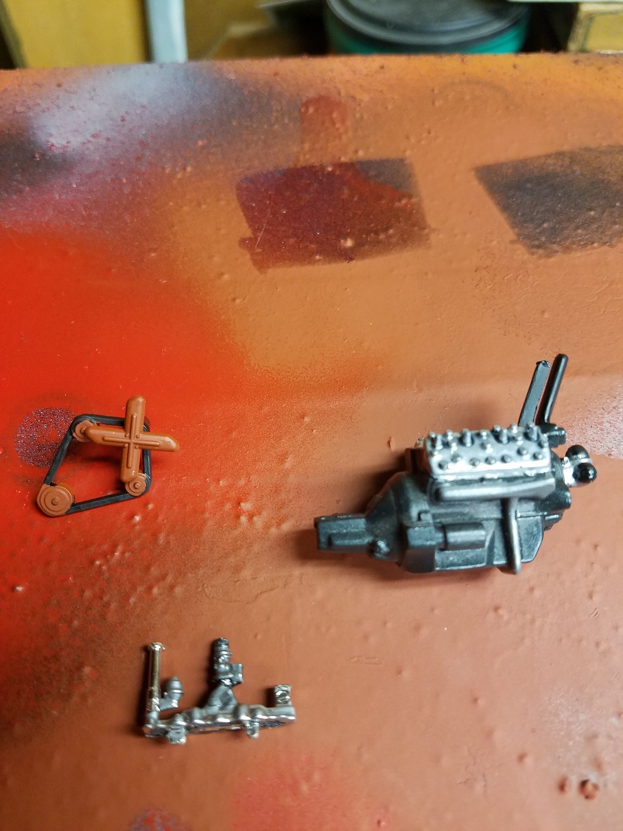

I got a bit more done with this one. I discovered a couple things I do not like so much about the Monogram engine. I find the molded in radiator hoses are only half rounds. Also, I started to put booties for the spark plugs on each of them but when looking at reference photos of the engine this was incorrect, so I will be changing what you see here.

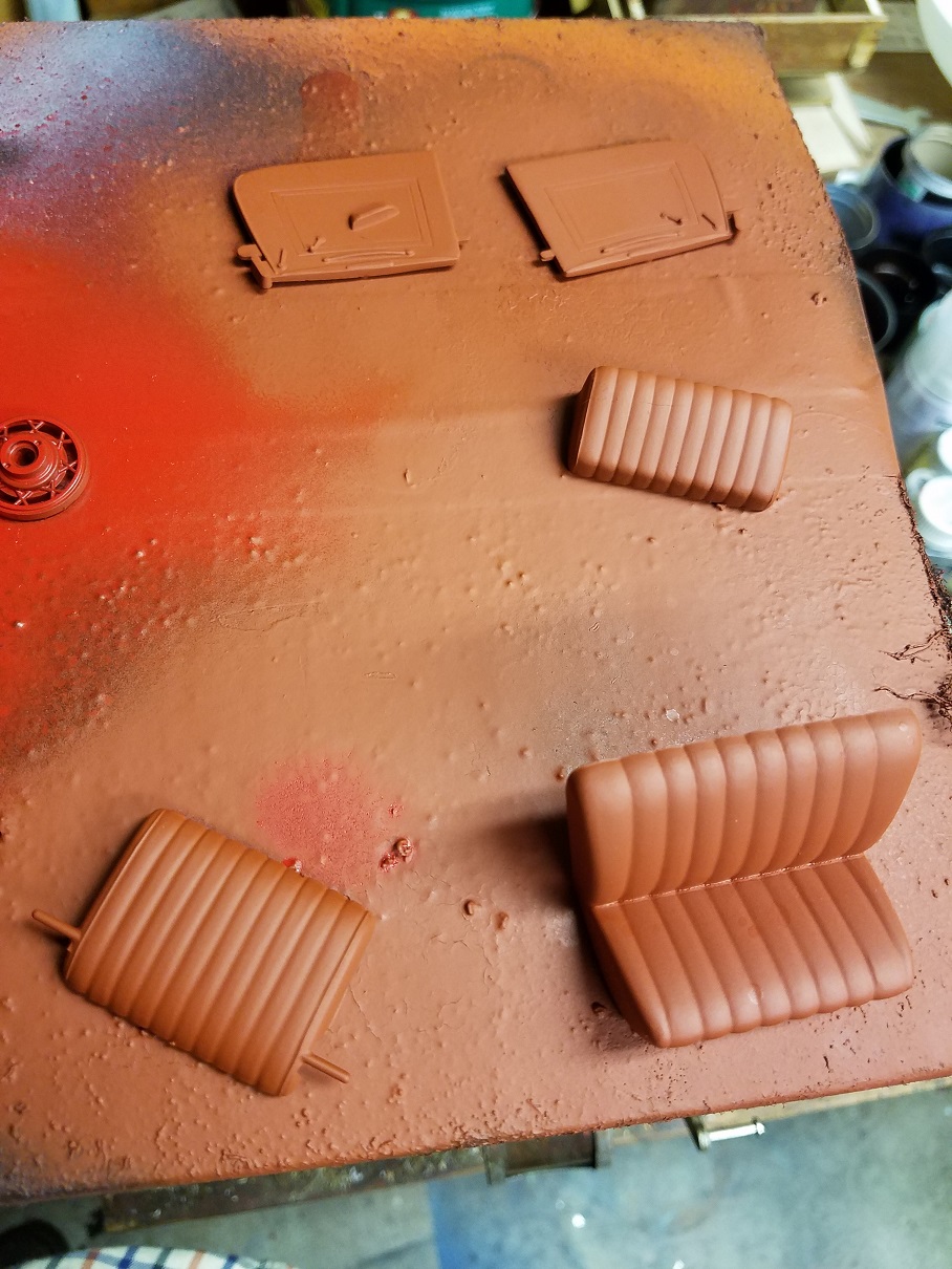

I am still trying to decide if I want to replicate a car with a leather interior which is sort of a mottled pattern of brown and copper colored leather or (probably more correct) a tan mohair interior. In either case, I needed to get some primer on all the interior pieces. Here is what I have so far. Thanks for the kind comments so far.

I decided I did not like the look of the engine with the spark plug "booties" so I removed the heads and replaced them with another set. I am struggling with aluminum vs. cast iron painted heads but decided this is a Deluxe car (as it is a Cabriolet) and likely would have the upgraded engine. I did some detail work on the engine and accessories but need to do quite a lot more to bring it to life. Here is where I am so far.

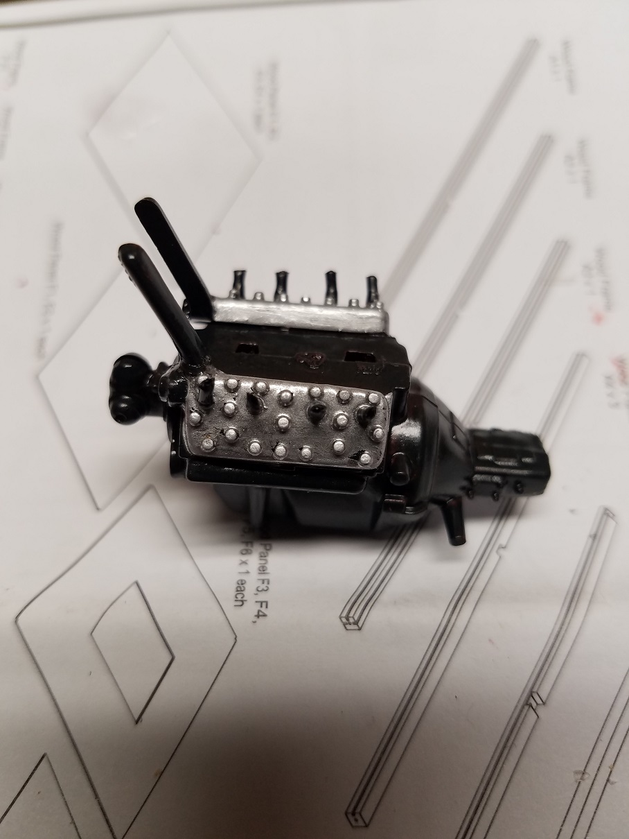

Here is the completed engine sans wiring. Thanks again to all for all good information. Sorry for the somewhat blurry images. These were "quick" photos.

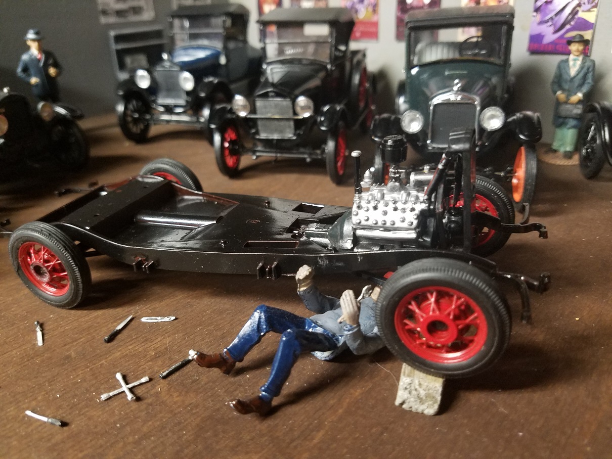

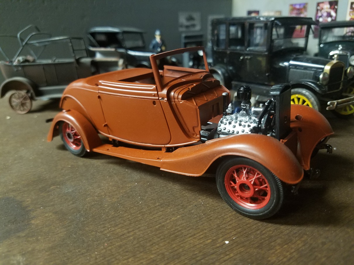

So it has been said on this forum that you reach the half way point when you have the wheels mounted. I have gotten there. That being said, It has been two steps forward and a big step back. I not only got the wheels in place but got paint on the car. And there is the problem. I had a significant problem with the paint. It came out as an absolute mess (I used Rustoleum paint and primer in one, over Duplicolor primer-something that usually works for me) so into the tub of purple haze it goes. I still plan to add wiring and plumbing to the engine but have to get some tubing first.

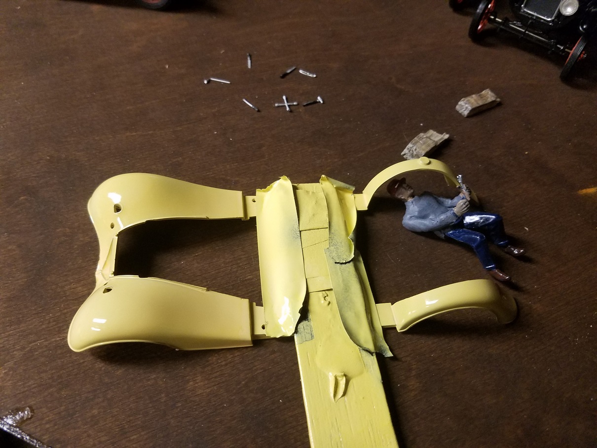

So I figured out what I did wrong. I sprayed the paint in my garage (always do in the winter) and it was simply too cold to be blowing paint out there. Yesterday it was nearly 60 here in balmy Michigan and I had the paint up to 70 degrees on a freshly stripped and prepped surface. Here is what I came up with. MUCH better.
