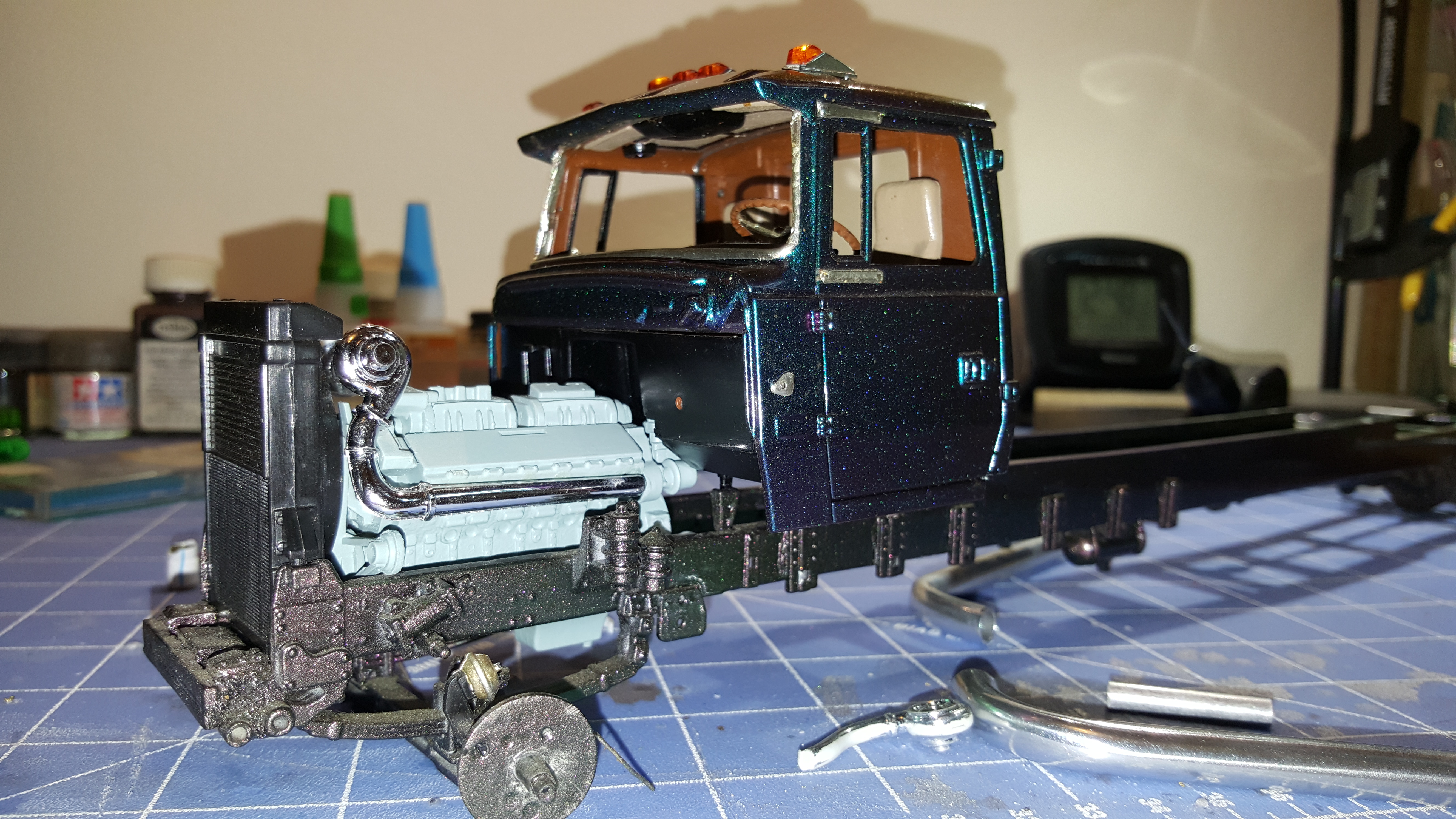

highway Posted January 4, 2018 Share Posted January 4, 2018 9 hours ago, TheSDTrucker said: I always used to wander why some 71 series had 92 style valve covers, I guess that really makes sense now haha. As far as color goes, I couldn't find any model paints that I liked, so I decided to use alpine green engine enamel for my engine. I really like how sharp the alpine green looks on those old Detroits I used Model Master USSR Fulcrum Gray/Green to hopefully get close to Detroit Green, and at least to my eyes, it is at least close. Quote Link to comment Share on other sites More sharing options...
TheSDTrucker Posted January 4, 2018 Author Share Posted January 4, 2018 5 hours ago, highway said: I used Model Master USSR Fulcrum Gray/Green to hopefully get close to Detroit Green, and at least to my eyes, it is at least close. That is very close to alpine green. My only problem was that our hobby store (Hobby Lobby) has a very limited supply of anything. So I just headed to the local auto parts store and there it was, alpine green engine enamel. I guess that's just what happens in small towns haha Quote Link to comment Share on other sites More sharing options...

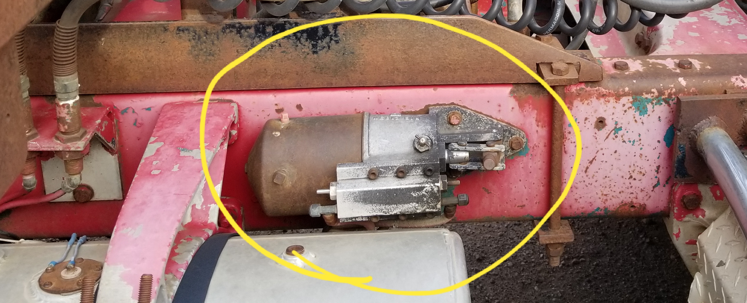

TheSDTrucker Posted January 4, 2018 Author Share Posted January 4, 2018 As I was viewing some of my research pictures again, I noticed something on the frame above the fuel tank that I've never seen before. I circled it in yellow. Do you guys know what this is? Quote Link to comment Share on other sites More sharing options...
DRIPTROIT 71 Posted January 4, 2018 Share Posted January 4, 2018 That is the cab jack to lift the cab. Quote Link to comment Share on other sites More sharing options...
TheSDTrucker Posted January 4, 2018 Author Share Posted January 4, 2018 5 minutes ago, DRIPTROIT 71 said: That is the cab jack to lift the cab. Oh, I see it now. Towards the right is where you would insert a jack handle. How good are these pumps at lifting the cab? Is it a pretty slow or quick process? Quote Link to comment Share on other sites More sharing options...

DRIPTROIT 71 Posted January 4, 2018 Share Posted January 4, 2018 43 minutes ago, TheSDTrucker said: Oh, I see it now. Towards the right is where you would insert a jack handle. How good are these pumps at lifting the cab? Is it a pretty slow or quick process? Not sure on these. An 1983 model was made very similar and they worked pretty well. Not terribly fast or slow if I remember correctly. I could jack a cab up at 13 with no problem, of course I had to slide in between the tank and quarter fender. Quote Link to comment Share on other sites More sharing options...
TheSDTrucker Posted January 4, 2018 Author Share Posted January 4, 2018 10 minutes ago, DRIPTROIT 71 said: Not sure on these. An 1983 model was made very similar and they worked pretty well. Not terribly fast or slow if I remember correctly. I could jack a cab up at 13 with no problem, of course I had to slide in between the tank and quarter fender. Didn't the Freightliner cabs tilt out to a 90 degree angle? And how would you lower the cabs after you were done with any servicing you needed to do? Quote Link to comment Share on other sites More sharing options...
DRIPTROIT 71 Posted January 4, 2018 Share Posted January 4, 2018 19 minutes ago, TheSDTrucker said: Didn't the Freightliner cabs tilt out to a 90 degree angle? And how would you lower the cabs after you were done with any servicing you needed to do? Around half way (45 degrees) up on an 83 there is a safety catch. that was usually as high as we lifted them. Freightliner cabs were "supposed to tilt 90 degrees, but the times that we tried the cab would try to fall. My dad would run safety chains to the ladders to keep the cab from falling. They have a release like a regular hydraulic jack. IMG_7222 by Brian Smith, on Flickr IMG_7221 by Brian Smith, on Flickr IMG_7220 by Brian Smith, on Flickr Quote Link to comment Share on other sites More sharing options...
Muncie Posted January 4, 2018 Share Posted January 4, 2018 (edited) On 1/4/2018 at 12:43 PM, TheSDTrucker said: didn't the Freightliner cabs tilt out to a 90 degree angle? And how would you lower the cabs after you were done with any servicing you needed to do? Freightliner claimed the only "clyclomatic" dual action cab tilt pump. The pump worked when the handle was moved in both directions so it actually tilted the can fairly quickly - like Brain said, not terribly fast or slow. Once you got past 45 degrees, the weight of the cab would finish the tilt. There is a small valve, the thing sticking out with a crosspin above the cyclomatic valve, that controls up or down. The horizontal location in the photo is more correct than the vertical position in the AMT kit. But it needs to be far enough ahead of a fuel tank bracket so the tilt pump handle doesn't hit the fuel tank brkt. Edited January 21, 2018 by Muncie Quote Link to comment Share on other sites More sharing options...
