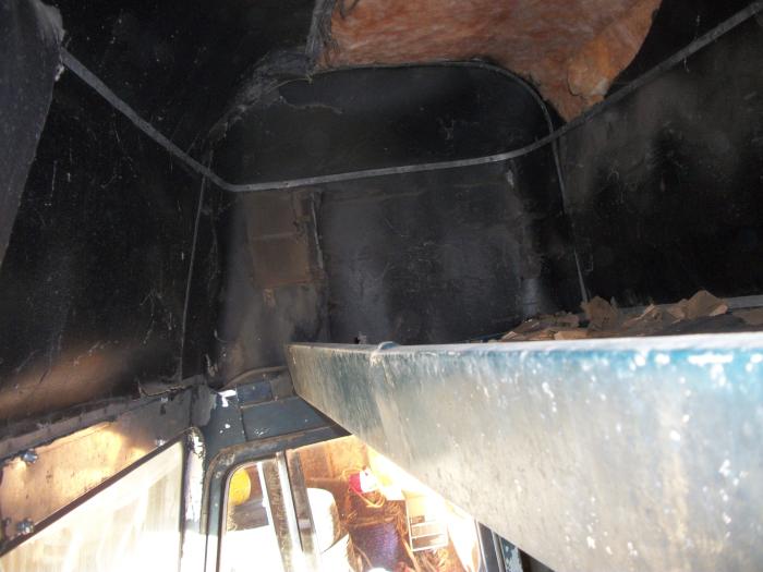

33 minutes ago, PettyKW43 said:
I sure am gleening a lot of info from this column, I was always wondering about the grille differince . I always thought it was just the Powerliner that was a 4inch wider cab. And thanks to the info on the two story, I never thought about a trap door!
had these saved ,just had to find them

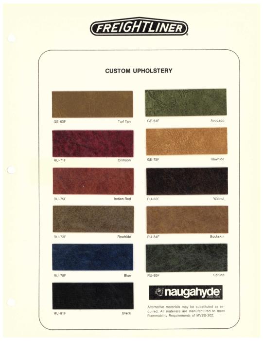

3 hours ago, mistermodel said:
found these.my dad had one with orange interior
Ok, I'll go with that.   Thank you for posting the color chart. I learned something.  My familiarity with Freightliner starts with the late 70's and the color selection was much more limited by then.  Most of those colors were gone.
That makes a lot more sense than what I was thinking. Great photos of a pretty rare truck configuration.
These charts are so cool! If only we still had a selection like this today..
