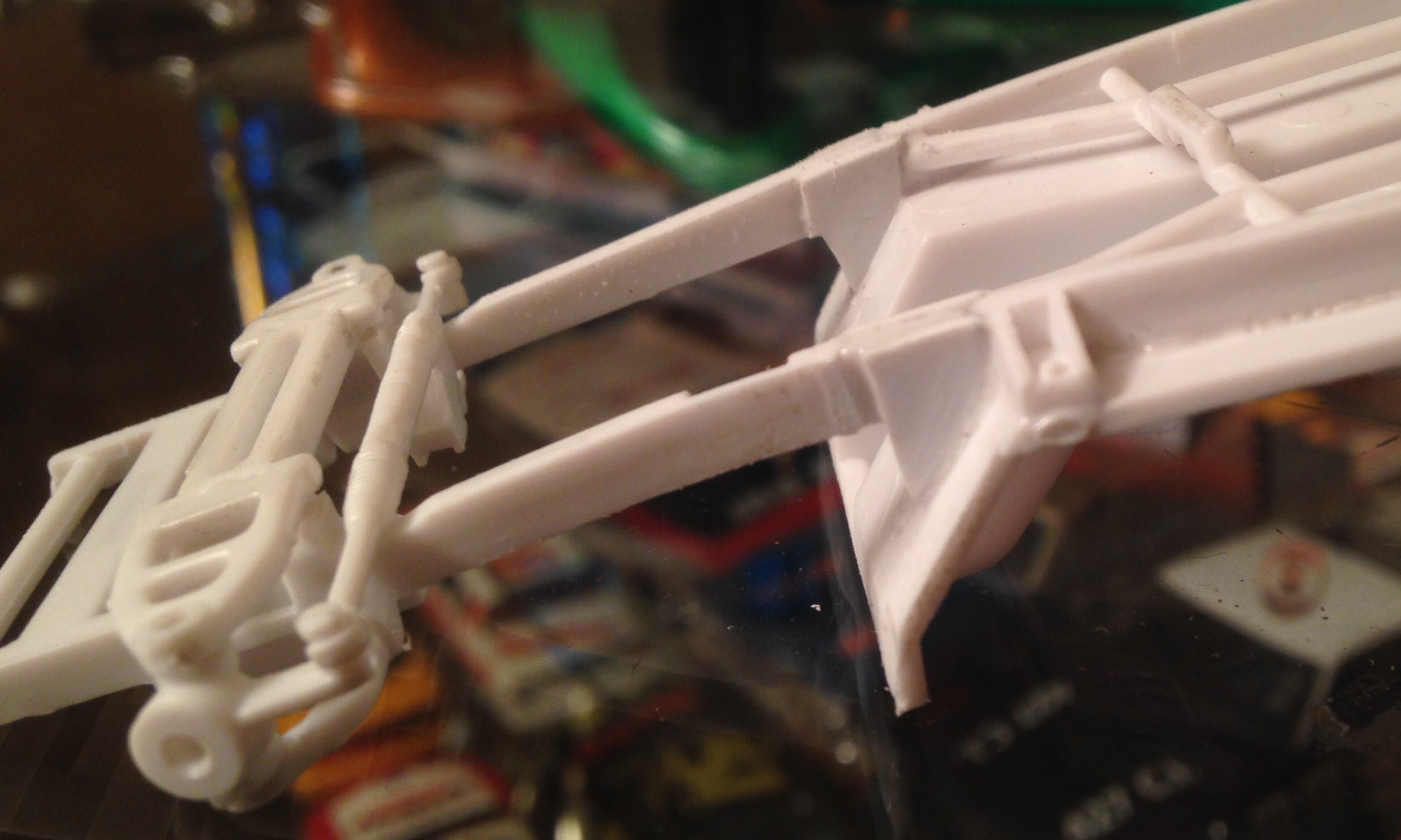

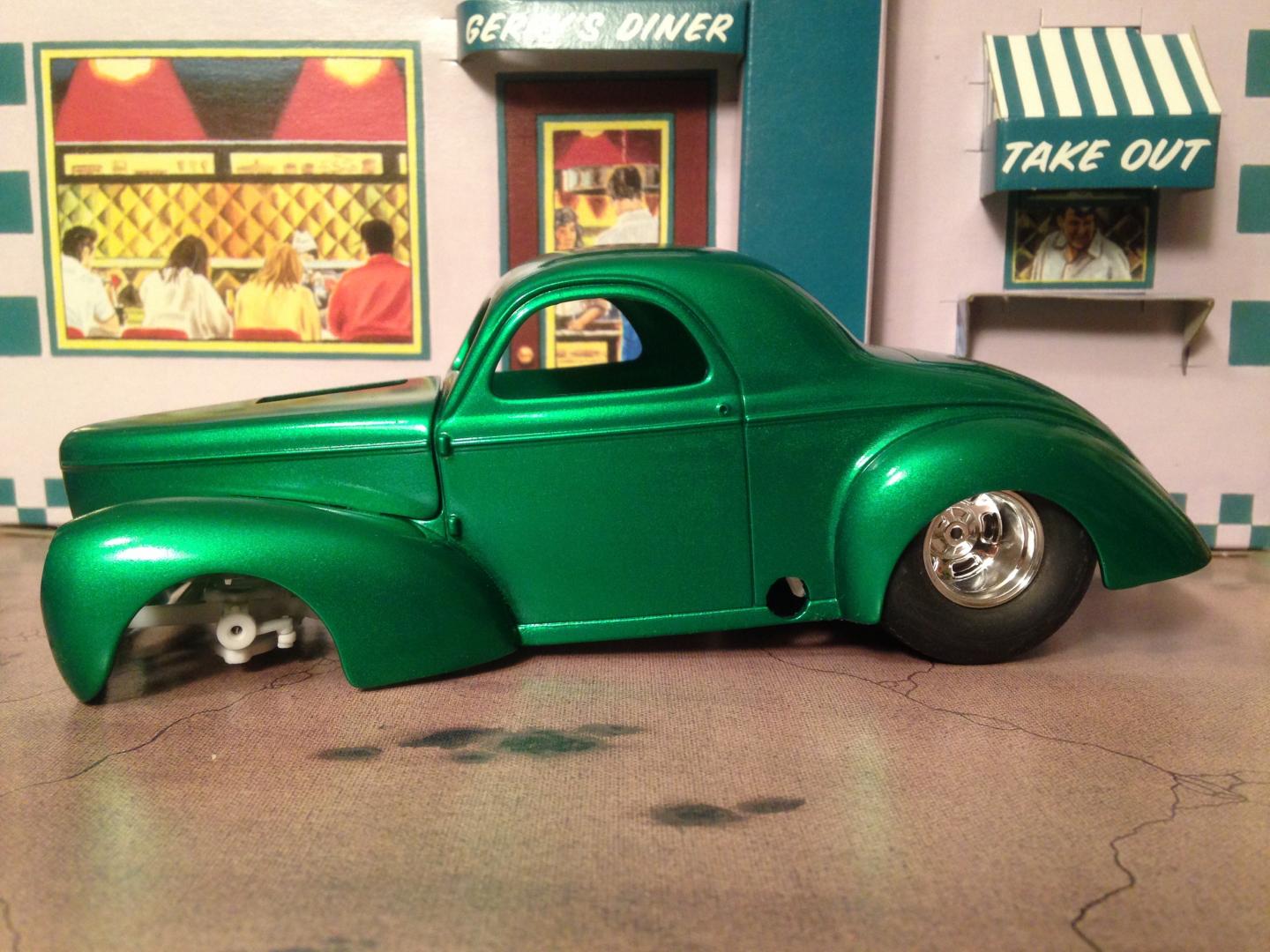

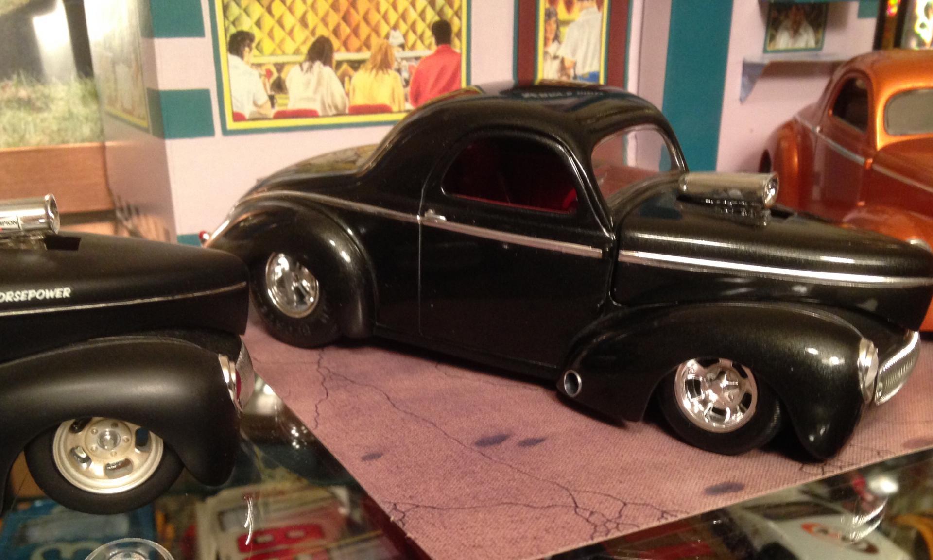

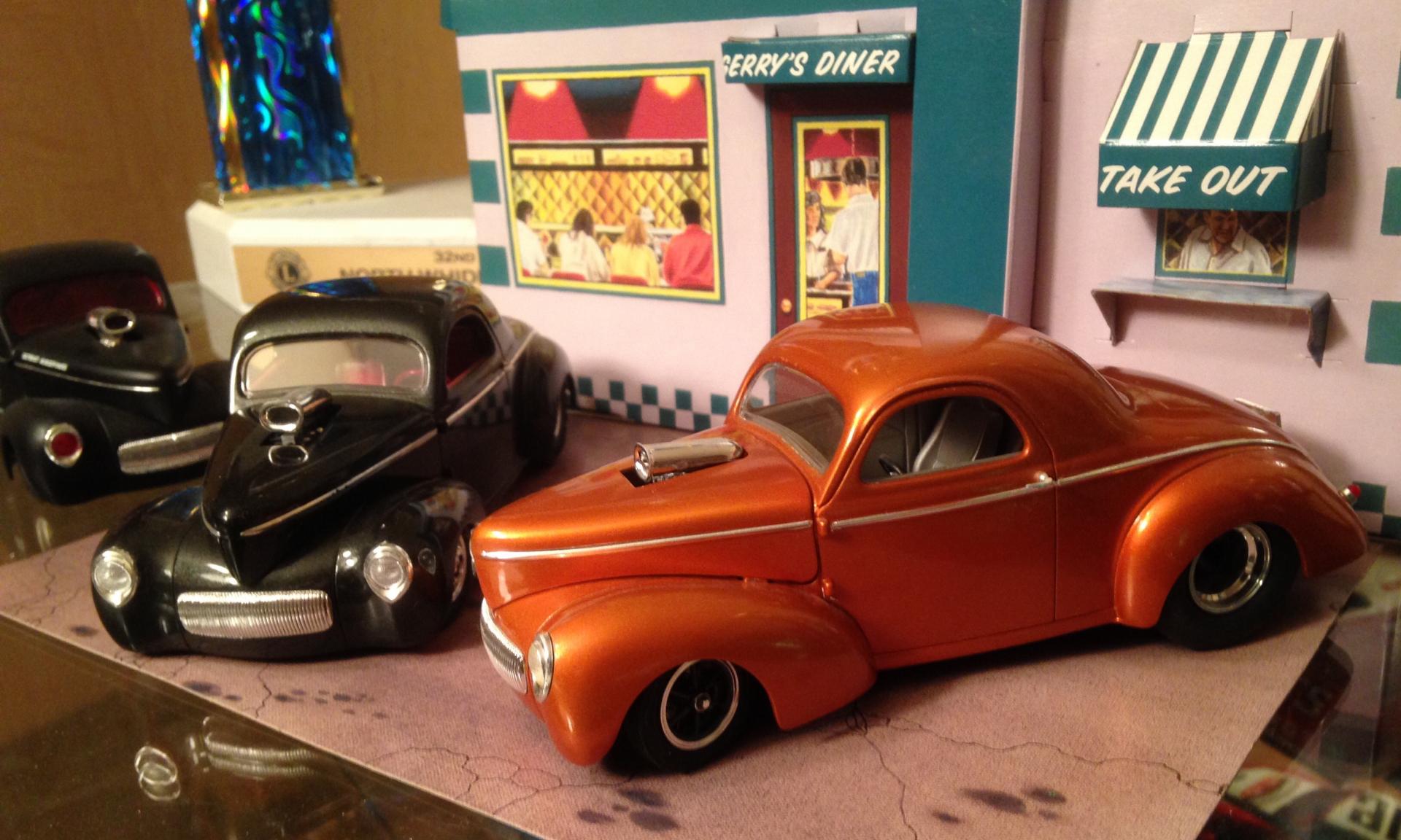

Hi Mike , here are some pics . I cut the frame just in front of the body mounts . And flip the lower a frames like yours but I cut the upper part of spindle off .  Then carve away the bottom of the frame for rack - tie rods clearance . The green one has Revell pro street Firestones stuffed up in it , tight .
Love your Willys  , Jeff

Thanks Jeff for the pictures.  It looks like you angled the front of the frame up a bit to lower the front suspension.  I actually like how yours looks more then what I did.  I'm just going to leave mine since it's all in primer now.  All your Willys' are beautiful!  I hope mine looks half as nice when it's done.
