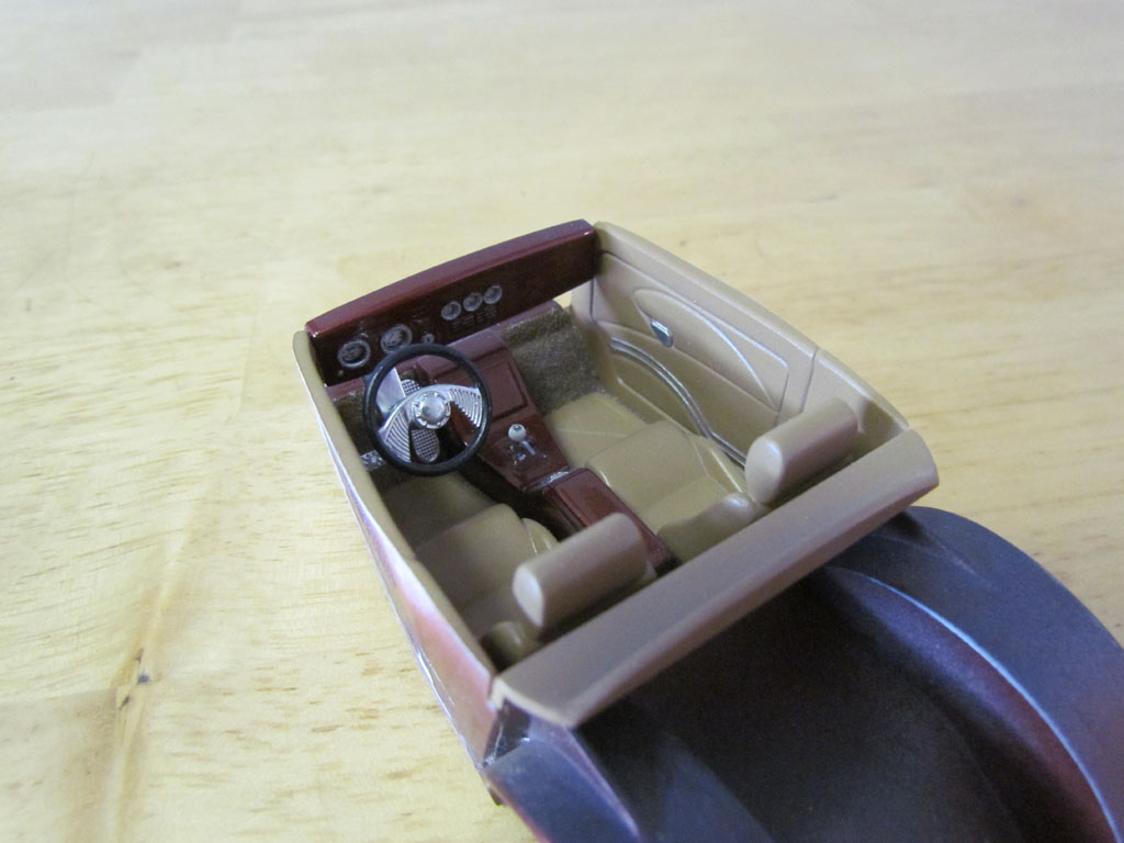

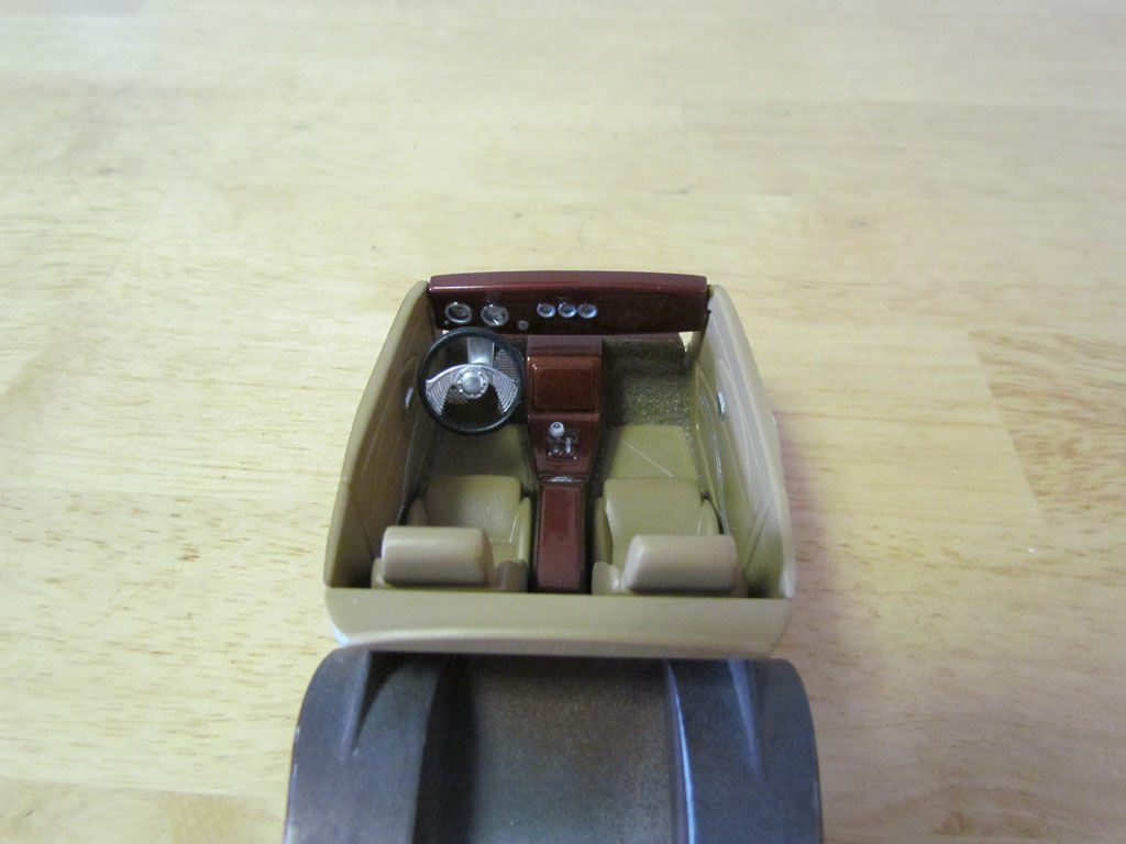

It's been a while but I'm finally finishing this one.  :)
The instructions say to cut out the dashboard gauge decals and not to dip them in water and glue in place.  Instead I cut the shapes out of .5mm sheet styrene and applied the decals.  I glued them in with canopy glue and used Testors clear parts cement to make lenses.
The interior's center console and dashboard are painted the body color as well.  It photographs almost red but it is a slight reddish-root beer brown color.
The tan is Tamiya XF-59 Desert Yellow which is actually a nice saddle tan color.  For the carpeting I used a Champagne color embossing powder I found at Michaels.  The 1:1 Willys that inspired this build doesn't have a finished interior since the owner decided to sell it before the interior was finished.  I picked saddle tan which seems to go really nice with the body color.  The steering column, the center of the steering wheel and brake pedal are airbrushed with Molotow Chrome and clear coated with Spaz Stix Ultimate Clear Coat.  I made the directional lever out of a straight pin.  It looks a bit more in scale than the plastic one that was attached to the steering column.
Since I built out the firewall I had to move the engine forward about 2mm as well as the radiator mount on the chassis.  The body slopes down at the front so I shortened the radiator a couple of millimeters and modified the electric fan to fit.
I originally lowered the front suspension about 3.5mm but when I test fit it I wanted to lower it another millimeter.  I sanded down the top of the chassis rails that attach to the floor to lower the front some more.  It worked out nicely.  Another problem I encountered with the lowered front suspension was that the tires rubbed up against the inside of the front fenders.  I shortened the upper control arms and the lower suspension cross member with the control arms.  I moved the wheels/tires in about 1.75mm on each side.  Now there's plenty of clearance and the wheels can steer.
The front wheels in this kit represent 13" wheels in 1:1.  They looked too small in diameter compared to the rear wheels.  For the front wheels I'm using a set of rear wheels from a Revell 40 Coupe Street Rod.  I had to cut the opening of the tires larger to fit them.
It's basically all together now except for the Enderle bug catcher and the part that goes underneath which I had to re-spray with Molotow. It should be finished in a day or two and I'll post pictures.
Thanks for looking in. :)

Thanks guys!
The lighting isn't so good today.  I'll take more pictures and post in the Under Glass section as soon as I get some sun.
Here's a quick picture with the hood off.  This picture isn't showing the color to well or the darker fade along the bottom.

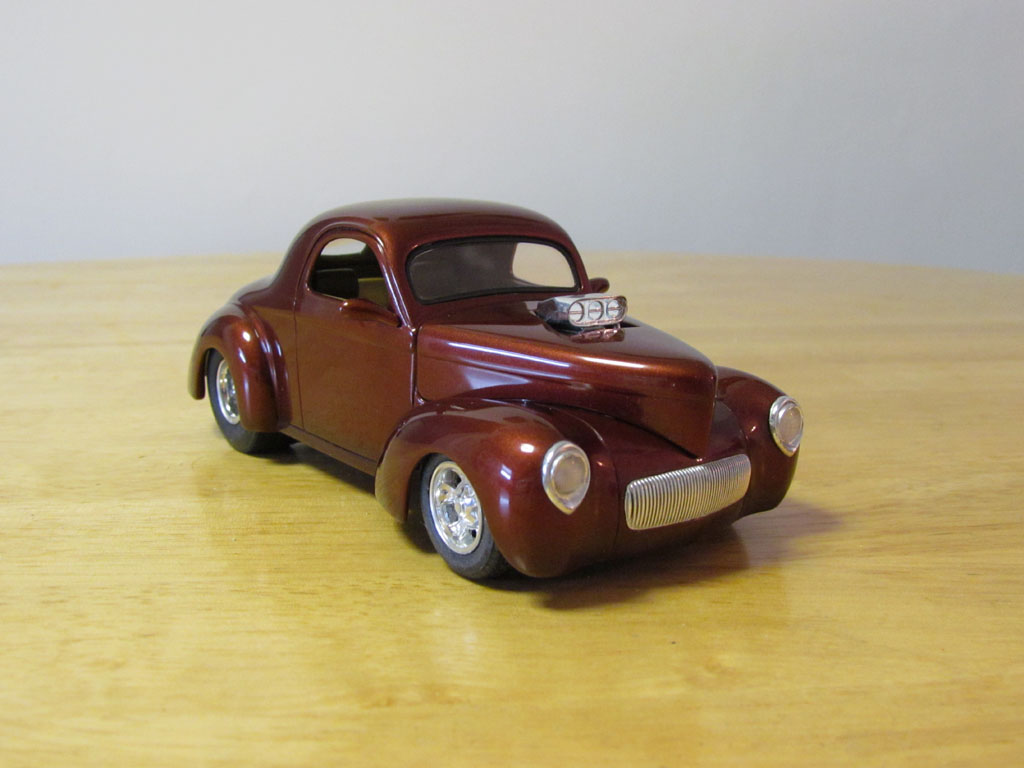

It looks like the sun will be out on Saturday so I'll take pictures.  It's been overcast so it's making the color look dark red and not as shiny as it really looks.
Here's another picture with the hood on.

Nicely done indeed. I've built these with a lowered front end, much in the same way you did. But it's not clear to me how you brought the rear end down. How did you do it. Nice low stance overall.
Share this post
Link to post
Thanks for the compliments!
I didn't bring the rear down.  It's in the stock kit's position.  I made the rear wheel openings smaller so that must be making the rear look lower.  On page 1 I show pictures of the original and modified rear wheel openings.
