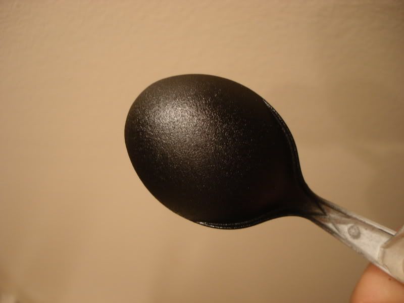

cruz Posted July 9, 2008 Author Share Posted July 9, 2008 Jairus, you are a genius man, I decided to try the 3M glue trick for the vinyl top and I am absolutely in love with the results man!!! It went on perfectly and once I laid my semi-gloss coats it really popped!!! I laid 2 soft glue coats within 1/2 hr. of each other and the rest is history. People, go out and try this!!!! This is how the can looks, I got it at Michael's..... If this is not a vinyl top look I don't know what it is!!!!! I took a picture with a lot of light bouncing off the spoon, it is less glossier than this. I used a mixture of gloss and flat back for a semi gloss look, I can always play w/ this mixture and ultimately come out with the glossy or satiny surface I want..... Quote Link to comment Share on other sites More sharing options...

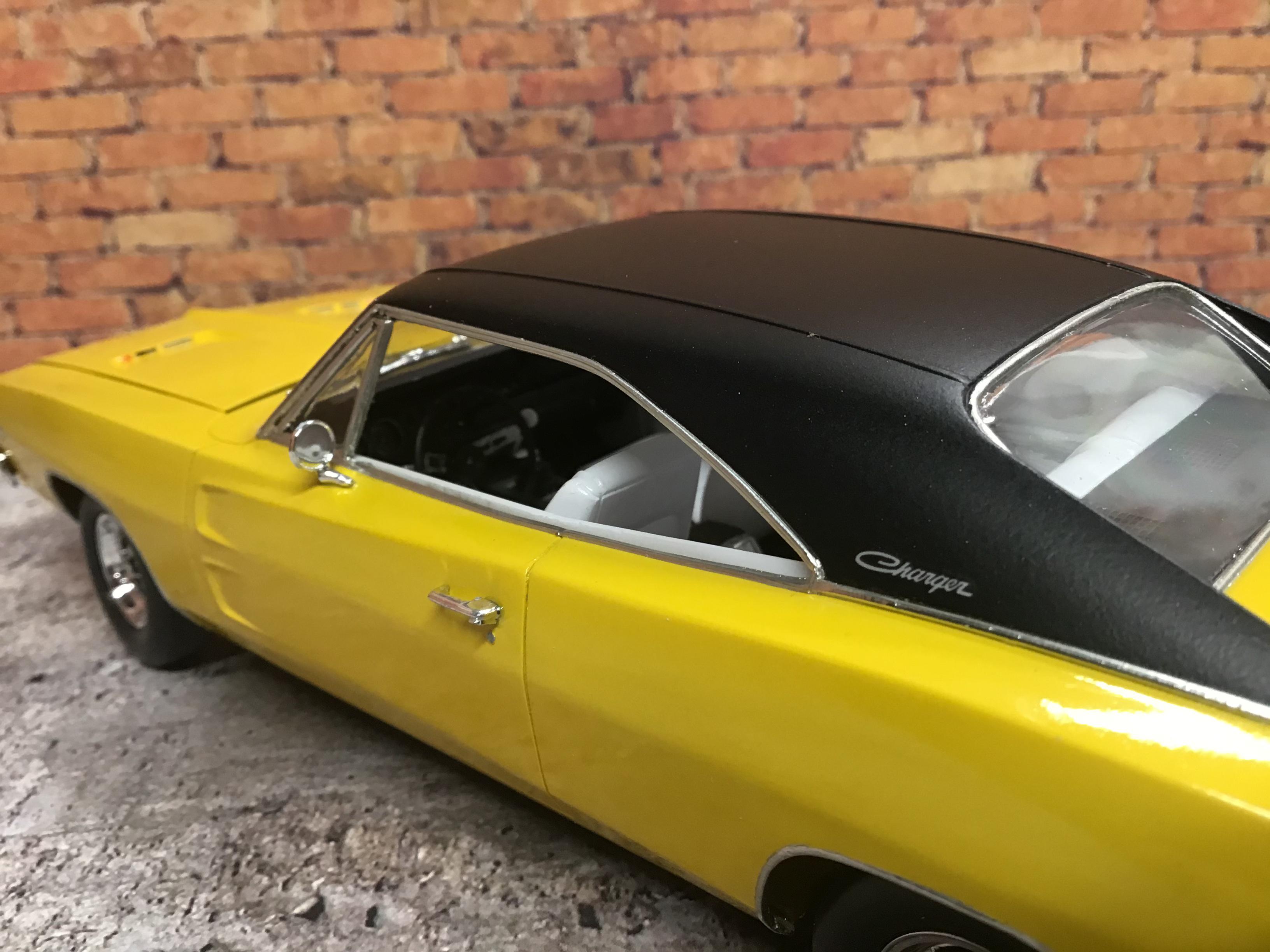

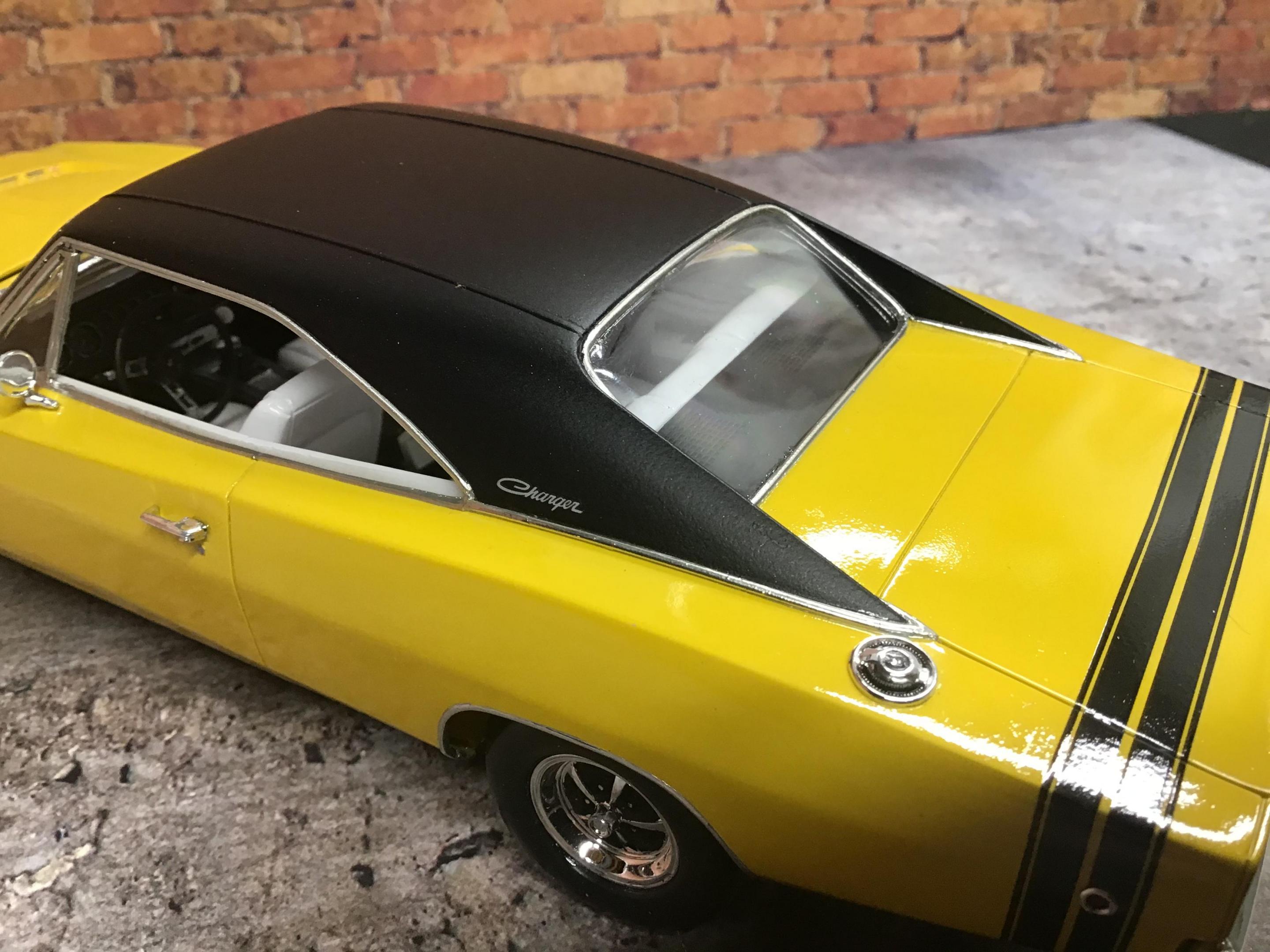

NOBLNG Posted November 11, 2020 Share Posted November 11, 2020 (edited) This is gloss black with one coat of Tamiya flat clear on top sprayed from a distance of 8”-10”. I did the gloss black first so that I could apply the decals. Edited November 11, 2020 by NOBLNG Quote Link to comment Share on other sites More sharing options...

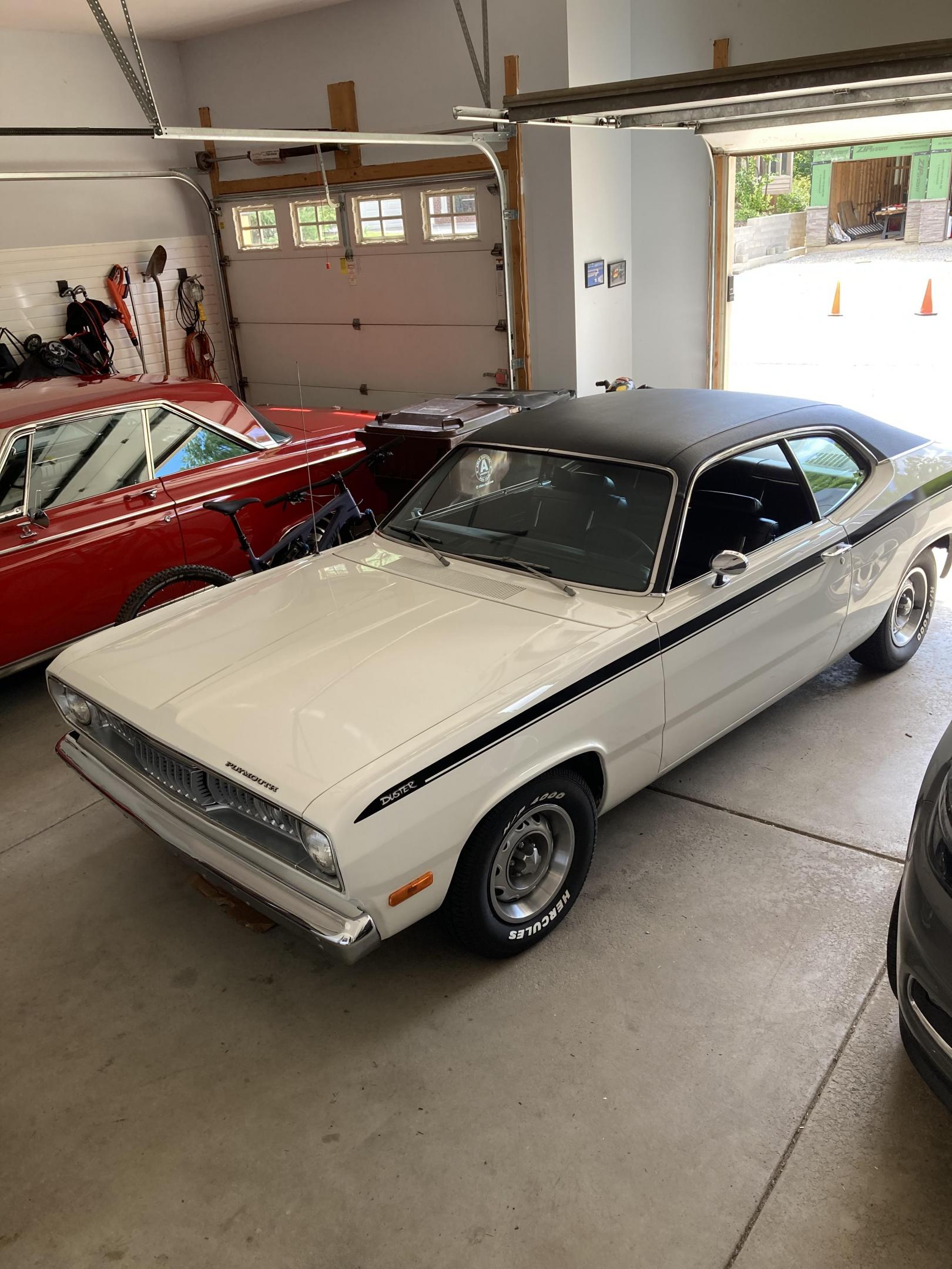

drodg Posted November 11, 2020 Share Posted November 11, 2020 My 72 Duster that I am replicating. Quote Link to comment Share on other sites More sharing options...
StevenGuthmiller Posted November 12, 2020 Share Posted November 12, 2020 10 hours ago, drodg said: My 72 Duster that I am replicating. There is a perfect example of how the vinyl texture is nearly imperceptible. Steve Quote Link to comment Share on other sites More sharing options...
