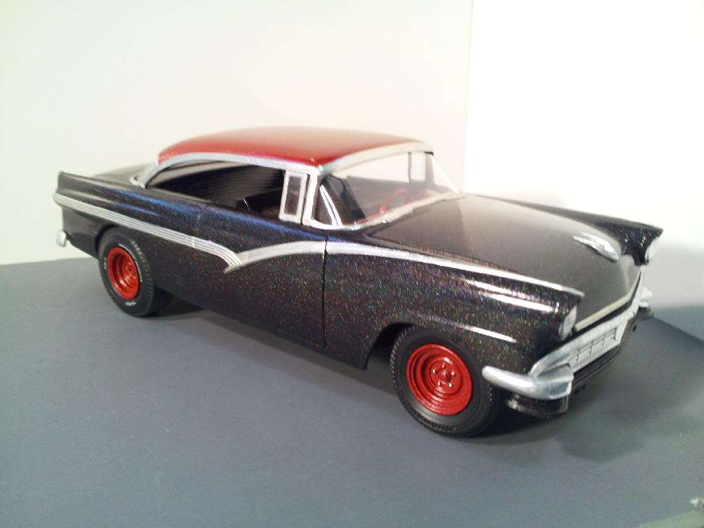

I did a Duplicolor paint on this one. Pretty colorful. When I posted it years ago, I got a little beat up about the flake in the comments, but I didn't care, I like it.
