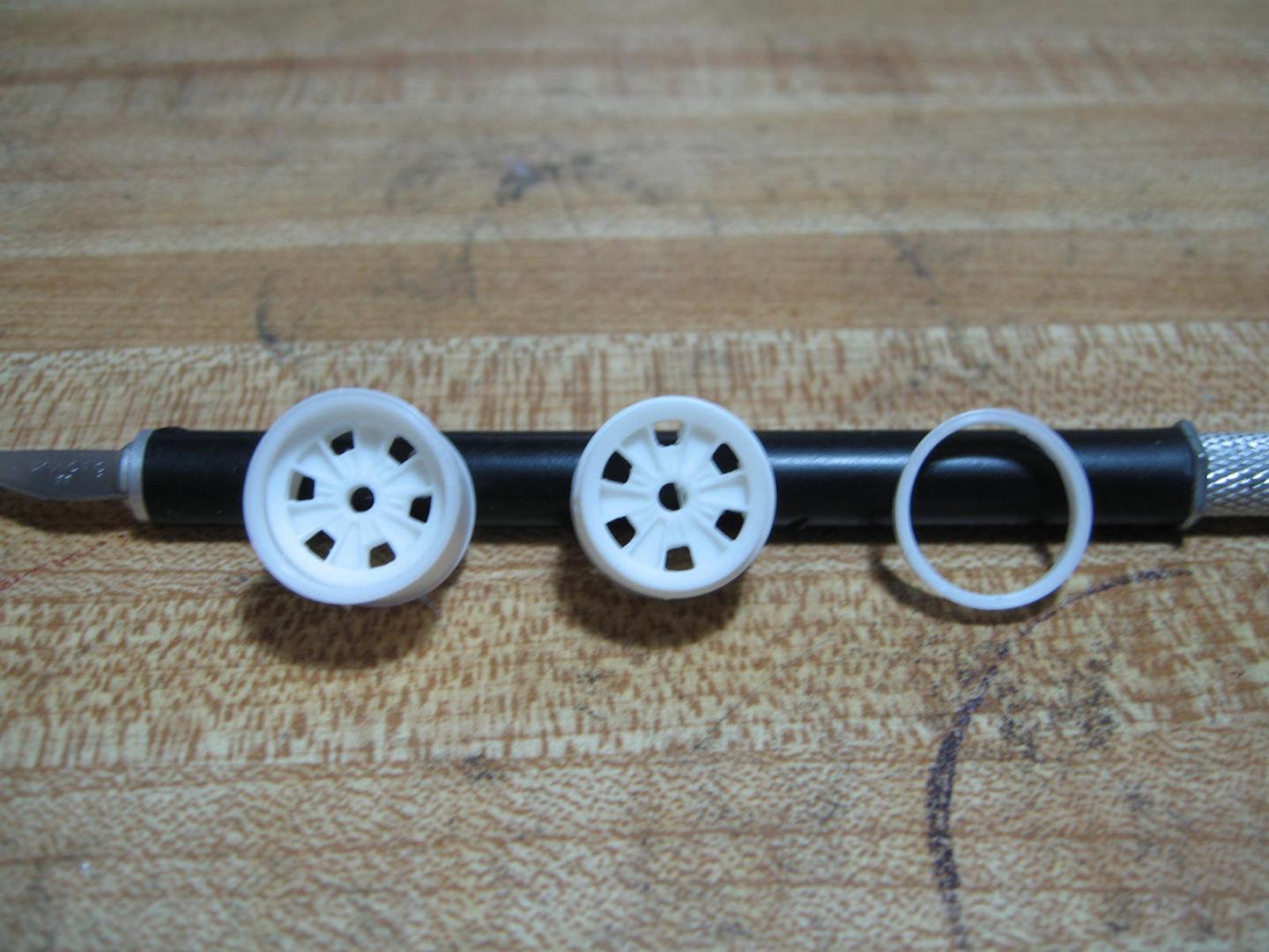

will  test  on junk wheels,  wheels should have little shine.

You might want to try Alclad "Dark Aluminum" for that.
Polished aluminum will be brighter.
Steve
