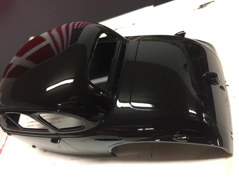

Being a member here for quite a while, I know not all are into facebook, VK, and similar "social media" sites. I'm into facebook, and there, in a lot of model car groups. Once in a while something really cool shows up.
This week I was looking at the posts of the Revell and Monogram model cars group, and found the work done by Michael Ejs Bredgaard, from Denmark. He does the very best brush painting on model cars bodies I ever saw.
Take a look:

That is remarkable! I'd like to know his secrets for obtaining such a nice finish with brushes.

Holy c r a p... I'd like to know how to do that.

I know some of the secrets. Use enamel. Thin the paint about 60-40, varies with brand and color. Use a fairly large flat brush. Only brush INTO the wet paint, lifting as you meet the previous stroke. Keep the paint fairly heavy (not too heavy!) and wet. NEVER touch any area that already has wet paint on it except for finishing the next stroke. Light sanding with 1500 between coats. Don't expect even coverage right away, you might need five coats to cover. I've seen praise for Humbrol, especially for gloss black. Finally a coat or two of spray clear is often done.
It takes a lot of practice to develop the techniques. I've had some moderate success but my bane is always dust and floating cat hair (arrgh.

You nailed what he does. Even the Humbrol enamel paint.
I had zero success on brush painting anything glossy larger than a radiator, or a engine block. Cats hair? That's inevitable.

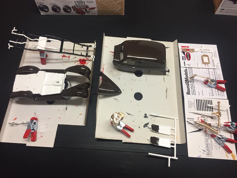

Those are remarkable.
I have a friend in Model Airplane world who has been building 1/72 airplanes for at least 40 years and has probably hundreds of them, all hand-brushed. He's only tried his hand at a few cars but he managed to achieve an amazing finish on those as well, simply not knowing that "it can't be done."
