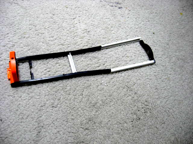

OK. This ought to be interesting. The picture shows the truck I've been wanting to build for a long time.It was in an issue of Rod & custom magazine in the early 70's. I bought a Big T frame the other daymand started. The wheelbase comes out to around 15.3". I cut the frame off right before the kick up,and made some new rails. I'me using a Bit T front suspension, with a Camaro rear end w/ buggt spring. The engine will be Monogram's Chevy with a 4 barrel carb and intake from the PE62 engine kit. The body is going to be scratch built from styrene and I may use basswood for the bed.I figured it's going to be around 23" when it's done. Then I'll have to find a place to put it...

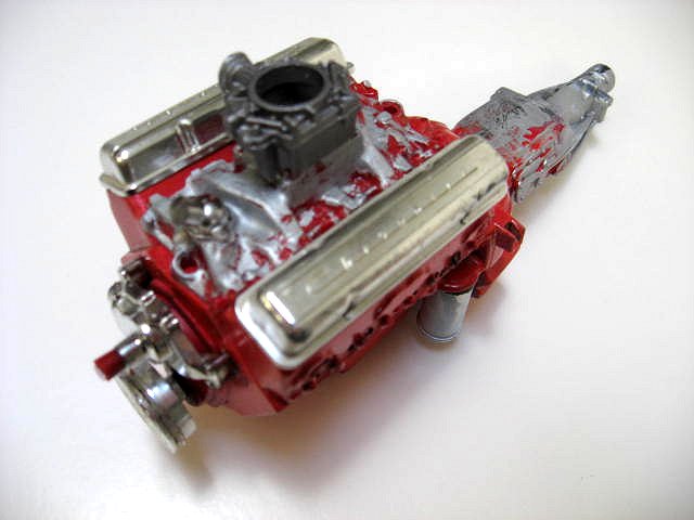

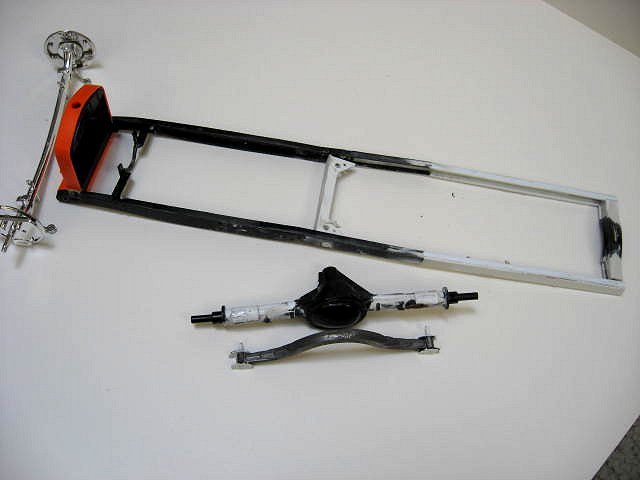

OK, I'm back. I had a project that got in the way of this. The engine is mostly done,with a few vintage parts. The rear end -from a 1/8 Camaro -has been narrowed,and the gap on the top filled. It's being converted to a buggy spring and Big T backing plate and drums.The front axle is a Big T. The front crossmember will have to be modded to fit the Lindberg radiator shell.
