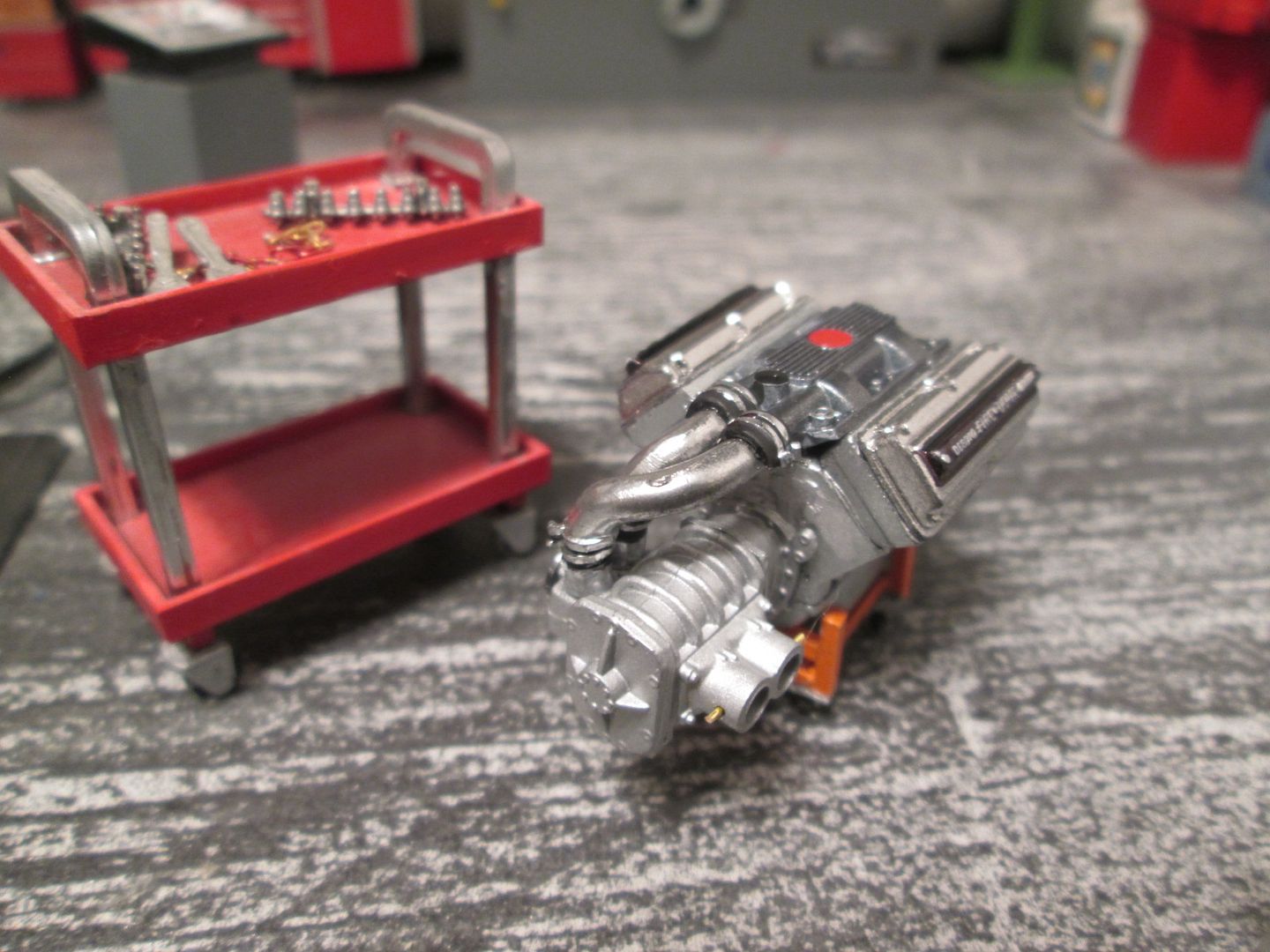

This is a junkyard engine with the blower from the Parts Pak, as above
Share this post
Link to post
Good heavens, I own several of the things, then. Didn't even know it!
