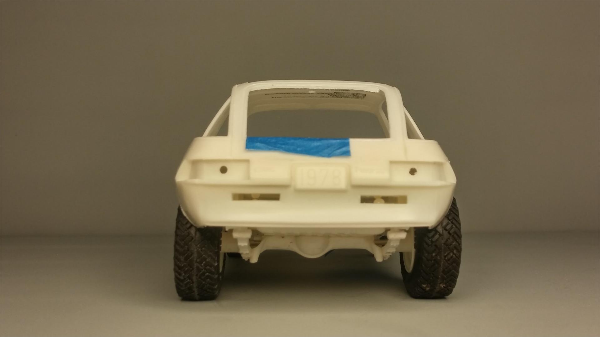

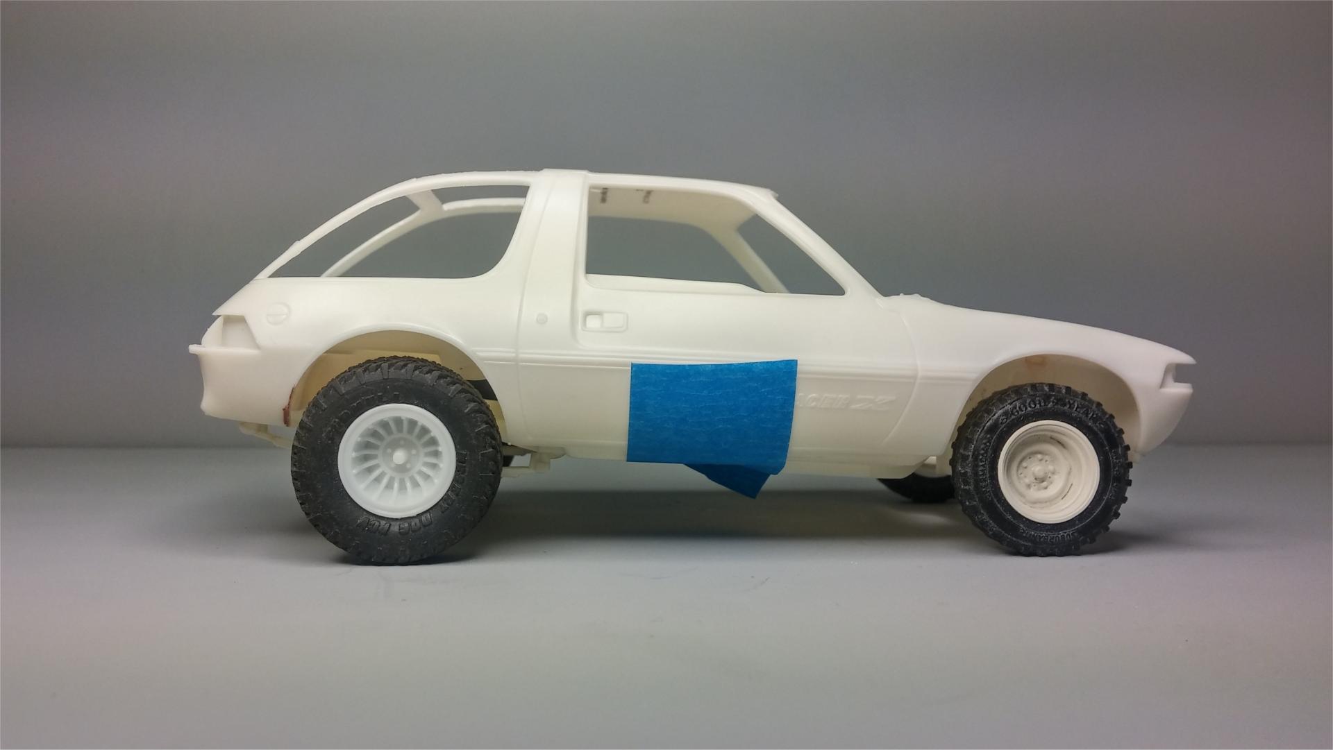

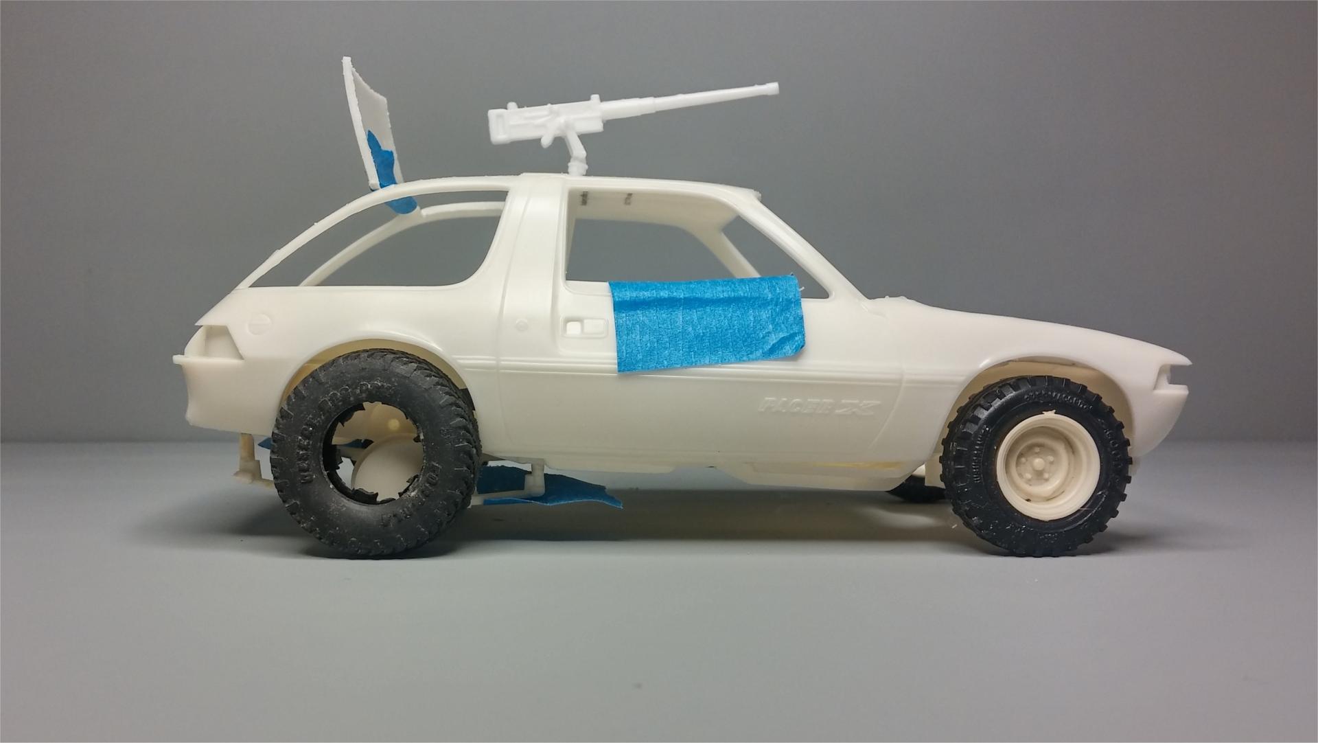

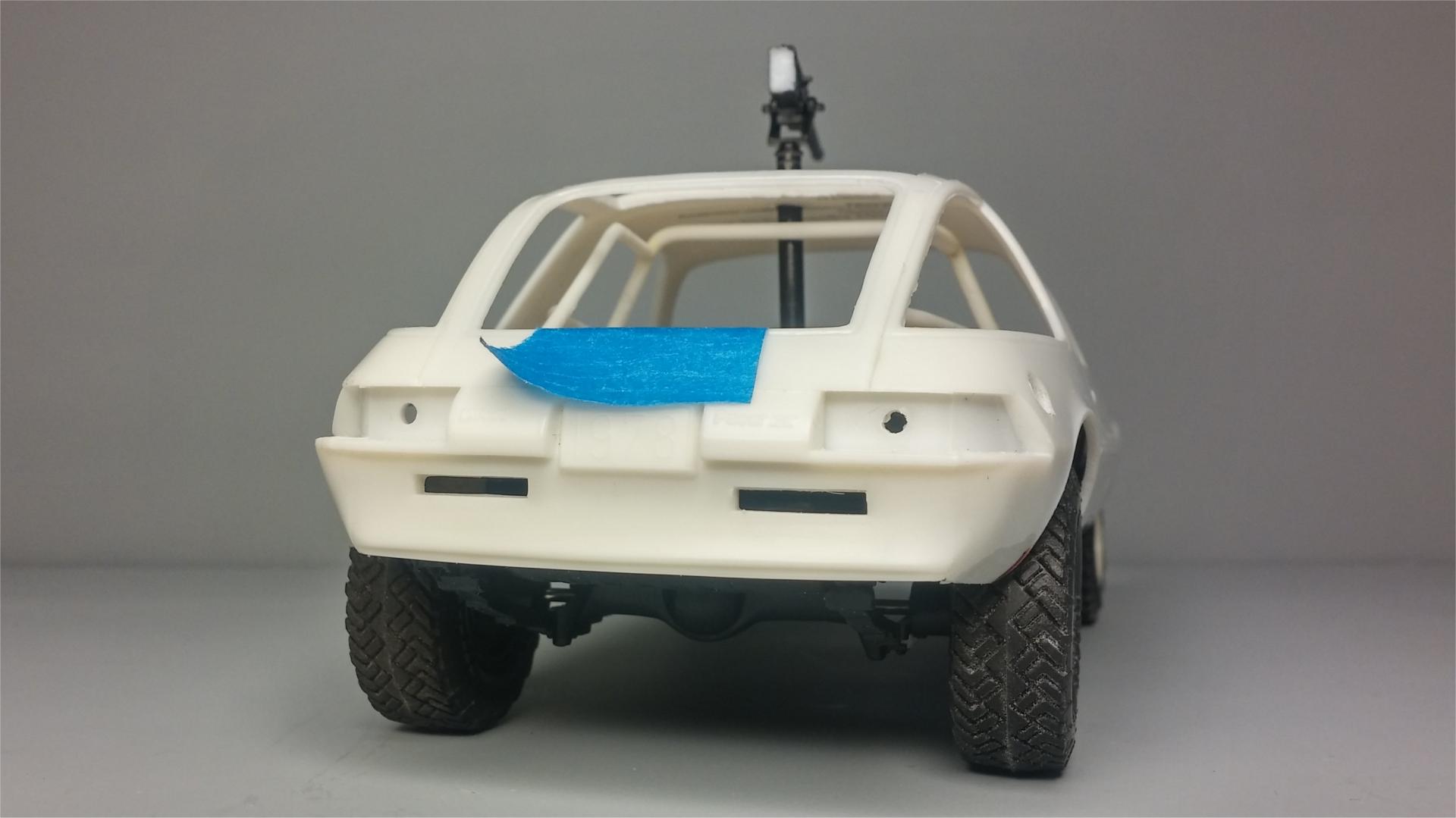

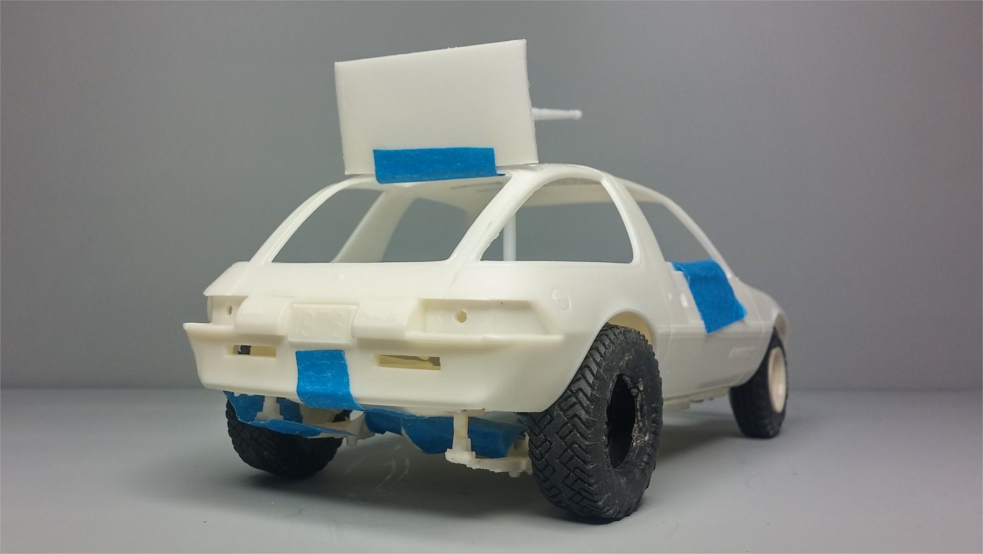

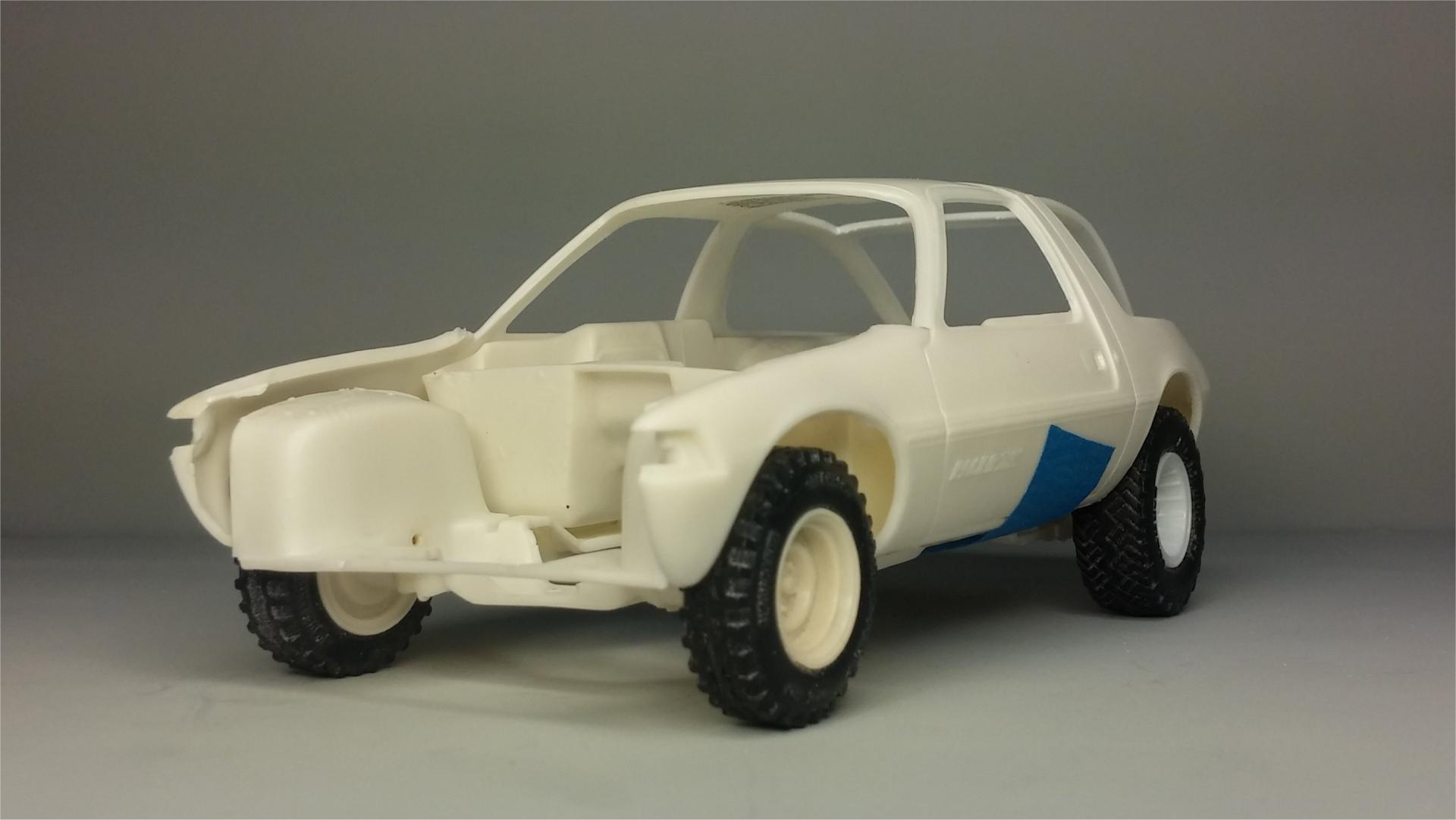

David G. Posted February 2, 2018 Author Share Posted February 2, 2018 Thanks Gary and Kerry- wait, you guys need to stop rhyming . OK, I got the junk-box axle epoxied to the chassis. I just slapped it over the one that is cast into the chassis plate. At this point I'm more interested in "shelf appeal" than detail. It took a bit of fiddling but I managed to get the rear axle lined up nicely. I also raised the front about two inches to offset the rake that developed and give the car a bit more of an off road stance. I'm not sure what I'll do about the engine. I'm still considering a curbside build. Or I may just build the 258 six-banger and slap it in there. That stance does make it look ready to pounce, though. As always, thanks for taking the time to look and please feel free to comment. David G. Quote Link to comment Share on other sites More sharing options...

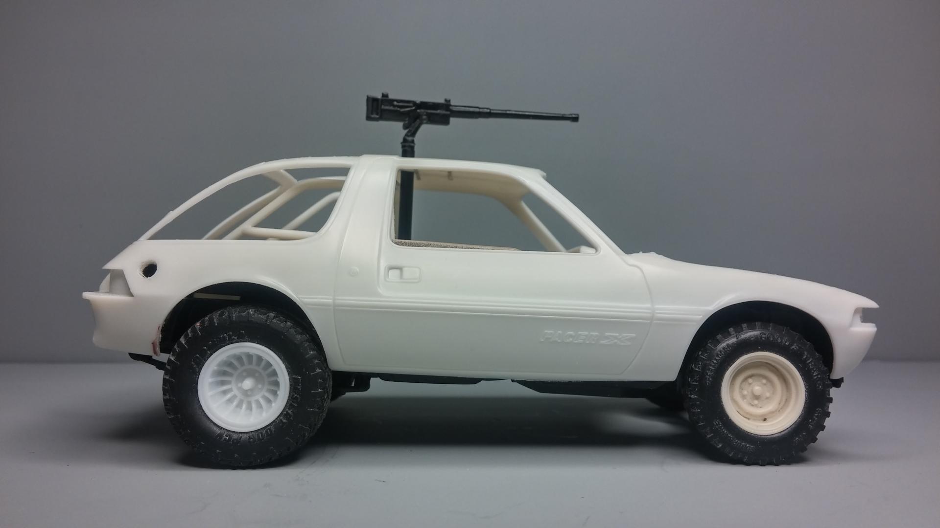

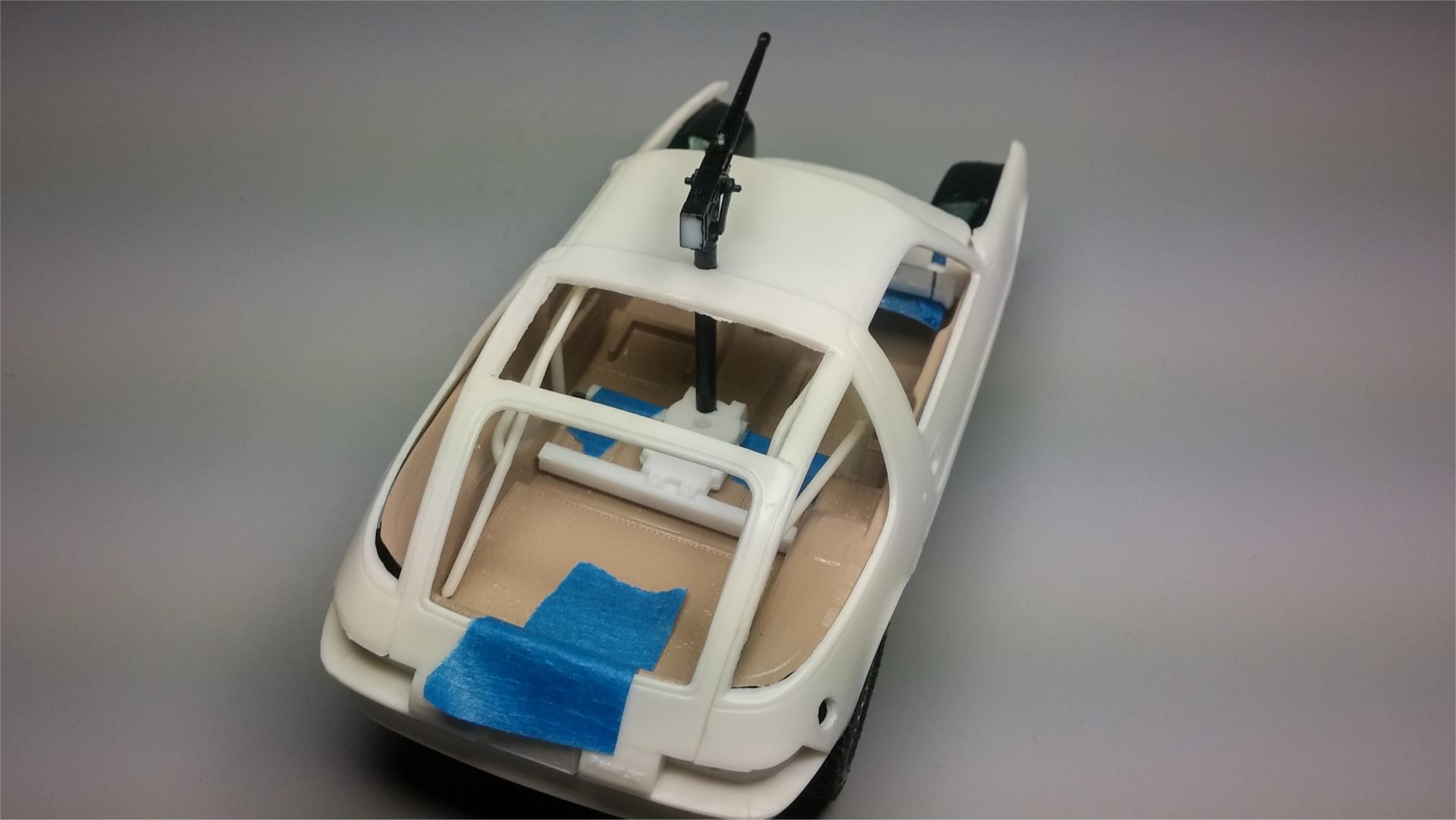

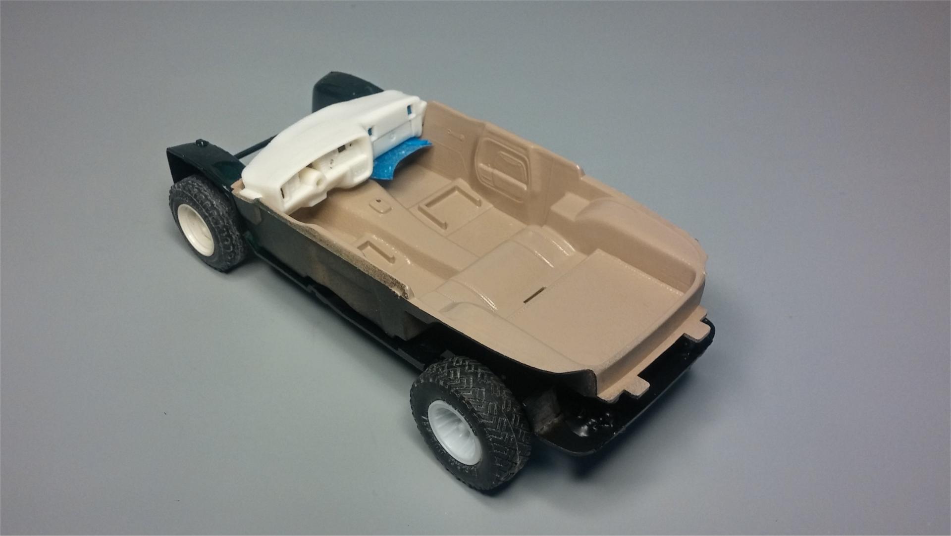

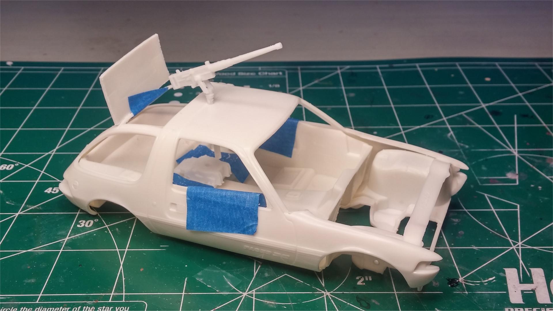

David G. Posted February 5, 2018 Author Share Posted February 5, 2018 Hello again, time for another update. I got some painting done, sprayed the chassis in black, the interior in tan and selected a dark metallic green for the body. I also cut the AC vents, radio and gauges from the dash board. I'm using the mounting point that goes with the .50 cal that I've borrowed from the MPC WWII Army Jeep. This Pacer kit also has roll cage for the rally version- nice coincidence. I like the way this one is coming together. Nice profile. As always, thanks for looking and please feel free to comment. David G. Quote Link to comment Share on other sites More sharing options...

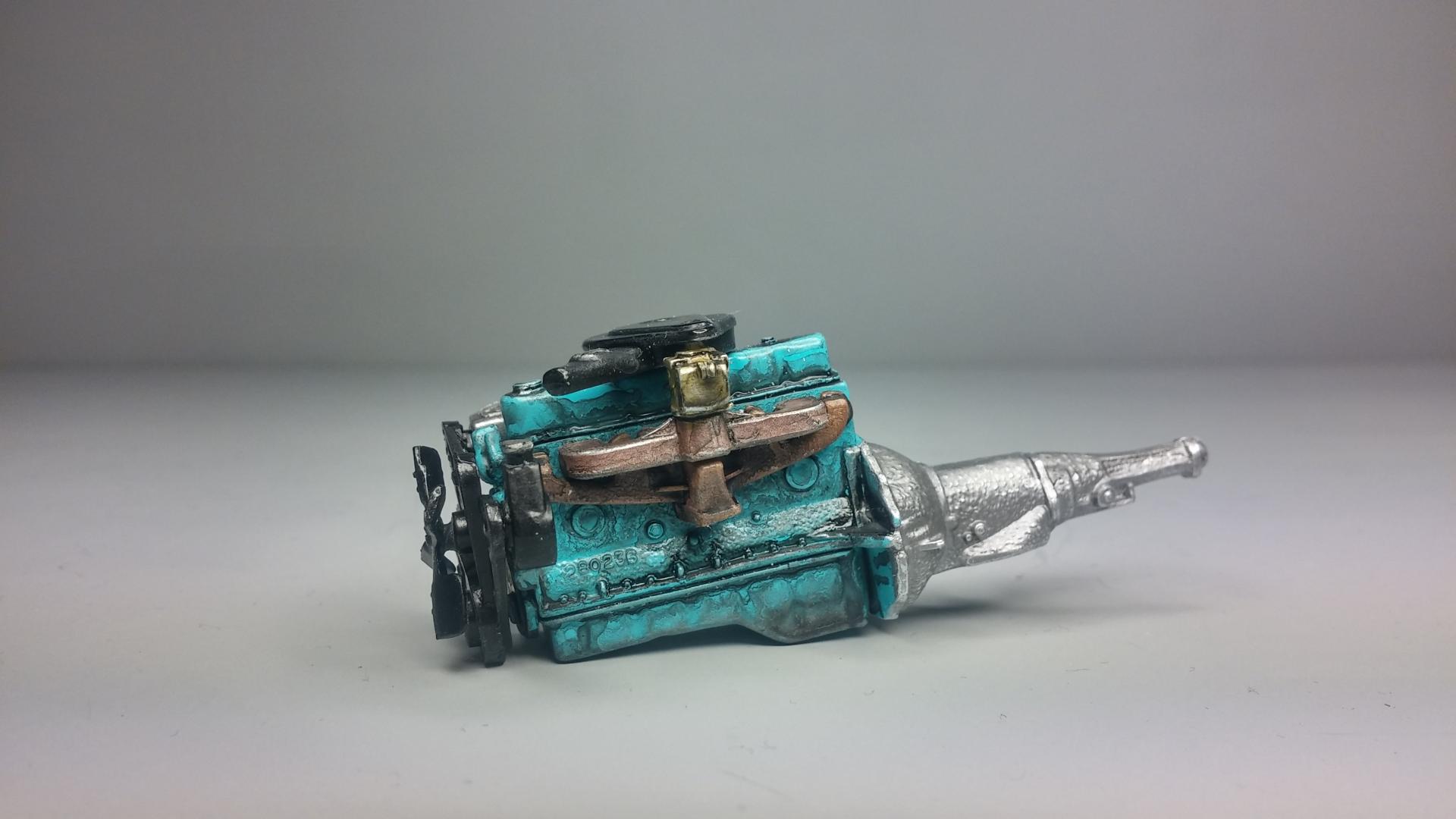

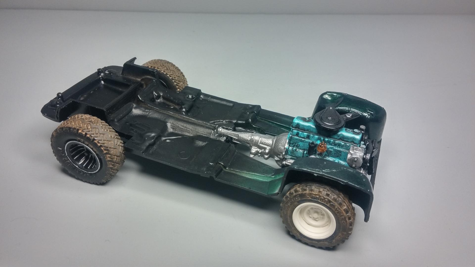

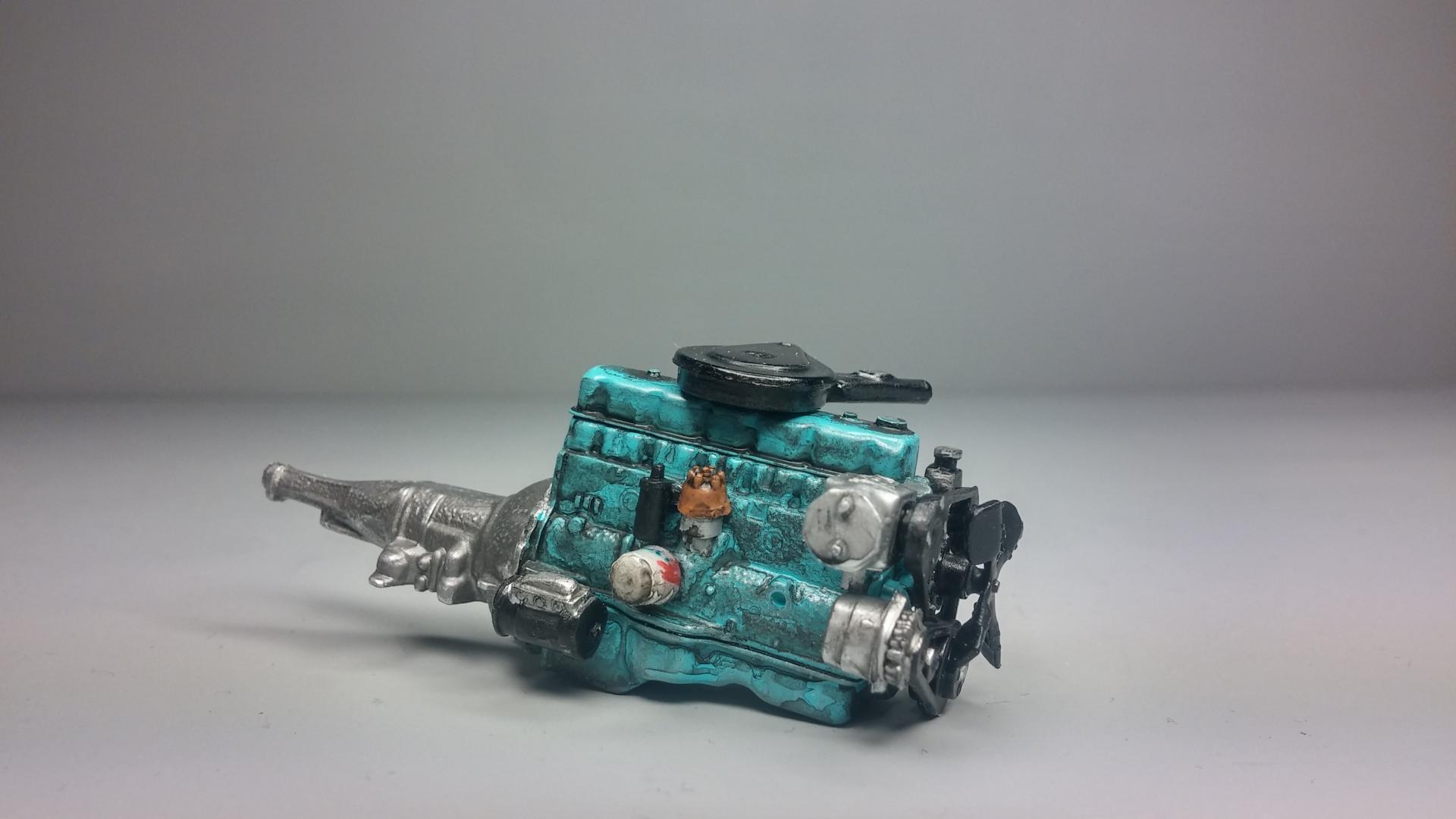

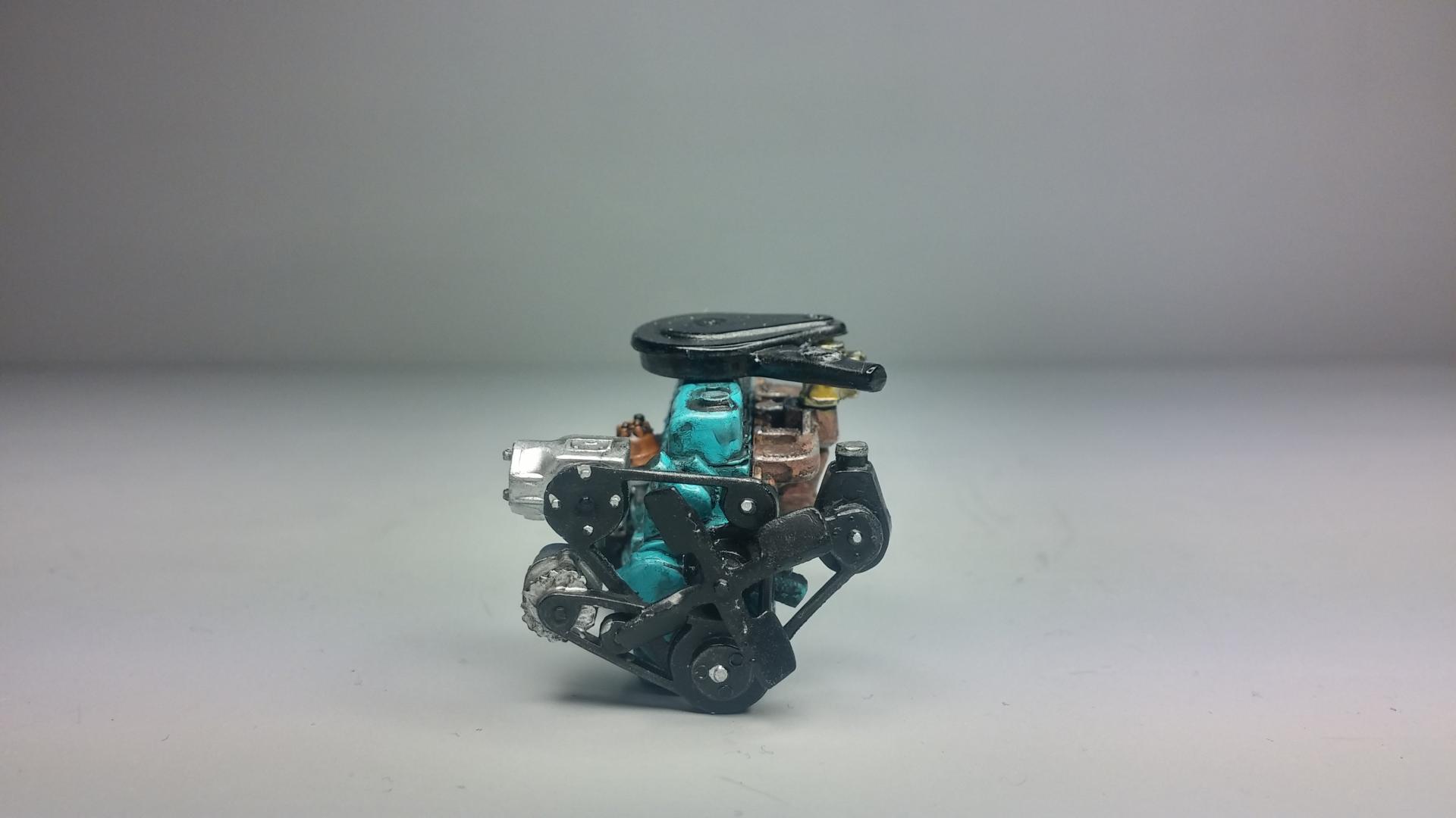

David G. Posted February 13, 2018 Author Share Posted February 13, 2018 Hello everybody! I had the time and energy to get a bit more done on the Pacer. I got the engine completed this weekend. I decided to use the stock 258 6 cylinder as is. K-Mart oil filter included! At home in the chassis. As always, thanks for taking the time to look and please feeel free to commen, David G. Quote Link to comment Share on other sites More sharing options...
vintagercr Posted February 13, 2018 Share Posted February 13, 2018 That's pretty cool Quote Link to comment Share on other sites More sharing options...
Harpo Posted February 13, 2018 Share Posted February 13, 2018 Looking good! What did you use to grime up the engine? Quote Link to comment Share on other sites More sharing options...
El Caballo Posted February 13, 2018 Share Posted February 13, 2018 That engine strongly resembles a 235 chevy. Quote Link to comment Share on other sites More sharing options...
David G. Posted February 14, 2018 Author Share Posted February 14, 2018 9 hours ago, Harpo said: Looking good! What did you use to grime up the engine? Thanks Harpo. I used Tamiya flat black (XF-1) acrylic thinned with Windex applied with a brush. David G. Quote Link to comment Share on other sites More sharing options...
David G. Posted February 14, 2018 Author Share Posted February 14, 2018 9 hours ago, El Caballo said: That engine strongly resembles a 235 chevy. Knowing how AMC borrowed from the "Big Three", it may be based on the same block. David G. Quote Link to comment Share on other sites More sharing options...

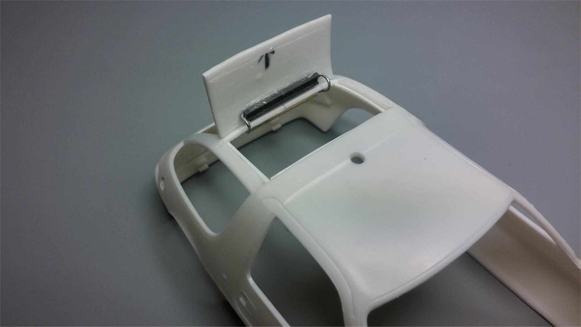

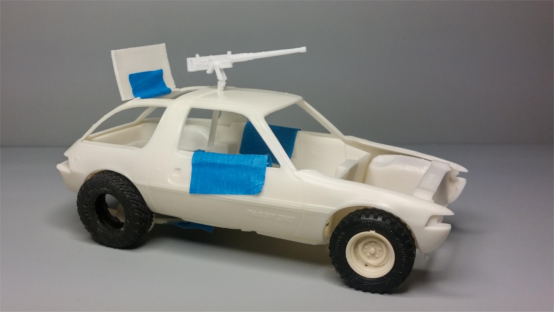

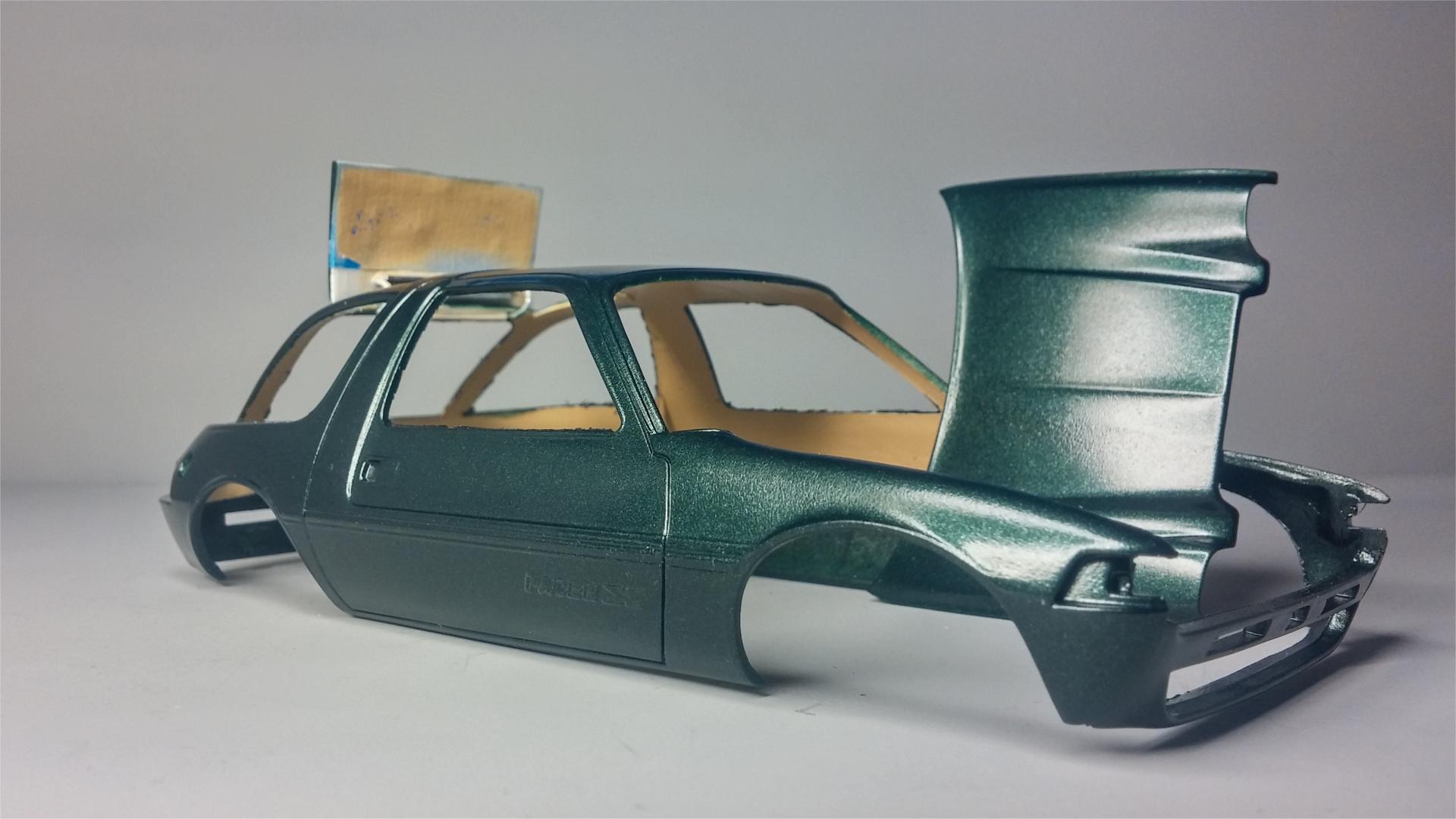

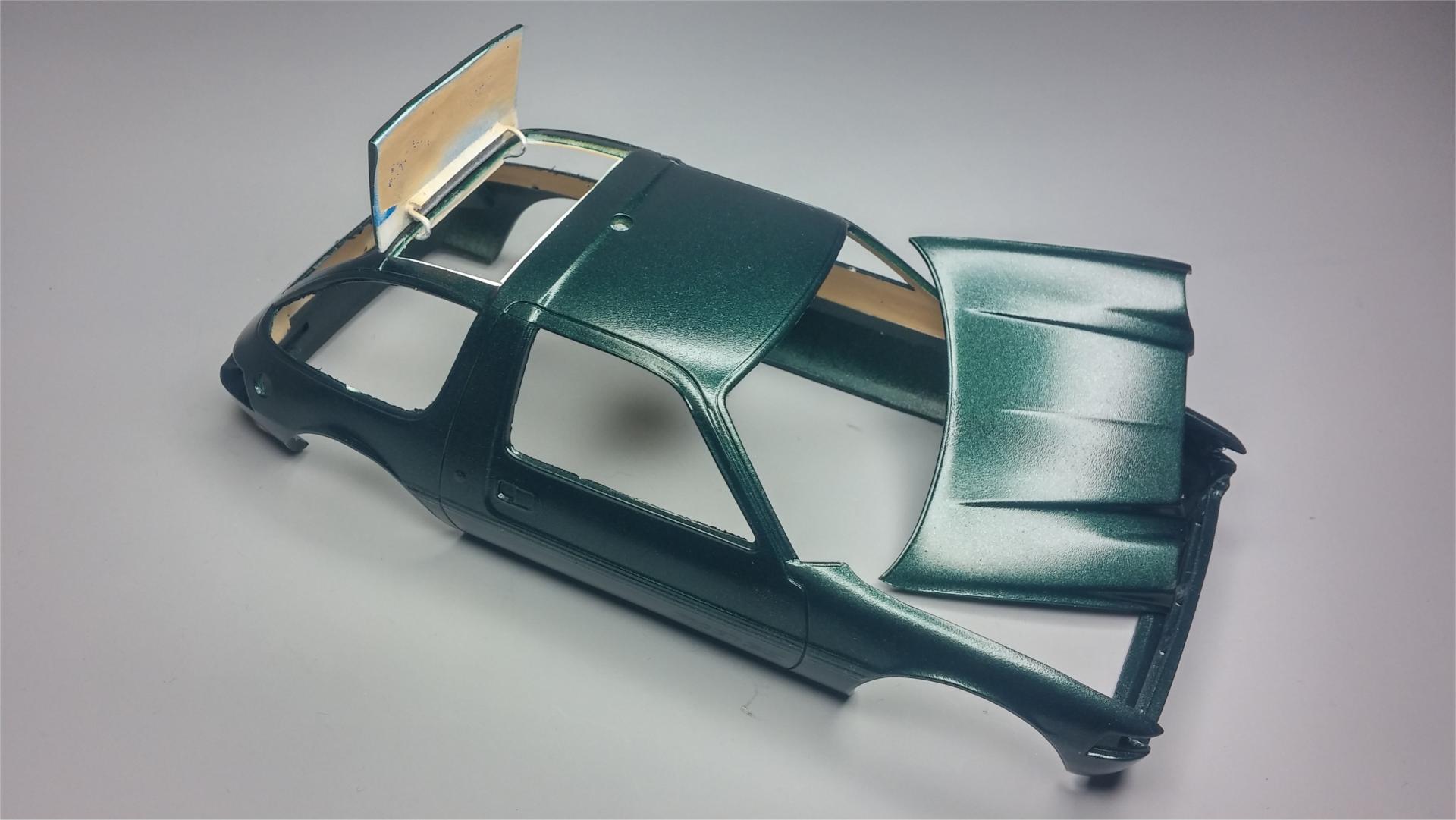

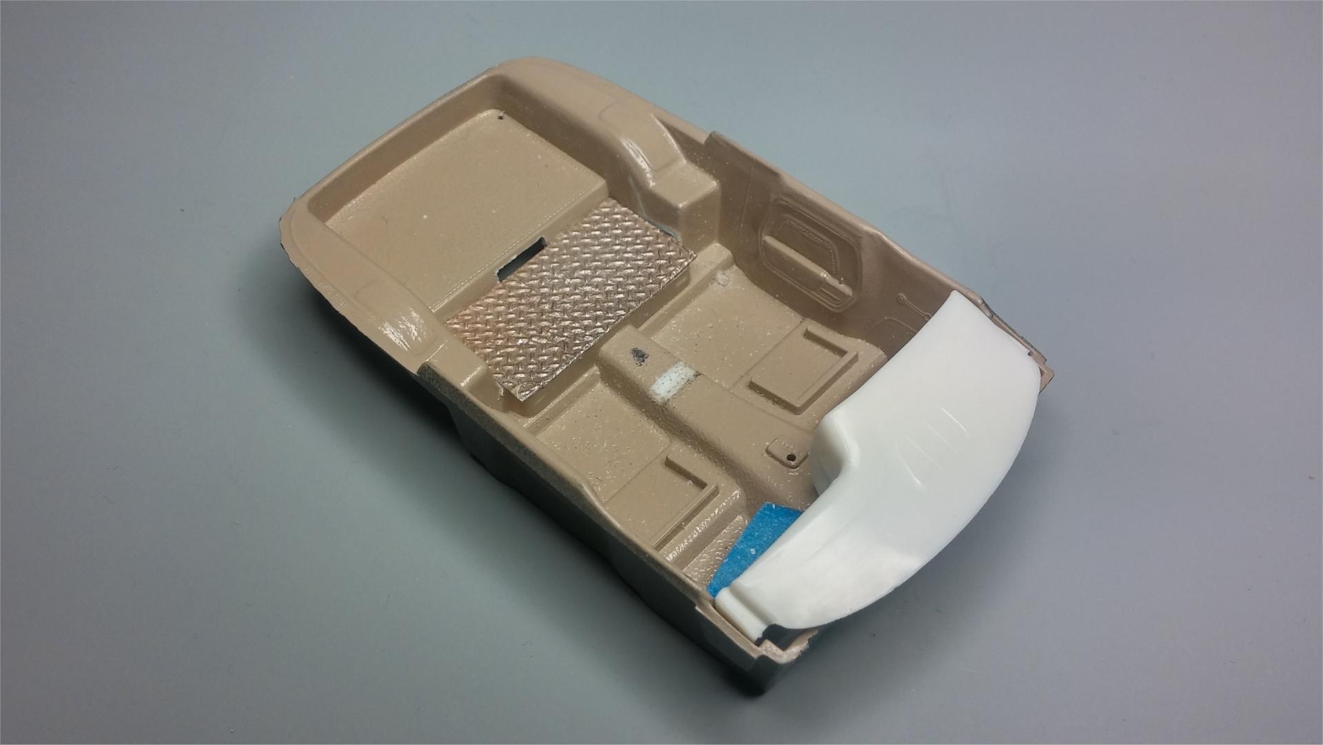

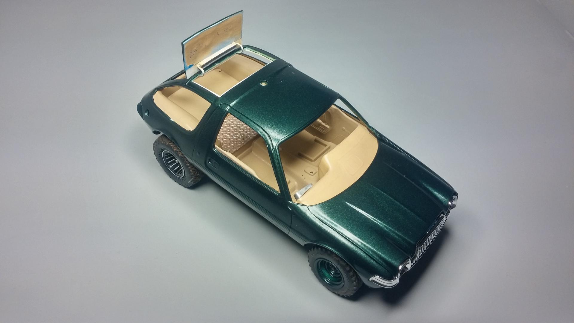

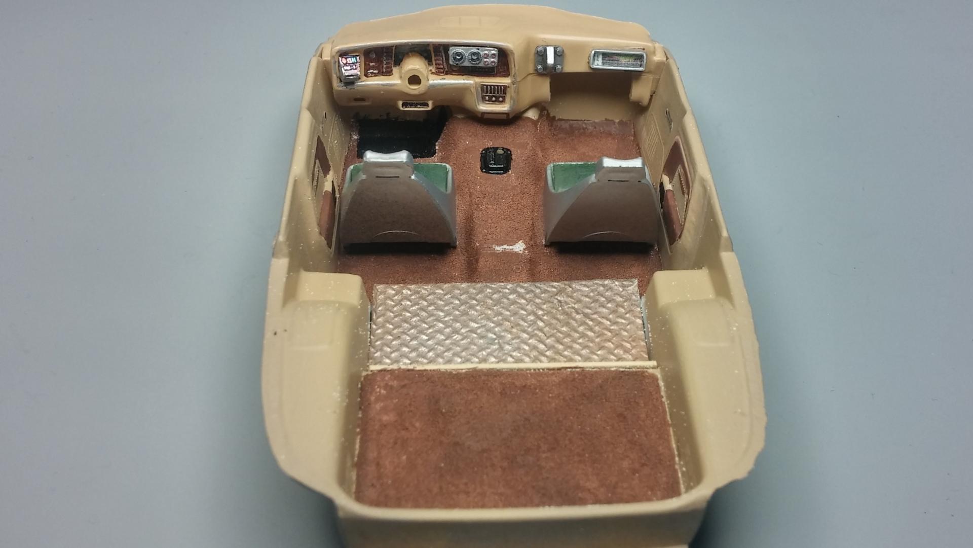

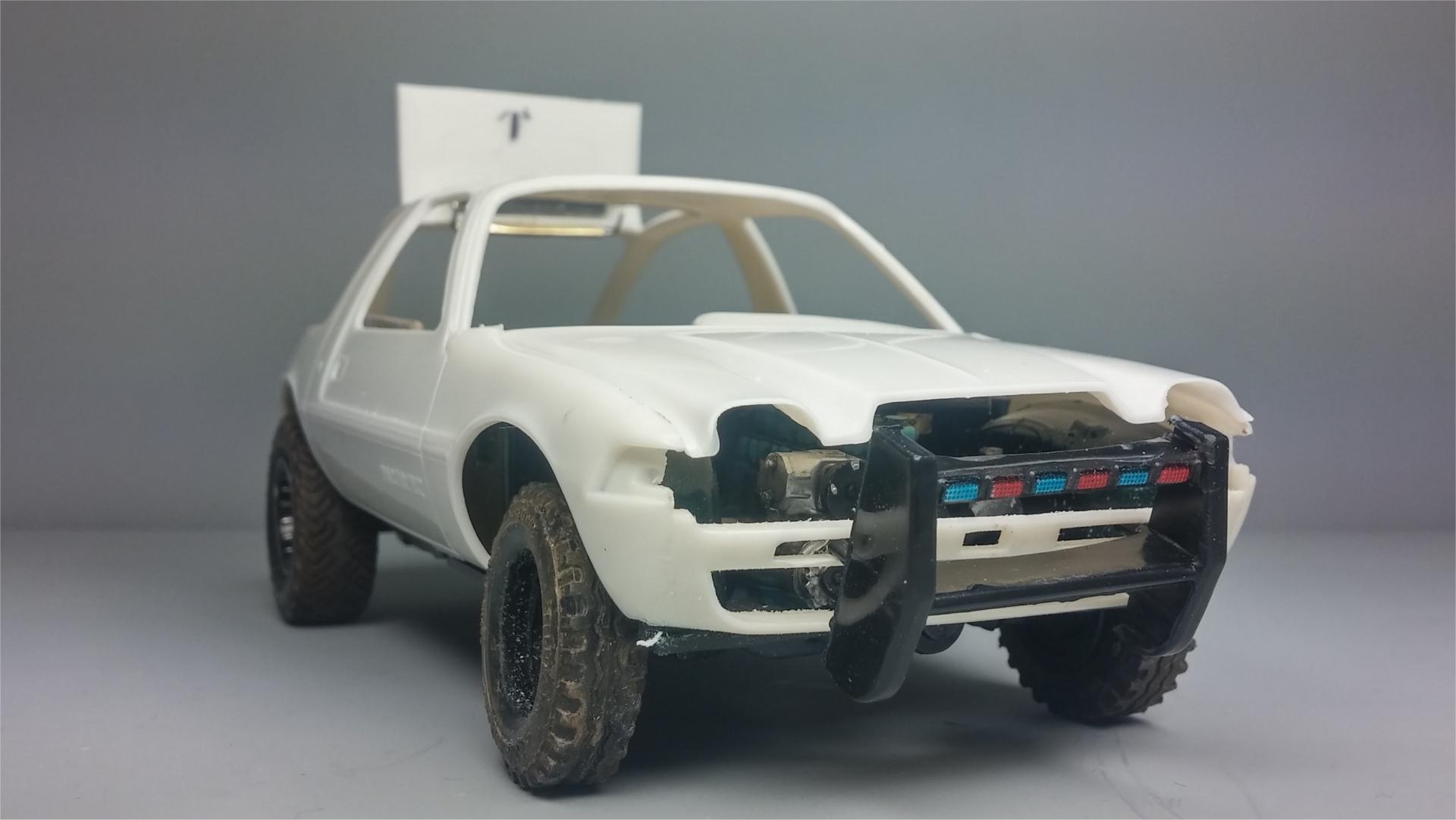

David G. Posted February 22, 2018 Author Share Posted February 22, 2018 Thank you all for the comments. I really do find inspiration in your feedback. I managed to fabricate a simple hinge for the pop-top. I removed the rear seat cushion and replaced it with a piece of diamond plate steel. I made the steel plate by using a piece of aluminium foil to take an impression from a parts box trailer deck. I then glued the foil to a thin piece of styrene and painted it to look a little rusty. I got the front valance glued into place. I've decided to omit the stock bumper and use a push bar from the parts box. As always, thanks for looking and please feel free to comment. David G. Quote Link to comment Share on other sites More sharing options...

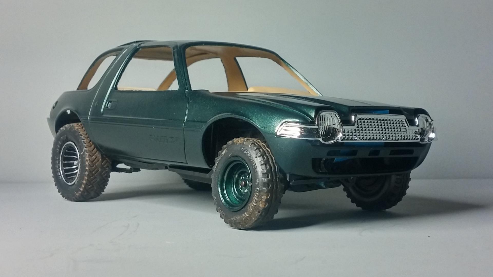

David G. Posted March 1, 2018 Author Share Posted March 1, 2018 I got some paint sprayed last weekend. Yeah, I know that it's the same color as the box art. What can I say, those artists pick good colors. The Duplicolor paint was a little too hot and crazed a little bit. I should be able to smooth it down and spray another coat then polish it... hopefully. Thanks again! David G. Quote Link to comment Share on other sites More sharing options...

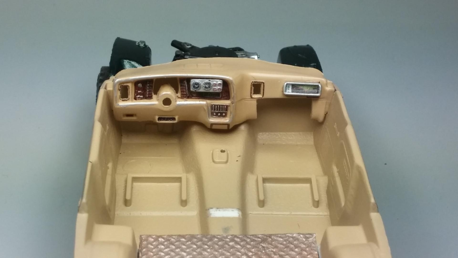

David G. Posted March 5, 2018 Author Share Posted March 5, 2018 (edited) Hello everybody! When I started building this kit I had planned to build it as a beat-up post-apocalyptic vehicle pieced together using salvage and remnants, a la "Road Warrior". When I saw how the paint looked on the body, I liked it so much that I decided to change my plans. I switched from the "Road Warrior" universe to the "Car Wars" universe. Car Wars is a board game from the 80's set in the 2030's in which manslaughter has been decriminalized and auto manufacturers offer accessories like machine guns and smoke screens. So that moves us from a grungy lo-tech motif to a slicker high-tech look. I've started updating the dashboard with techie-looking gizmos. For those who may be interested, here is a little Car Wars background from Wikipedia and a video from the Steve Jackson Games. As always, thanks for looking and please feel free to comment. David G. Edited March 5, 2018 by David G. typo Quote Link to comment Share on other sites More sharing options...

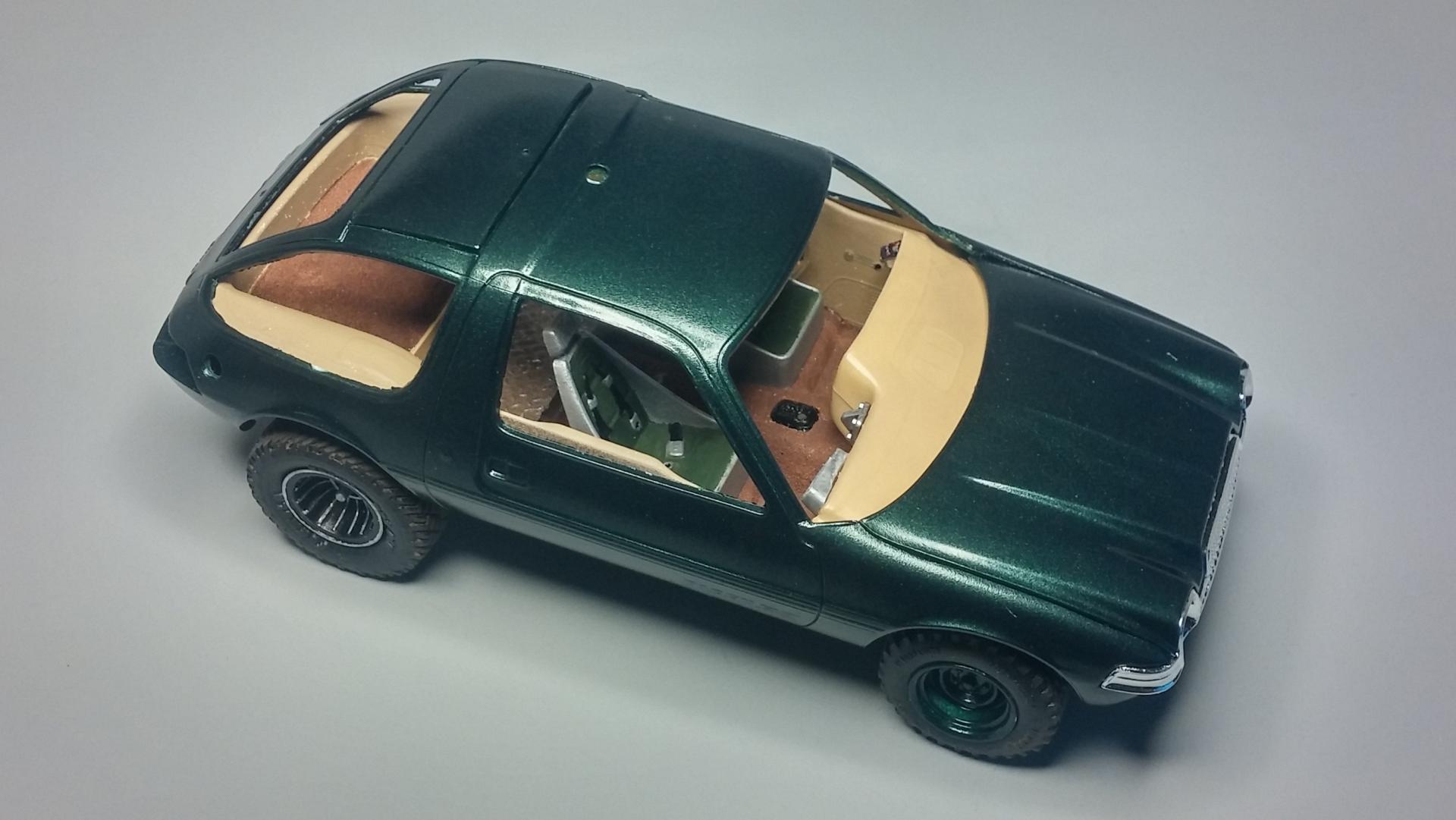

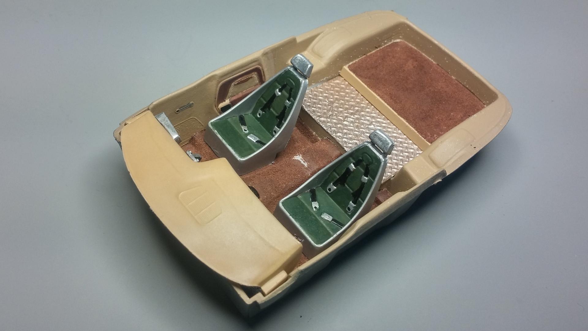

David G. Posted March 11, 2018 Author Share Posted March 11, 2018 Thanks Ron. Here's a little more for those who may be interested. I decided on color-keyed custom racing seats for the interior. The dash detail is mostly finished. I'm currently searching for a twin grip aircraft-style steering wheel. I also got some "carpet" laid down. As always, thanks for taking the time to look and please feel free to comment. David G. Quote Link to comment Share on other sites More sharing options...

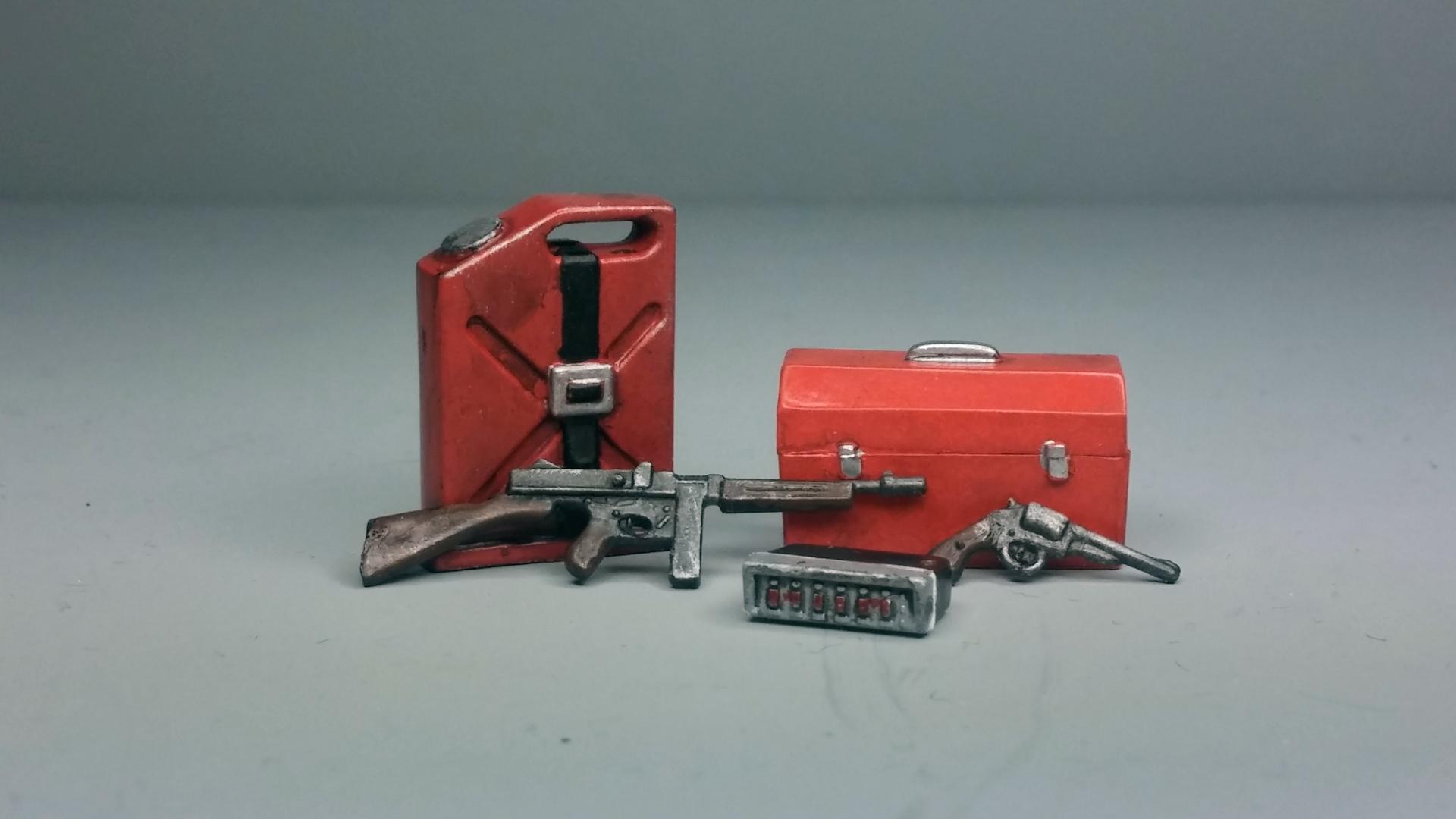

David G. Posted April 2, 2018 Author Share Posted April 2, 2018 I did some work on a few cargo area accessories. They still need some highlighting to punch up the details a little, but it's a good start. I know it's not much of an update, but thanks for taking the time to look. And as always, please feel free to comment. David G. Quote Link to comment Share on other sites More sharing options...
