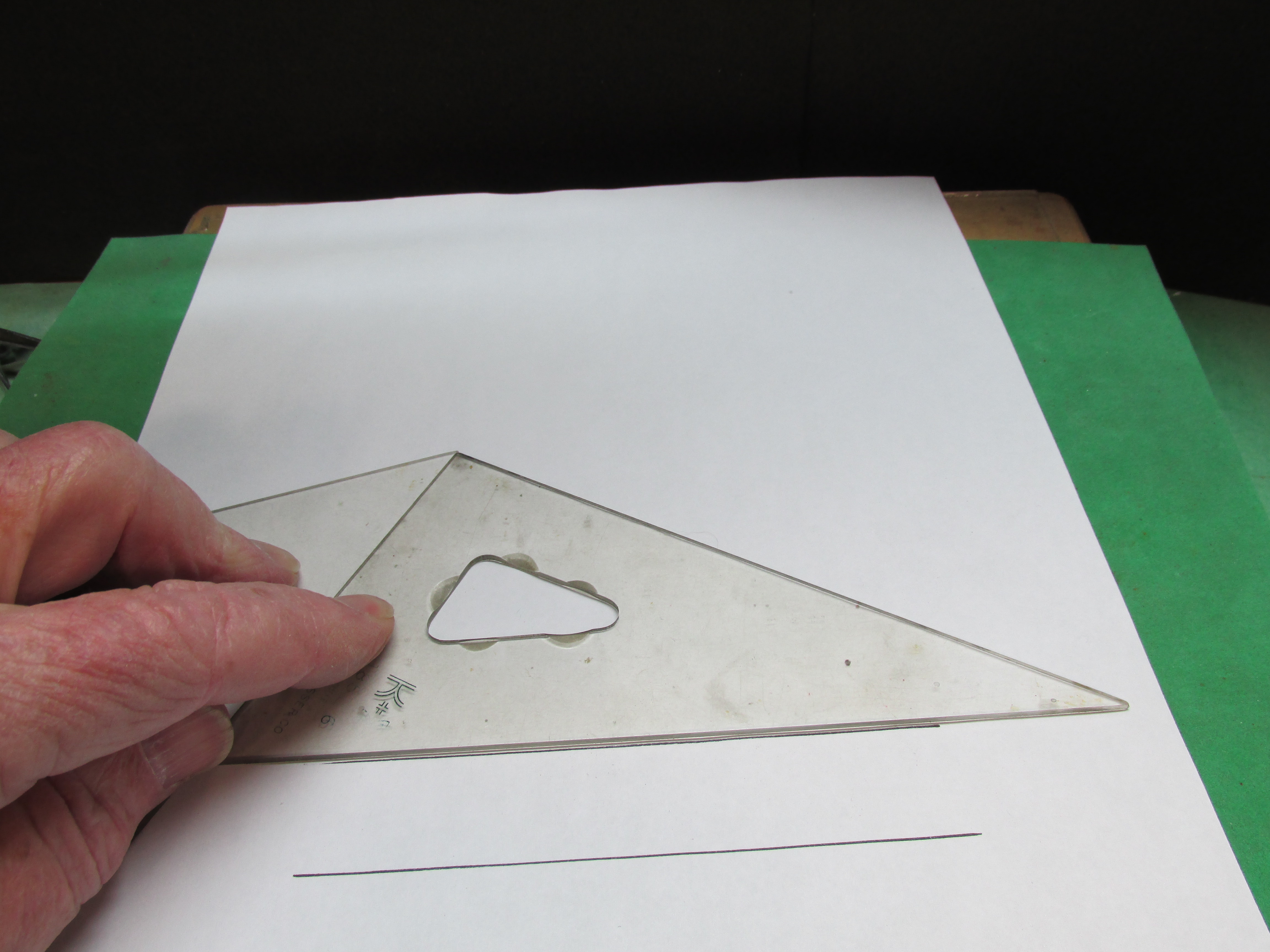

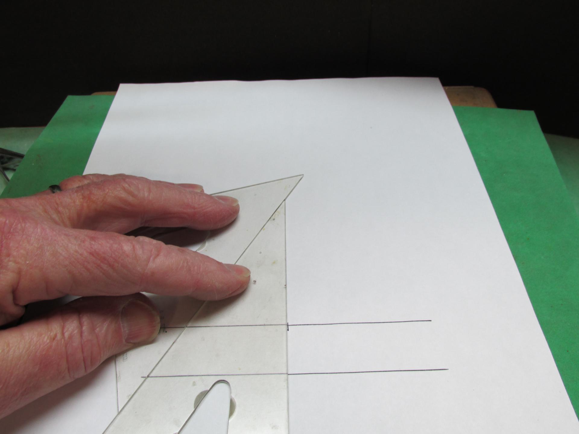

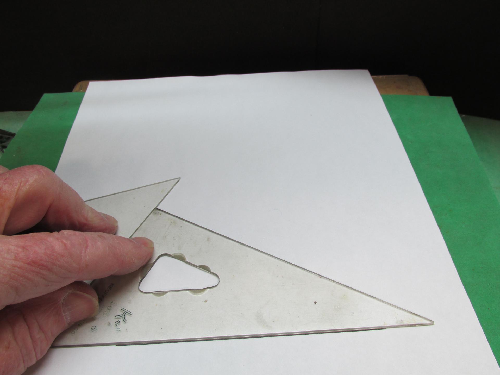

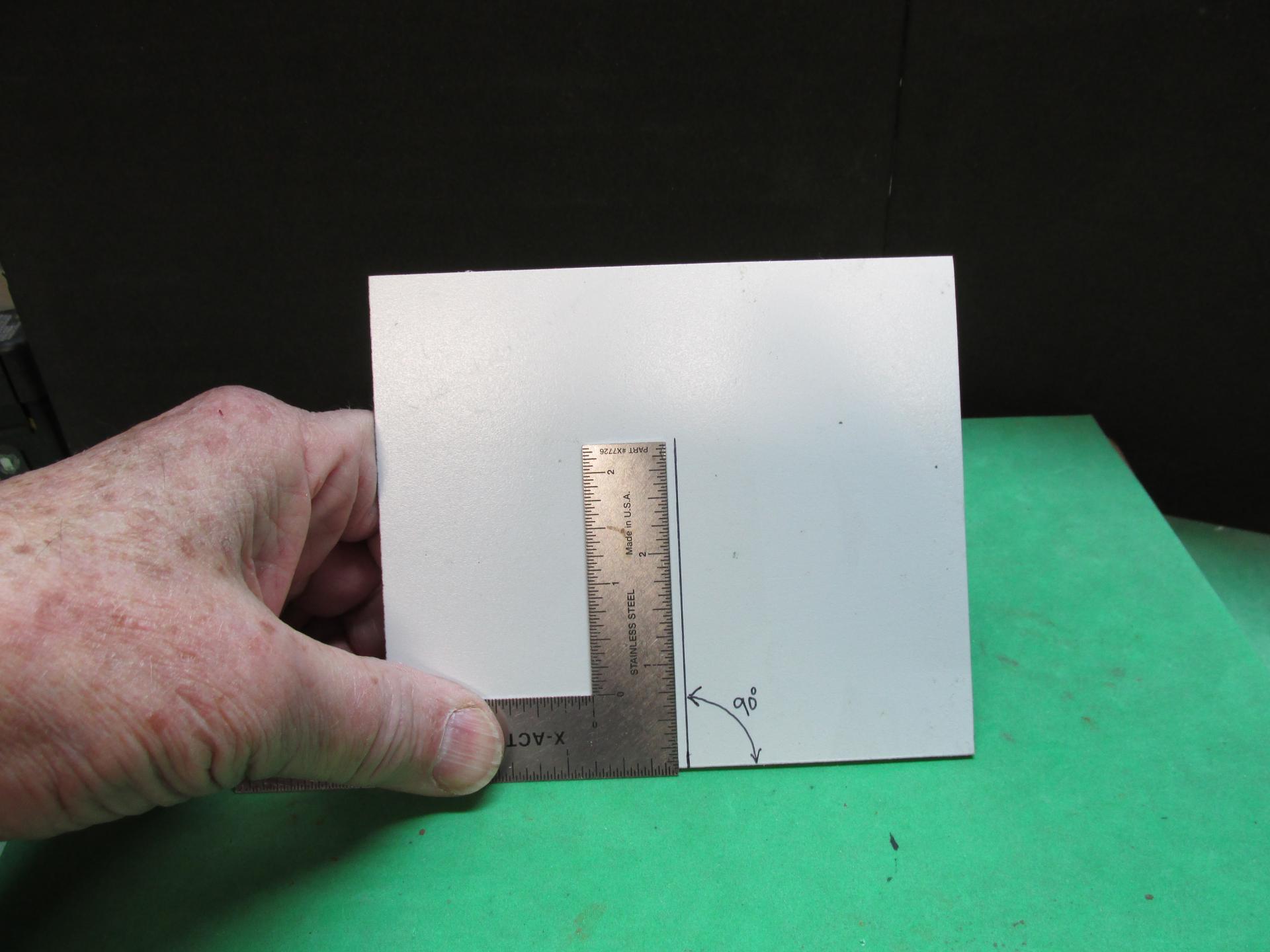

Get your measurements of the length x width of the body floor.  Square that up.  Do you know how to use a couple of drafting triangles to get good right angles?  Same technique for the back and sides.
Photo 1 shows how to get right angles using a simple square.005.thumb.JPG.707ced60d9e2e69f6c54f8180a7d74c5.JPG
Photo 2 and 3 shows how to get parallel lines.  First you place the bottom triangle on the line you have just drawn.  Hold firm and place the second triangle up against it on an adjacent side.
Next you hold the left triangle firm and slide the first triangle along it until you get to the point where you want to draw the parallel line.
Want to make a line perpendicular to the two parallel lines?  Choose a point like in the next photo and place the edge of the right hand triangle up against the line with the point on it.  Now hold the left triangle firm and slice the right hand triangle down until the right edge is at the point in the next photo.
Draw a line against the far right edge of the right hand triangle and it will be at 90 degrees to the two parallel lines.  NOTE:  The two edges of the triangle you are using are at right angles to each other so that is why it works.
Use this technique to make the bottom, sides and back of the body.  All you have to do is choose your dimensions.  If you are working in 1/25 scale get a metric ruler that measures in millimeters.  If you measure the real body in real inches there is no conversion necessary.  For example a body length of 108" would be 4.32" in 1/25 scale.  Since there are 25.4 mm in one inch there is an insignificant difference so that 108" would be 4.25".  The difference is only 0.07"!  Can't hardly mark that with a pencil!  So just mark off 108 mm and there you have it!B)
