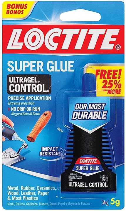

On 2/11/2018 at 12:08 AM, Ace-Garageguy said:
This product seems to be pretty much immune to the problem...
Image result for loctite toughened gel
Having used CA glues in model building since the 1980's (Goldberg Jet) i've found that the thicker consistency CA's do not set up nearly as rapidly as the original formulae, very thin consistency will.  Having said that, I use needle tip extensions (Bob Smith Models) which have a full inch or so of approximately 1/64" inside diameter tubing that is at least an inch long.  When sitting for any length of time, a 32nd inch or so hardened plug will form at the end of that tube--to clear it, I simply slice that portion which is plugged, off with my Xacto knife.  These tips come a dozen to the pkg,  very inexpensive, when I see them in a hobby shop, I buy 4-6 pkgs (12 to the package) just so I never run out.   Been using them since the 1980's.
