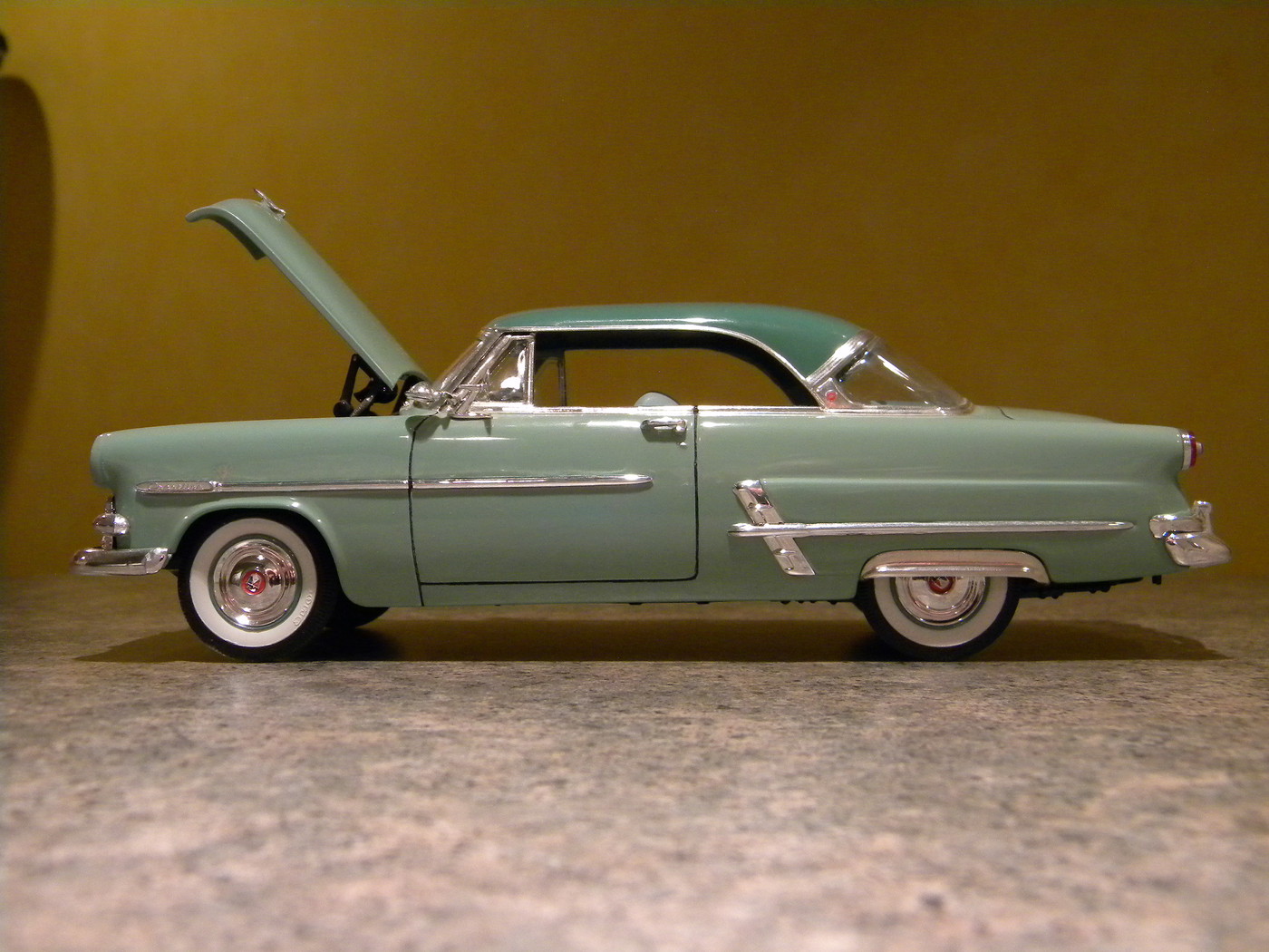

StevenGuthmiller Posted February 15, 2018 Share Posted February 15, 2018 47 minutes ago, phish said: Perhaps I'll just start with the testor enamels and do the 1:1 with cheap thinner as donn yost recommends. There just doesn't seem to be a great "one topic says it all" post on paint including price, results and technique. If you're going to try enamels, my personal recommendation would be to use flat Testors enamels. I used to do it this way with pretty fair results. You can mix your own colors & thin it with lacquer thinner for faster curing times & then use one of the Testors Lacquer clear coats to make it shine. Flat paints will lay down much nicer & dry faster giving you less chance of orange peel, runs & sags. It works pretty well to do it this way. After the clear is applied, let it cure for a few days & then polish & you can achieve a pretty nice paint job with little fuss. This 1953 Ford was painted using this technique. Steve Quote Link to comment Share on other sites More sharing options...

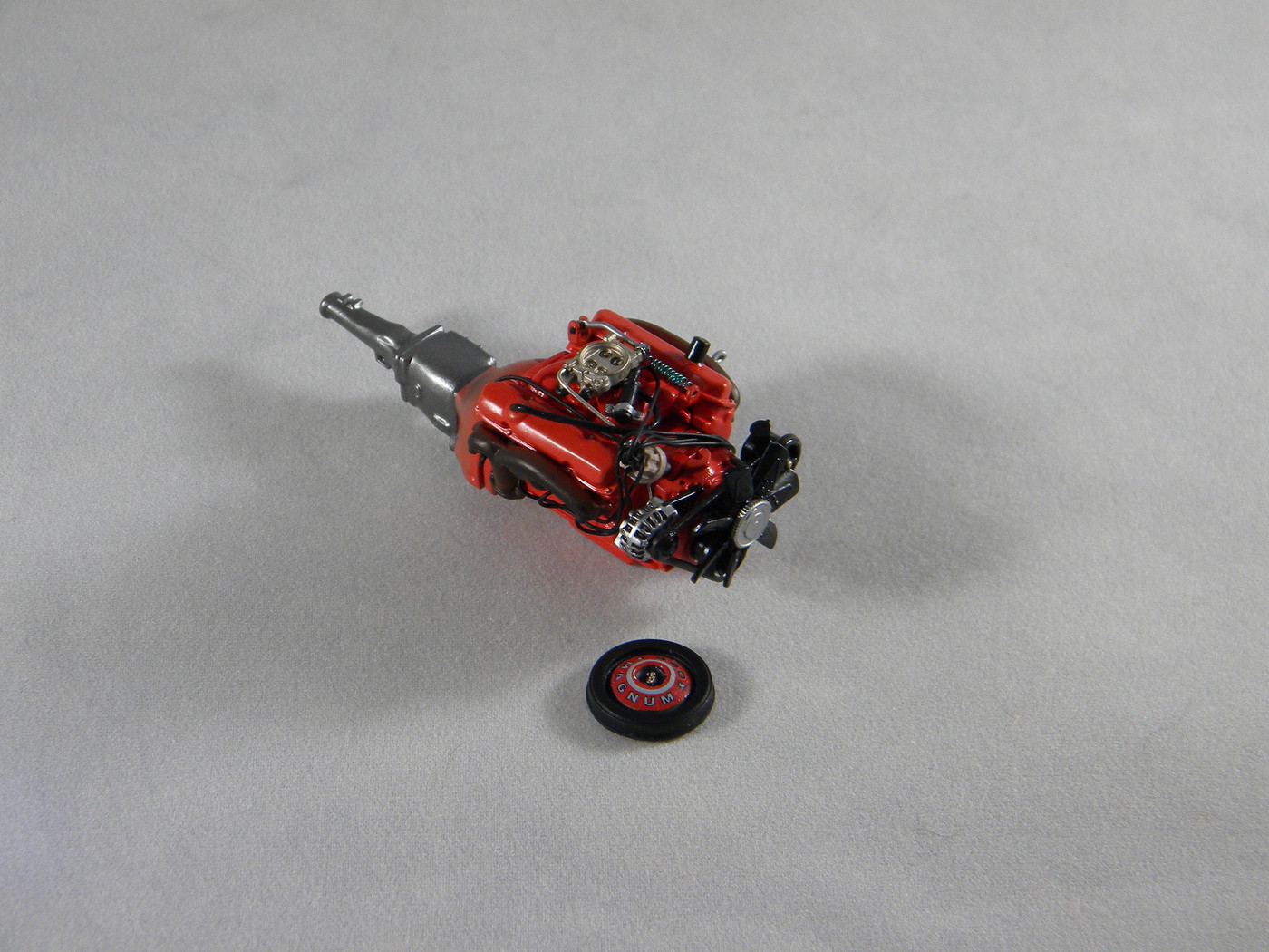

StevenGuthmiller Posted February 15, 2018 Share Posted February 15, 2018 1 hour ago, phish said: Would this technique (using flats+clear) also work well for smaller peices such as engine/ suspension? Absolutely! As a matter of fact, I still do most of my engine & chassis parts this way, occasionally mixing in a few lacquers. This 440 was painted with a custom mix of flat Testors paints & clear coated with Testors lacquer. The black parts were done the same way except I used Duplicolor black primer as a base color. The metal parts were all shot with various colors from Alclad. Steve Quote Link to comment Share on other sites More sharing options...
