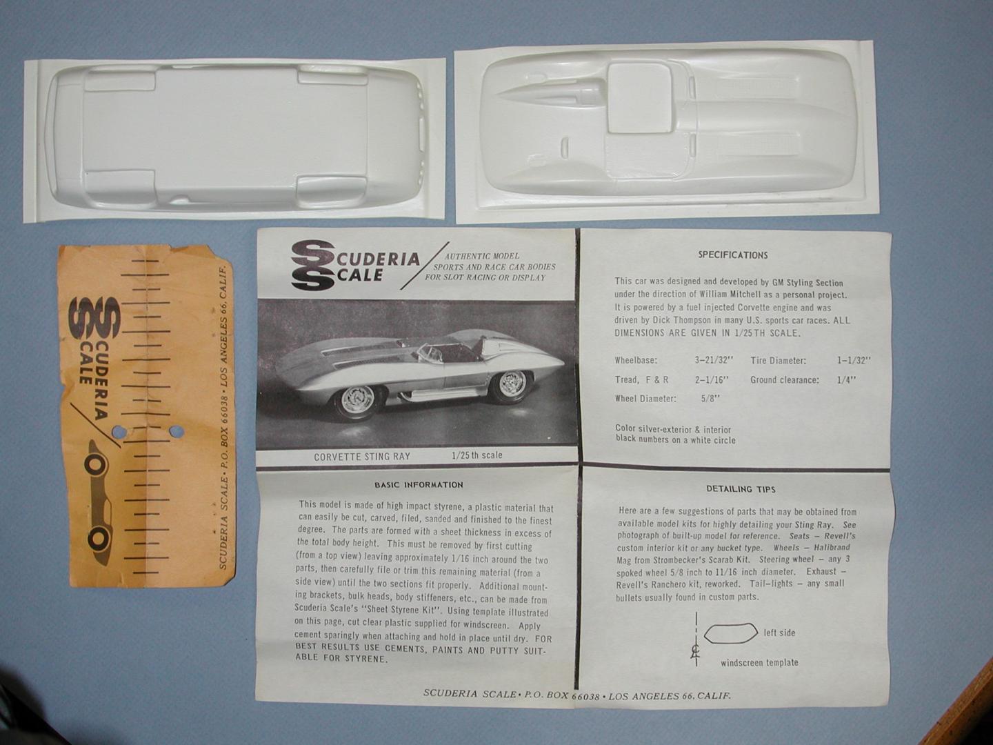

Gramps46 Posted February 19, 2018 Author Share Posted February 19, 2018 Thank you all for your comments, I appreciate them. The body started life as a vacuum formed 1/25th scale slot car body by Scuderia Scale. Then Bill Landis and Dave Spazaro (SPL?) made solid resin castings. I took one of their castings and re-profiled the fenders and a few other pieces. When AMT reissued the El Camino I knew I had to the set. Quote Link to comment Share on other sites More sharing options...

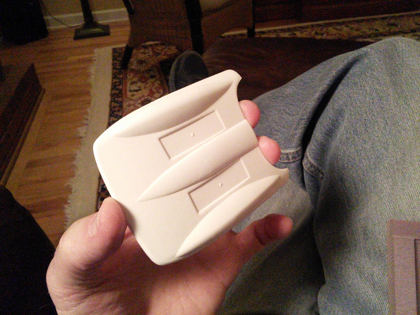

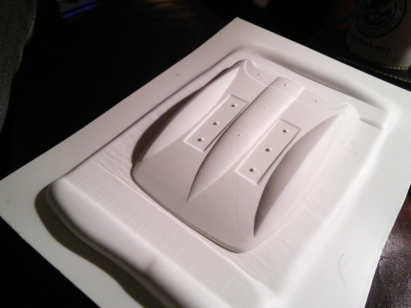

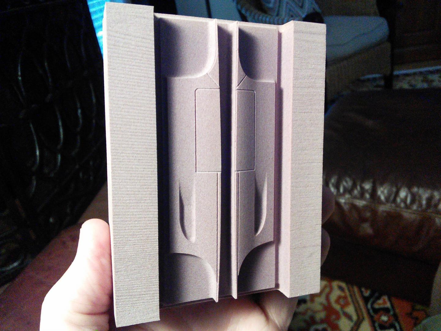

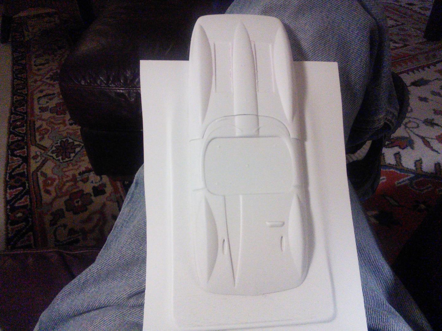

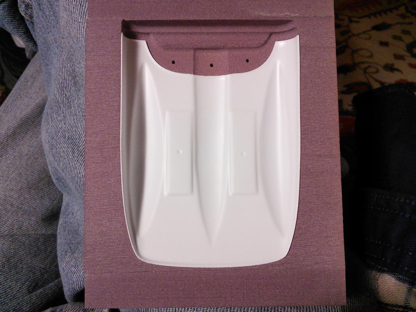

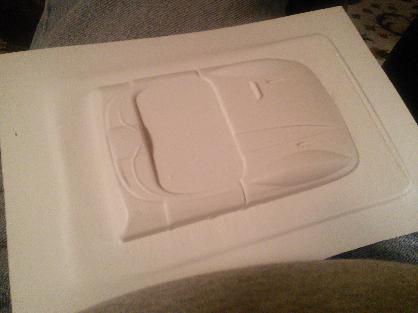

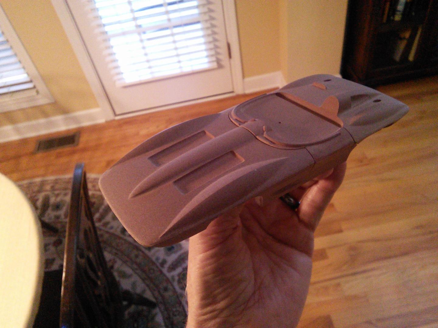

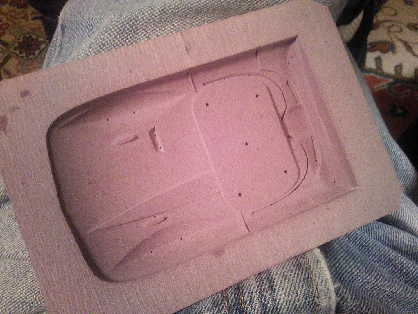

Bilingham Posted February 20, 2018 Share Posted February 20, 2018 I'm currently scratch building the XP-87 in 1/24 scale. Take a look: The brown model and the cavity molds are CNC machined from Renshape. The white pieces are vac formed body panels. This project is about one year old. Quote Link to comment Share on other sites More sharing options...
Dave Darby Posted February 20, 2018 Share Posted February 20, 2018 23 minutes ago, Bilingham said: I'm currently scratch building the XP-87 in 1/24 scale. Take a look: The brown model and the cavity molds are CNC machined from Renshape. The white pieces are vac formed body panels. This project is about one year old. Well now you just separated the men from the boys! Nice! Quote Link to comment Share on other sites More sharing options...

Ace-Garageguy Posted February 22, 2018 Share Posted February 22, 2018 Beautiful finished models, Gary, and fine looking work on those RenShape masters too, Bill. Quote Link to comment Share on other sites More sharing options...
