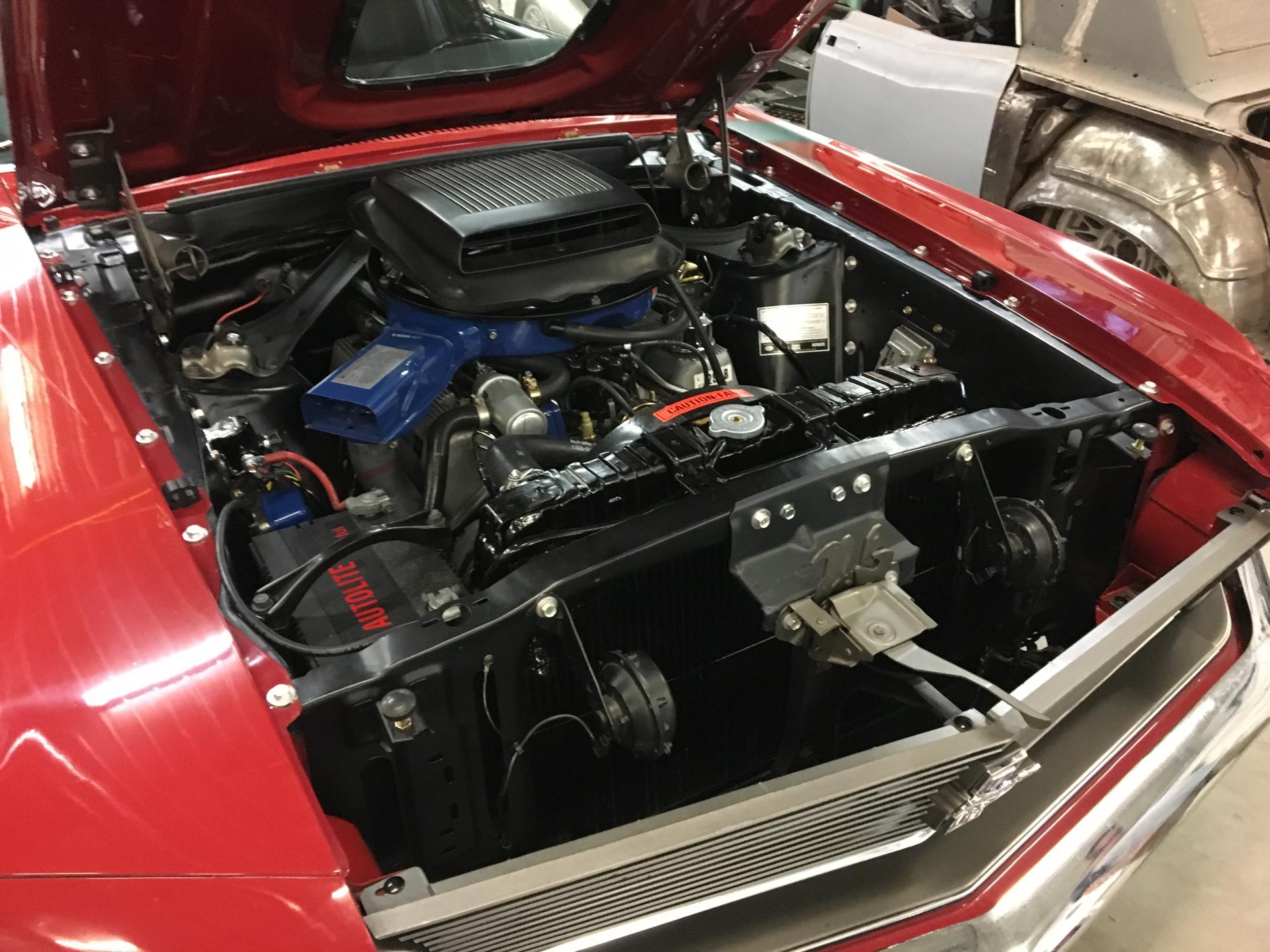

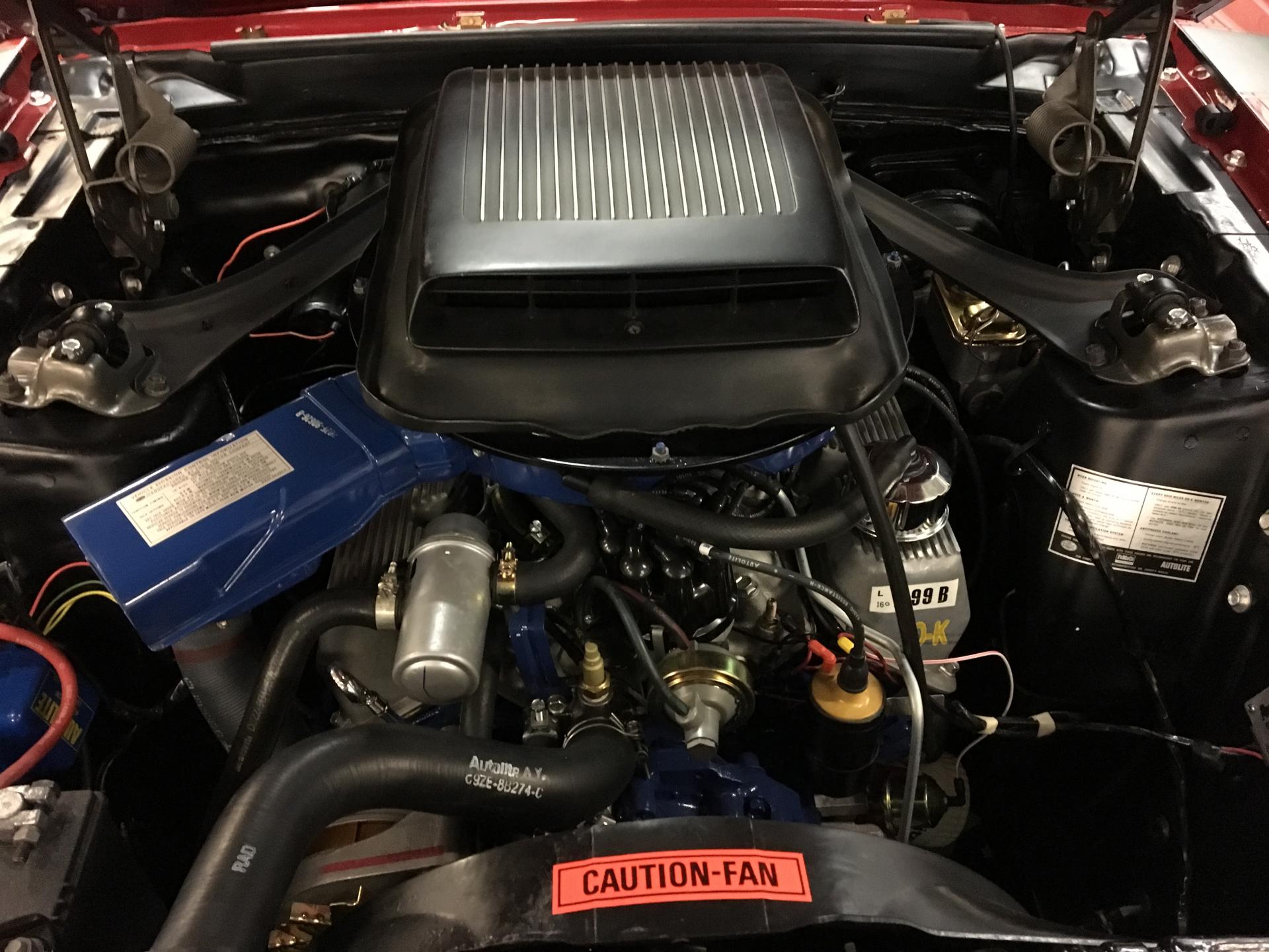

Here’s a couple pics of a 1:1 1970 Boss 302 that we just finished up putting together. It shows various finishes. Gloss, satin, flat and metallic.
Dennis
