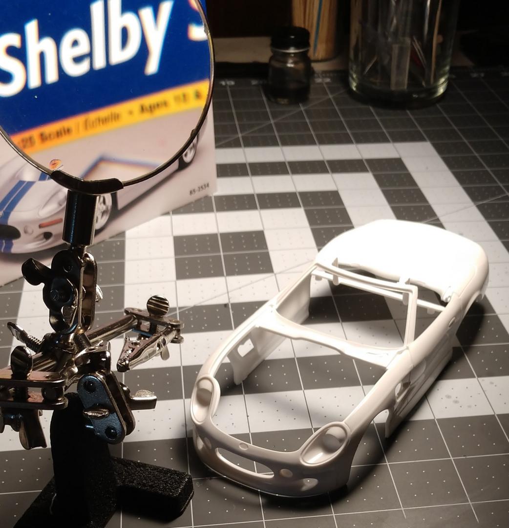

Here we go. I think that I will attempt to cut the doors and do some carpet on this one. I am open to any suggestions on flocking or embossing powder. What are your thoughts

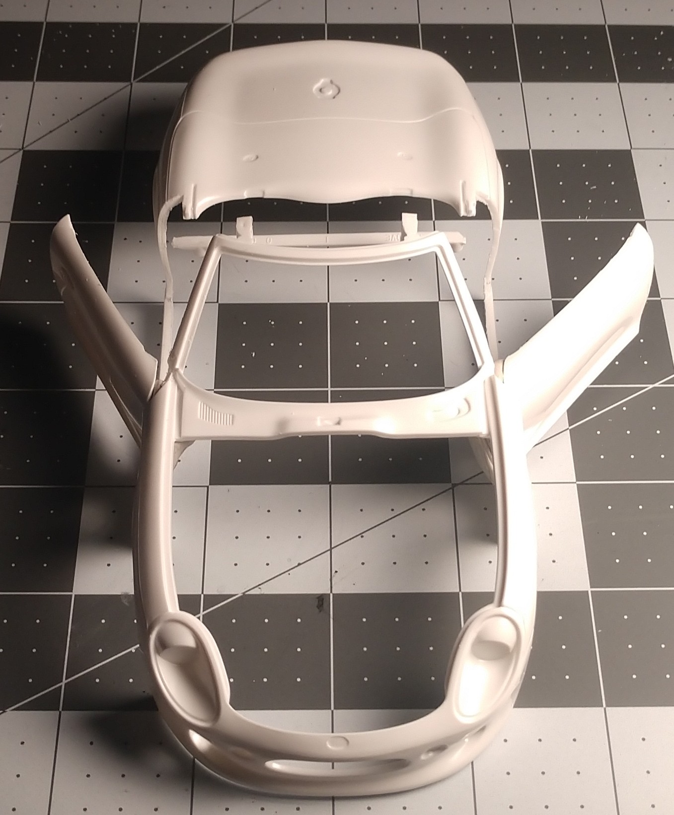

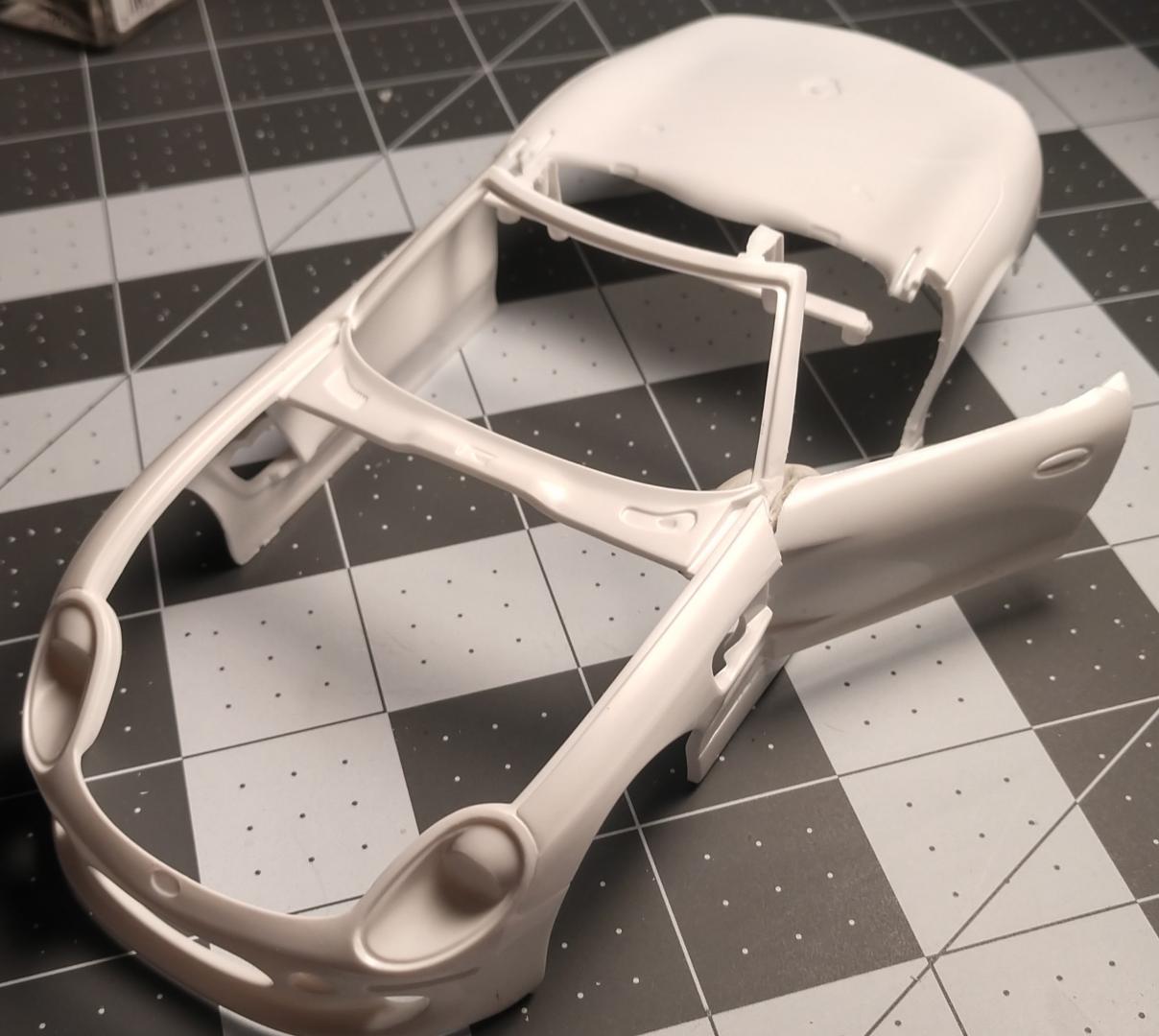

I hope I can give you some insight and inspiration. So far the doors are proving to be difficult to cut out but definitely doable

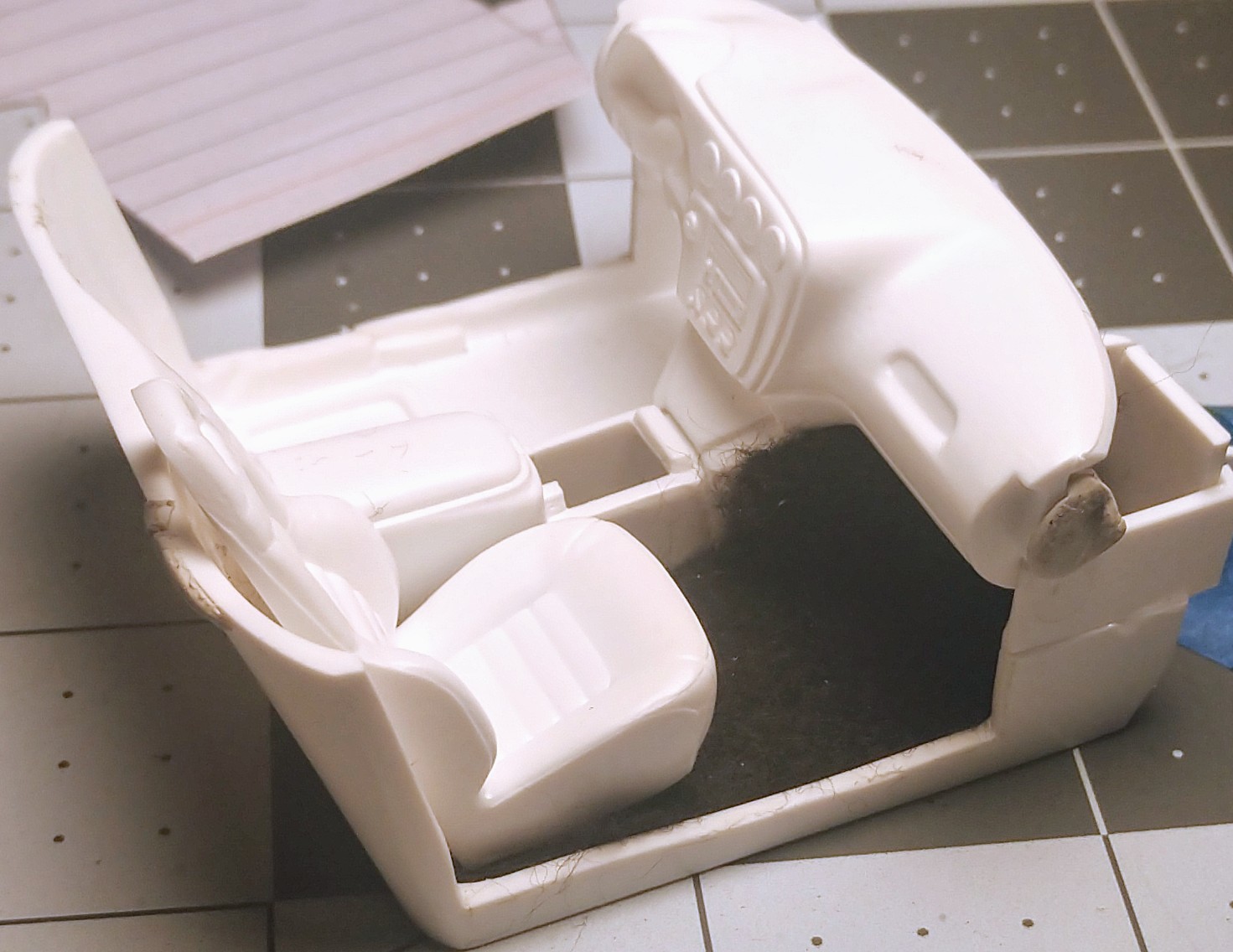

Trying out some 1mm think felt for the carpet. It's just a dry fit but doesn't look bad. I might go back and get the right color. I think they all came with a grey carpet.

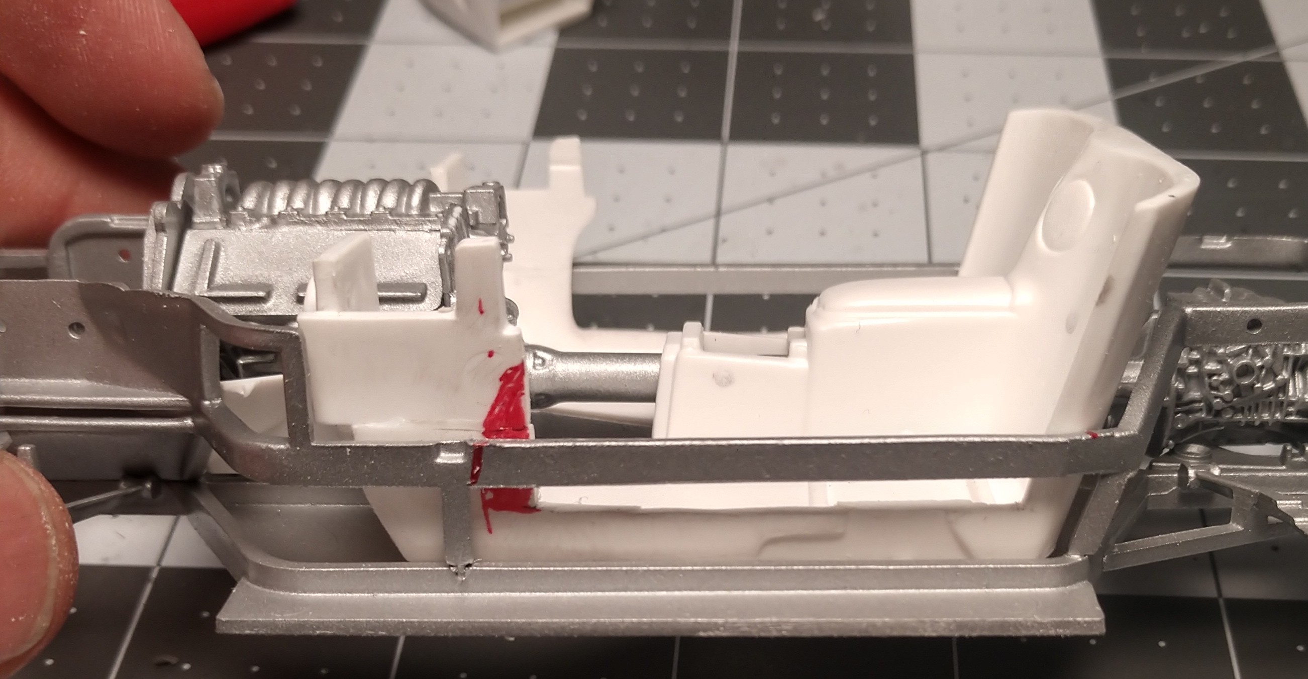

I will say the two issues with the kit are glueing on the rear bumper, and getting the hood to sit properly. Otherwise it builds up nicely!

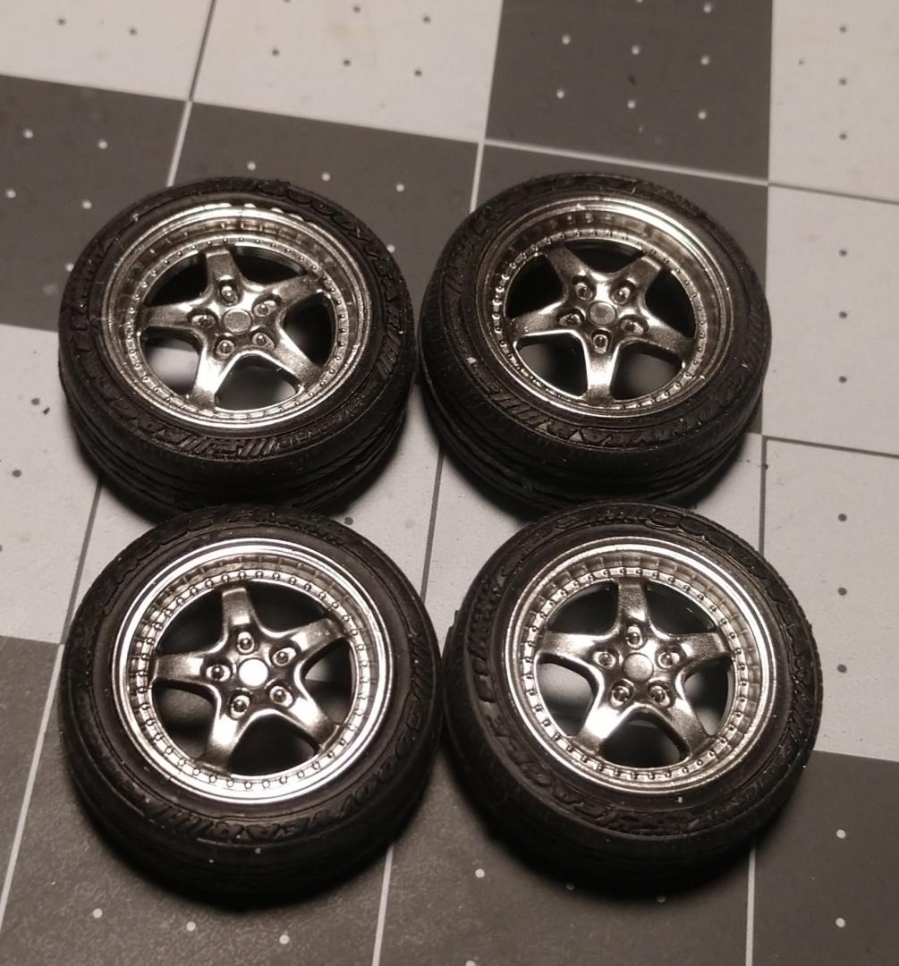

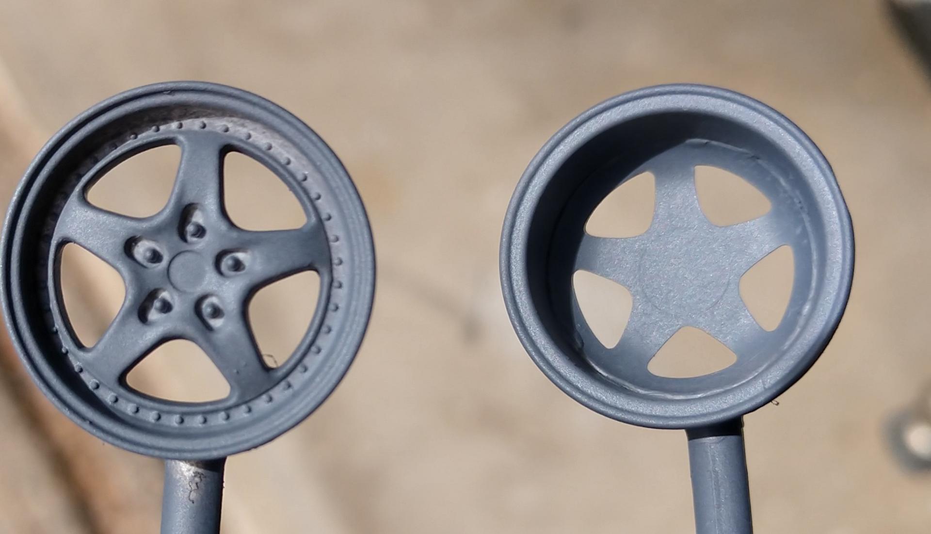

I was not happy with the wheels in this kit and the way they go together. I decided to cut the inner spokes and hub then re glue it to make a more realistic wheel.

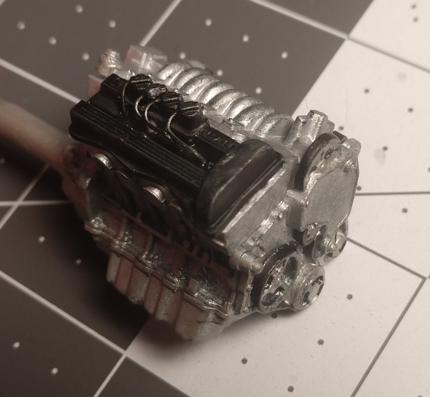

Look at the cute little plug wires! That was a tight fit.

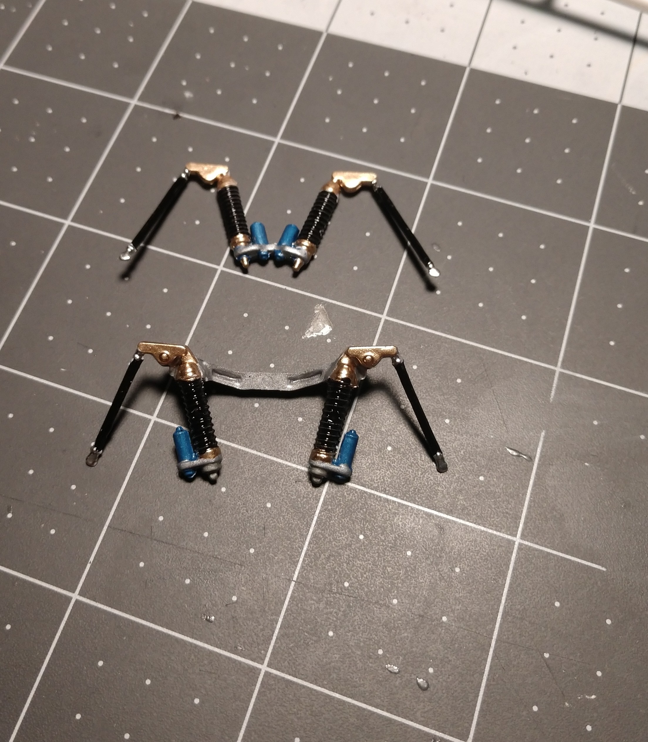

Got the suspension parts painted. Lots of work on something that can't be seen. That's what we do 😋

Making some progress. This May be the last time I cut doors. Every time I test fit something I have to modify something else.

Why does the Aurora/Northstar engine in this kit only have plug coils on one bank of cylinders?  After a quick search, answered my own question.  Each coil should have two plug wires, as seen in this photo.  The handwritten numbers identify the cylinder.  No distributor, just sensors and an ignition control module.
Edited by GerN
Share this post
Link to post
I figured out the same thing after I looked at some more pictures. I'm not sure why they didn't just use individual coil packs. My 98 Camry v6 had them. This is a 99 model.
