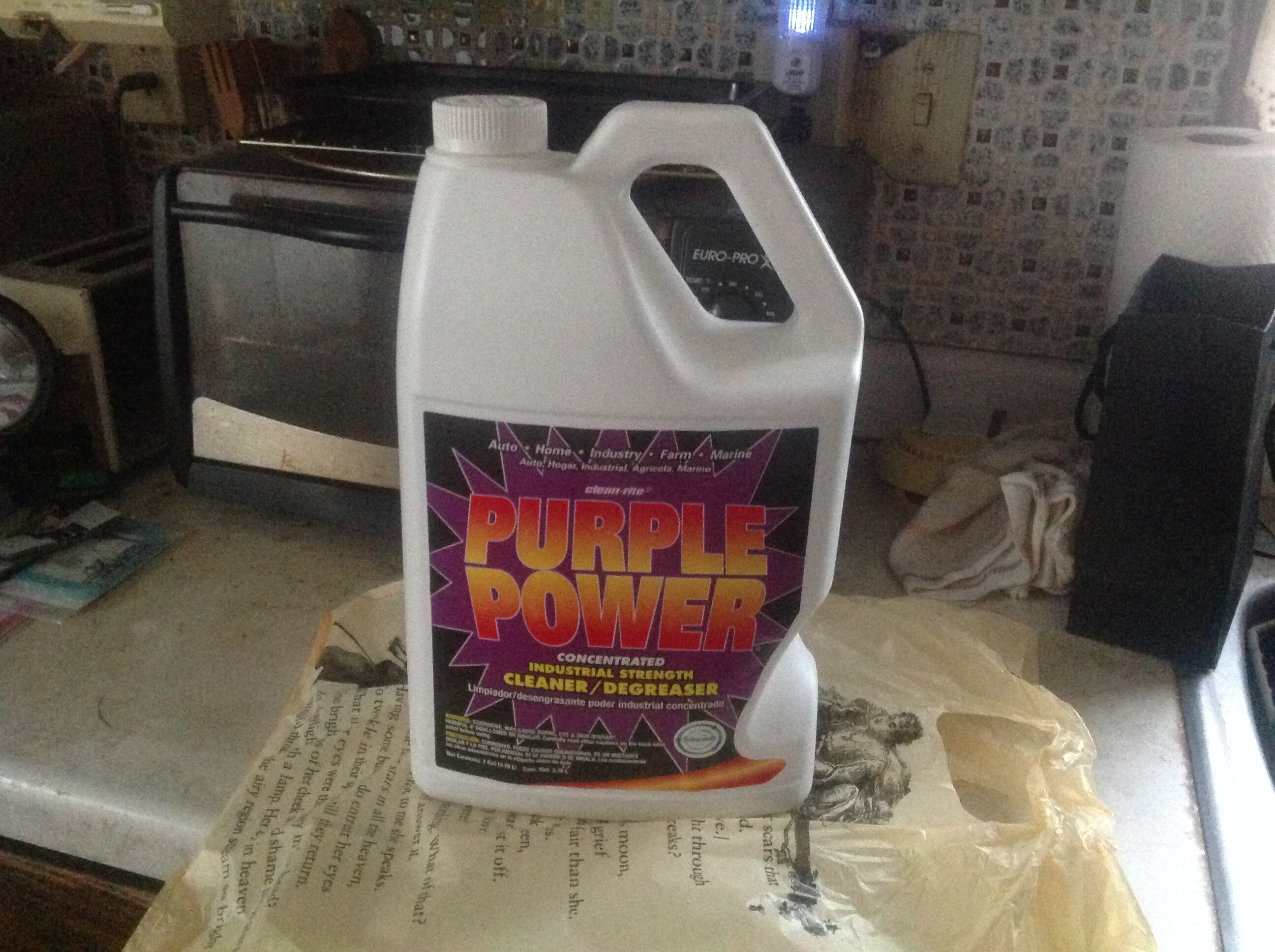

I don't know if you can get it in the UK. But this stuff works pretty good.

Super Clean also works well & available at Walmart and auto parts stores here. I'm guessing its similar to the Purple Power suggested by Scott. Its purple too. It used to be known as Castrol Super Clean, but the Castrol name is no longer on the bottle (last time I looked).

Ok, the stuff Scott posted is the knock off brand,  Super Clean is what use be called Castrol Super Clean , Super Clean is a lot stronger than the Purple Power stuff, the Purple Stuff does work, Super Clean works better, its worth the extra couple of dollars more.
