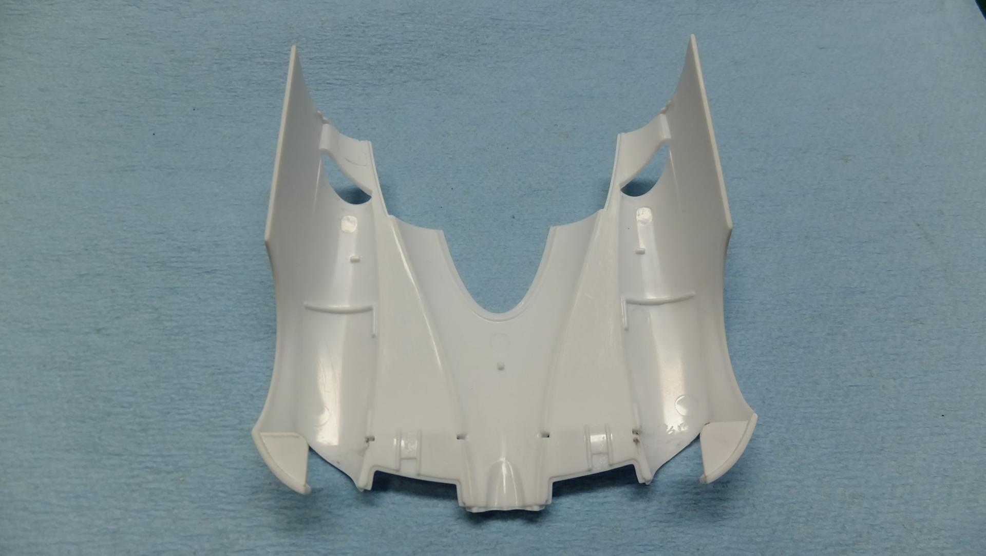

Dann Tier Posted June 26, 2018 Author Share Posted June 26, 2018 Here are a couple of parts that I forgot to post.....looking at the rear corners of the cowl, you can see where I added the brackets for the micro magnets. If you look closely, you can also see that I ground-away the rear positioning points of the fender-wells, so that you can still slide them into place. Quote Link to comment Share on other sites More sharing options...

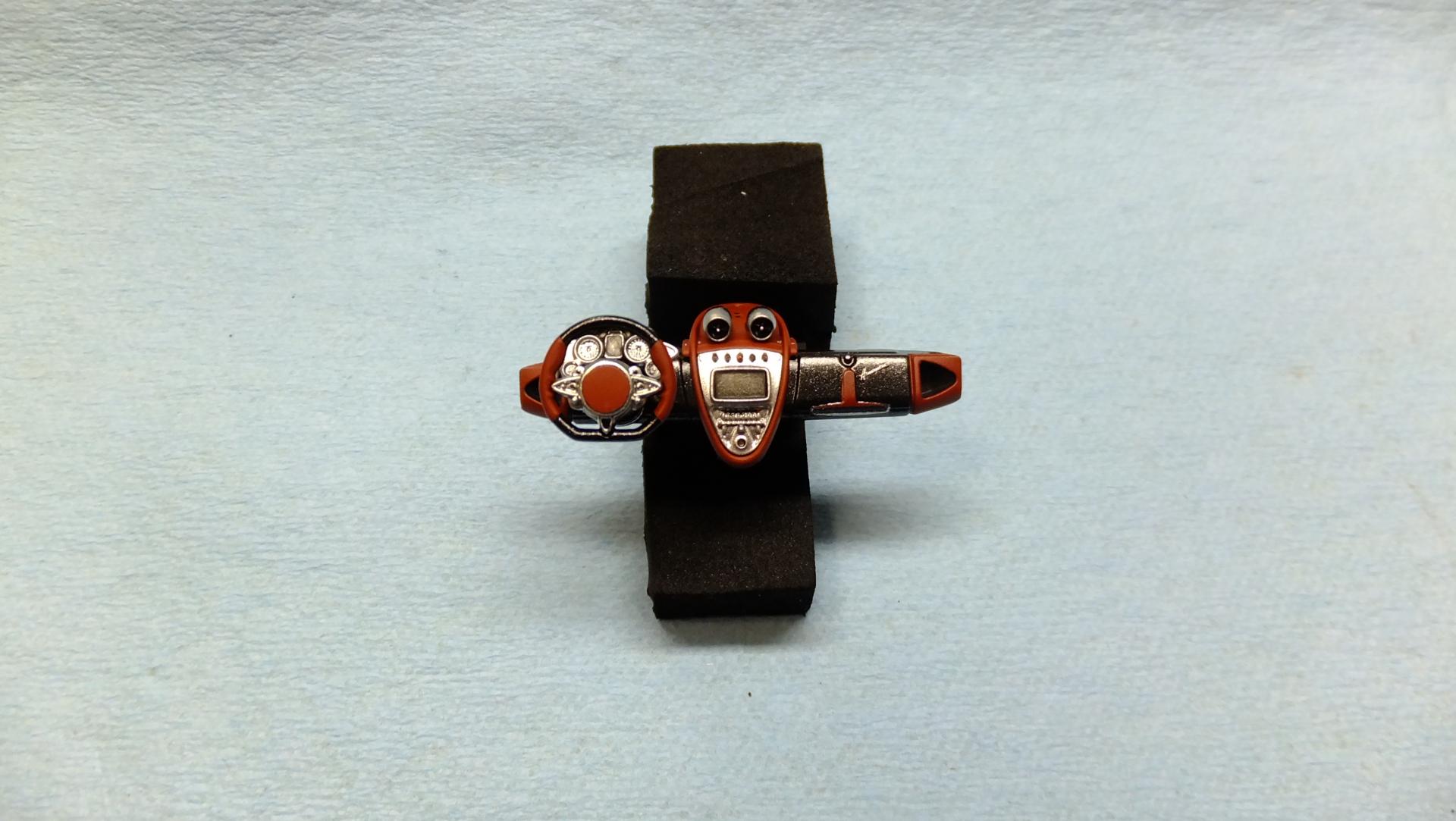

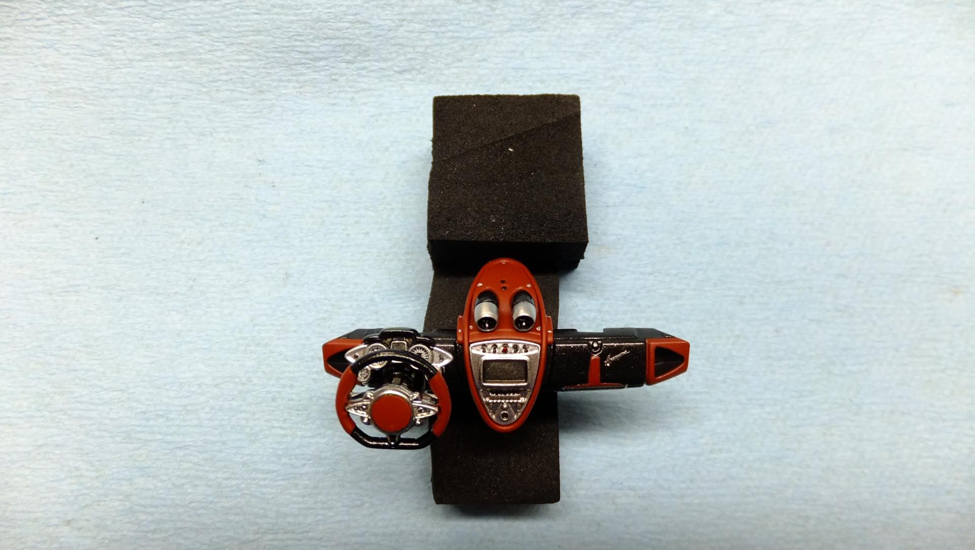

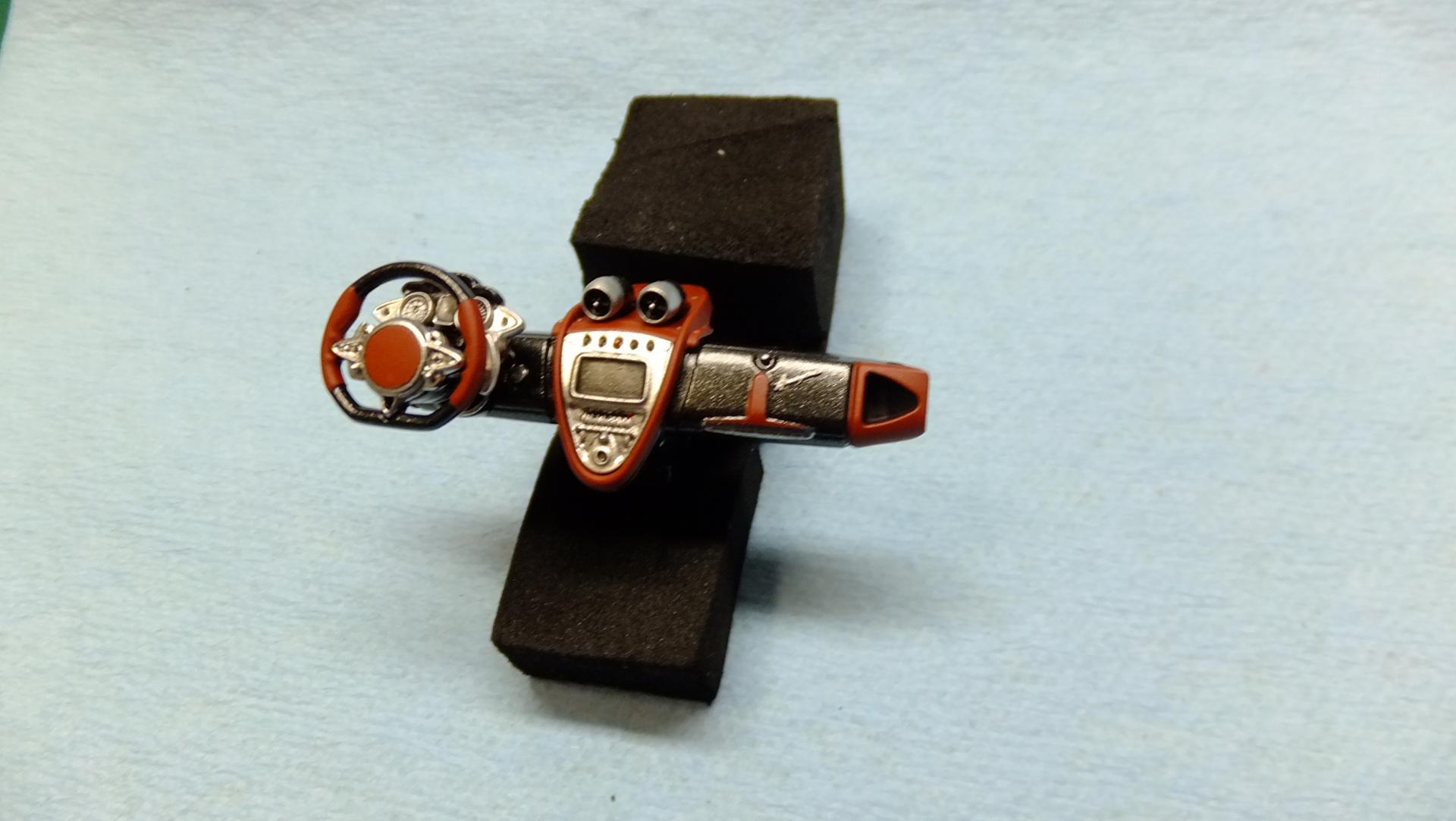

NOBLNG Posted June 27, 2018 Share Posted June 27, 2018 that central dash cluster looks like some sort of tribal mask! Quote Link to comment Share on other sites More sharing options...

Dann Tier Posted June 27, 2018 Author Share Posted June 27, 2018 4 hours ago, NOBLNG said: that central dash cluster looks like some sort of tribal mask! LOL, its crazy isn't it.... Quote Link to comment Share on other sites More sharing options...

jchrisf Posted June 27, 2018 Share Posted June 27, 2018 Great work Dann! I just read all your posts on this entire thread. I think I have a good idea (even though I am new to all this) of everything you have done except how do you mask and paint all that fine detail work like on your dash and doors. For instance the round leather piece on the center of the steering wheel.. how did you perfectly mask and paint that or the silver parts on the doors, etc. Small detail painting is my biggest struggle. Thanks for sharing your work. Quote Link to comment Share on other sites More sharing options...
Dann Tier Posted June 27, 2018 Author Share Posted June 27, 2018 28 minutes ago, jchrisf said: Great work Dann! I just read all your posts on this entire thread. I think I have a good idea (even though I am new to all this) of everything you have done except how do you mask and paint all that fine detail work like on your dash and doors. For instance the round leather piece on the center of the steering wheel.. how did you perfectly mask and paint that or the silver parts on the doors, etc. Small detail painting is my biggest struggle. Thanks for sharing your work. Thanks, Chris!, I always start out making a template with Tamiya tape, or their sheet of masking film, then I transfer it to a 3x5 card, and cut it out so that I can save it incase I want to build another one some day. I try to make my masking templates when the parts are still bare plastic, that way theres no way to screw up the paint. For the center of the steering wheel, I tried both ways of masking it; mask off the polished aluminum to paint the colored center, and masked off the colored center to spray the aluminum. Cutting out a round mask was WAAAAAY easier than masking around the center.....there wasn't enough of the edge to seal with the tape, so it bled through. Quote Link to comment Share on other sites More sharing options...
Dann Tier Posted June 27, 2018 Author Share Posted June 27, 2018 41 minutes ago, jchrisf said: Great work Dann! I just read all your posts on this entire thread. I think I have a good idea (even though I am new to all this) of everything you have done except how do you mask and paint all that fine detail work like on your dash and doors. For instance the round leather piece on the center of the steering wheel.. how did you perfectly mask and paint that or the silver parts on the doors, etc. Small detail painting is my biggest struggle. Thanks for sharing your work. I find that if I have to detail paint, I will use my other fingers of my painting hand to steady myself as I paint, either touching them to my other hand, the part i'm painting, or lower the part to the table, and touch it while painting. Hope you understand this, and it helps! Quote Link to comment Share on other sites More sharing options...
jchrisf Posted June 27, 2018 Share Posted June 27, 2018 3 minutes ago, Dann Tier said: I find that if I have to detail paint, I will use my other fingers of my painting hand to steady myself as I paint, either touching them to my other hand, the part i'm painting, or lower the part to the table, and touch it while painting. Hope you understand this, and it helps! Thanks for the explanation Dann.. I do understand this but the post before I am not understanding if you transfer your used mask to cardboard or if you make the template in cardboard first and then transfer it back to Tamiya tape? Whatever you do it works perfectly Quote Link to comment Share on other sites More sharing options...

Dann Tier Posted June 27, 2018 Author Share Posted June 27, 2018 5 minutes ago, jchrisf said: Thanks for the explanation Dann.. I do understand this but the post before I am not understanding if you transfer your used mask to cardboard or if you make the template in cardboard first and then transfer it back to Tamiya tape? Whatever you do it works perfectly LOL, I use the tape directly on the part, form it to the proper shape....burnishing it down, cut it out carefully, then stick it to a 3x5 card. cut the shape out again, trace it on a fresh piece of masking tape/ film, cut it out, then put it in place and spray your kolor…..hope its better to understand now...lol Quote Link to comment Share on other sites More sharing options...

jchrisf Posted June 27, 2018 Share Posted June 27, 2018 1 hour ago, Dann Tier said: LOL, I use the tape directly on the part, form it to the proper shape....burnishing it down, cut it out carefully, then stick it to a 3x5 card. cut the shape out again, trace it on a fresh piece of masking tape/ film, cut it out, then put it in place and spray your kolor…..hope its better to understand now...lol I understand now and that is what I thought but wanted to be sure. Thanks again for sharing your tips and work Quote Link to comment Share on other sites More sharing options...

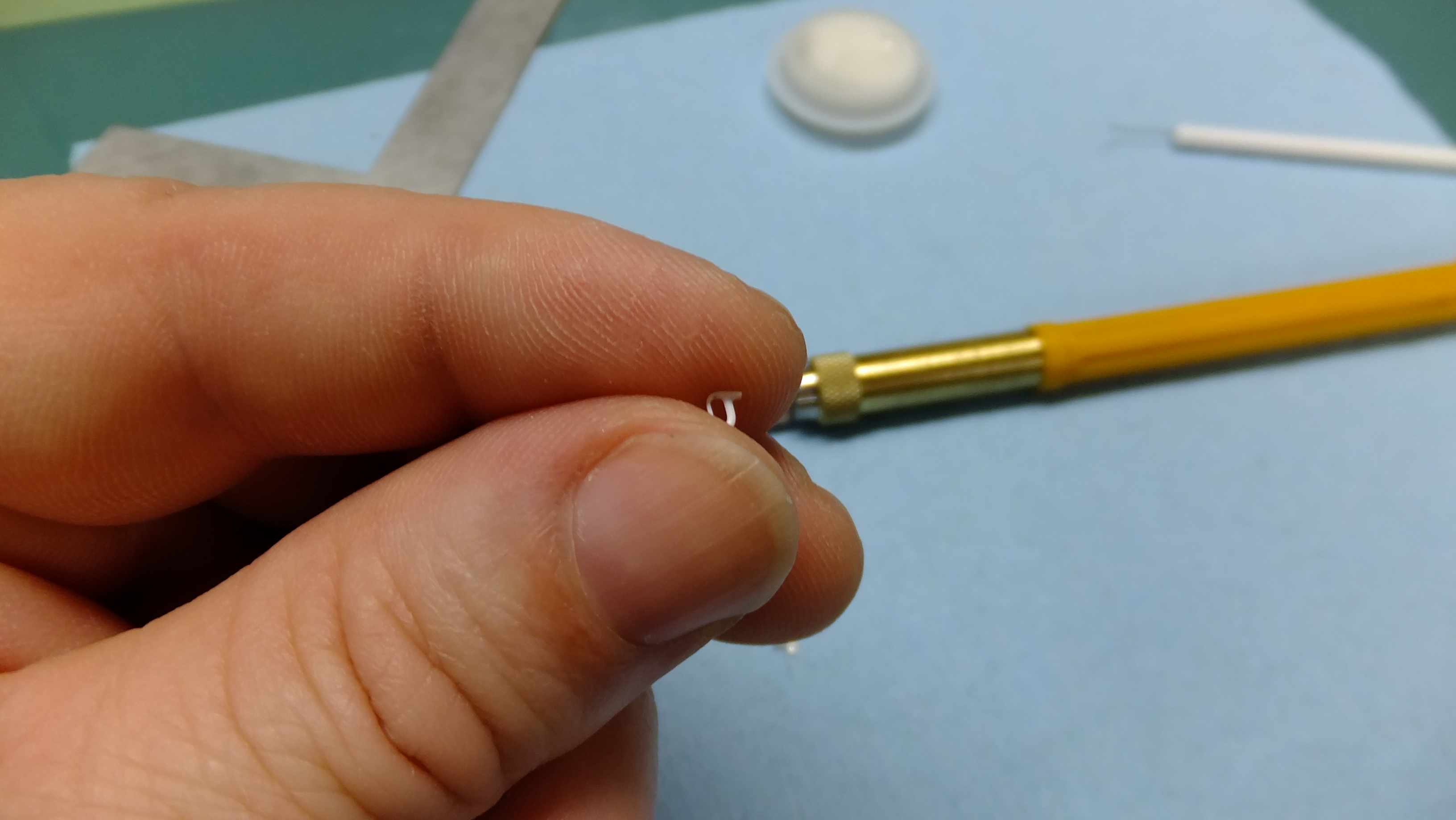

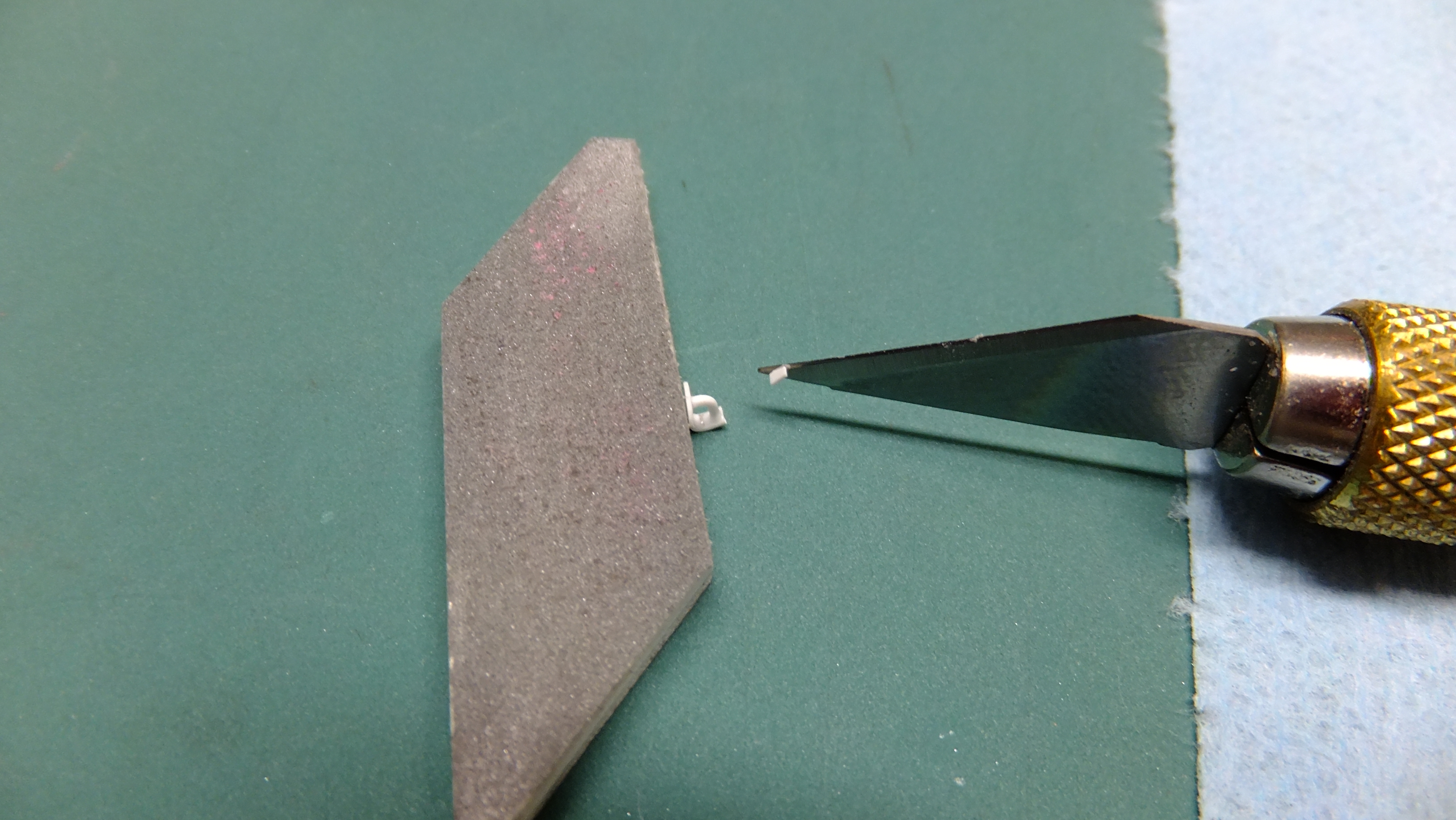

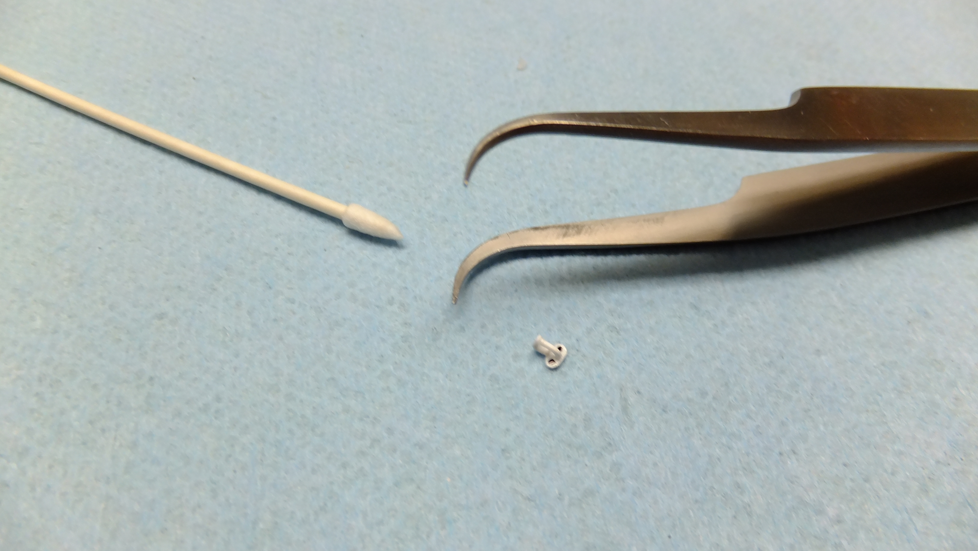

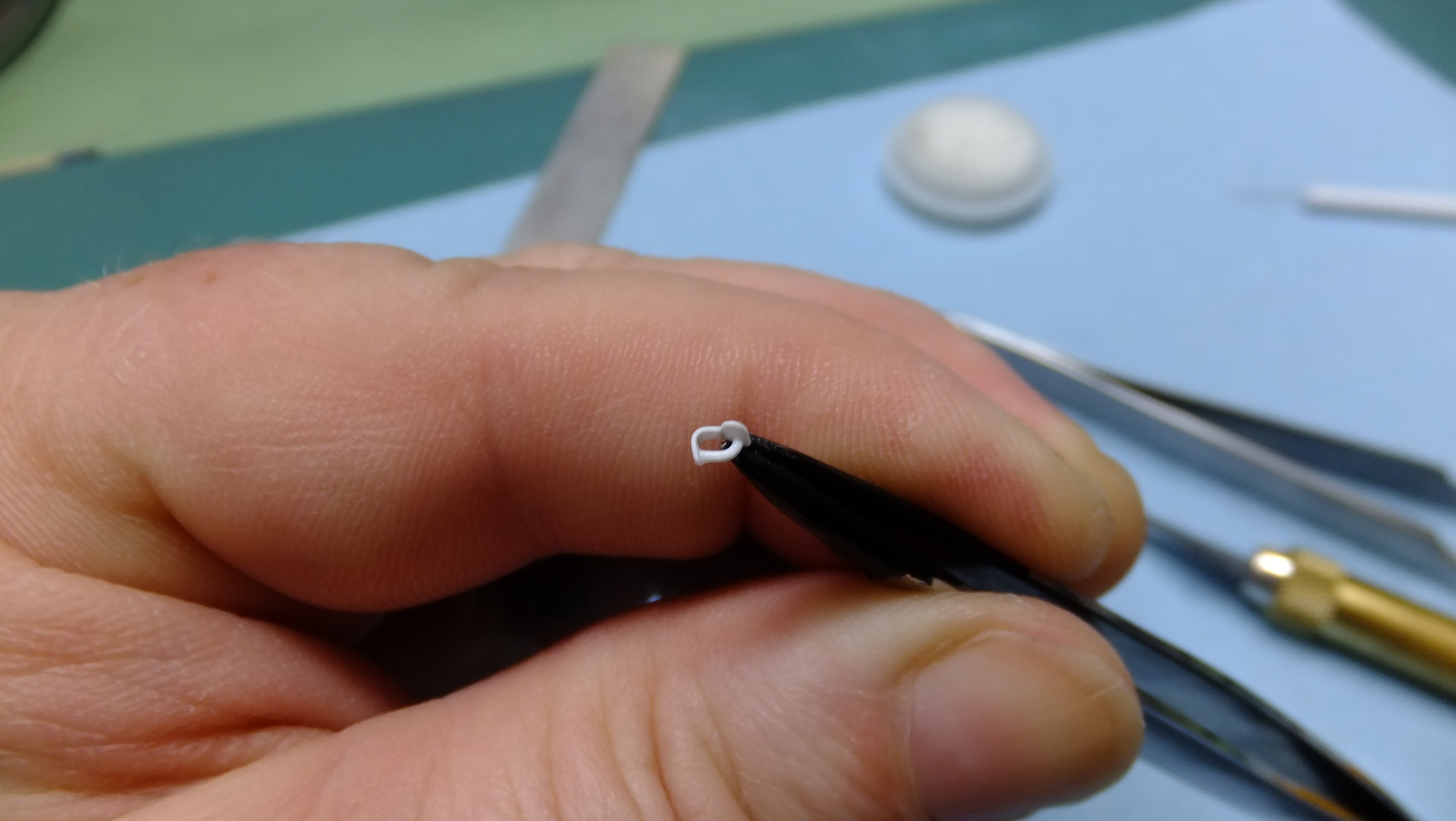

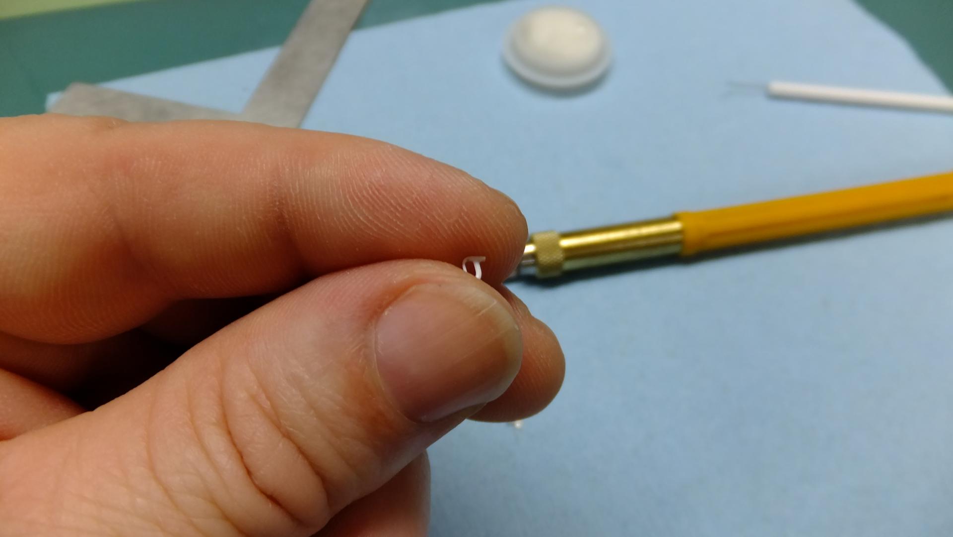

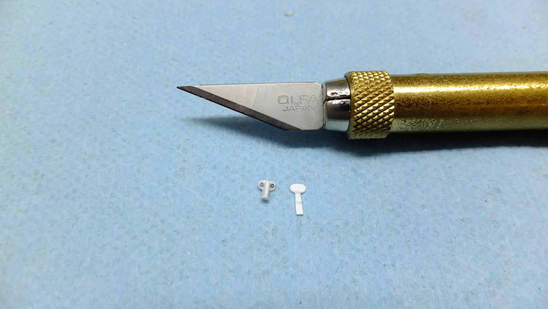

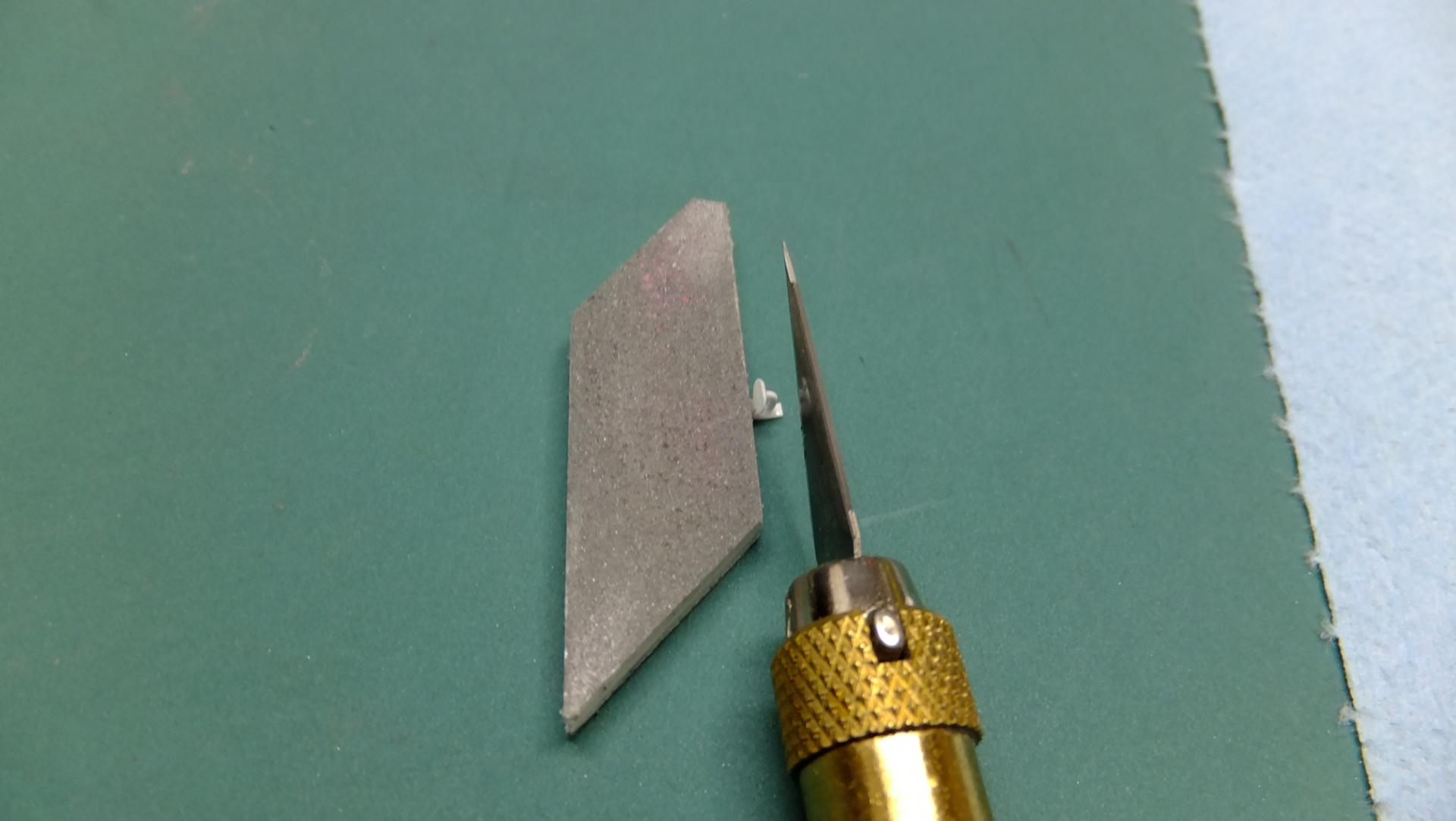

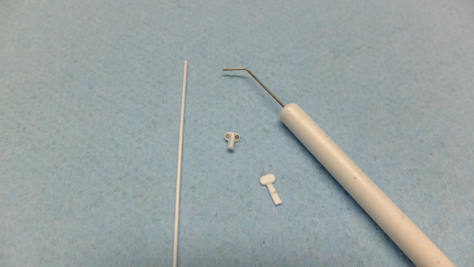

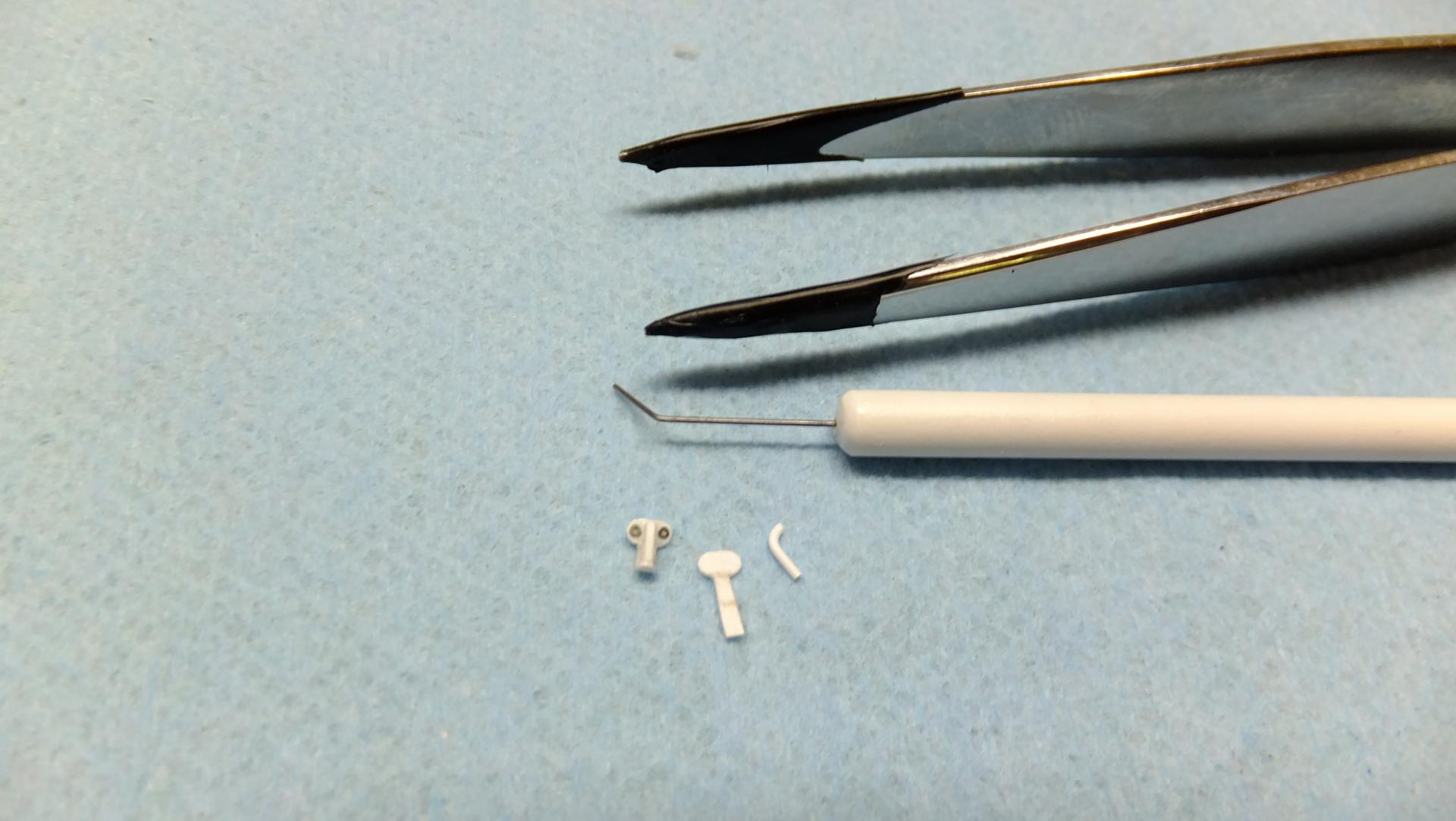

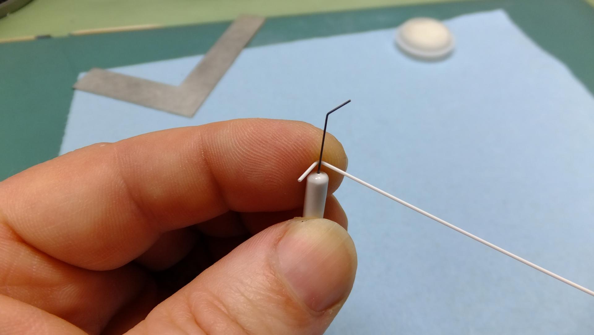

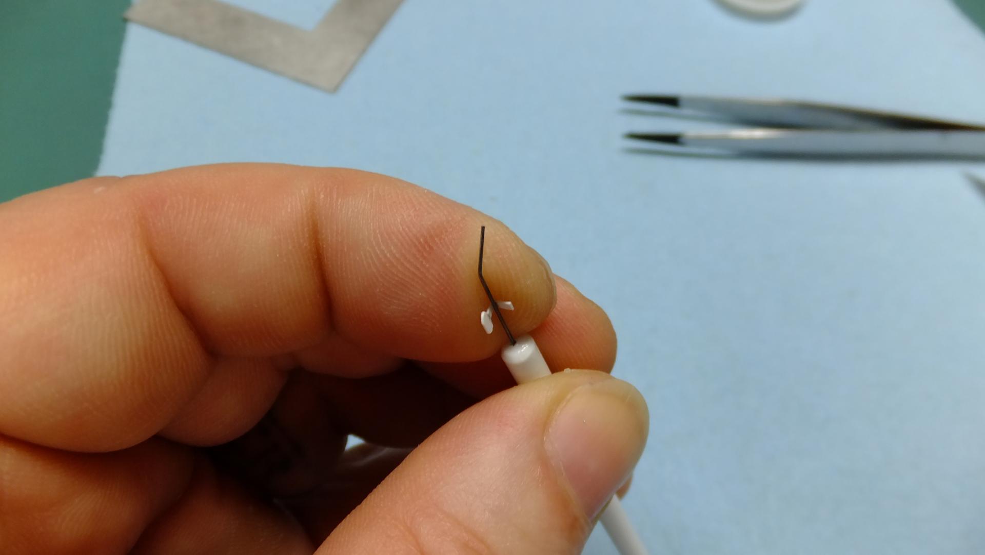

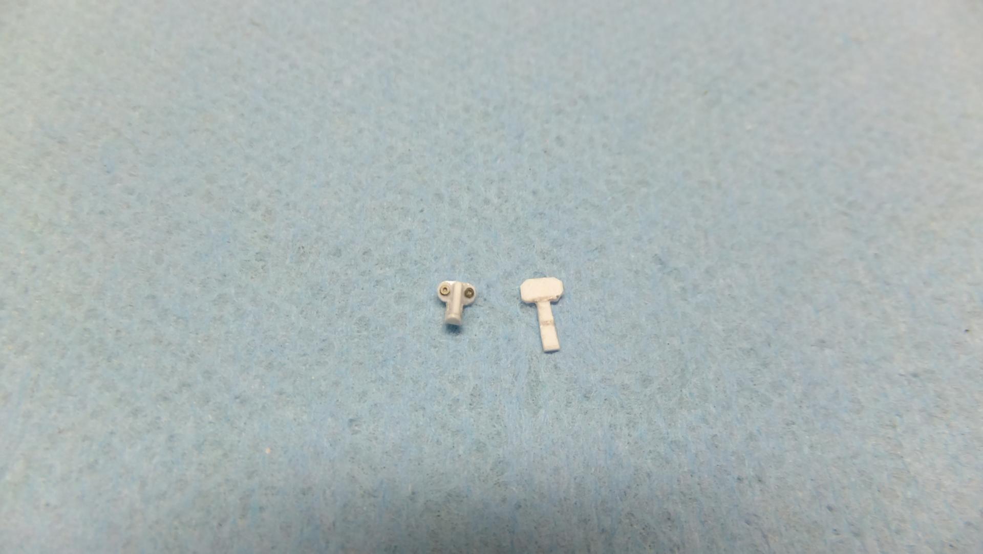

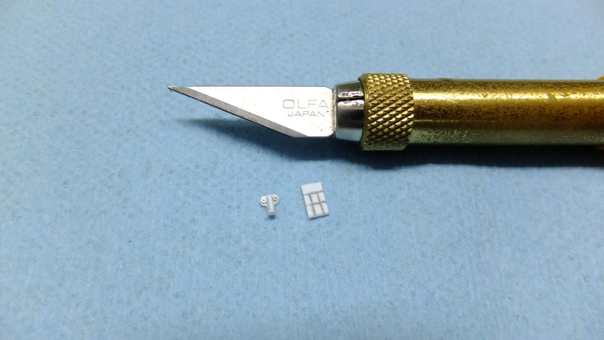

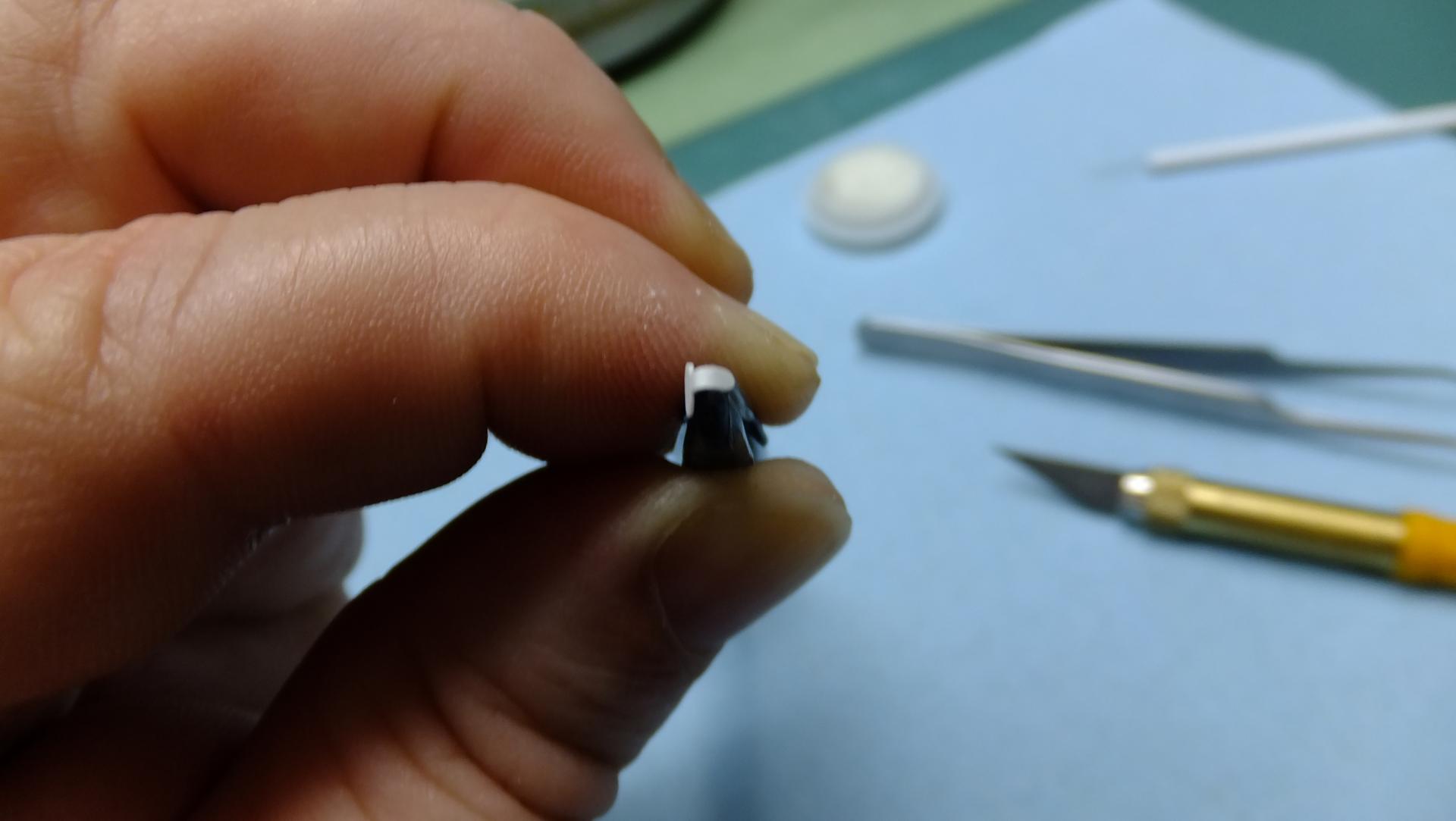

Dann Tier Posted June 28, 2018 Author Share Posted June 28, 2018 Hey, everyone! as requested from a few of you, here are the steps that I take to scratchbuild my door catches....I hope this helps! -First photo; I picked out the thinnest sheet of styrene they make, and measured out the size it had to be, by using the kleaned-out opening of the molded in ones. -Second photo; I notched-out the basic shape. -Third photo; I kleaned it up, and using tweezers, I rounded the corners of the base. -Fourth photo; I got the thinnest styrene rod I had (Sorry, I cant remember the size ), and got my spring steel glue/ paint dot application tool. -Fifth photo; The rod is easily bent without breaking. I would suggest going just pass a right angle, since it will slowly start to straighten back out again. -Sixth photo; Cut one end of the rod as close to the bend as possible leaving a gap about the same width as the diameter of the rod being used, and then cut the long end off at the last pencil mark furthest from the top of the rounded bracket base. -Seventh photo; At the same pencil line from photo six, I used my tool again to bend the bracket over....I bent it til it touched itself around the tool ( should be at a right angle at this point ). -Eighth photo; Very carefully, glue the curved end of the rod in the center of the top edge of the bracket. I would suggest using a quick drying superglue. After its dried, adjust the long end of the rod so that when you bend the flat tail of the bracket up to meet the rod, it just up slightly past a right angle. I use my very sharp snippers to make the adjustment to the rod if needed. -Ninth photo; I braced mine up against a sanding stick so that I could cut off the excess plastic up against the end of the rod. -Tenth photo; Using my blade, I carefully cut away the rest of the excess plastic to match the curve of the rod. -Eleventh photo; I lightly sanded the bottom of the catch til it was smooth with the curve of the rod. -Twelfth photo; Notice the slight angle of the tail of the catch that was previously mentioned. -Thirteenth photo; The finished product!!…..where the black ink dots are, is where I would glue my PE bolts. Quote Link to comment Share on other sites More sharing options...
Jason Sheer Posted June 28, 2018 Share Posted June 28, 2018 THat latch is next level ! Super-customize Me Please ! Are you still painting the Body Silver-graphite color? Now all we need is a Konessieg Agera Kit! Aoshima get on a licensing deal with Christian pronto!!!! Quote Link to comment Share on other sites More sharing options...

Exotics_Builder Posted June 28, 2018 Share Posted June 28, 2018 Great technique. I appreciate the tutorial!! Quote Link to comment Share on other sites More sharing options...
NOBLNG Posted June 28, 2018 Share Posted June 28, 2018 (edited) 12 hours ago, Dann Tier said: ...and got my spring steel glue/ paint dot application tool. Hi Dann. Pardon my ignorance, but what's the deal with this tool? Is it just a piece of wire on a handle, or a hypodermic type tube? What type of glue works with it and how do you use it? Thanks, Greg. Edited June 28, 2018 by NOBLNG Quote Link to comment Share on other sites More sharing options...
