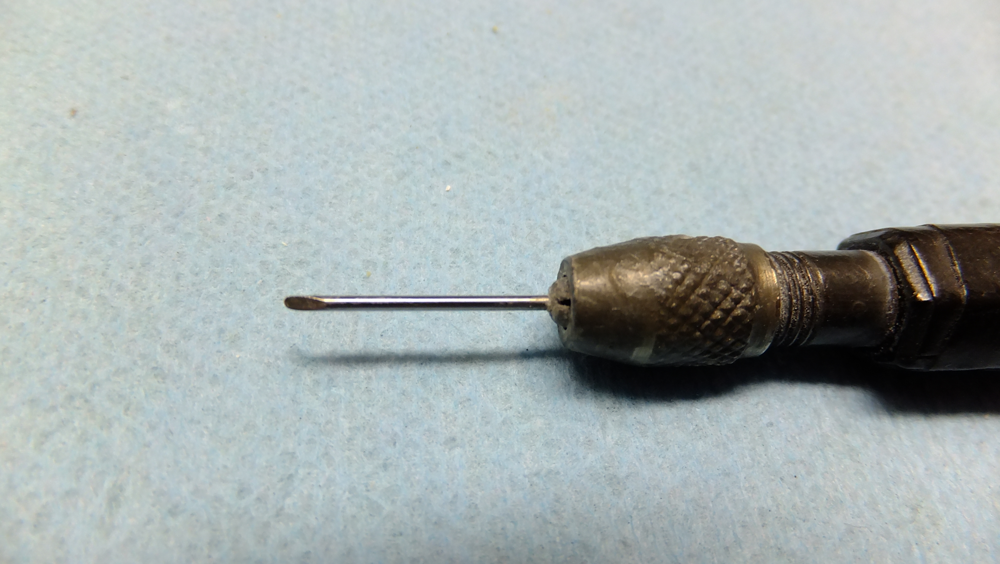

Hi Dann. Pardon my ignorance, but what's the deal with this tool? Is it just a piece of wire on a handle, or a hypodermic type tube? What type of glue works with it and how do you use it?
Thanks, Greg.
Hey, Greg!, I don't know about anybody else, but quite often I will make things like this to make my building easier. I try to mask as much stuff as I can, but there will ALWAYS be a time that I have to hand paint/ detail something. I made this tool out of necessity for this Pagani, but its proving to be more useful than I originally thought. Its made of a styrene rod, and K&S spring steel. I needed something to accurately, and uniformly dd all the screws, and bolts in the interior, and after putting a comfortable angle on it, and grinding the end of it totally flat, it worked quite well as you can see. I ended up using it for knobs/ buttons on the steering wheel and dash as well. Its even REALLY great for micro applications of glue!, and you can scrape the end off as much as you need, without damaging the end, because its spring steel!  I do have other sizes now that I know they work well. Thanks for the interest, I hope this helped!

That works pretty good too!, for my main building, I have an old pin-vise without the swivel end, that I use. I put a broken drill bit in it (backwards), and ground the tip at a sharp angle....works perfectly!. and like yours, you just scrape it klean!

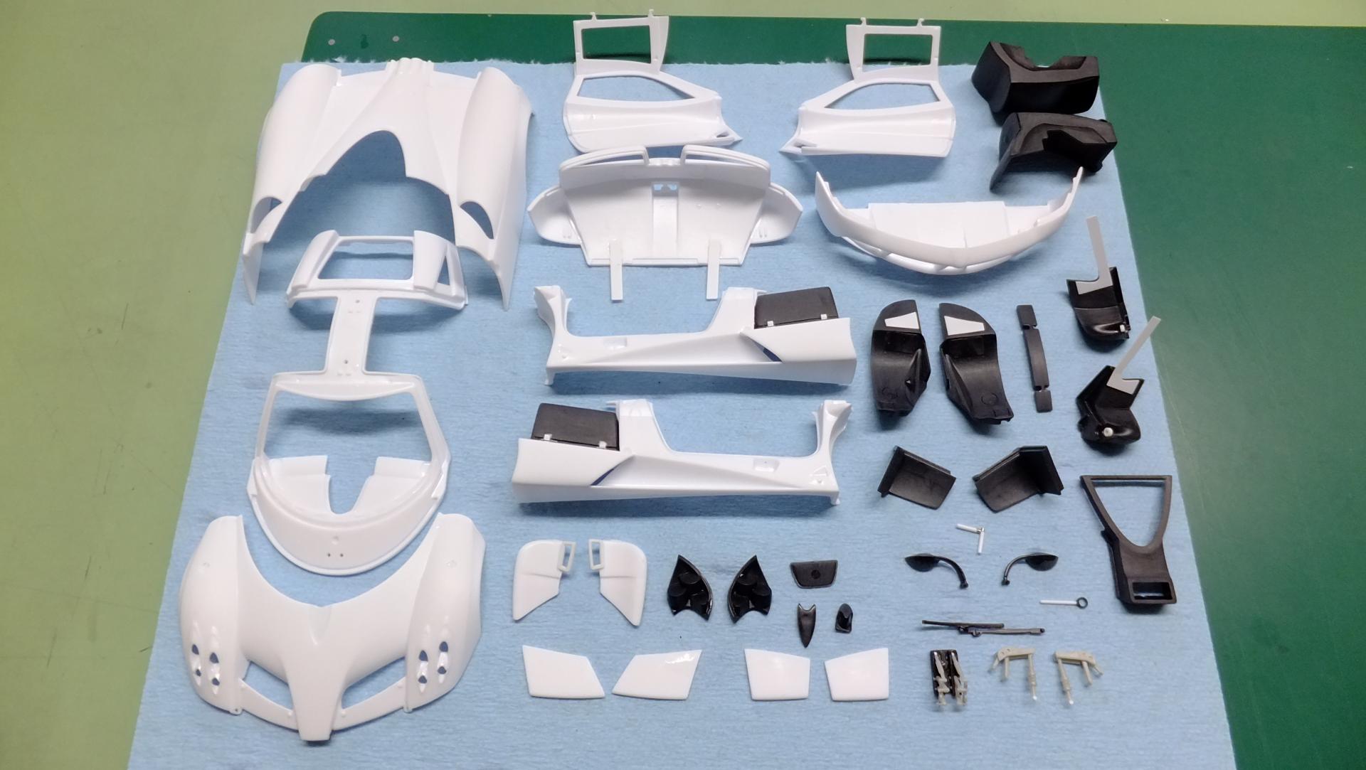

Thanks, Mark!!, where have you been?!, hopefully everything is tickety-boo in your life!!   -I will be posting a video on how I like to mount its parts for painting, otherwise, it wouldof already been primered today, lol

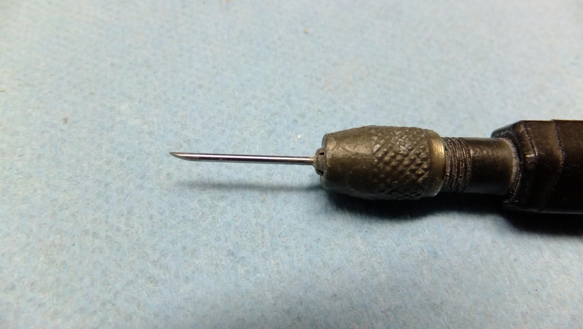

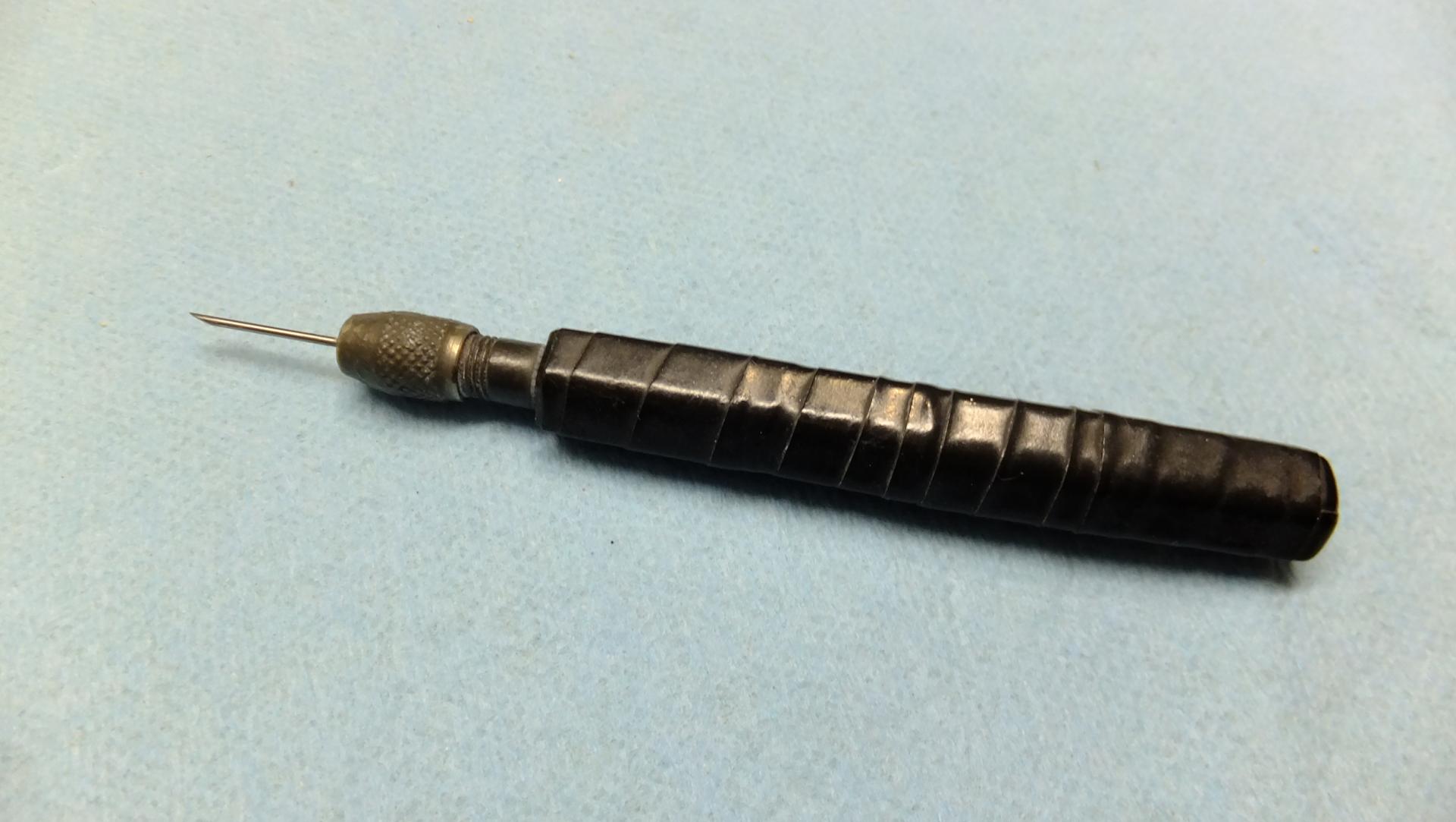

Heres my main glue application tool....

LOL!, Thanks, Thomas!, i'm in the process of painting th body now.....usually takes me two weeks, but I will be posting more SB details VERT soon!!  -i'm glad you like it!, if you are interested, I have made three videos on building it so far. They can be seen at; Scale Models And Figurines.....youtube
