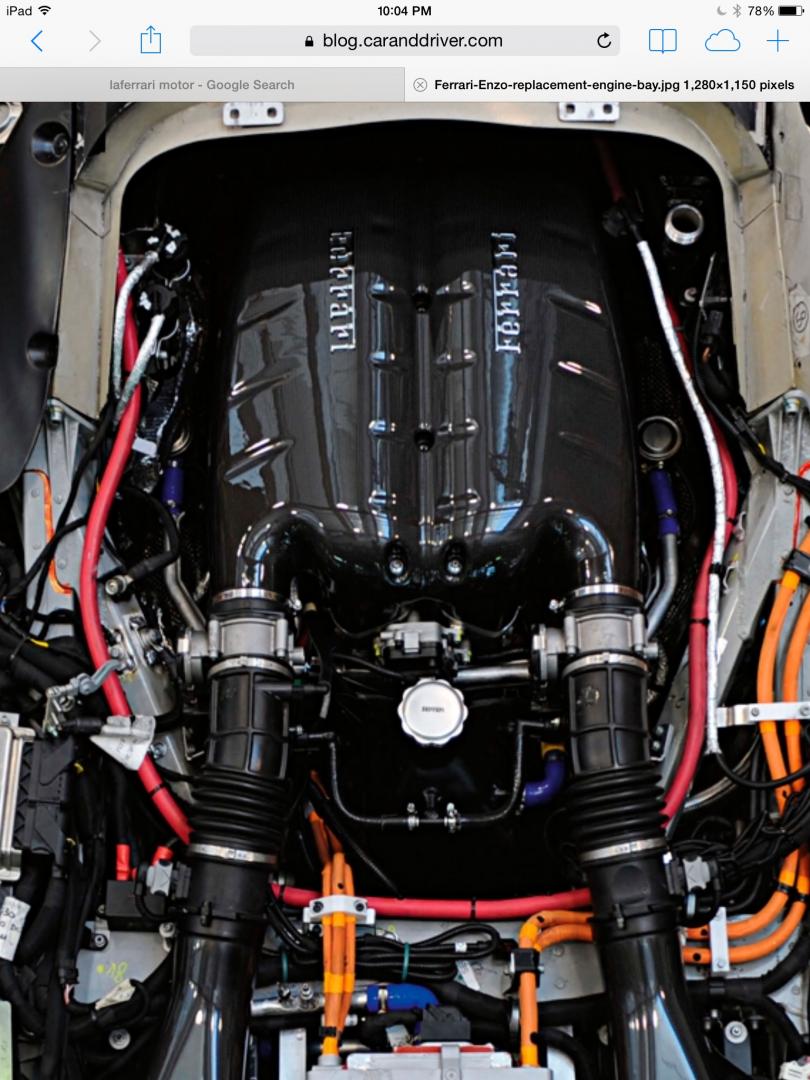

This is a picture I used for some detailing. This car is a test mule of the la Ferrari. Hope it helps some
Share this post
Link to post

Thanks, guys... and thanks to Tim for the reference material.
