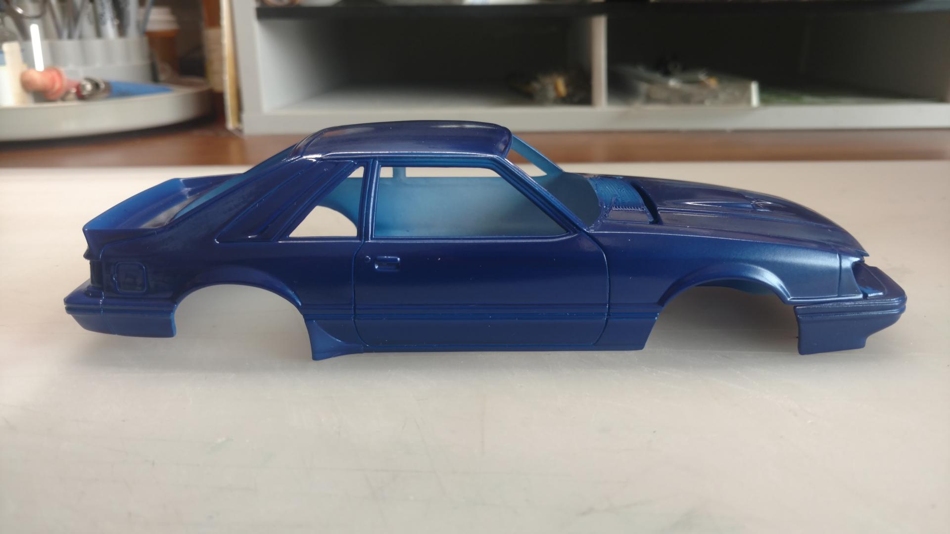

I painted this with Model Master Arctic Blue Acrylic.  It sprayed through my airbrush with absolutely no issue.  Then the clear coat ate my lunch, so into the purple pond she went-a-swimmin'.  I think I will be going with a Sinful Colors "Let's Talk" pearl blue this time so I can use lacquer clear.  IMG_20180301_122358852.thumb.jpg.4f359b61c551d85fe0fcbf316c07caa2.jpg

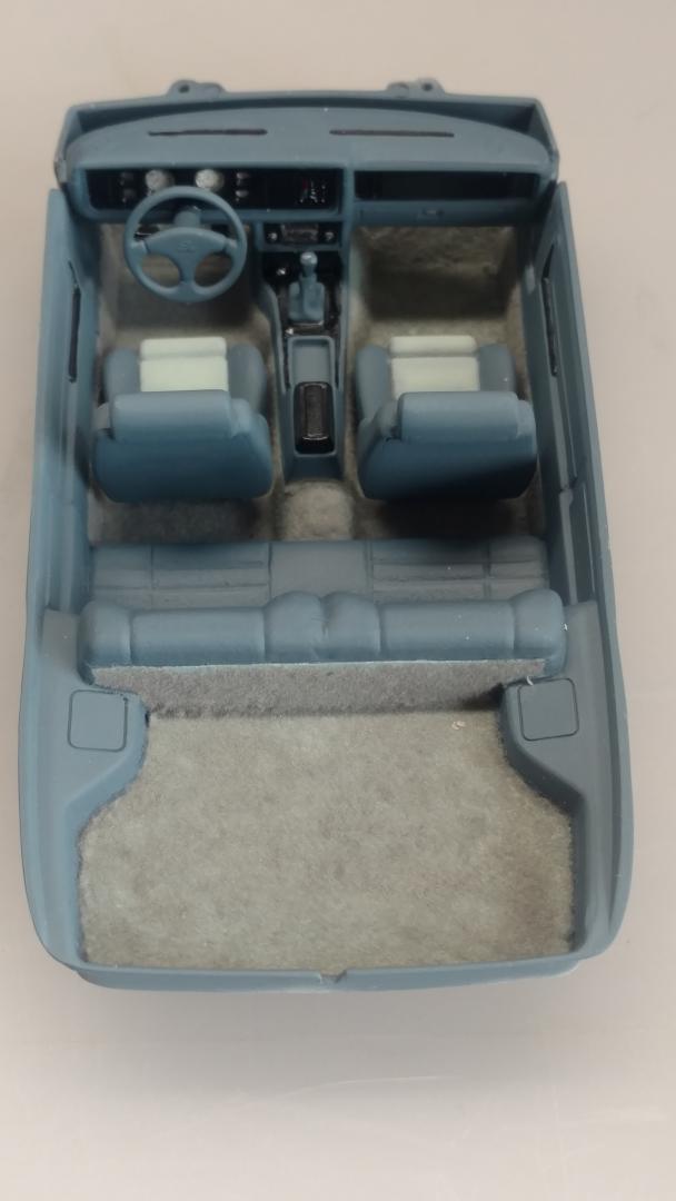

The interior is relatively box stock.  I modified the gauges to be deeper into the dash and to have a lens.  It didn't turn out as good as I had hoped, but I think it looks better than the stock offering.

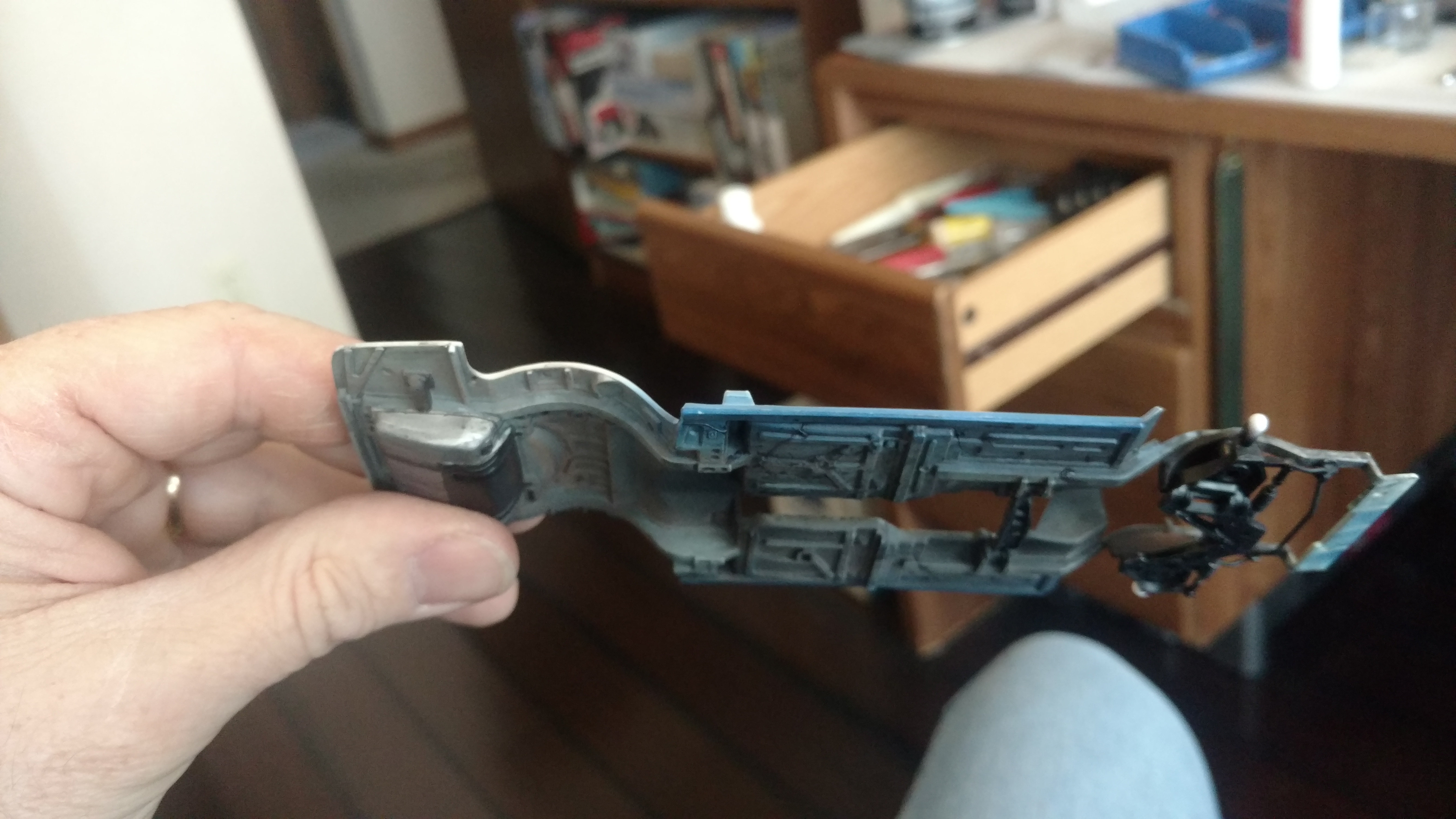

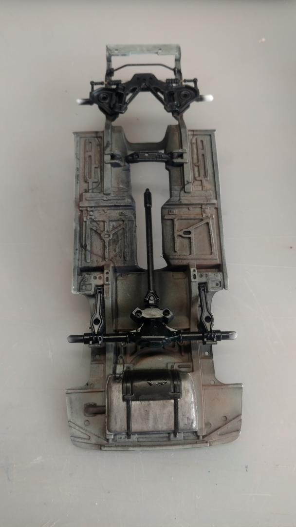

I weathered the chassis and Engine to resemble something that is driven often as opposed to a trailer queen.  I used light gray primer, acrylic washes (made with thinned out paint), airbrush work to get some grime stains, and a very steady hand to paint the molded in hoses, lines and details.

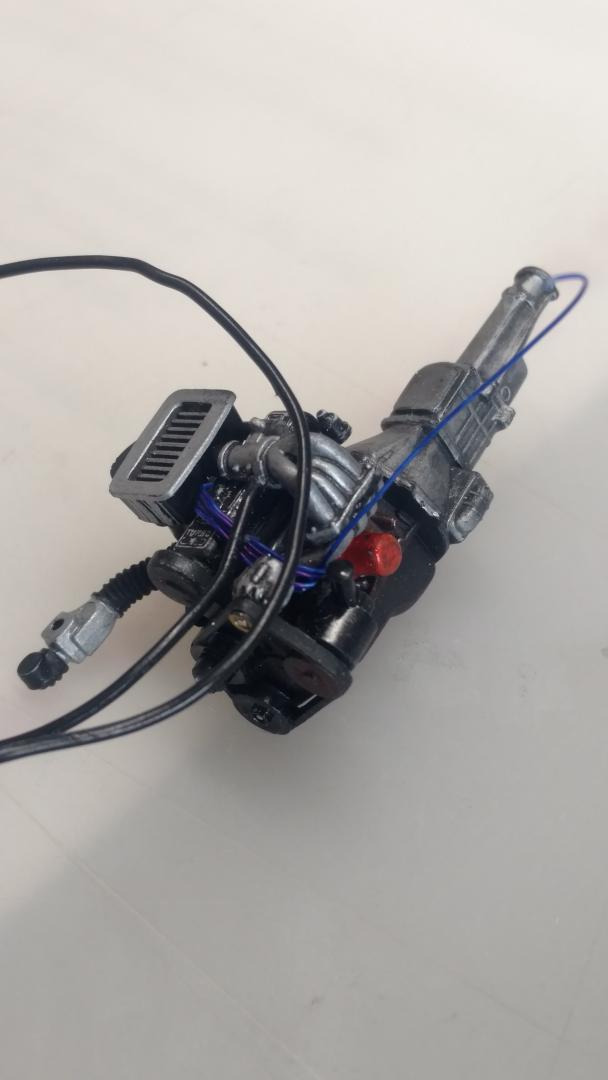

The Engine and Transmission are also detailed with acrylic washes also I have added ignition wire, turbo oil feed line, brake booster hose, and will be adding more harnesses and air conditioning system.

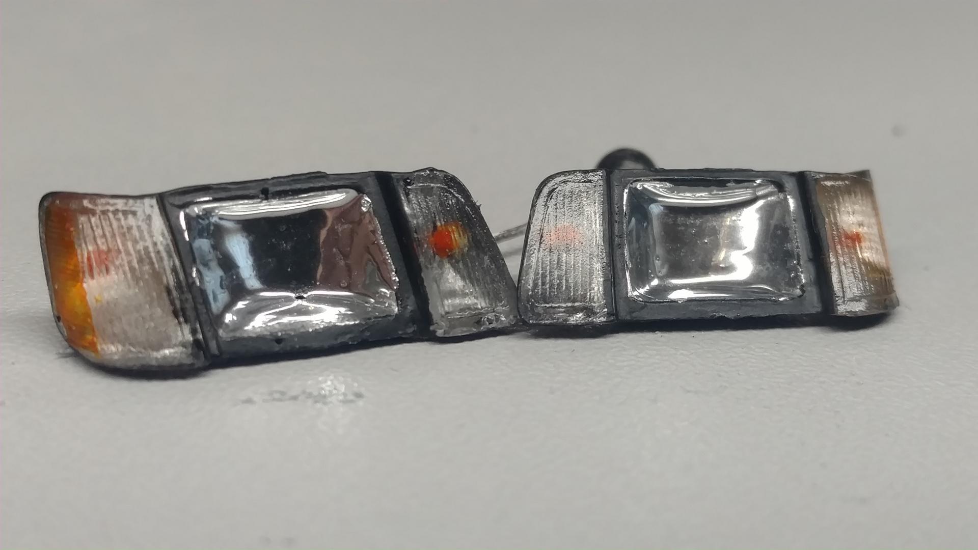

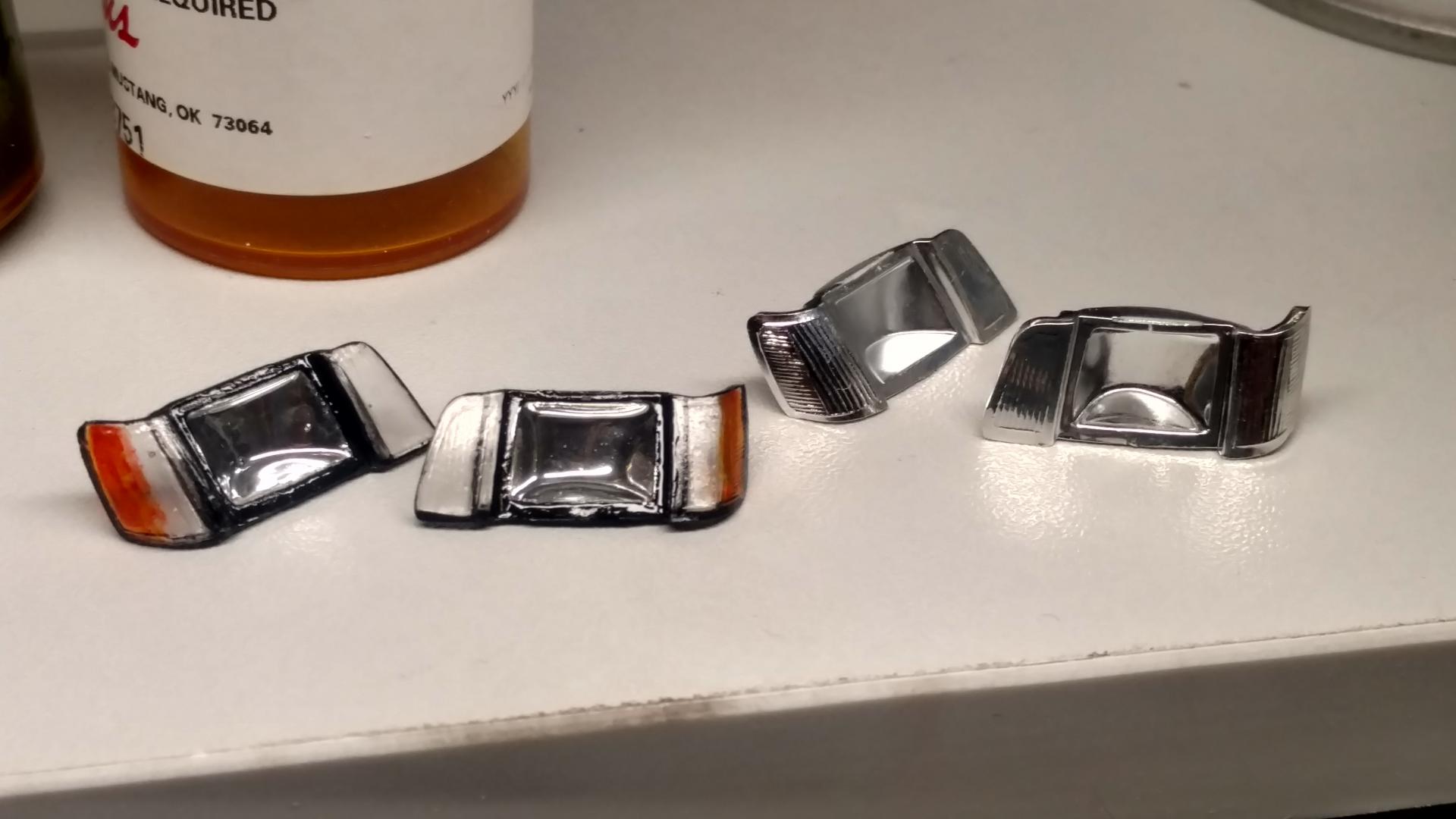

I was also very unhappy with the chrome turn signals up front, so I made a mold and cast some clear lenses.  I added material to the back of the lenses to resemble the buckets of the real car, instead of just plain lenses with nothing behind them.  My first rendering of the clear lens came out great, but I new I could make it better.  The second image of the lenses I am comparing the original part to my first rendering of clear lenses that have been detailed.

Those chrome turn signals/parking light lenses were the most obvious weakness of that kit. Good to see you addressed that in a major way. :)

Thats one of the best looking weathered chassis I've seen ina  really long time! \m/ Keep it up!

Nice work , chassis looks great

Thanks, Mike.  I really wanted to make this car look driven but not abused, as if maybe a feller might have purchased it and put a paint job and some other stuff to make it look nice without having it fully restored.

I had to have another go at the paint, so another setback.  One more wetsand and a final color coat, trim and final assembly.  HOPEFULLY all goes well.

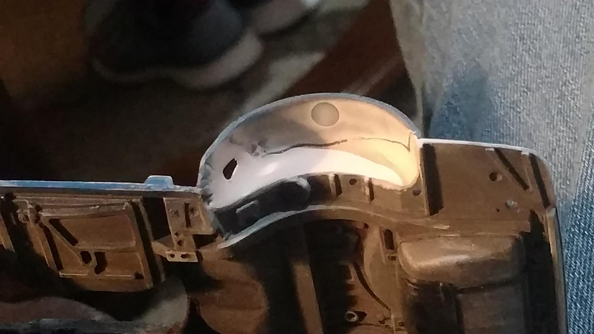

Looking at my Revell 1993 Cobra I was seeing some things that needed attention.  The wheel wells are non-existent.
So I found a chassis with some decent wheel wells from the parts box, I think it was from a Buick.
Some fancy cutting, super-glue, and some putty later and a you have a reasonable wheel well.
Now I'm going to blob in some Tamiya primer to give it an under-body coating texture, some semi-gloss or flat black and some weathering to match the rest of the chassis.  Then on to the front.

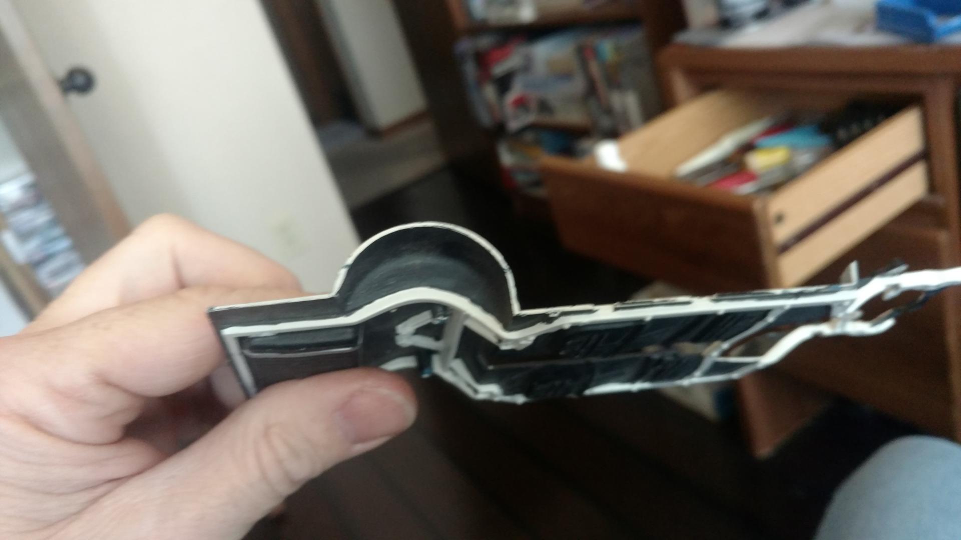

I wasn't happy with the clear version of the kit headlights, so I re-molded them to have buckets behind the turn/park lamps.
I also finished up the new rear inner-fenders and drilled and painted the exhaust.

There really isn't a lot more to do, but the clear coat is being very stubborn and it isn't getting very shiny.  I can't assemble anything else until I get the paint done.  Soon as I figure that out it'll be "Under Glass".

The bad thing is the sister kits (the 93 Cobra and the GT Convertible) had amazing headlights with buckets behind the lenses.  Maybe the SVO was the basis of the Cobra and convertible and they made improvements.  Who knows.  Anyway you put it, I have some good looking lenses now.

Thank you for your compliments.  It really does fuel the drive to do better and push through the difficult parts of modelling.
Don't mistake this one for not having clear headlight lenses, it does.  However, it doesn't have clear front corner markers or turn signals.

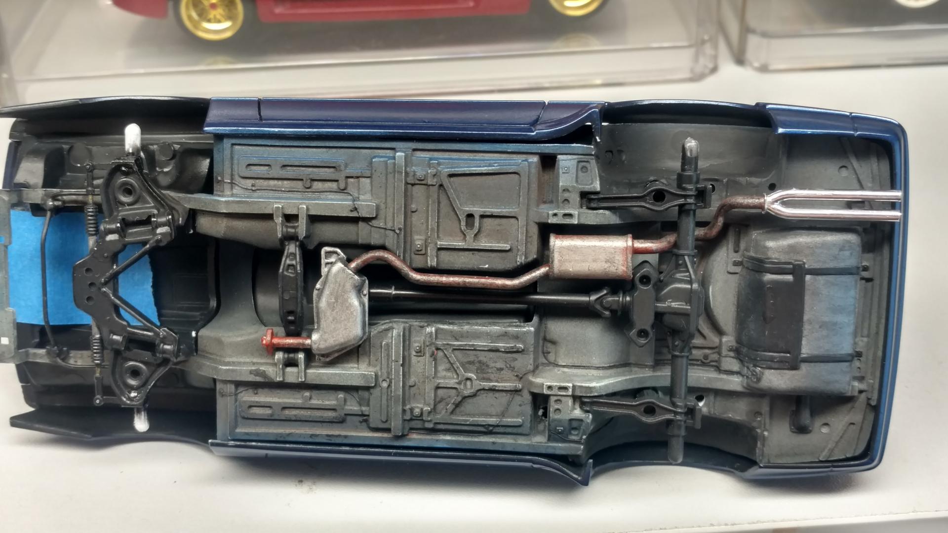

Amazing work on the underside! The weathering is spot on

Thanks.  It's all just thinned acrylic paint and dry brush.  As a mechanic, I see a LOT of daily driven car chassis, so I really know what they look like.  Lol
You see the blue "overspray" like ithe car was recently painted?  I am going for a used but well driven look
