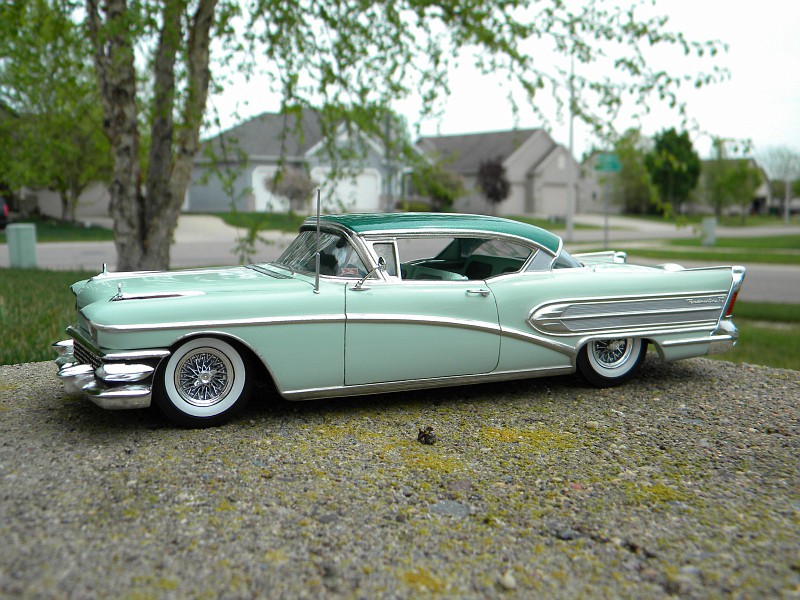

I usually will scribe all of my panel lines a bit more to insure that they are all deep enough & uniform & then just paint it.
After all of my paint work, foil, etc, usually one of the very last things that I will do is use some Ceramcoat acrylic craft paint, slightly thinned and flowed into the panel lines & then after drying to the touch I wipe over the body with a slightly dampened cloth to remove any excess.
This helps get it cleaned at least a bit down into the groove & helps to keep it looking less stark.
I also will use a darker shade of the body color on lighter colors to help with lessening the starkness.
Black works fine on dark colors.
This '58 Buick was done in this manner, probably with dark green, but I think it still looks pretty much black, & I also think it looks pretty realistic. ;)
Steve

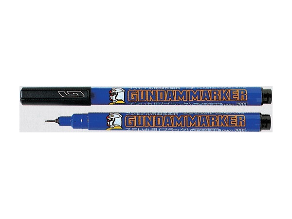

Anyone tried these yet? My son uses them to define the panel lines on his Gundams. I keep meaning to buy one, but the mind alas, is slippery when I get to a hobby store.
Image result for gundam markers
Yes, my latest completed that is in the under glass section I used those on it.
I scribe the panel lines to get them a little bit deeper, than I am use the marker , then primer and paint.
