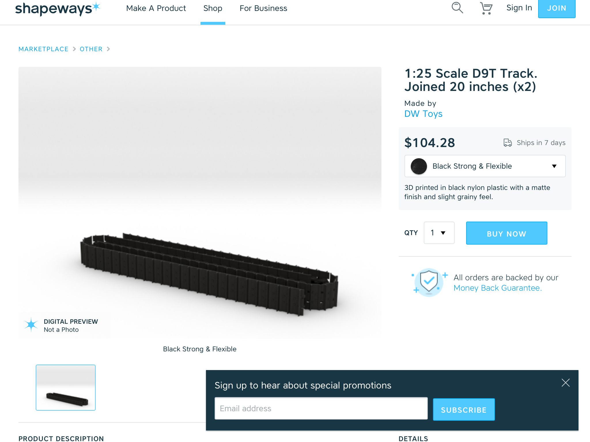

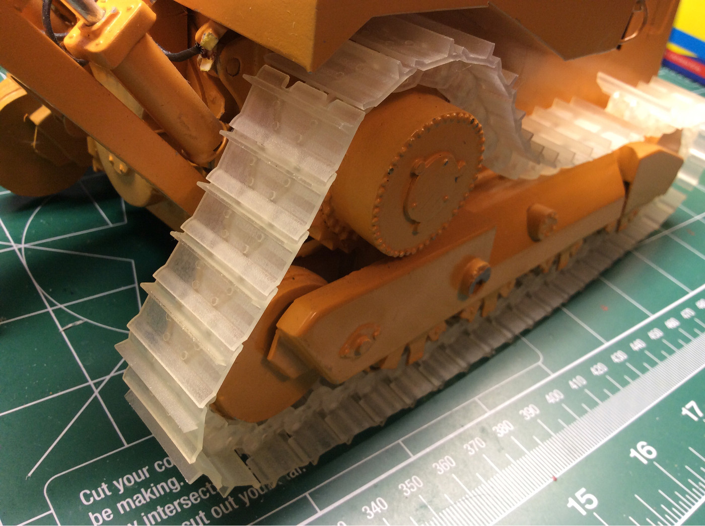

I had the correct tracks drawn up for print on Shapeways for my D9T high track dozer. The D8H idler wheels need to be widened a bit to fit the tracks properly. The white version is just five links for test fitting if desired.

Hey!  those are nice!  Quite an improvement on the kit parts.  You say you did them for a D9.  Is there much difference between the D8 and D9 that would be noticeable?

This is on the pile of things to be released in May.

D9 track of a similar vintage (H and G models) would be wider, for the "normal" width about 2" wider on the 1:1, whereas D8H track would be about 22". However, the true width difference depends on which spec of track is modeled by each respective source. D9 track would also have more links per side.

The idler wheels are a little bit too wide on the D8H but that’s an easy fix.

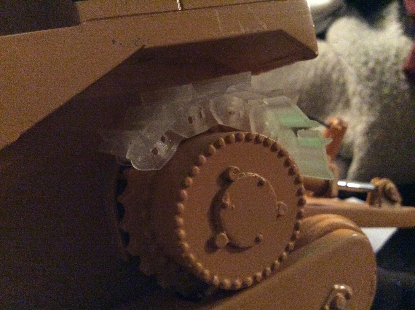

This D9T drive sprocket was made using the sprocket from the D8H kit. The 3D printed tracks fit it perfectly.

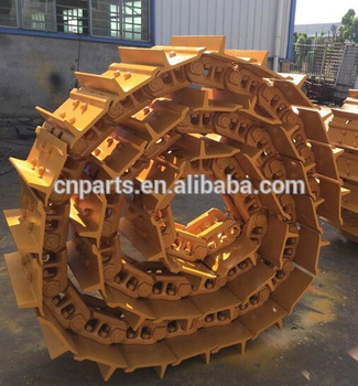

Here’s how the D9T tracks I had made compare to real D8H tracks.
