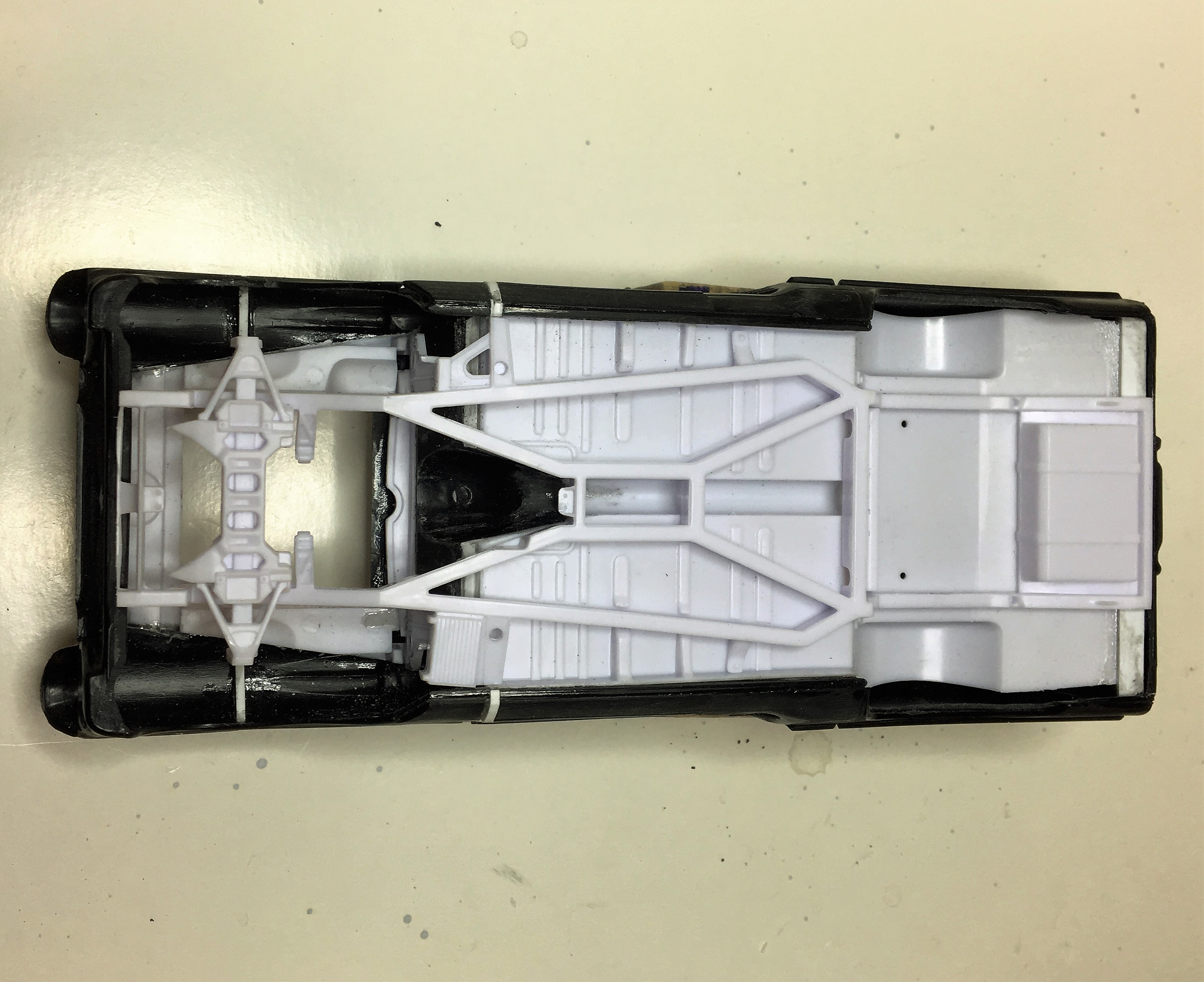

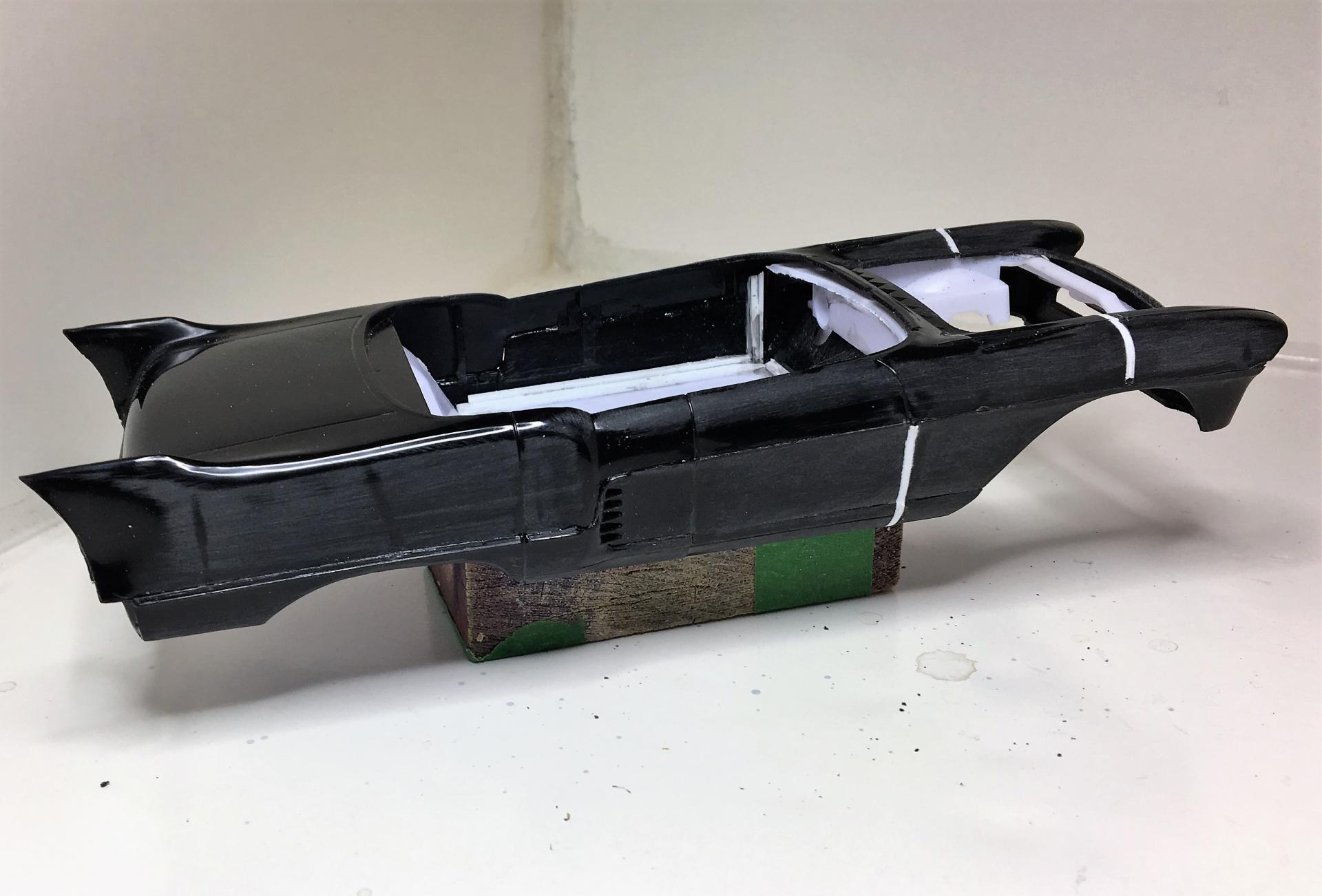

dino246gt Posted March 30, 2018 Share Posted March 30, 2018 I started to mix that chassis, engine, suspension, with an Eldo Brougham, stretched the front fenders and customized the body but here's how I extended the front end. To keep the wheel openings intact, I added styrene to the lower portion just at the door/fender line, then on the upper part (this kit has a multi-piece body) I extended it just above the wheel openings. I opened up the hood and fitted the Foose inners as well. Quote Link to comment Share on other sites More sharing options...

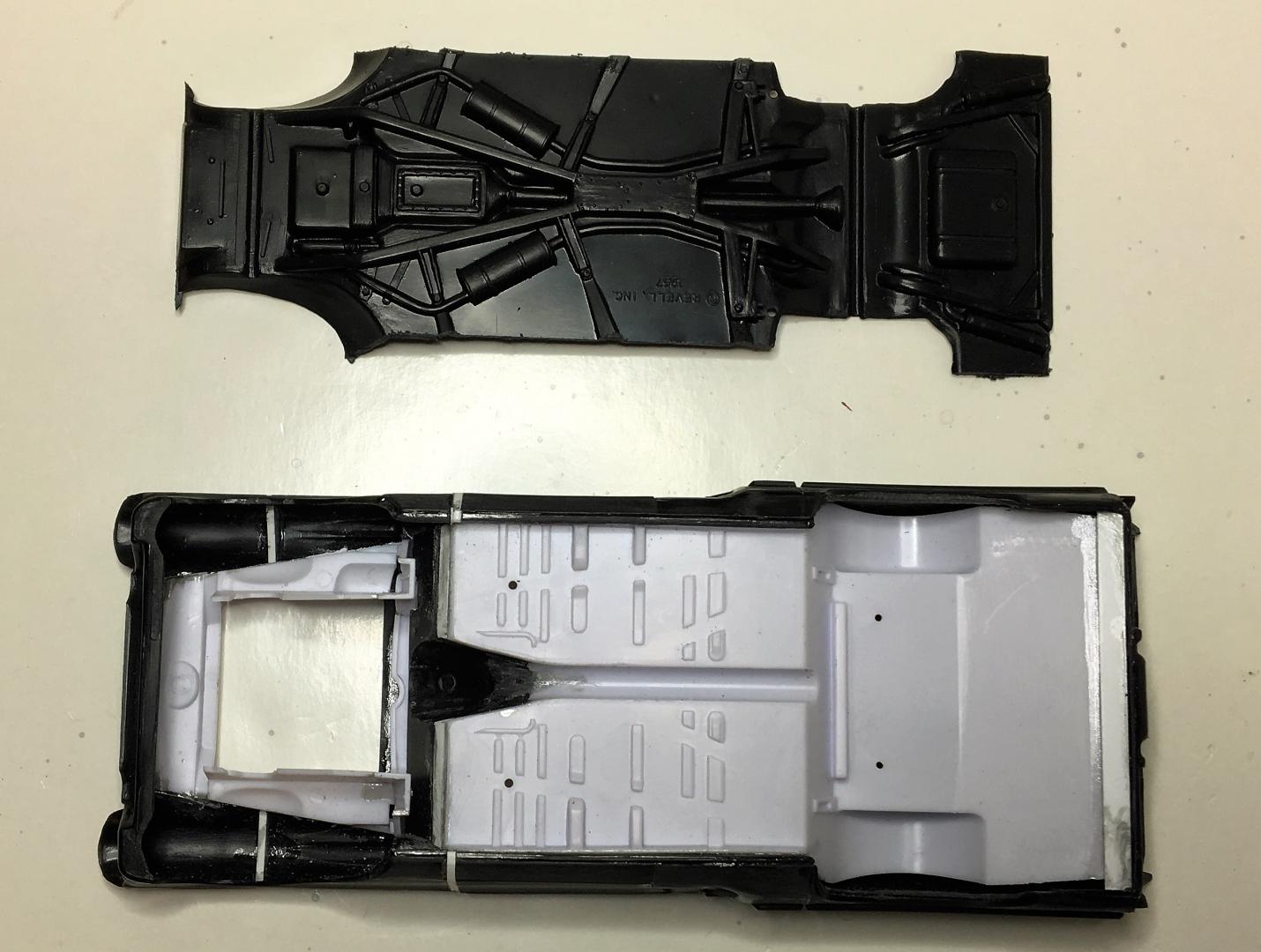

Ace-Garageguy Posted March 31, 2018 Share Posted March 31, 2018 For what it's worth, in the real world, aftermarket frames (like Art Morrison, etc.) made for specific vehicles, are usually very similar visually in shape to the OEM frames they replace. This is because well-designed aftermarket frames are engineered to pick up the original body mount locations. For this reason, kit frames that represent OEM units can be modified to represent aftermarket upgrades, usually, by cleaning them up in general, modifying or replacing crossmembers as necessary, installing IFS, and narrowing the rear rails to accommodate wider rubber. The Foose frame appears to be either a Morrison or similar unit, or an OEM frame that's been clipped both front and rear...achieving essentially the same thing. The '41 Caddy frame, below, is much like the '48. Quote Link to comment Share on other sites More sharing options...

misterNNL Posted April 18, 2018 Share Posted April 18, 2018 On 3/31/2018 at 10:28 AM, Ace-Garageguy said: For what it's worth, in the real world, aftermarket frames (like Art Morrison, etc.) made for specific vehicles, are usually very similar visually in shape to the OEM frames they replace. This is because well-designed aftermarket frames are engineered to pick up the original body mount locations. For this reason, kit frames that represent OEM units can be modified to represent aftermarket upgrades, usually, by cleaning them up in general, modifying or replacing crossmembers as necessary, installing IFS, and narrowing the rear rails to accommodate wider rubber. The Foose frame appears to be either a Morrison or similar unit, or an OEM frame that's been clipped both front and rear...achieving essentially the same thing. The '41 Caddy frame, below, is much like the '48. Great side by side comparison photo.Thanks for sharing that. Quote Link to comment Share on other sites More sharing options...
