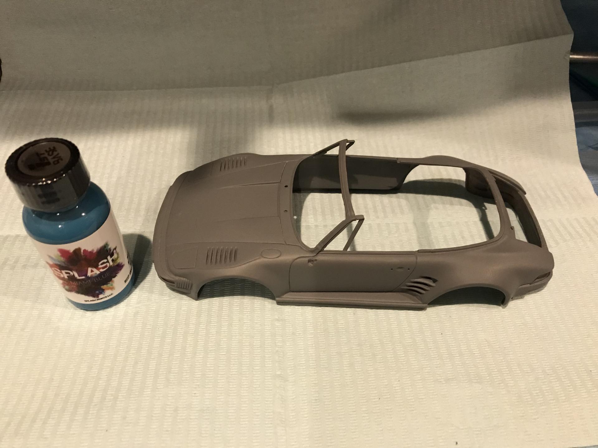

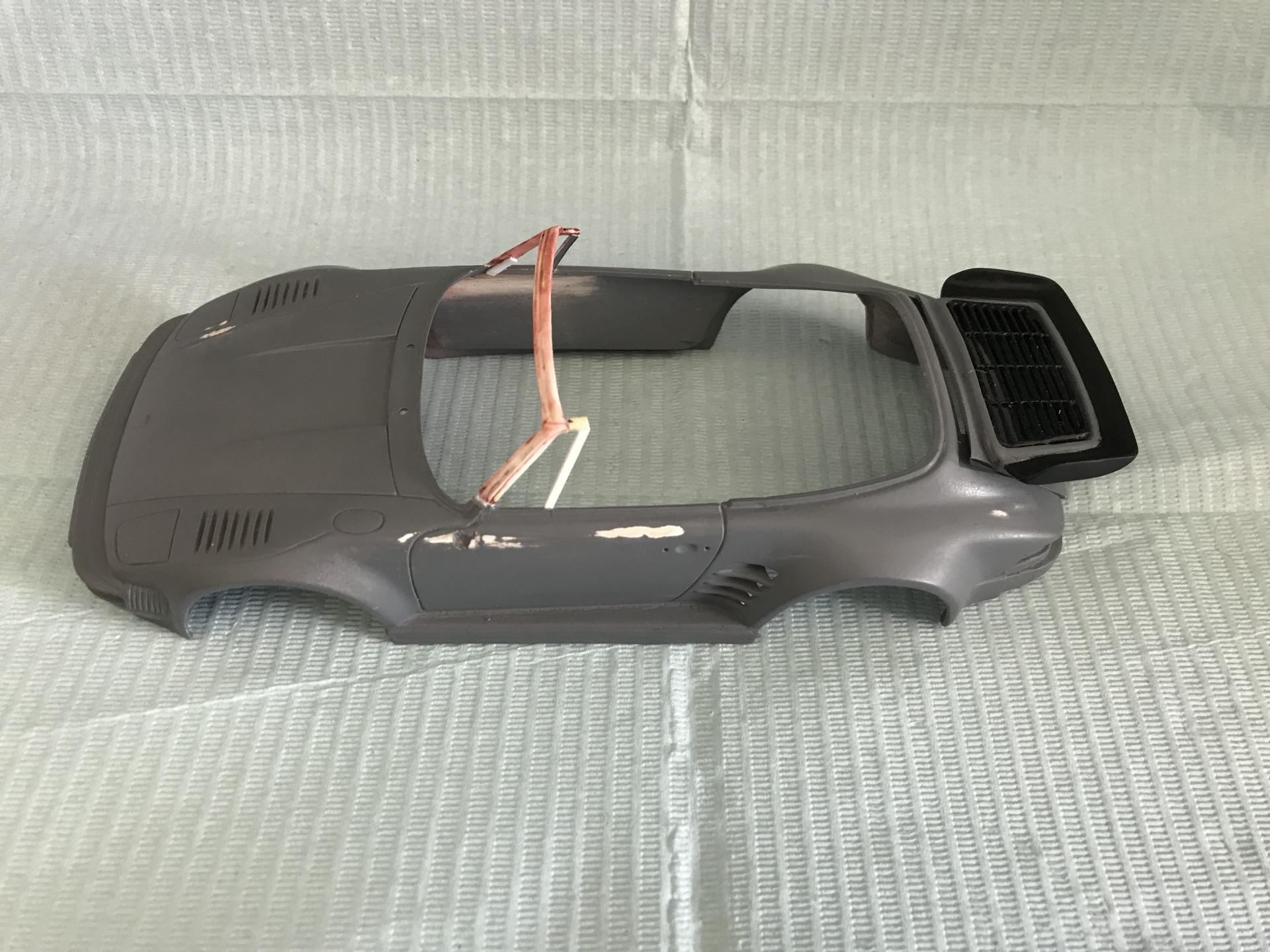

Getting set to paint tonight. The bottle says "ready to spray" so no thinner needed I take it
Any tips before I fire it up??

That is going to be an awesome color.  Better over white.

YA good point
It wasn't going to be this colour until I saw that paint.
It won't pop quite as much but this is only a test mule project, will prime the VW white
