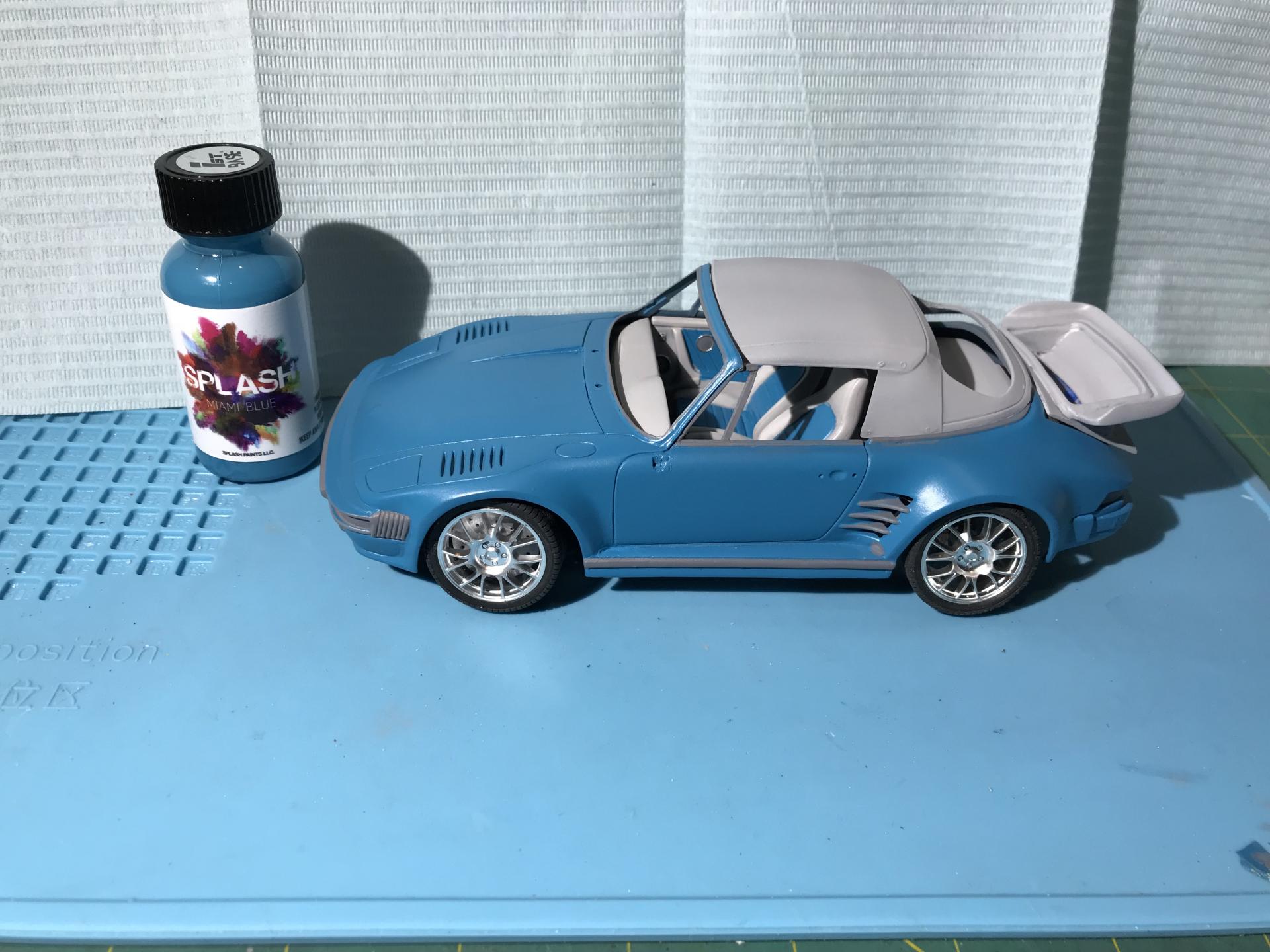

I did a spray of the Miami blue Splash paint on the weekend

Nice to see another paint company start up with an emphasis on maintaining good service. Although Scale Finishes or Gravity Colors paints are great,  their customer service degraded over time for many modelers.  Fortunately, Zero has been consistent.
Query: how does the metallic flake size of Splash compare to Gravity Colors? I know Gravity made a big deal of this when they first opened, and their flake size is small, at least compared to Scale Finishes (and maybe even Zero)?
We have had some big flakes on certain colors on previous releases. (Metallic colors) But all the new releases from here and onward will have scale correct ultra fine flakes.

Going by Bill Eh's recommendation, I placed an order today.
Looking forward to trying Splash Paints.
Share this post
Link to post
Follow Samuel's recommendations for needle size and pressure. Results are great

48 minutes ago, T-bone said:
He recommends a .15 for colors and clear and .4 for primer
Good. Thanks :D
