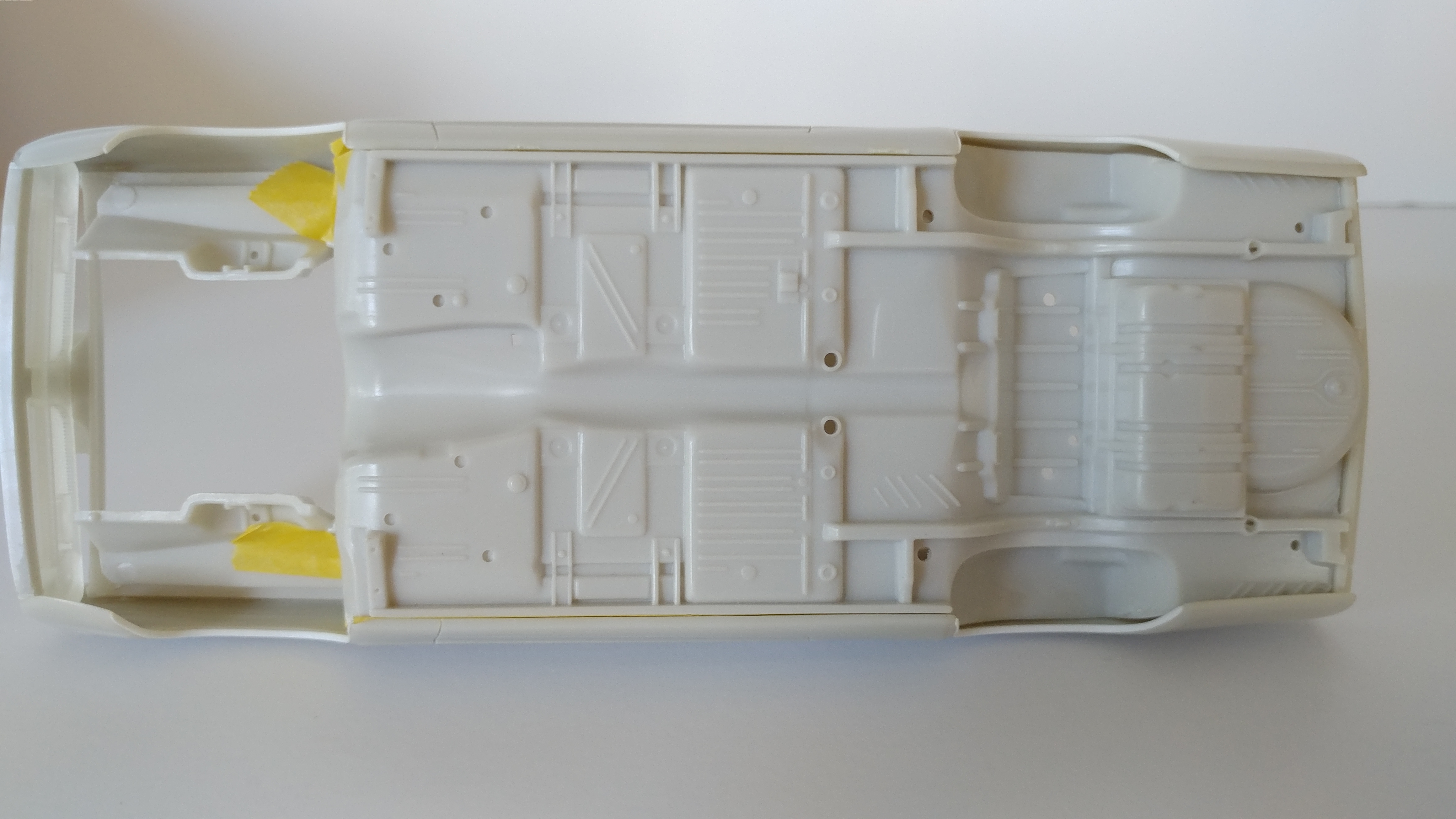

DustyMojave Posted May 1, 2018 Share Posted May 1, 2018 Some pics of my own 69 'Cuda on '71 Duster chassis: Comparison of the 2 chassis. Then where the firewall SHOULD fit based on photos of 1/1 Barracudas. MPC accurately located the firewall there BTW. The Duster firewall is between the ribs inside the fenders. How I cut it to adjust wheelbase and where the firewall fits. Quote Link to comment Share on other sites More sharing options...

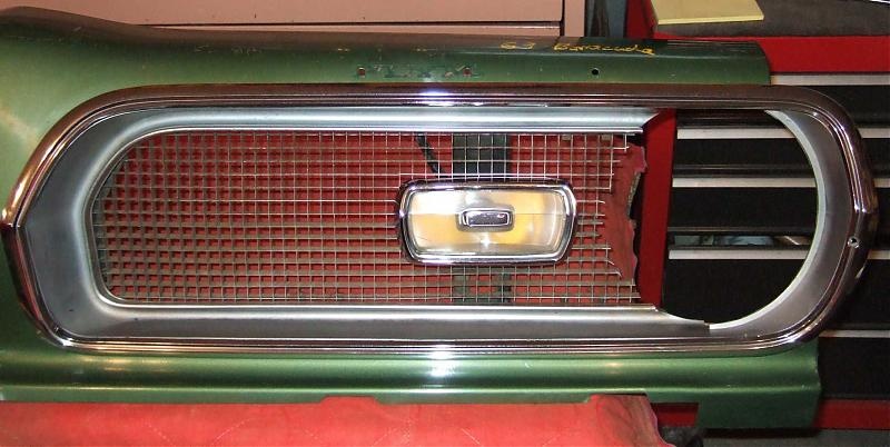

camaro69 Posted September 15, 2018 Share Posted September 15, 2018 Hi everyone, I´m involved in this project in making the accurate grille inserts and taillights. Today the testprint of the grille arrived. There are some little touchups left to do, especially the upper center parts of the inserts which I have to reshape. Otherwise I would call the grille done. Turn signal lenses are already drawn but not printed yet. Here some pics... Hope you like it. Rico Quote Link to comment Share on other sites More sharing options...
Bucky Posted September 15, 2018 Share Posted September 15, 2018 Looks darn close, to me!! Quote Link to comment Share on other sites More sharing options...
camaro69 Posted September 15, 2018 Share Posted September 15, 2018 Thank you Keith, but I wasn´t really happy with it. Reshaped the center area in hope the next test will fit better. Quote Link to comment Share on other sites More sharing options...

Dave Darby Posted September 24, 2018 Share Posted September 24, 2018 On 5/1/2018 at 7:29 PM, DustyMojave said: Some pics of my own 69 'Cuda on '71 Duster chassis: Comparison of the 2 chassis. Then where the firewall SHOULD fit based on photos of 1/1 Barracudas. MPC accurately located the firewall there BTW. The Duster firewall is between the ribs inside the fenders. How I cut it to adjust wheelbase and where the firewall fits. You had to adjust the wheelbase? On the 1:1s, both cars share the same 108 in wheelbase. Which kit was off, I wonder? A little trivia, newer Darts used the 69 Barracuda hood. Quote Link to comment Share on other sites More sharing options...

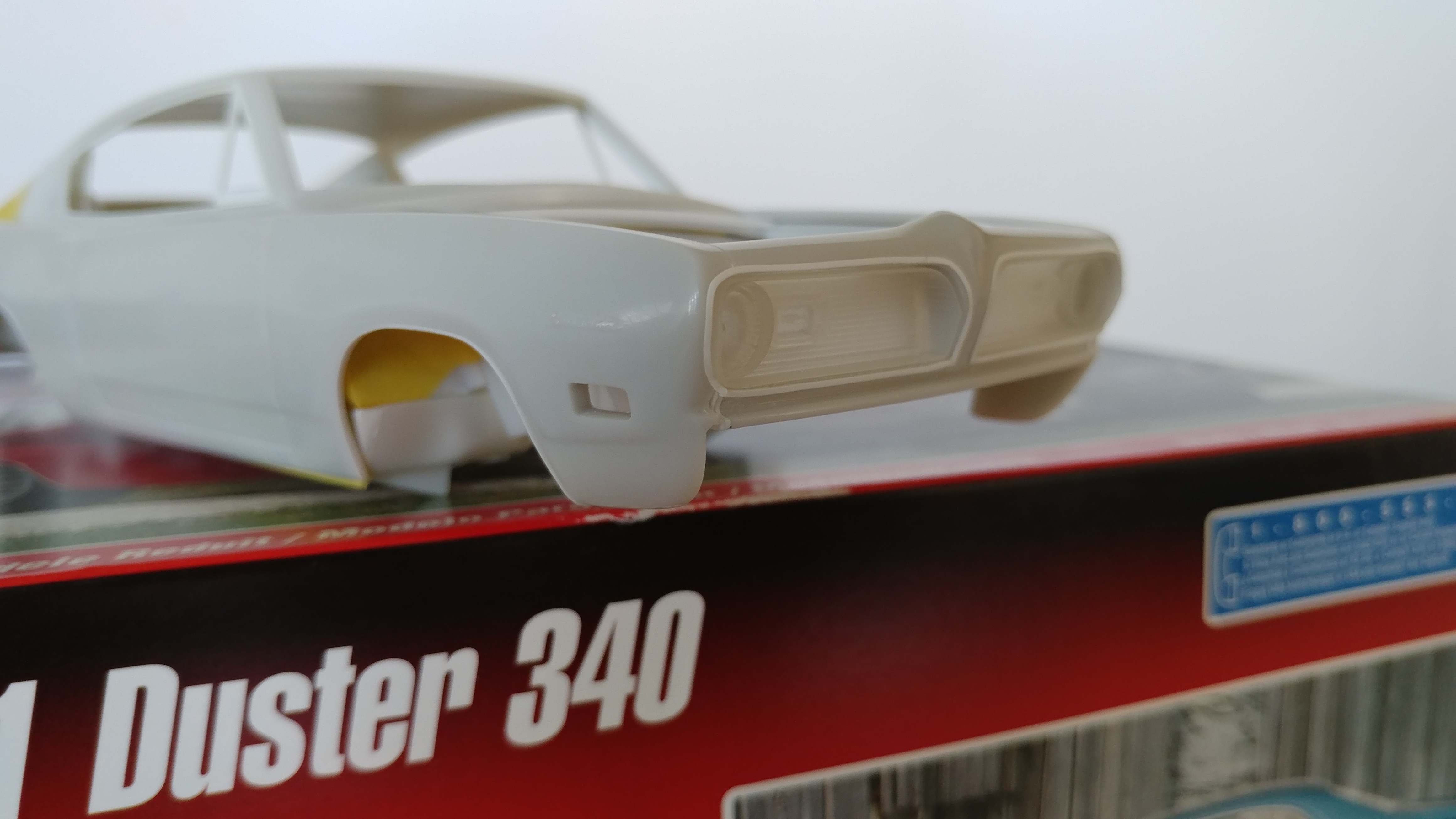

BobbyG Posted September 30, 2018 Author Share Posted September 30, 2018 On 9/15/2018 at 7:28 PM, camaro69 said: Thank you Keith, but I wasn´t really happy with it. Reshaped the center area in hope the next test will fit better. I just received my "test shot" Cuda grille from Rico, WOW!!!!. It fits like a glove with no modifications required and just looks right. The depth of the grille, the mesh and the signal lights are correct. I asked Rico if he could design and produce this grille and he came through. Now, I can't wait for the taillight/panel so I can finish this project. BTW, I had no problem using the Duster chassis as the wheel base matches the body and the only modification was some minor trimming at the rear. I did add a tab at the back edge and a slot in the body to lock in the chassis as if was designed in the kit. Rico does outstanding work and he is filling a void for us using his talent! Thanks Rico! Quote Link to comment Share on other sites More sharing options...
