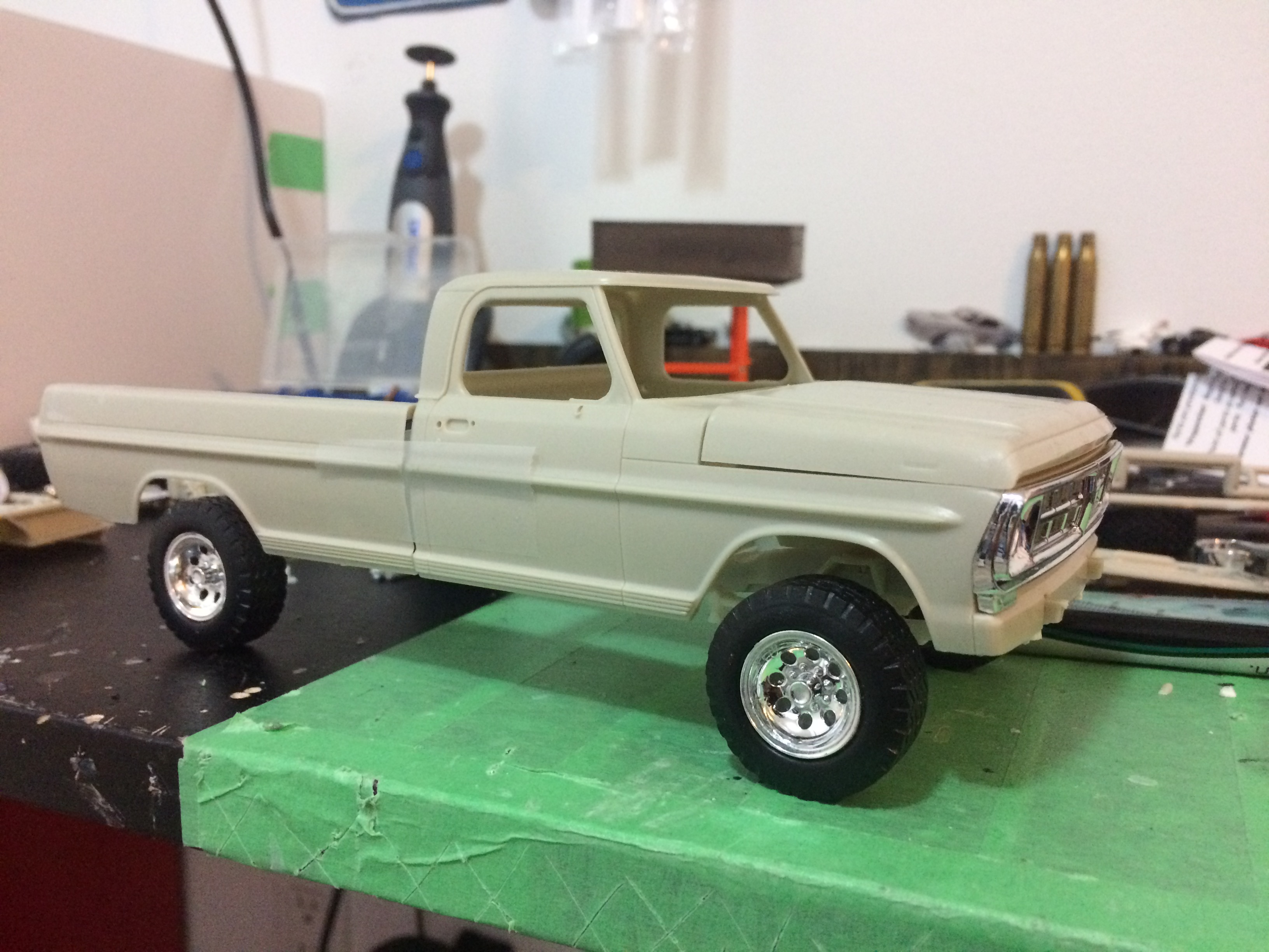

I will be building a moebius 1971 Ford that I converted to an F-250 4x4.
My truck will be affordable off-roader (something a teenage like myself could afford and have some fun with)

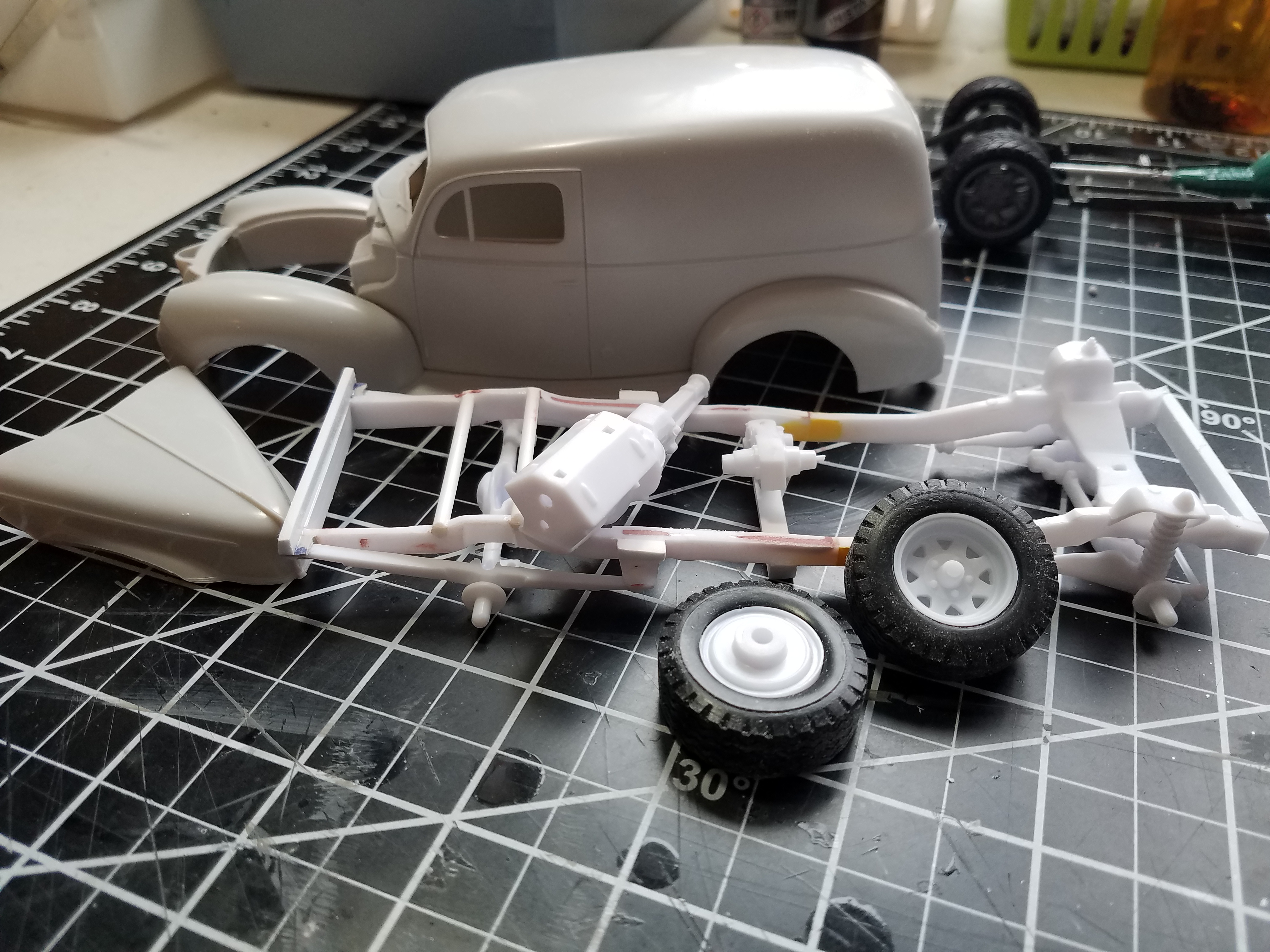

I'm doing a 40 Ford Panel 4x4. I'll post up pics tomorrow.

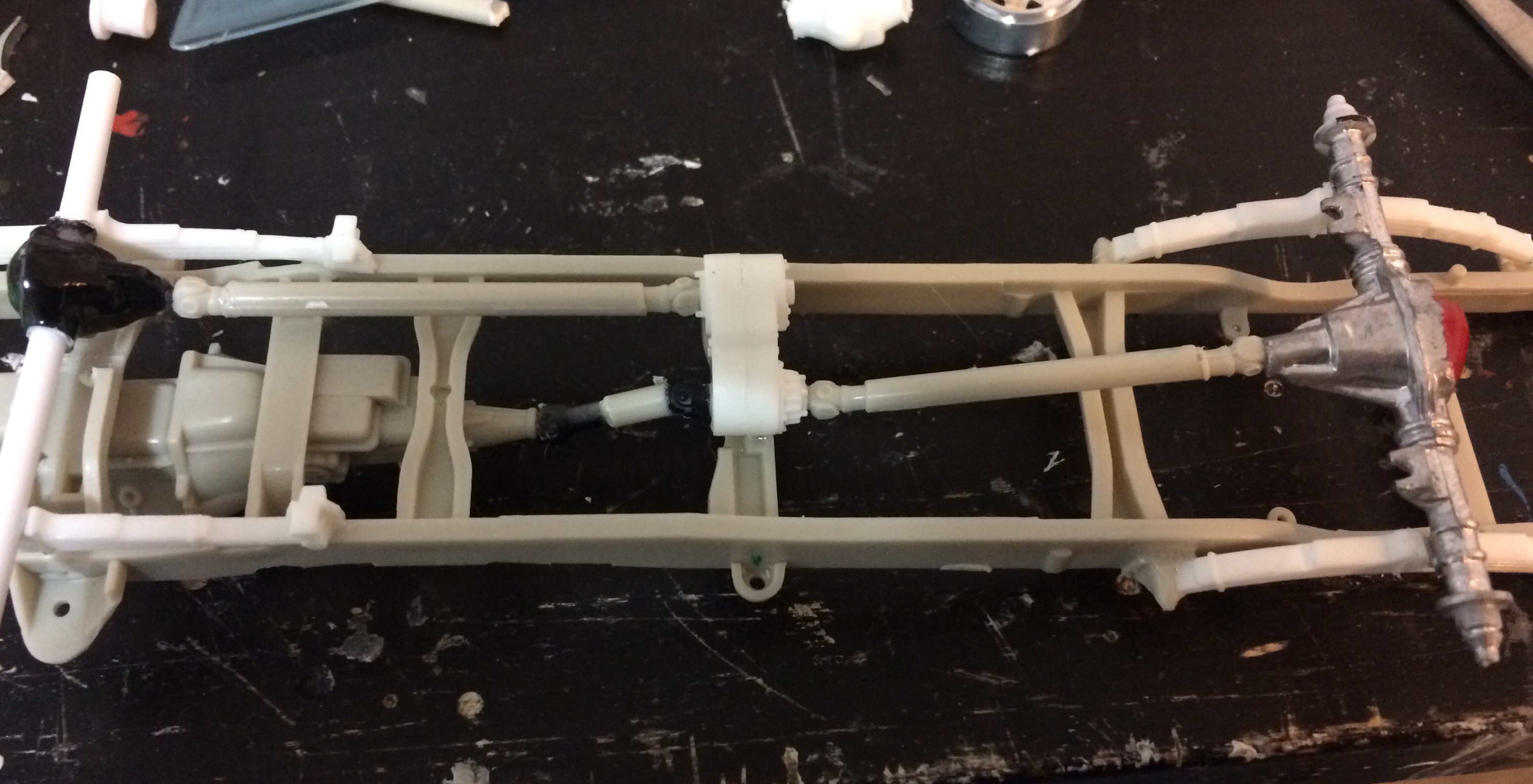

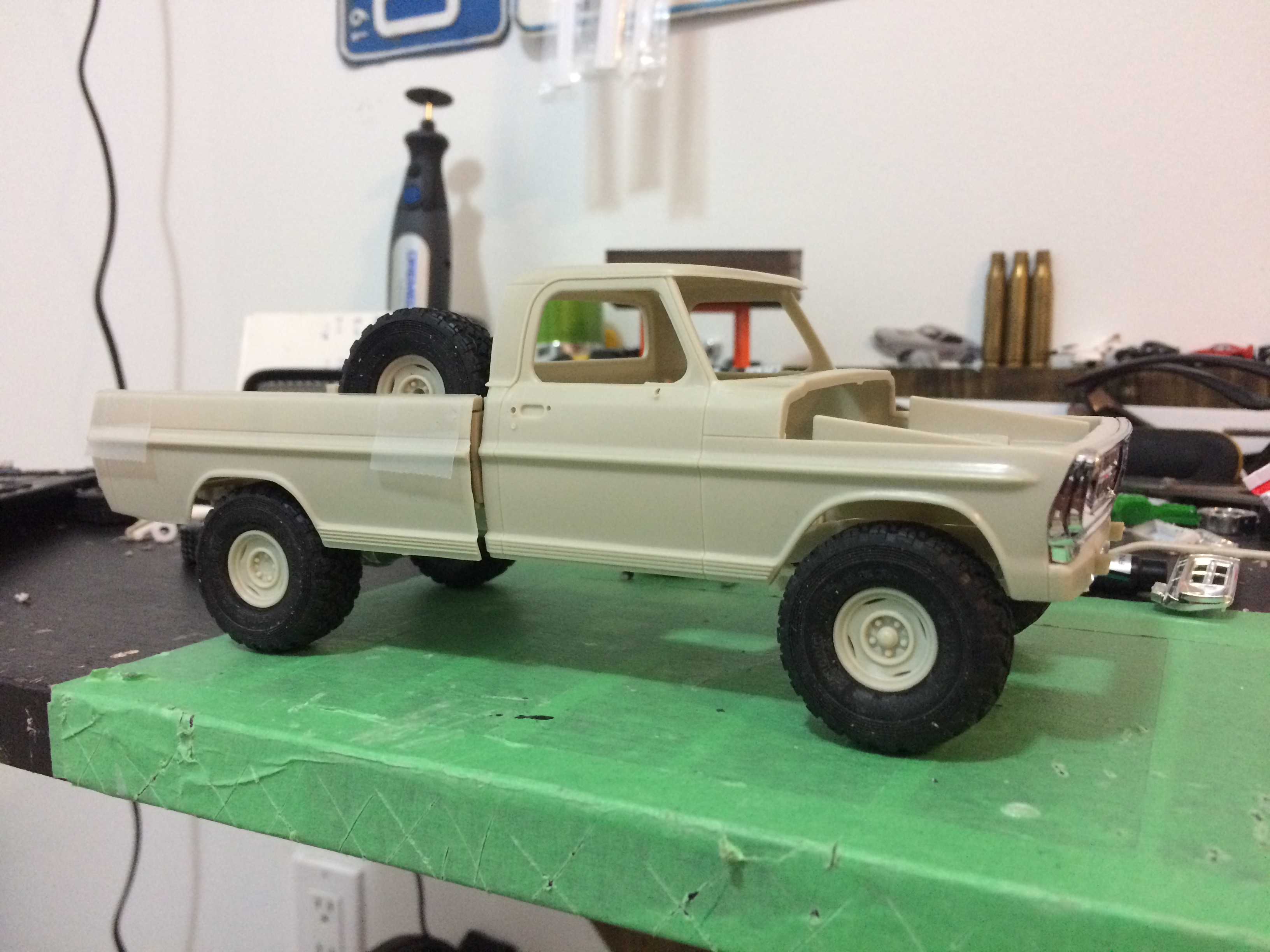

A little update,...deciding on stance

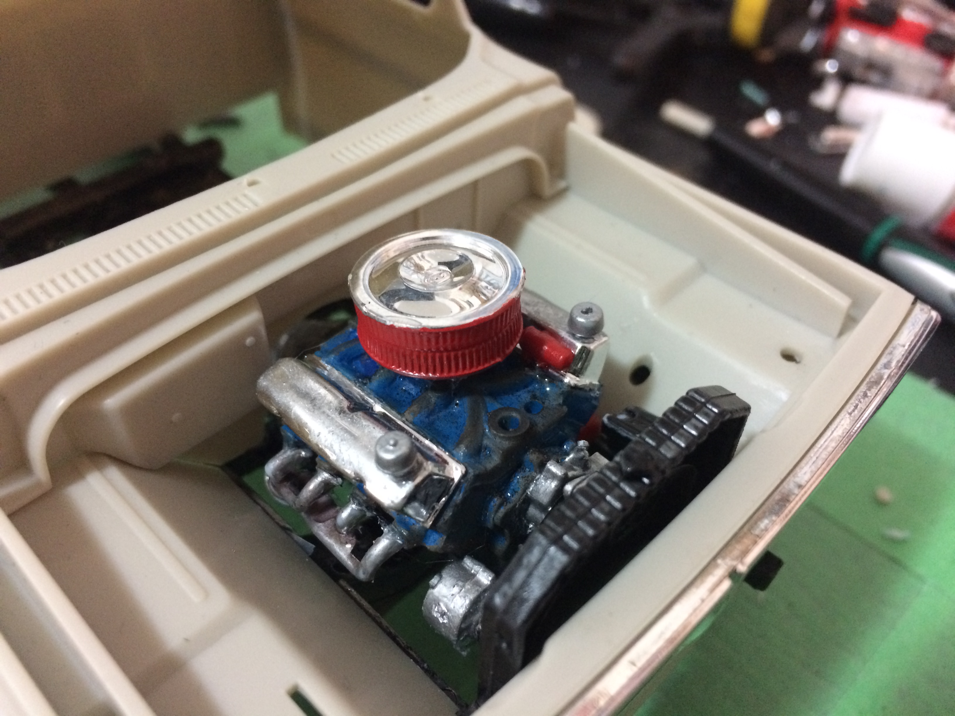

and power unit....
fills up the engine bay a bit better

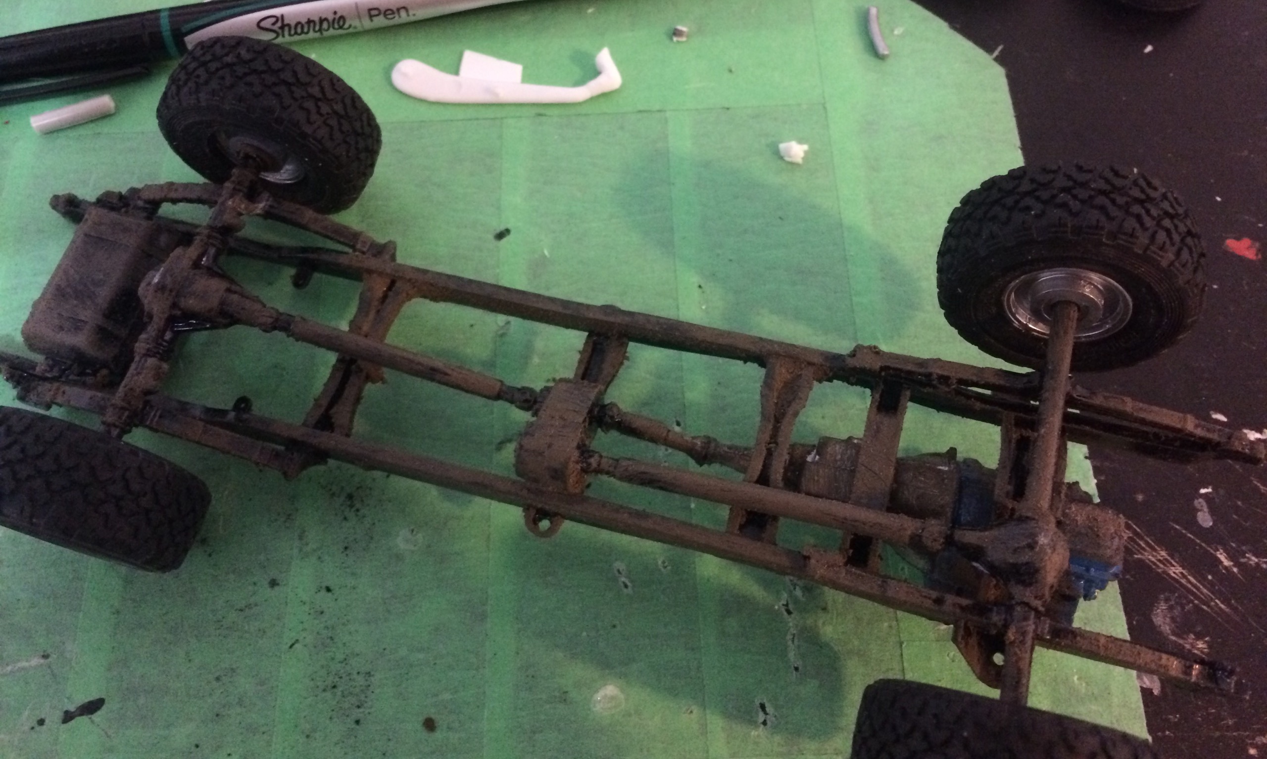

Here’s an update.
I found a set of 37” yokahama mud digger tires.
And the engine and frame are painted.
Share this post
Link to post

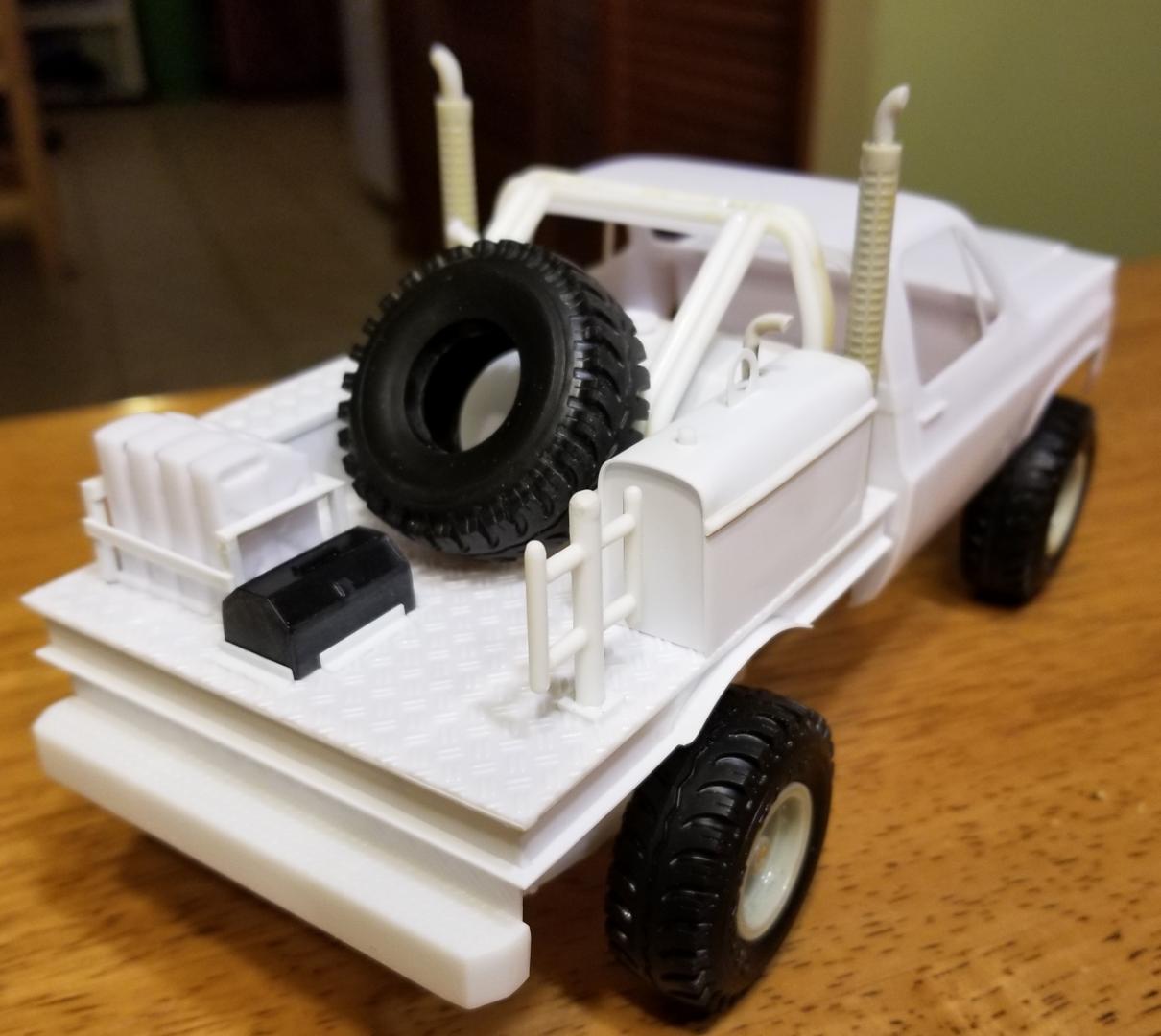

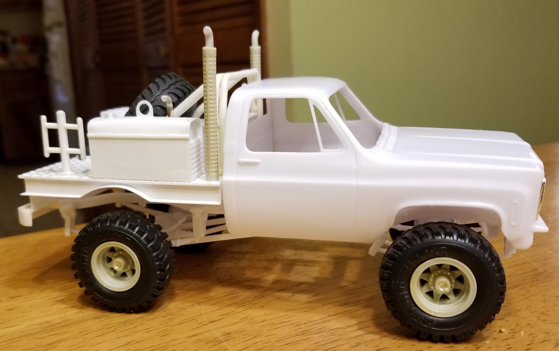

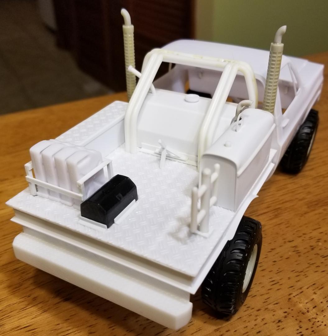

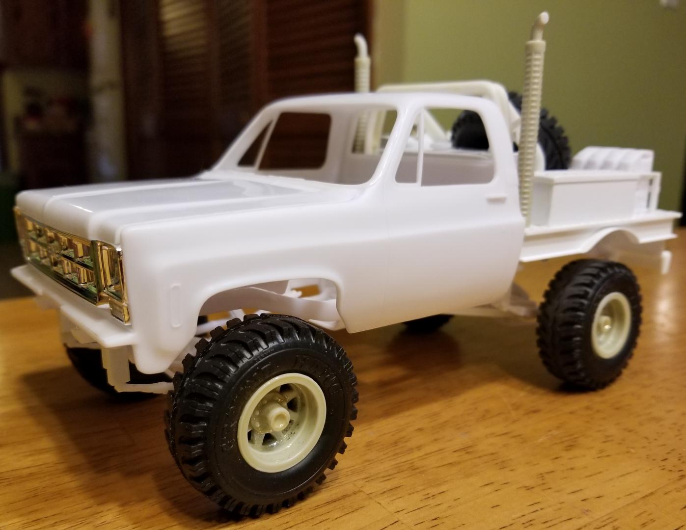

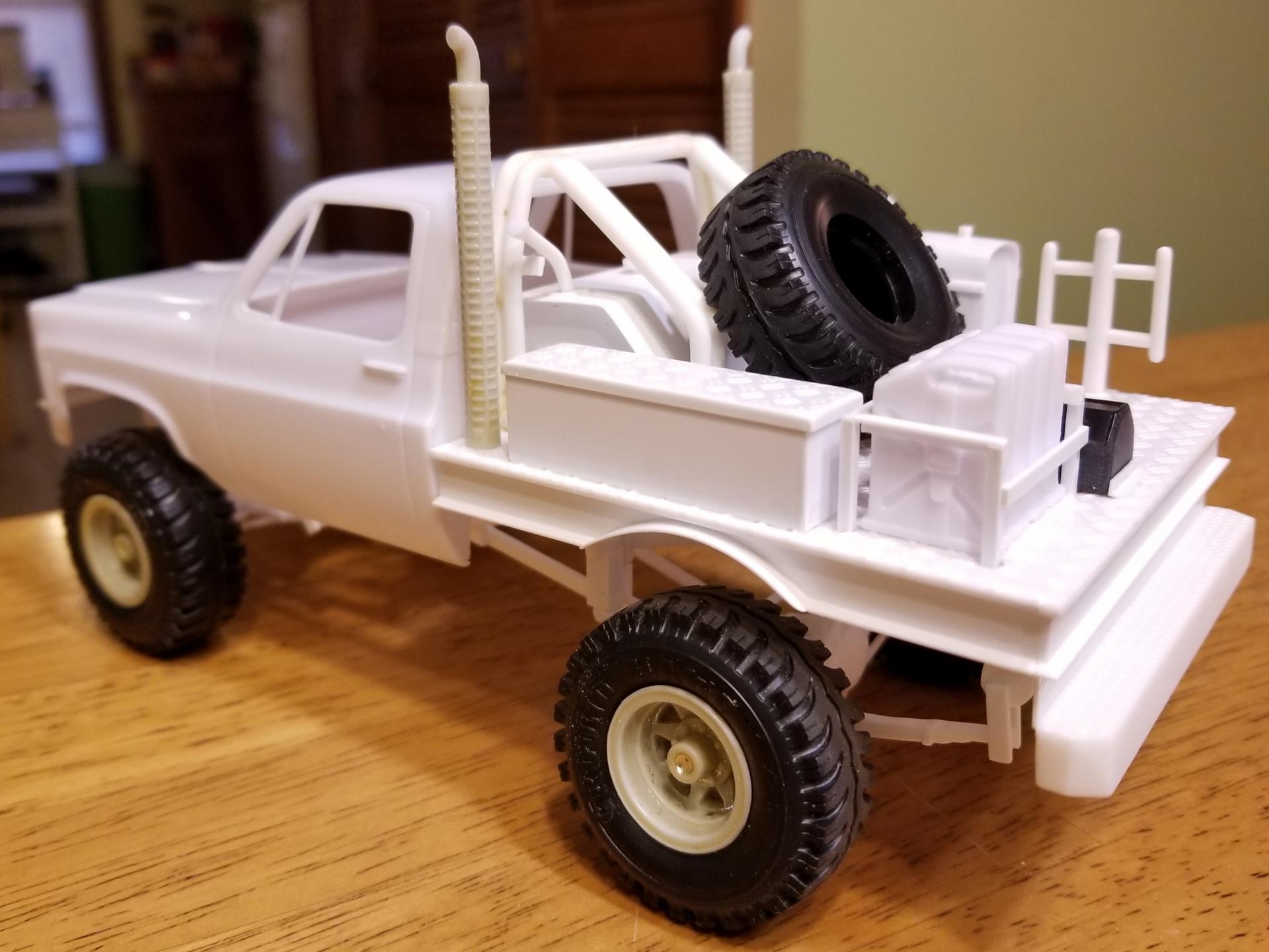

Okay, this my first major update for this build and I wanted to explain a bit about my design philosophy.
First, a weekend warrior is someone who is usually ballin' on a budget so I didn't want to use a collectible vehicle or something with hard to find parts as a base. This should ideally be something you can bash around without feeling bad about a few dents and dings. You can't get much more ubiquitous than a square body GM truck. It also meant that the truck would likely be a Jack of a trades type instead of a dedicated rock crawler or mud buggy. Something you can have fun in in lots of different types of locations but might not be the best for each situation.
Second, the vehicle should already have decent components for inexpensive modification. This ruled out similar era Ford products due to the TTB front end. GM's solid axle front is a much better platform for modification. I had intended to run the standard five lug wheels to indicate the stock Dana 44 and 12 bolt but I couldn't find five lug rims that fit the tires good enough. With all  the weight I've added to the rear it probably does need upgraded axles now.
Third, since the truck needed to be a daily driver recoverability and survivability are important. Getting back to go to work Monday is a big part of this things job. I put a storage bin on the driver's side for tools and recovery items and the jerrycans will hold different fluids that might get lost on the trail. I took off the stock fuel tanks and replaced them with a bed mounted tank under the roll bar. The welding machine on the passenger side will let you fix any busted pieces and let you get back on the trail.
20180417_200947.thumb.jpg.baf434724fe90644f6a1792e97c1073c.jpg20180417_200845.thumb.jpg.8fc702cd0e00ac44a024150fa49a87aa.jpg20180417_200809.thumb.jpg.d0dc20ec0b11727d108f6d51d95f9090.jpg20180417_200717.thumb.jpg.c256d7edc7ddd6d3a27b6f1eef1f535c.jpg20180417_201049.thumb.jpg.0ae91a029a1e7712f06c5d4994056e44.jpg

This just started at the right time for me when my bench was clear. I just finished the L9000 and custom Caddy so all I had going on was the CBR Mustang but I'm still waiting on a second set of bigger wheels for that. I was kind of stalled when this was posted so I was able to jump right in.
